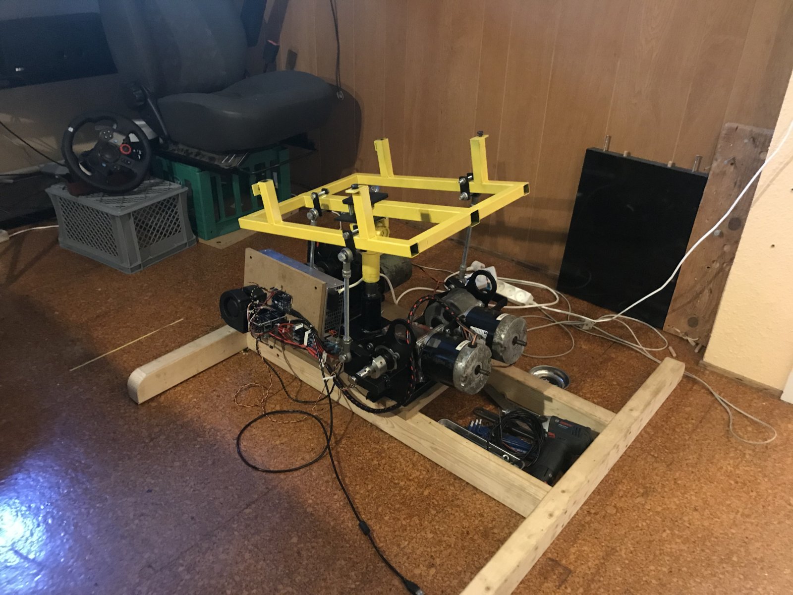

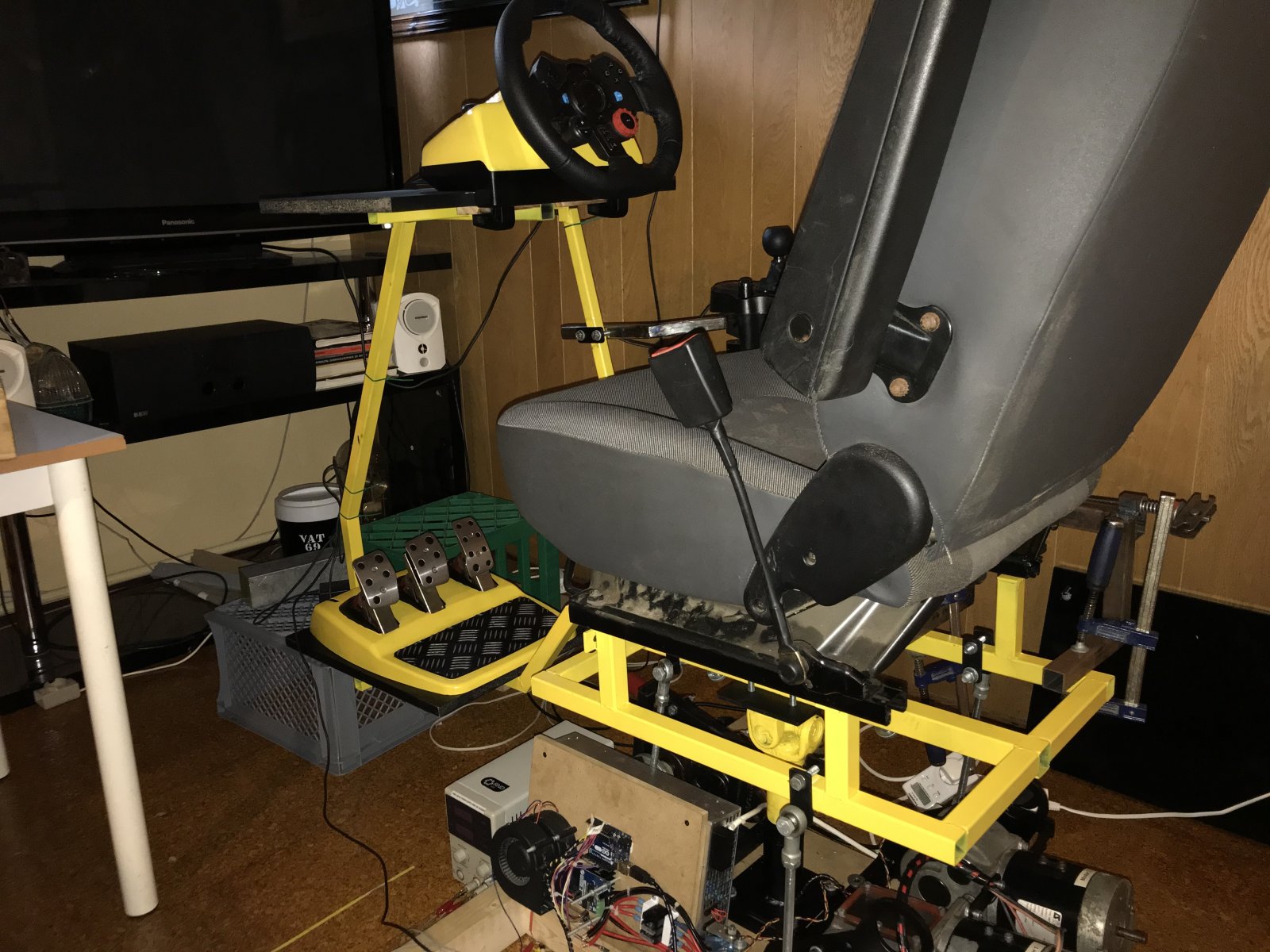

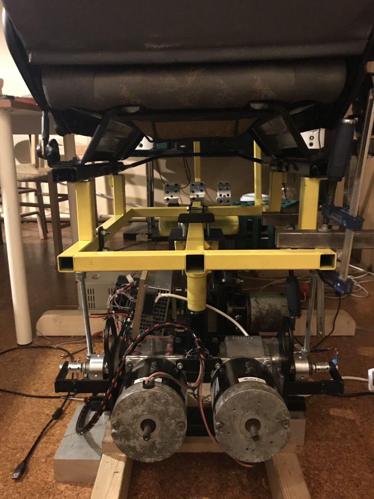

    Hi everyone . A am currently in the midst of converting my diy 2 dof into a 3 dof. roll, pitch AND heave. This means that the motors need to work much harder, since the rig can not be in balance.

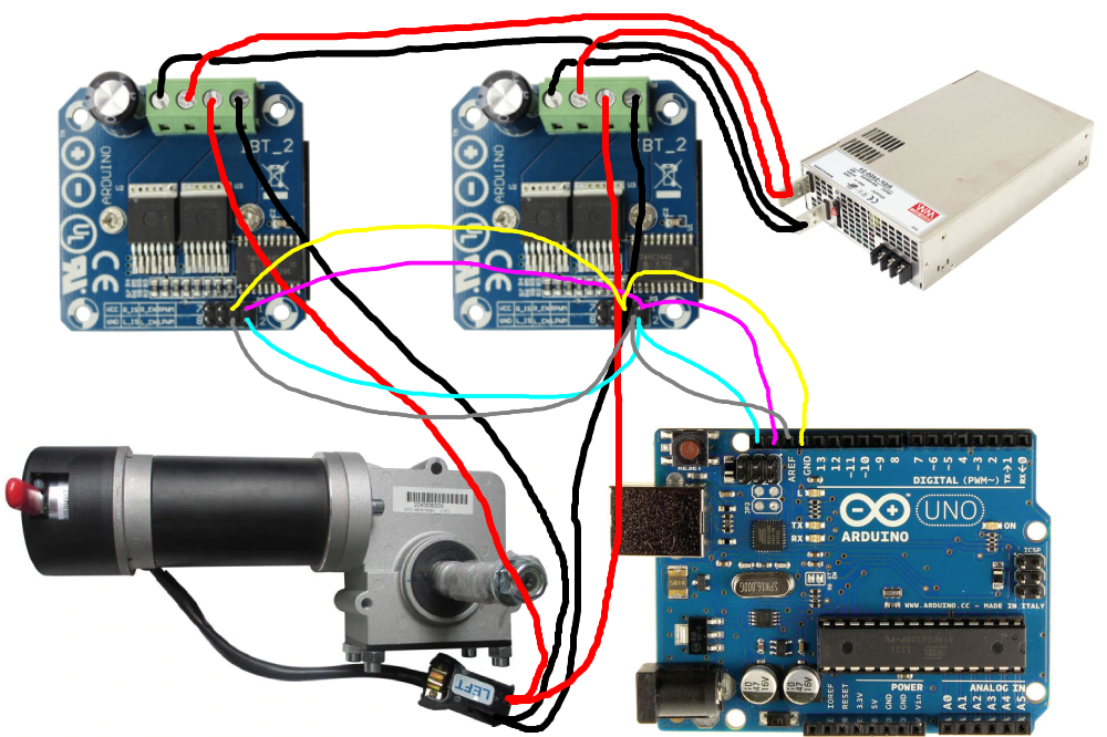

    Ok. I have made this drawing of how i think it should go together. (the wires to the arduino is obviously not correct and is only for illustration)
    Is it guanteed that the load would spread evenly to both drivers?
    Thanks!
  5. Gadget999
    2,011
    12,271Coins
    +494 / 11 / -0
    That looks correct

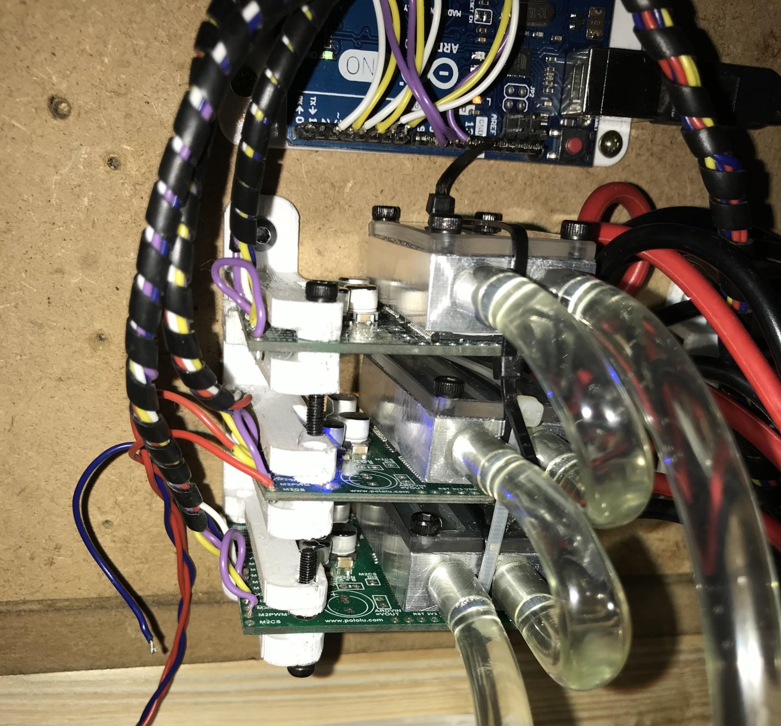

    Hi! Yearh i have been kind of silent working on and off on this project. I got 3 of the VNH5019 drivers and just ran them in parallel mode. That gives me 60A of current. I also decided to watercool them, just because the air cooling was way too loud, and also just for fun. I will make a follow up on the projekt when i get time.
    Take care!
