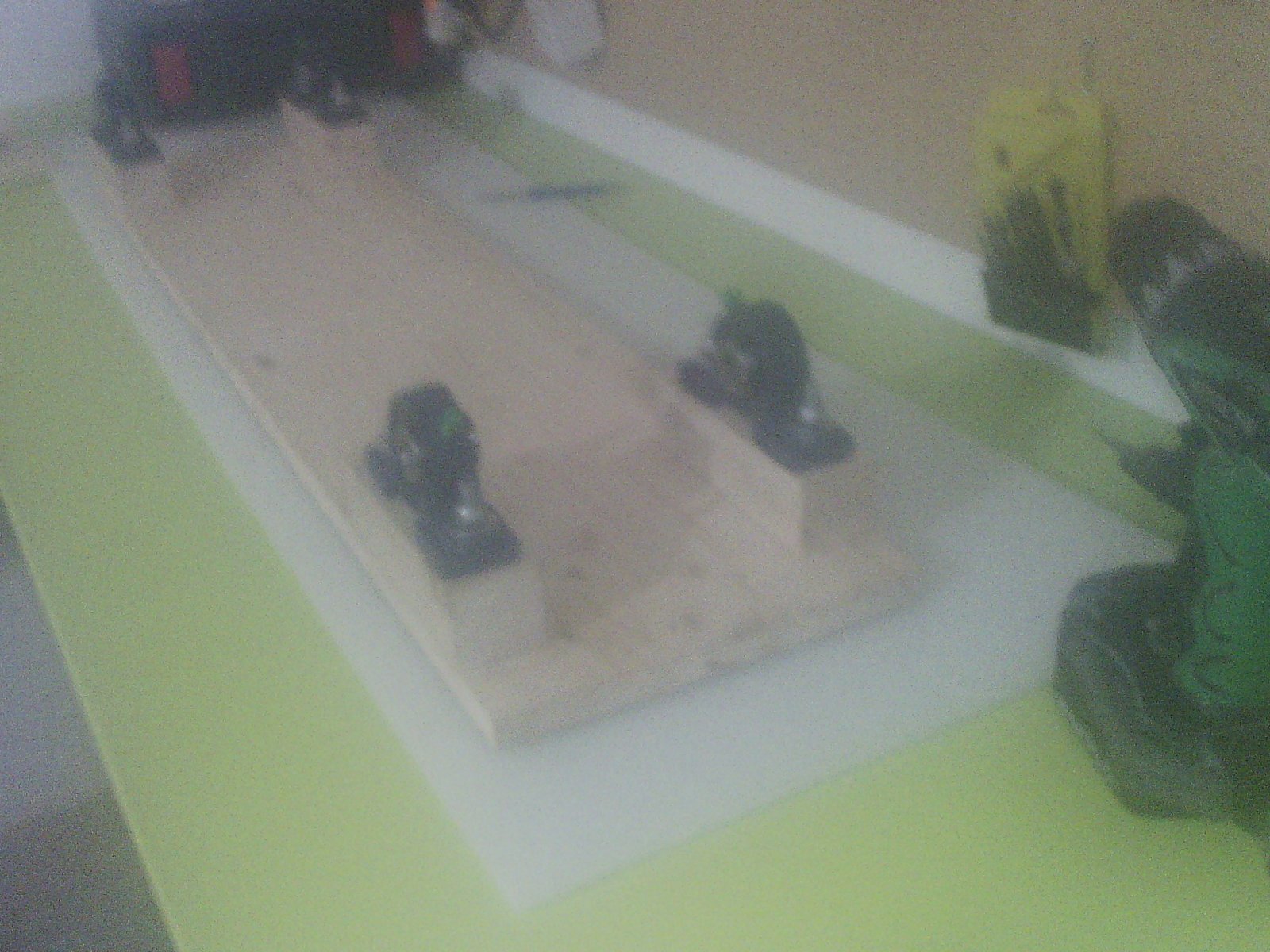

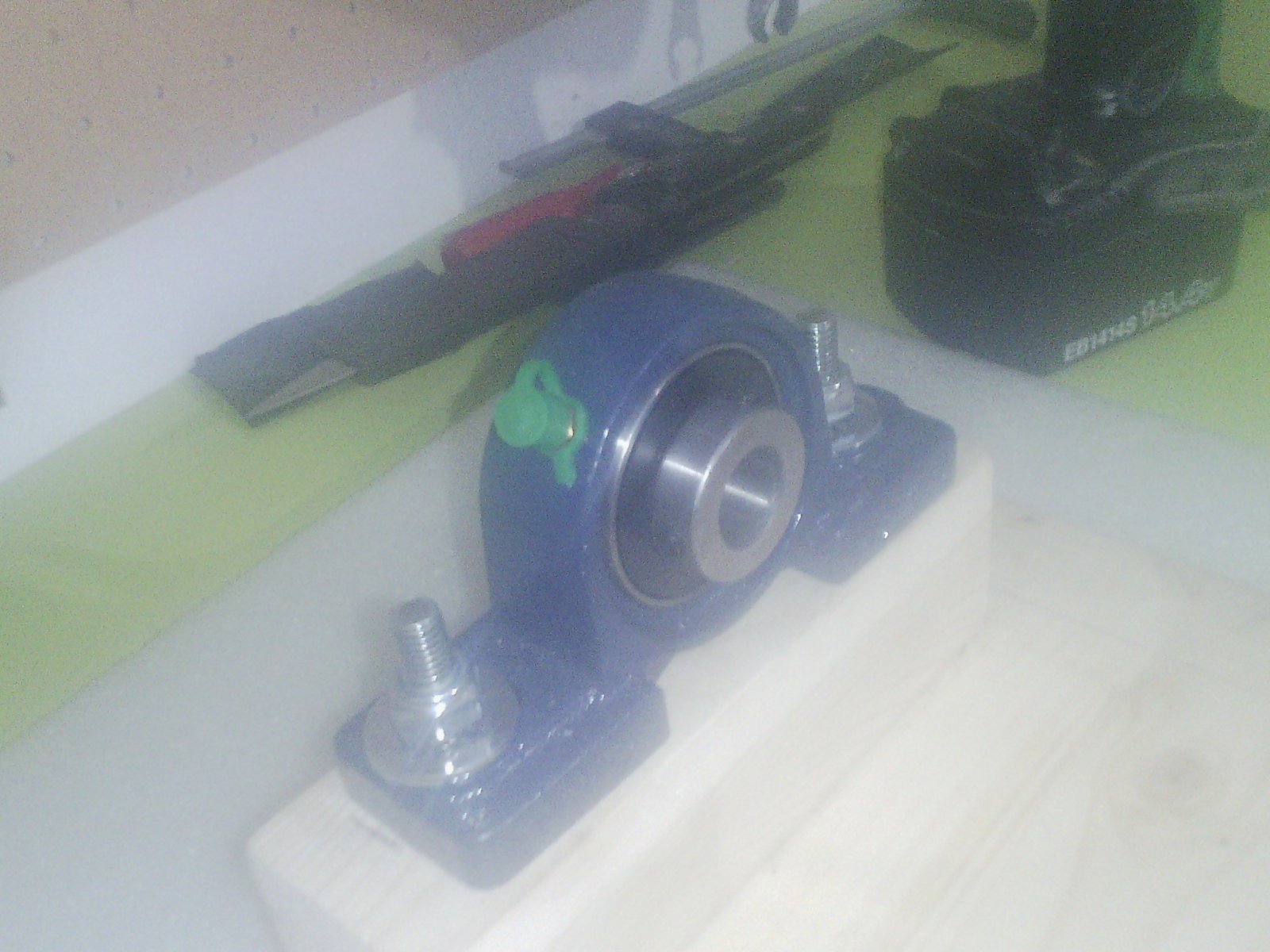

    This is what i have today, just bearings, i'm waiting for the 10t pot, 2 15mmx330mm solid steel shafts, 4 pulleys and 2 20mm M8 belts.
    These are the 15mm bushings, the best i could find
    they are factory oil filled and almost lifetime warranty, interchangable bushings 5euros /each

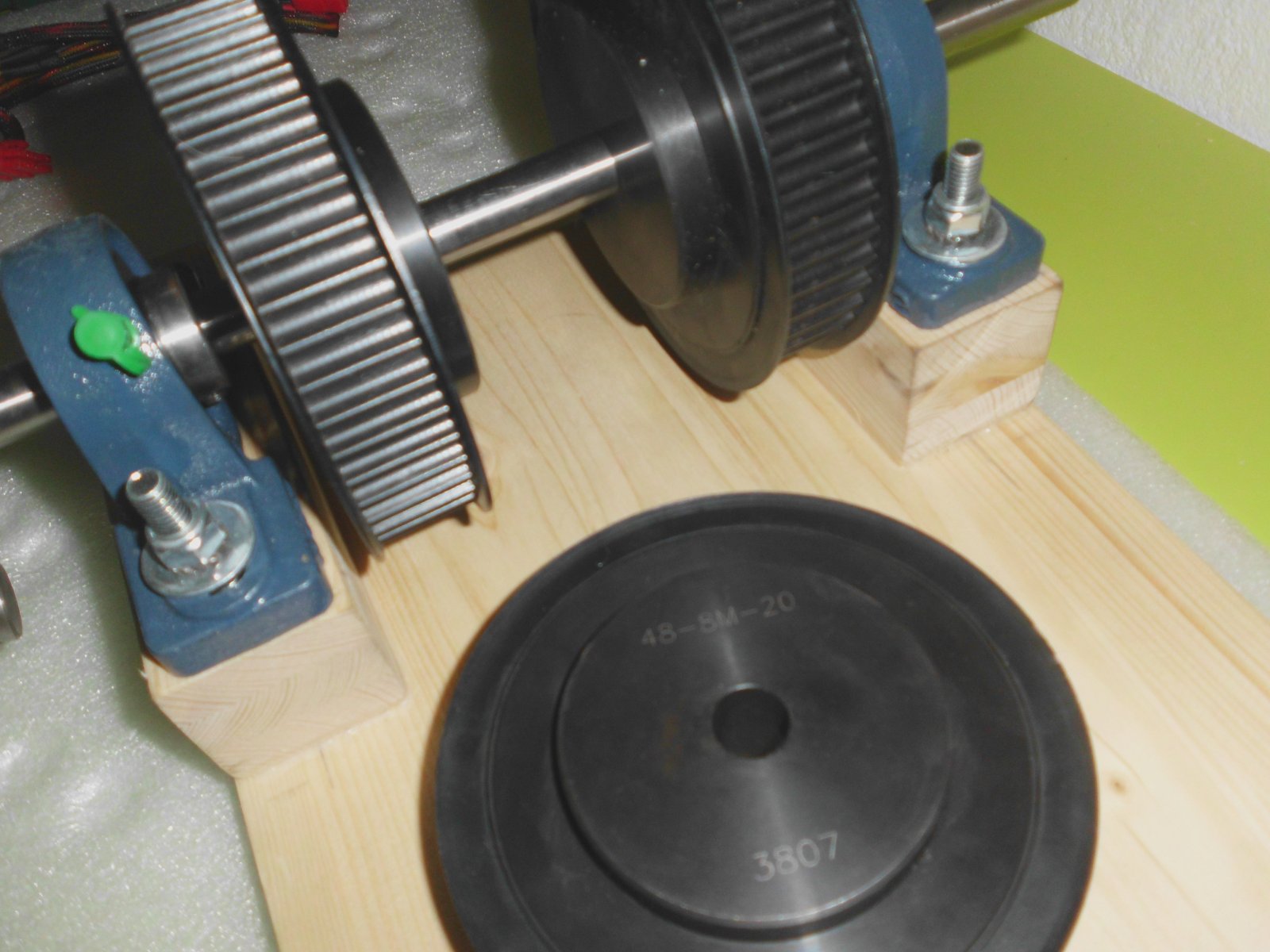

    Update of what i get, its nothing special but there are a lot a things comming.

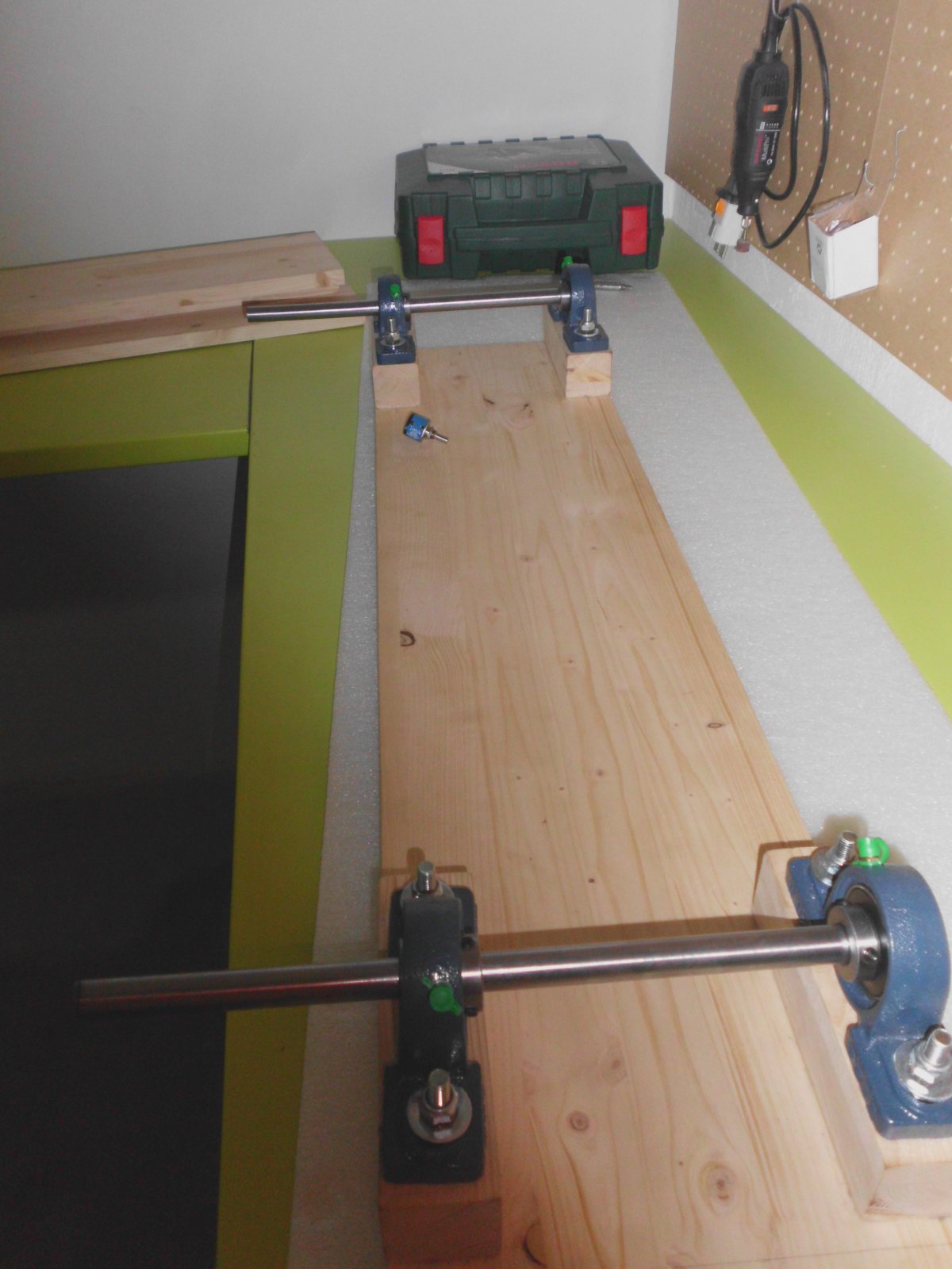

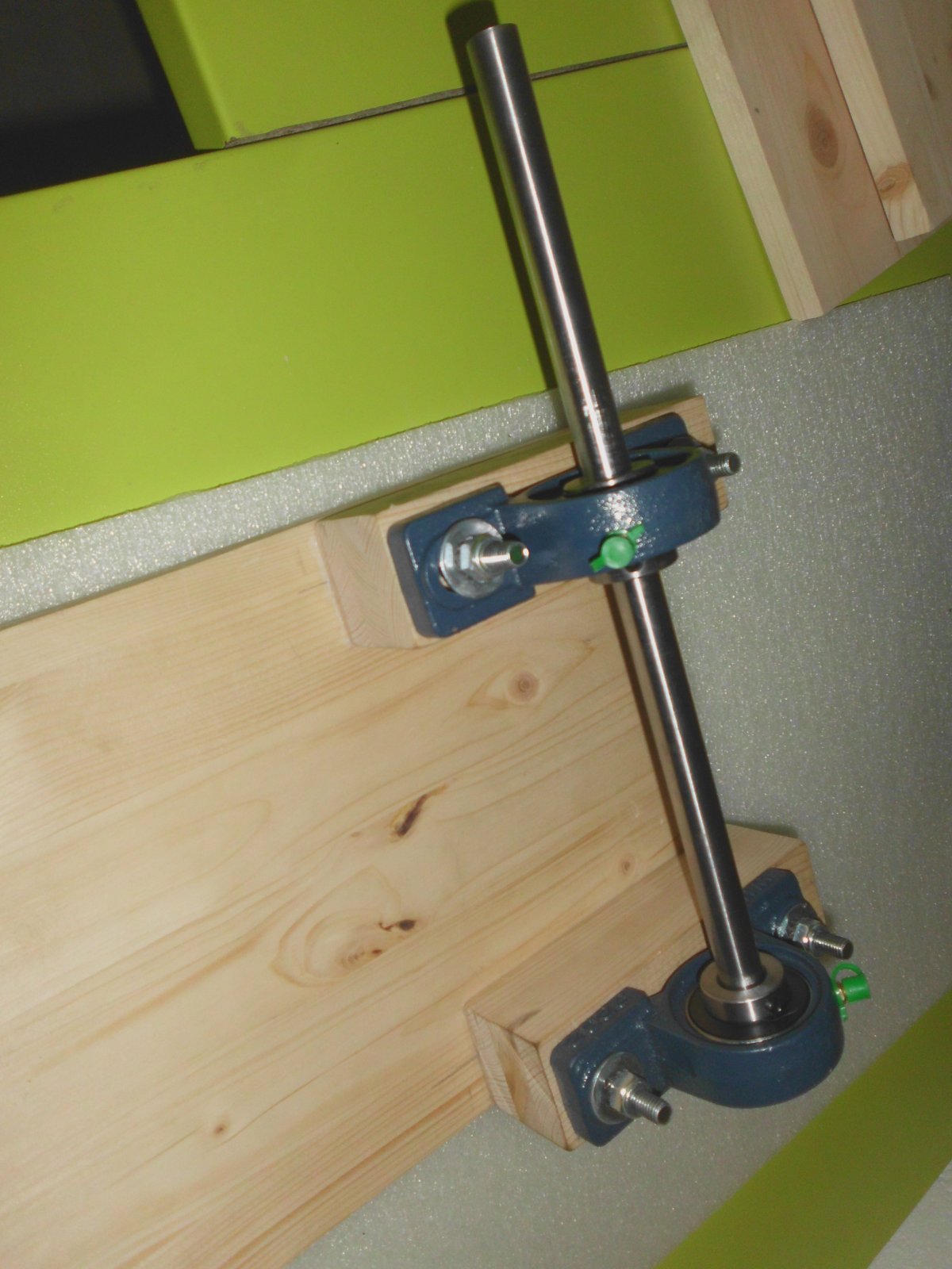

    15mm steel plated shafts. Cr,V,Mn needs to be cut, depends on the motor position which is being shipped.

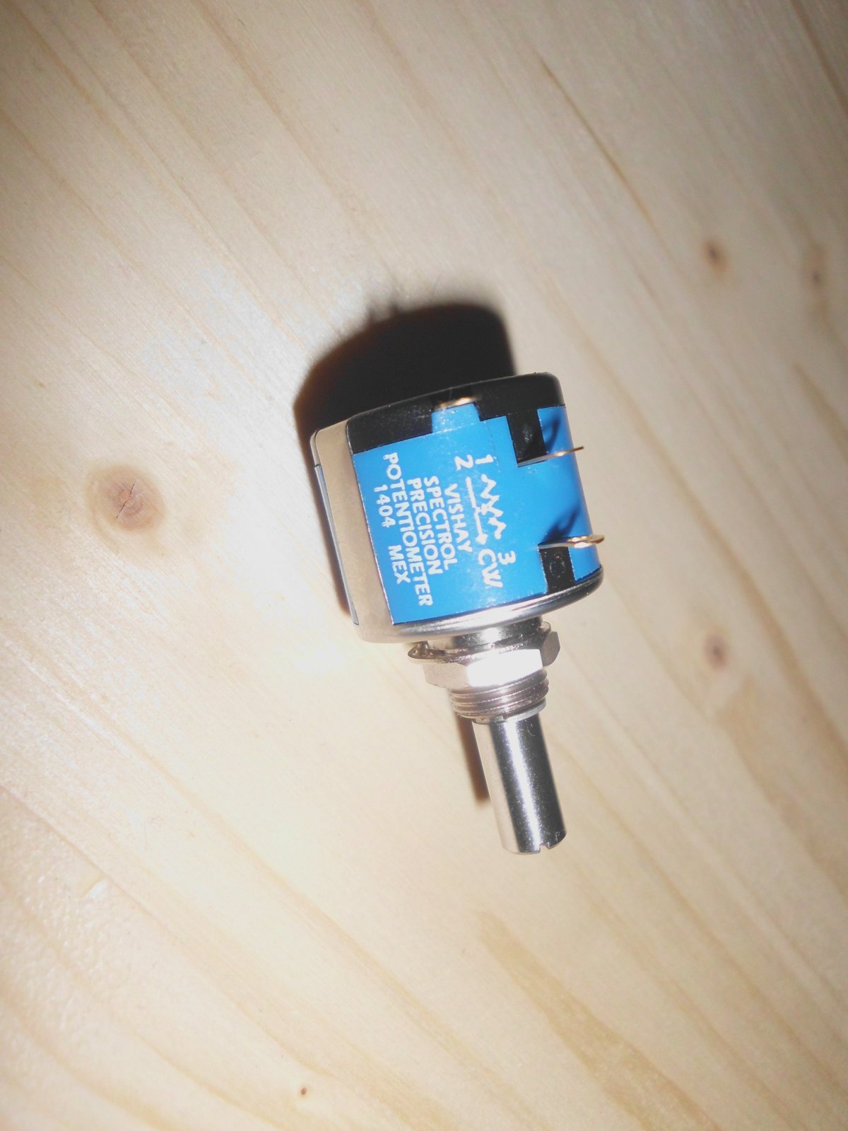

    This is the 10turn pot. Its vishera, it seems to be good. has a metric shaft 6mmx17mm it will turn about 7 times in a 50cm travel.
    This is a main view of the thing, thats the aprox position of the potentiometer. sensed via belt, 9mm 3M pitch.
    More soon.
    Greetings

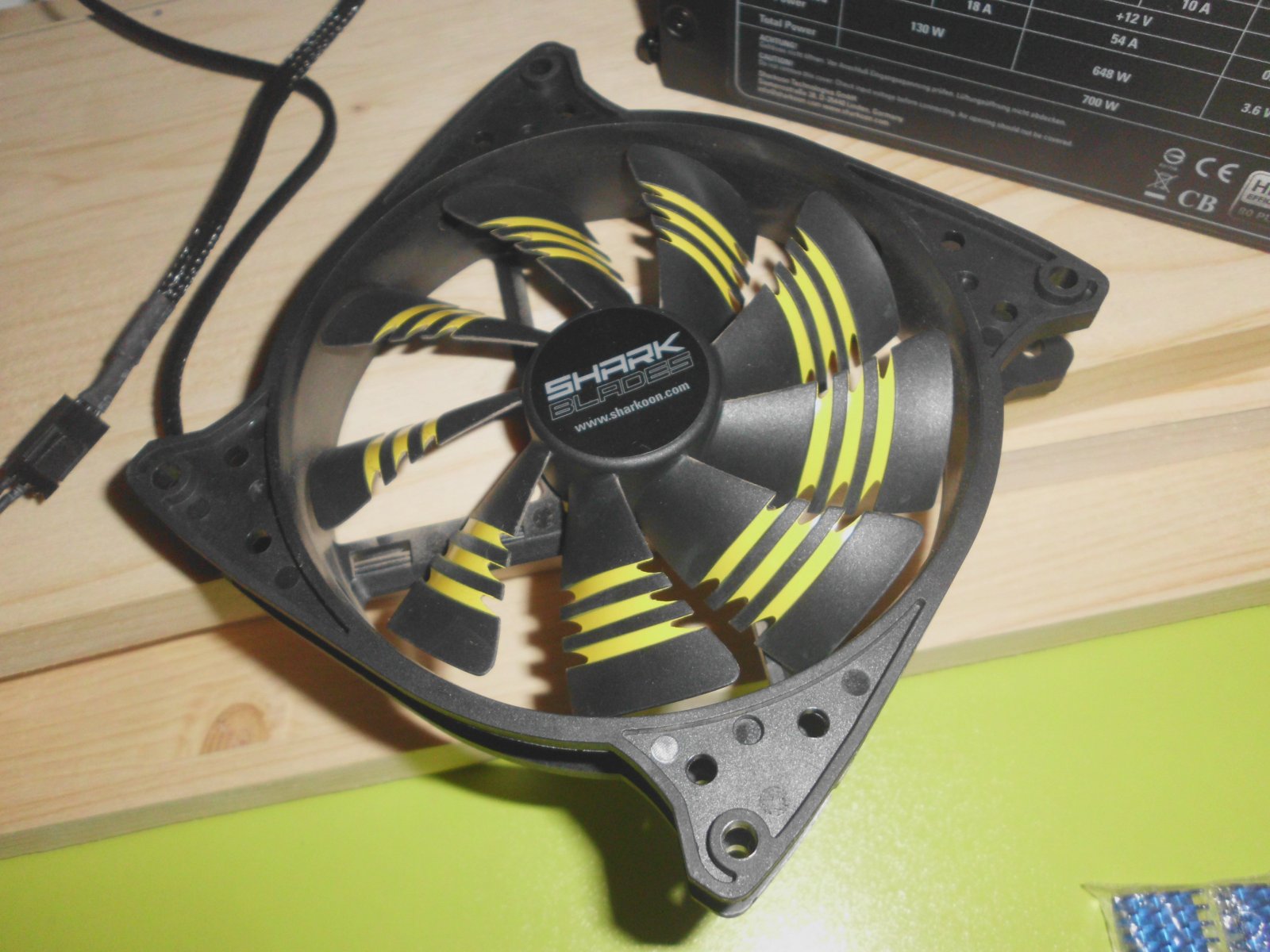

    Hey guys!!! got more things!

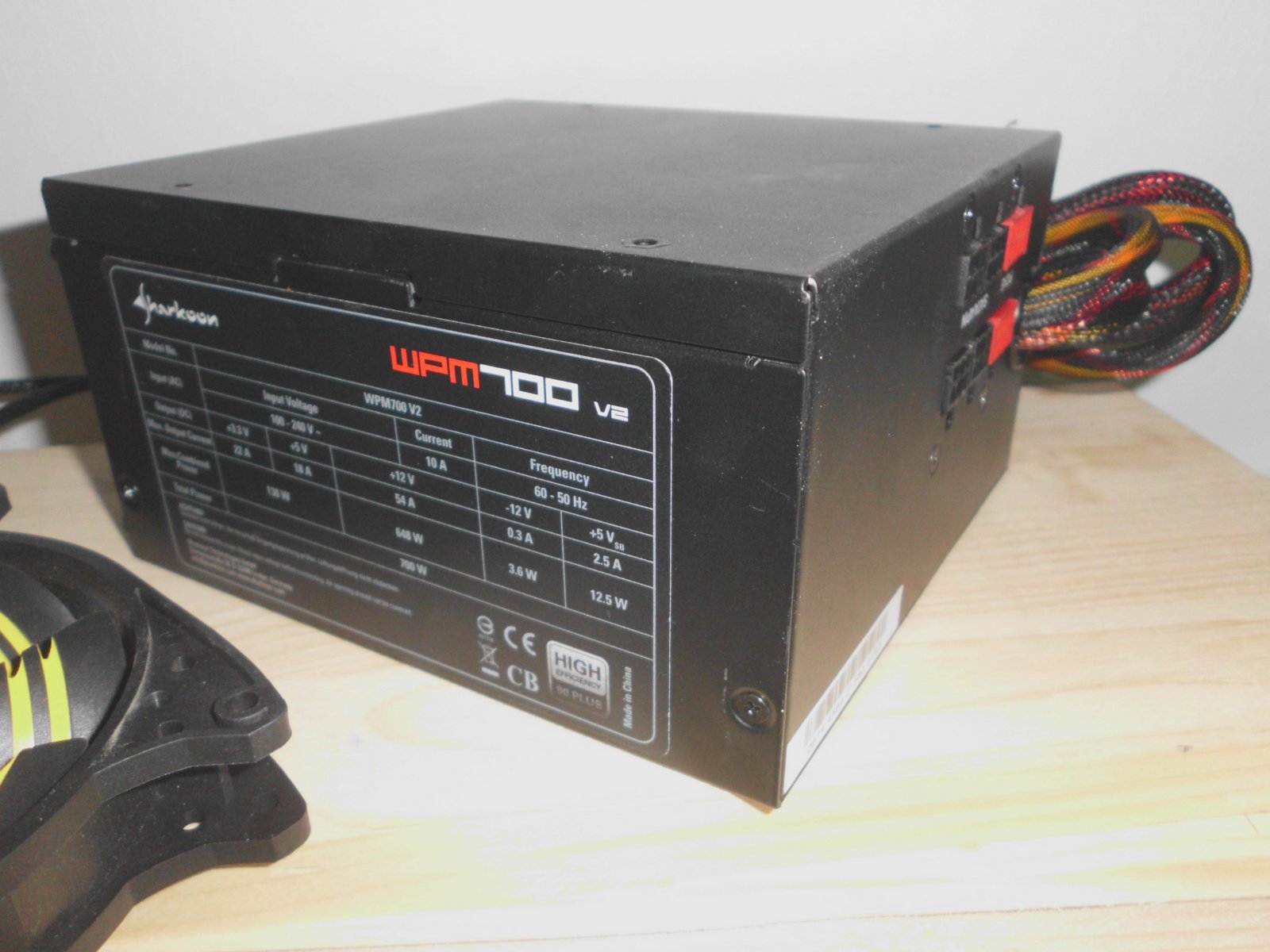

    This is the PSU, 54A @12v modular. Check specs.

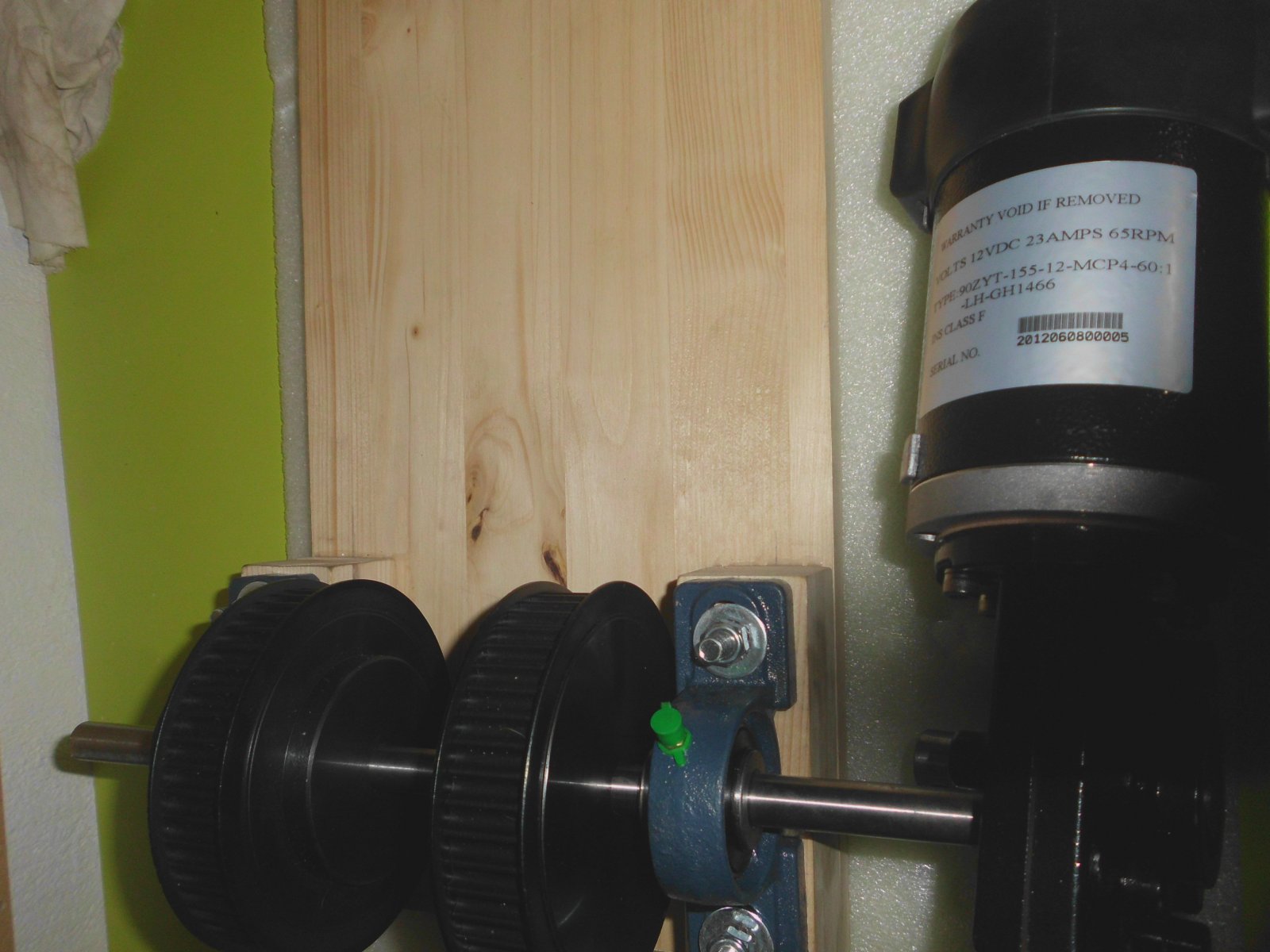

    This is the pulley.
    This is the fan for the small heatsinks for pololu
    And finally, the motor!!!
    Specting to receive the pololu&arduino soon, so I can start trying to program it. Only mechanical addons until that.
    Hope you are liking this.
    Greetings!

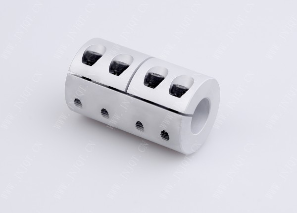

    Hi RacingMat
    The motor has a 20mm shaft, and i have 15mm shafts.
    This connects the motor to the shaft. its a 20mm x 15mm solid coupler. The coupler is on the way.

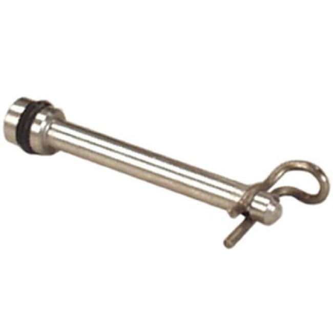

    For pulleys, im going to drill the hub, with the shaft, and insert a retention pin, made of sweet steel. ( 3-4mm ) finished with a key-ring to pull it out, and fixed with thermal glue.
    Something like this, but this is not the exact model i need.
    For that i need to buy a new tool because my drill and my hand is not enough to make this properly. I'm waiting for it.
    Greetings
  17. eaorobbie
    20,491Coins
    +1,687 / 23 / -2
    Yes a metal lathe is handy , I would have turned a shaft to connect it all but do recommend a flexi coupler in between.
  18. CalSim
    CalSim building things
    Jul 24, 2014
    89
    bacteriology analist
    Spain
    1,310Coins
    +41 / 0 / -0
    DC motor, Arduino, JRK
    Do you think a flexible coupler is better? I was thinking on a flexible but this seemed to be stronger and cheaper.
    I Will point it as a weak point so i'm opened to other posibilities. That piece is easy to change.

    Best to have a flexi shaft between the motor and coupling as any small misalignment will stress one or the other bearings etc. Which can lead to a premature failure. Also just my opinion, I have never seen a removable pin used to secure a pulley. Normally a key-way or grub screw is used - depends on application. I actually used both on my heave seat module motor connection. The Key-way to stop it moving on the axial plane and the screw to stop it moving on the shaft. If you haven't already have a look at this video.
