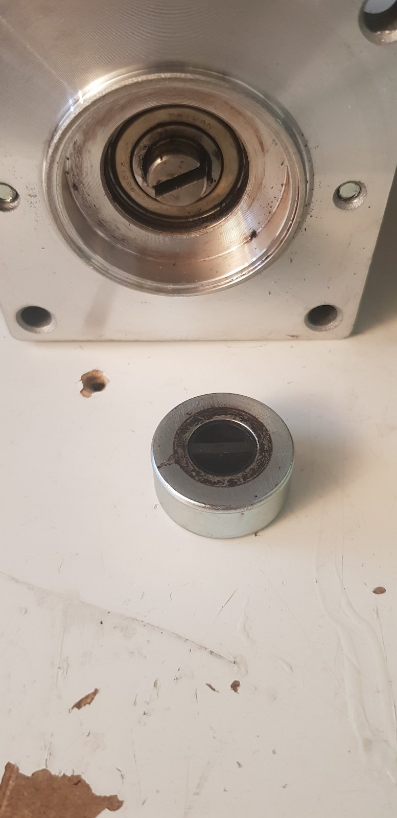

    I got some 24 wheelchair motors at 200w 3700 reduced to 116 RPM on its default gearbox. I'd like to convert and use a linear balls crew guide. Im unsure of the accuracy it will have given that it moves a about 2mm each cog when i turn it. Perhaps a new planetary gearbox 30:1 would be better? What im really after is no backlash or at least as little as possible. Its rather large on these worm gears and as a seat/backrest sway its just to much as i wish to feel all the detail. It dont really need that much torque to move just my body from side to side.
    Its a bit tricky on the shaft but i can make something work if i can find the correct dimensions. Or i can 3d print a bracket. The coupling it has now is actually just rubber and the shaft is protruding 5mm. A pin should be able to sort this out anyhow.
    What do you think?

    Hi
    With one of those sliders and youre motor directly directed to screw, you will get
    1204 screw 70kgf and 24,5 mm/sec at rated motor power
    With a 1605 screw 55kgf and 300mm/sec
    1610 screw 28kgf and 600mm/sec
    hope this helps
    regards Ad

    Check the link on the bottom of the org post.
    Thanks. Good info :) That should be more than enough for the back slider and probably fine for the seat. Will be a 100mm system so 50 each way. The seat wont be resting on the slider table but additional sliders which further helps.
