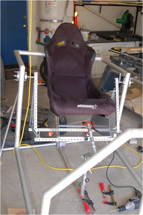

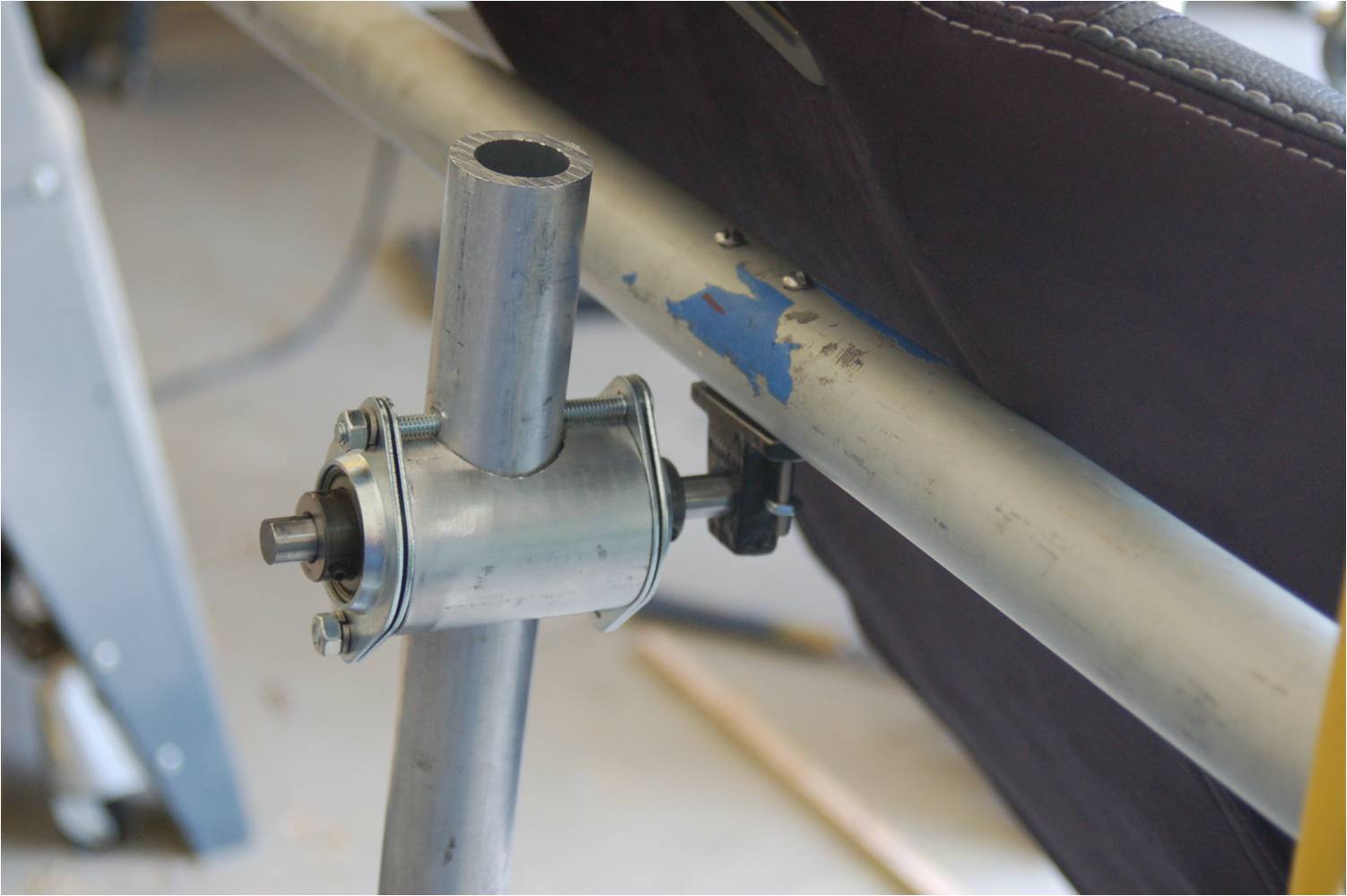

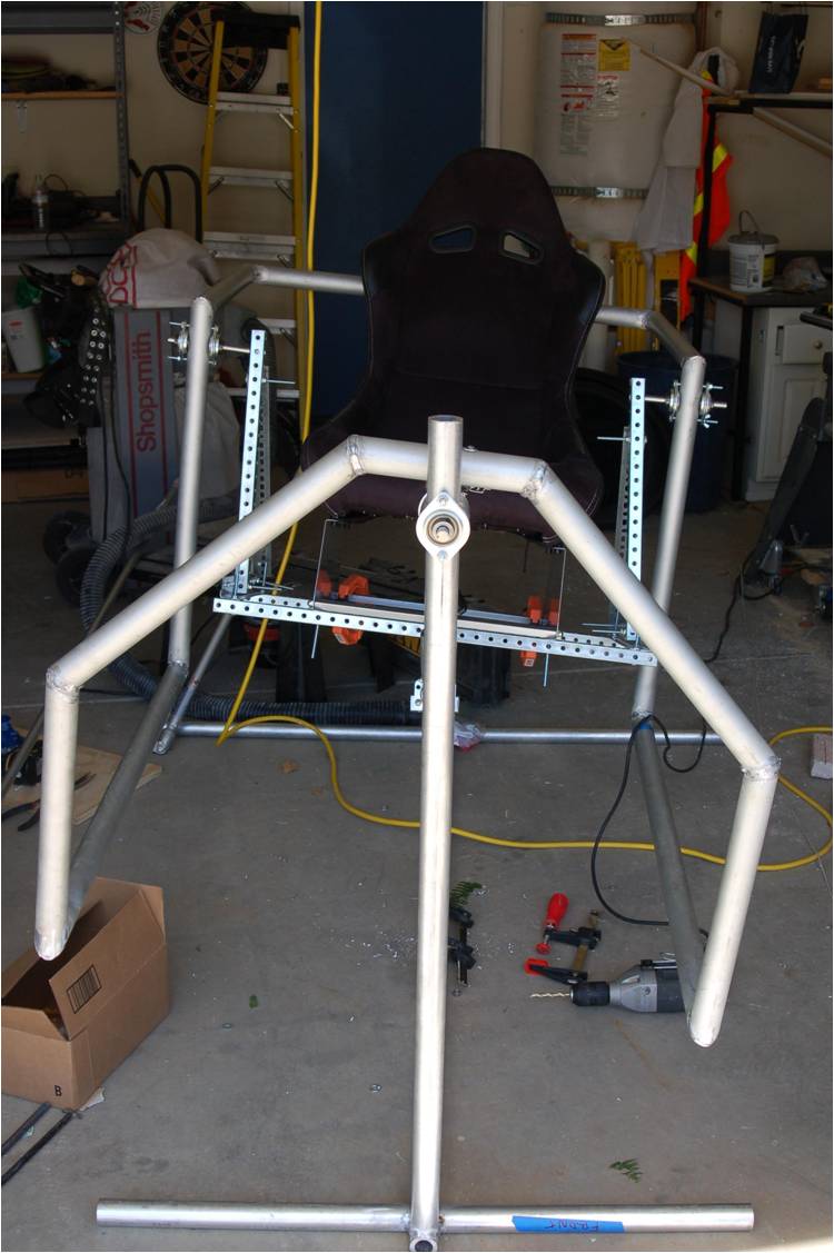

    Here is my project I began about 6 months ago. These are outdated shots already and I will post new ones soon.
    At this stage, most of the construction is temporarily pieced together with bolts/clamps so it looks much cleaner now. I still have supports to add for safety just in case my welds fail.
    The tubing is remnants from an old high school bleacher that I was able to claim, and the same high school allowed me to use their TIG welder, so the frame construction was very cheap.
    I tried to get dimensions based off of the joyrider plans along with production version pictures of mydreamflyer.
    Suggestions welcome!

    The inner frame that carries the seat seems to be too weak. You should replace the hole sheet metal stripes with a welded frame. Actually it seems to bend without anyone sitting in it already.

    yes, I agree. The final product will be the same aluminum welded frame as the rest.

    I like this construction, as it is easier to take place than in the joyrider.

    Yeah, I'm a little clumsy so I wanted easy in/out access.
    If I had to do it over again, I would use a thin walled steel tube (but the aluminum was free) since it would have been easier to weld or I could have bent some sections.
    Also, I am not quite happy with the dimensions - I think I made it too wide for example. But, when I am done I can post drawings of what I did and what I would have done if I had known better.

    Egoexpress is right... you have to do it stronger, my PVC tubes bend like hell while heavy movements. The LCD, the iron structure, the seat... everything adds weight to the total, and probably you will need some counterweight (that adds again more weight...)
