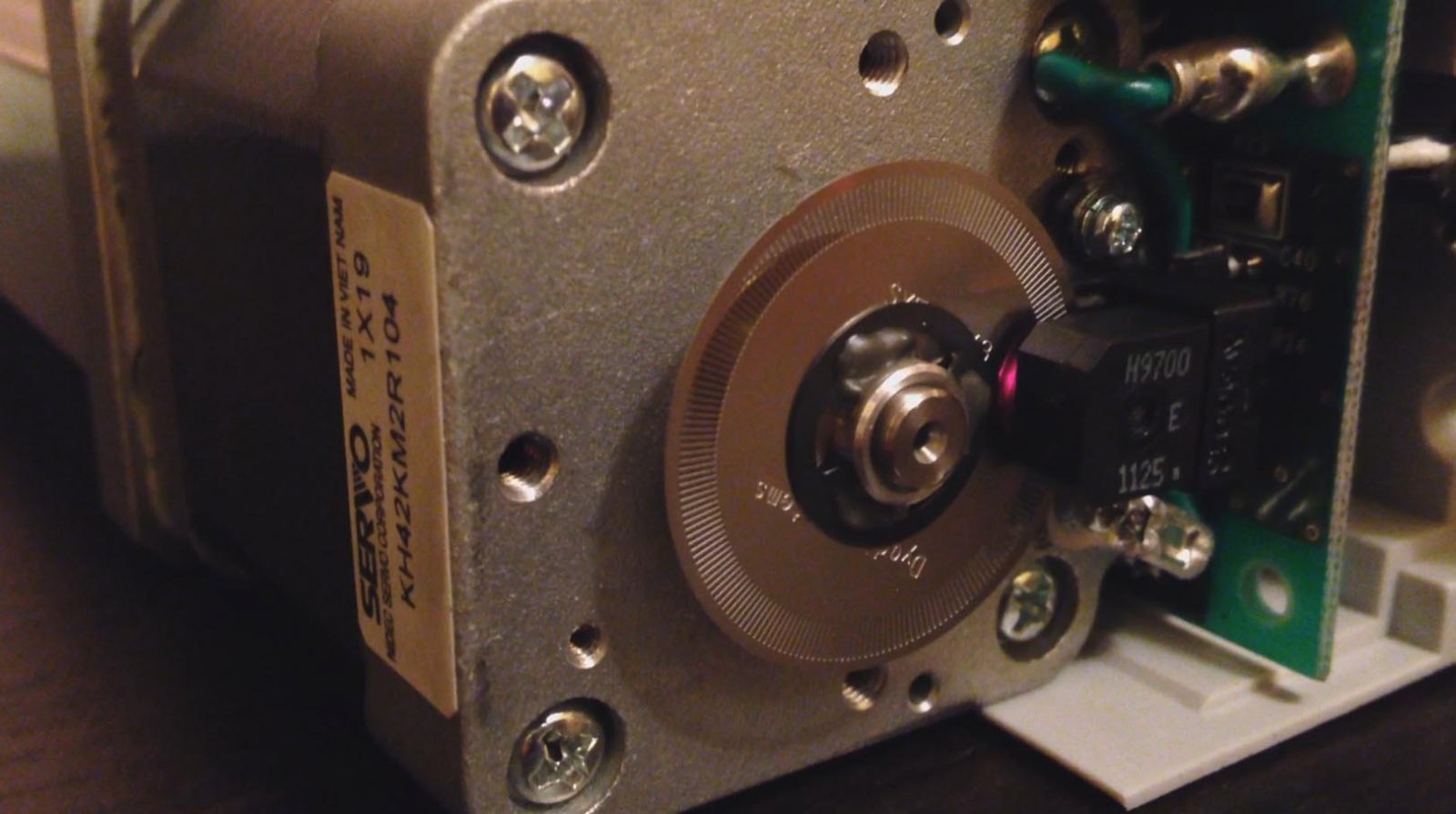

    I think that the main reason for the glorification of SCN5/6 is the "quality" of the movement. I will try to explain myself. Large DC motors are quiter, stronger and with the right lever even faster then a SCN actuator, but one thing is the "power" and another it's the control of the power. Large motor are strong but the have a large mass to stop and to accelerate (on rotation, that make linear movement in SCNs), so when you want that your simulator sticks on the value of the game, it's better to have reactive hardware, and for this reason the stopping and accelerating reaction of SCNs are top level. The second reason is the control precision of the movement. The SCN's sensor unit is VERY precise. Can you see how many holes there are in that wheel (see attachment)? If I turn that wheel from an hole to another I can't even feel any difference on the stroke of the actuator (but there is). That is a sub millimeter (really sub) precision. Sorry if I didn't do the math, it's a value that can be calculated, but I think I made the point. That is the level of precision these things have. If you ask me if this precision is demanded for our kind of application, I would reply that I don't know, I think it's on our opinion of the kind of movement we try to reach.
