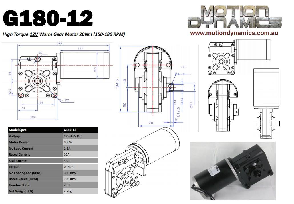

    3 motor i decide to take from au is just difficult project for me i f i complicate more changing something from the step by step video im sure something 'll go bad so... ttp://www.motiondynamics.com.au/worm-drive-motor-12v-24v-200w-180-rpm-20nm-torque.html
    , they sell them in 12 or 24 volt wich one i've to buy ?? 12 0r 24 ?
    also they can put a shaft inside so i dont have to make modification in the hole motor like max and they say: (Please note that the shaft we supply is not a TIGHT fit. There is approximately a 0.3mm tolerance between the internal tube and the shaft.
    If you want the shaft to be a little extra snug, you need it to be ~12.3mm!) best choice for the project ?
    thank you very much and sorry for the begginners questions

    I suspect shipping on the Motion Dynamics motors would be very expensive, locally sourced new or used wheelchair motors may be a cost effective alternative.

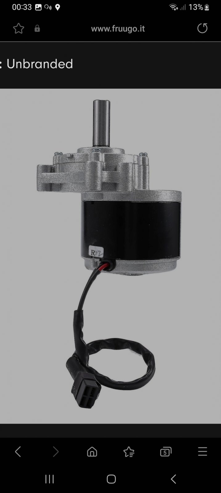

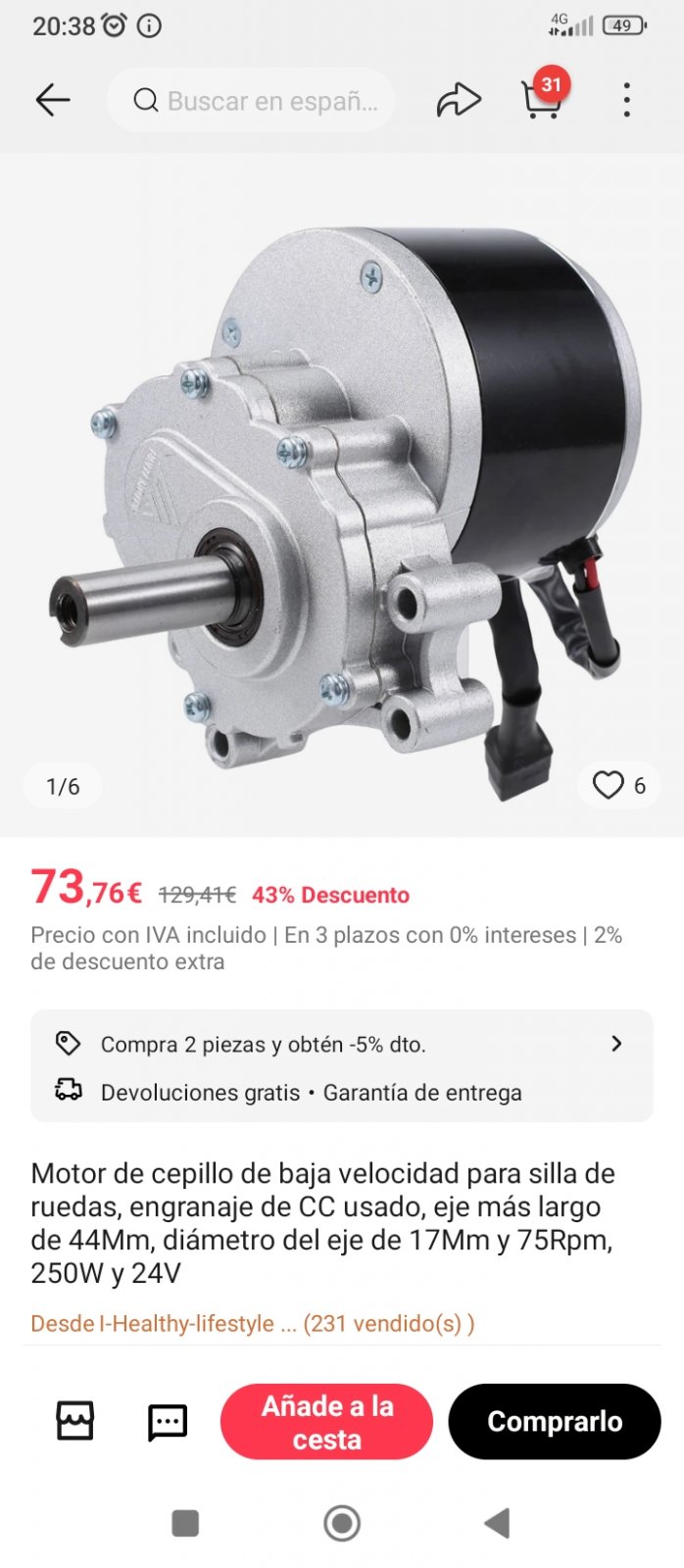

    I found it on alibaba ...all the other staff are right for start ?or im missing something ?
    Last question the motor are 24 volt and im not sure for that motor gear ratio 1:25 or 1:50 they can supply in two option im ordering from china i wanna buy the right one

    Here the motor
  5. Antonio1986007
    Antonio1986007 New Member
    Mar 6, 2022
    24
    - 84Coins
    +8 / 0 / -0

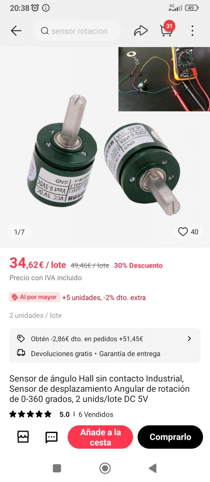

    Hello, the motors seem to be fine, the sensors use 0-5v, I also buy in China, I am from Spain, for me the cheapest option is AliExpress, I will post a photo with the material that has worked well for me

    The ratio depends on the specific design, but as a rule of thumb 25:1 for a shoulder mount seat shaker and 50:1 for full frame or compact designs. I use 60:1 on my compact 3DOF.

    I say on the title the frame and project is the same of d max so 2 gear front and 1 on rear for traction loss ..so is 1 :50 finally ?

    I think you mean @Halloween2go's build.
    If you are not sure then 50:1 is the safer choice.

    Finally ...after about 3 day of speaking with all the world , my china man is missed ...aahahahahah i decide to buy this like Antonio

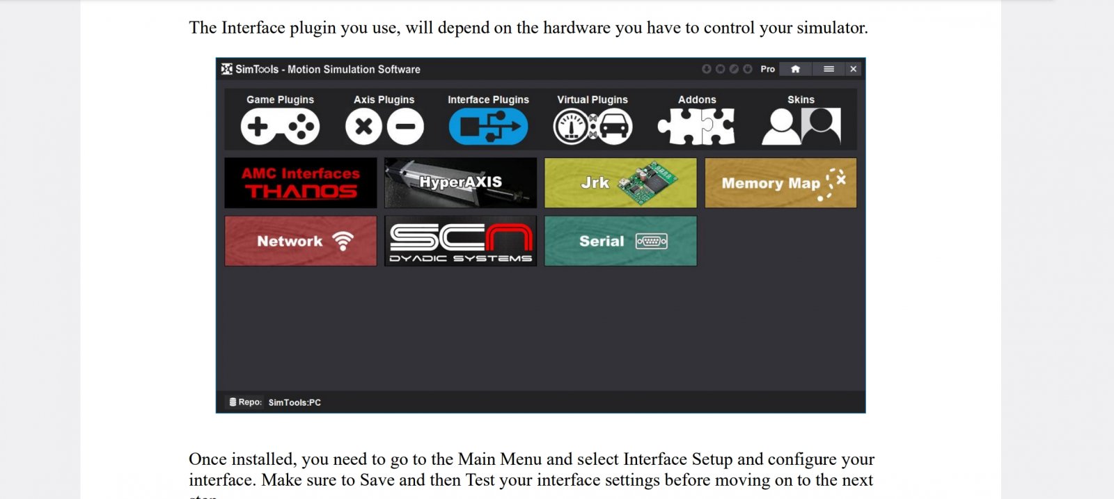

    Sorry guy i was reading the sim tools guide and all the staff, im missing one point because im too beginner
    He say the interfaccia depend on the hardware...
    I use arduino and dc motor wich one i need to chose as platform in this guide photo ?

    If you are using the likes of SMC3 code for the Arduino it will be Serial.

    Sorry guy im missing myself , and i dont wanna stop during setup
    in that point n3 of the sim tool guide he say that the interface i use depend on the hardware i use for to control the simulator once installed ...
    What does it mean ( in the picture there are ...Serial, memory map...etc) i ve to choose one of that or anyone ? Wich is mine ?

    From your earlier post that would be the Arduino controlling the IBT2s you linked to:

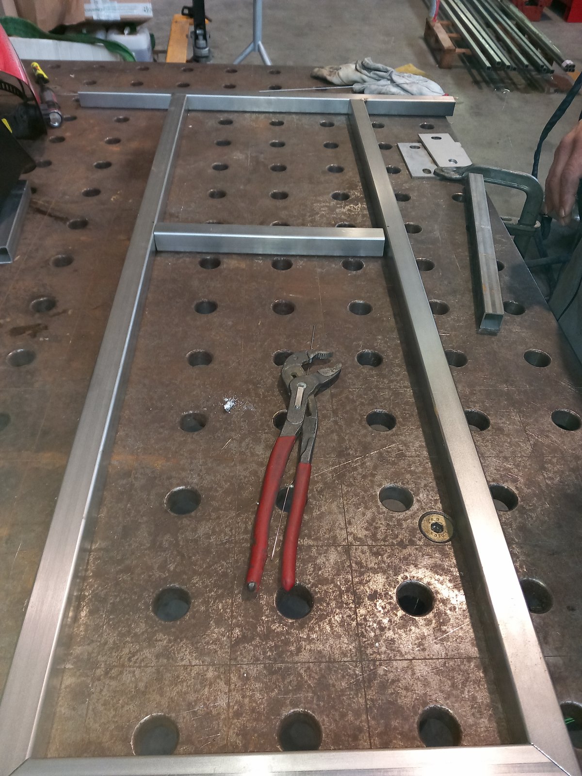

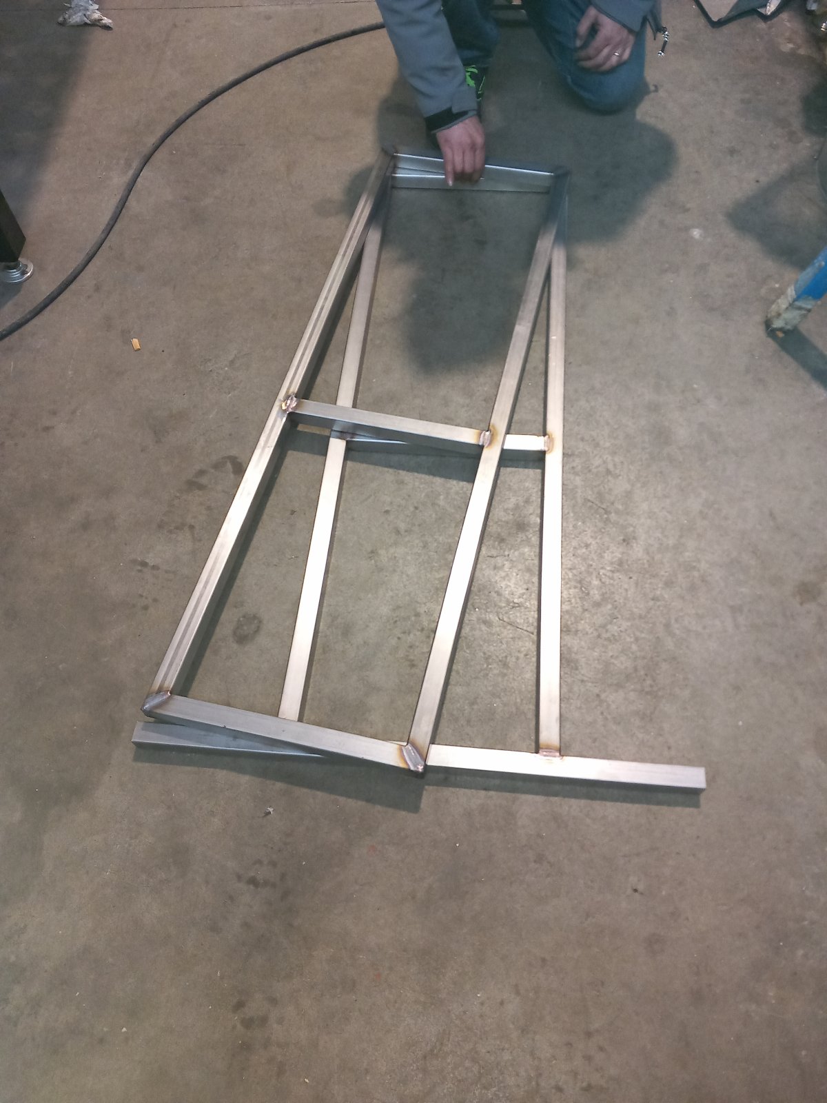

    I upload some progresss ...
