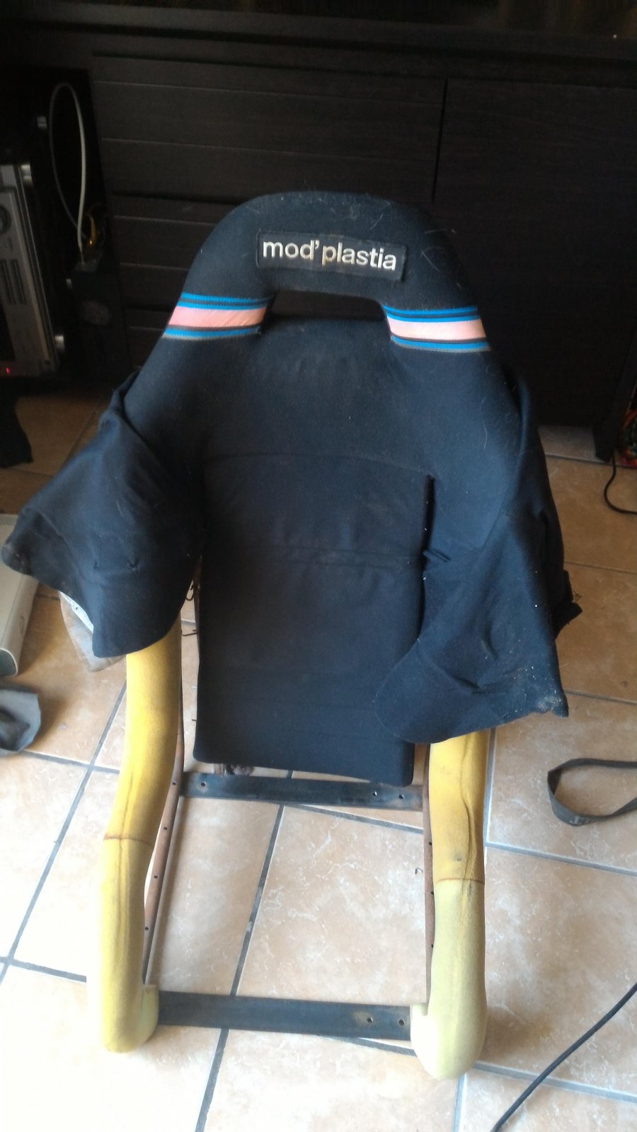

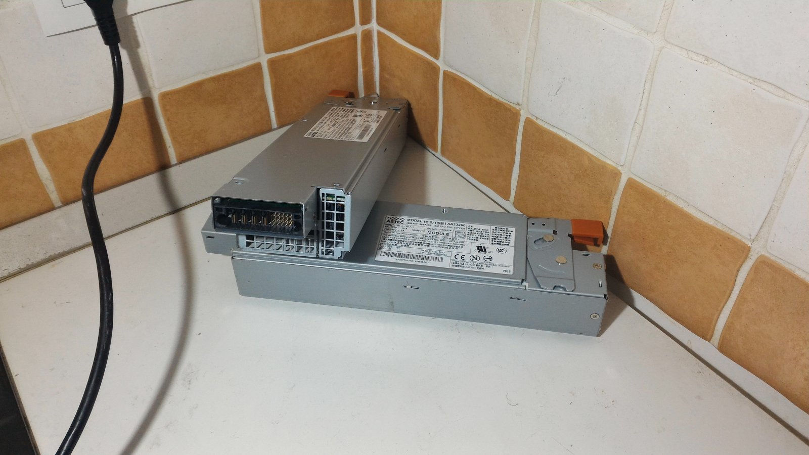

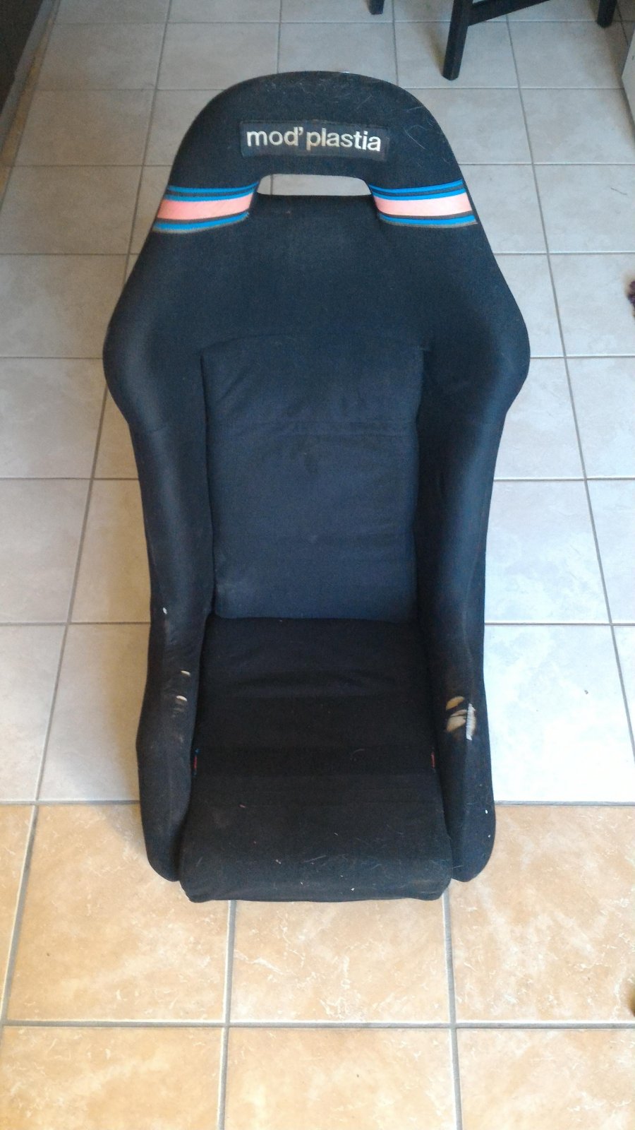

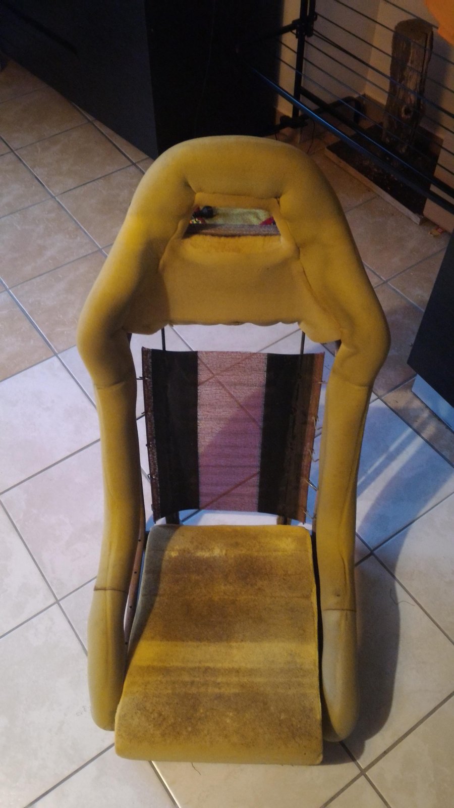

    Hello guys,
    Quick update about the project:
    I have reduced the options for the motor to only two choices N°1 and N°2. One is more powerfull but slower RPM the other have higher RPM but less powerfull.
    I bought to a friend an old seat for only 20€ that I will restore completely (see pictures attached)

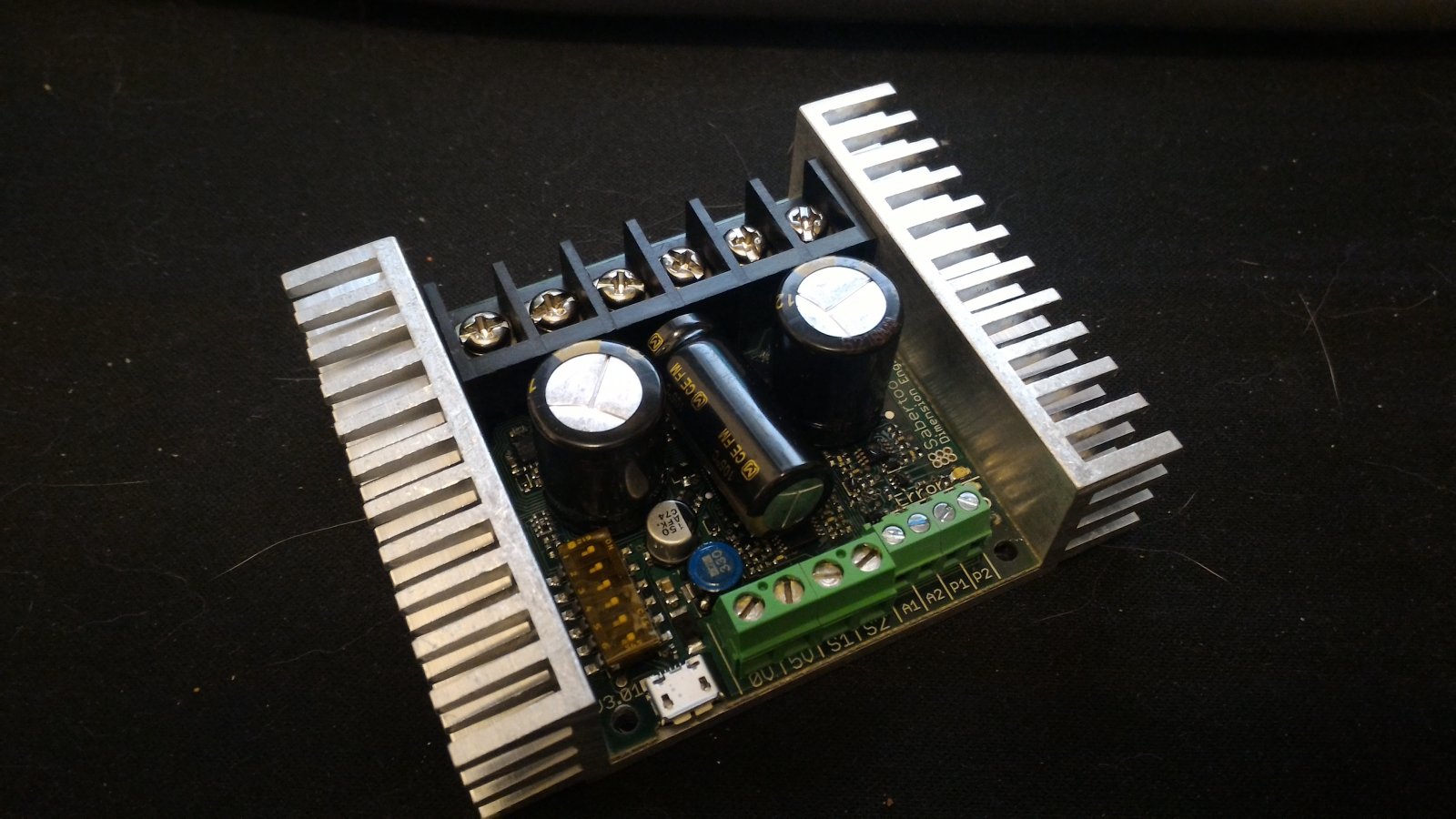

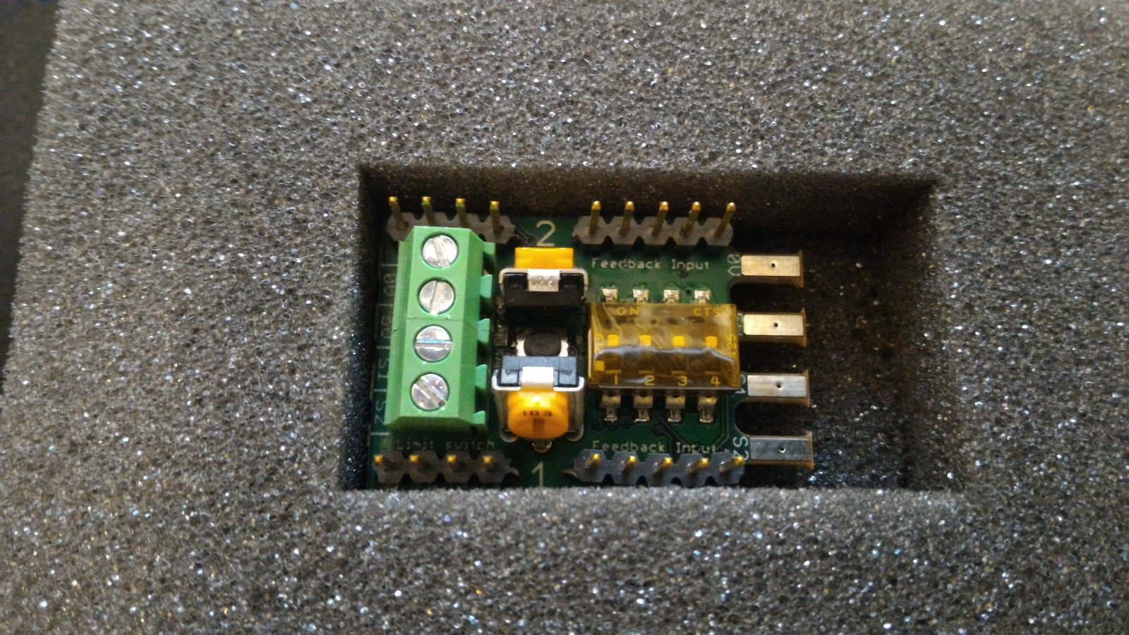

    I received the power supplies. I went with two AA23260 625W since it's the most used in RC. It was 28.5 for both.
    Some electronics parts are on the way, Sabertooth 2x32 (the best choice I guess) Arduino Uno, Kangaroo, 10turn pots, switch limiter. all that for around 200€
    Got a brand new Logitech G29 with shifter for 230€ (thank you amazon black friday)
    I will try to keep track of all the expenses along the build.
    Now I need to make a firm decision about the motors!
    I've tried to use your calculator @mariano68 but I must have f&@%ed up somewhere because the result is that I will get 550 newton, which is ludicrouso_O
    Will be back as soon as I have something to show.

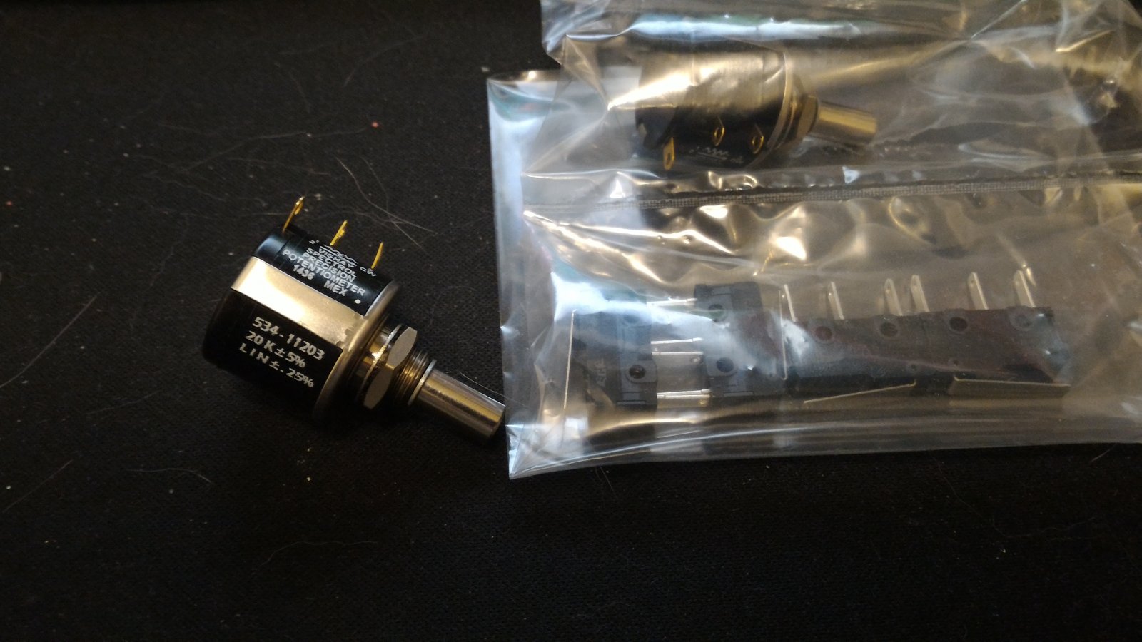

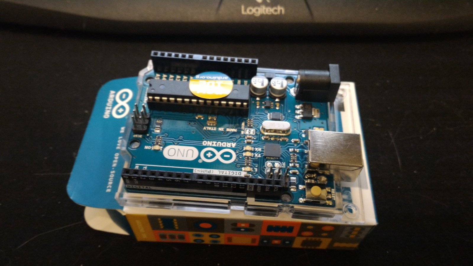

    21
    293Coins
    Really small news: Just received the electronics parts!
    And my god it looks complicated to me:( But I'll figure it out at some point in the future:thumbs
    Now I'll try to order ballscrew and motor before the end of the month.
    I've found somebody to do the seat for me so really happy for that!
    That's it for today, see you.

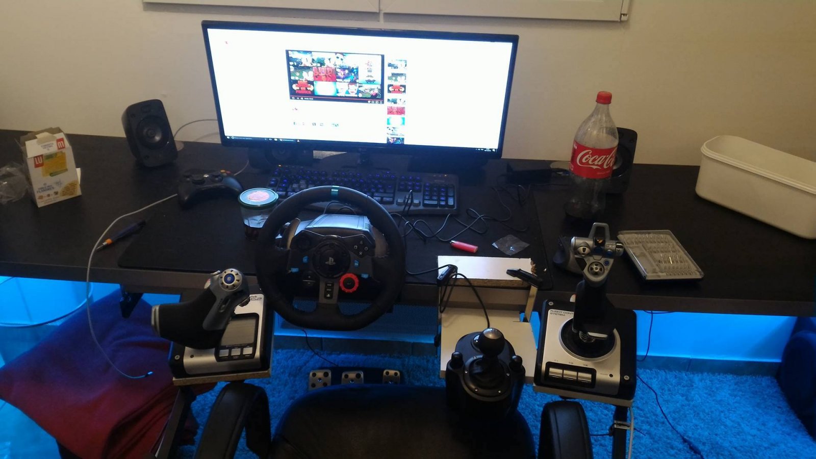

    1 - OJXKS8e.jpg 2 - N1hVxrY.jpg 3 - NsdPZpl.jpg 4 - S5X0lAt.jpg 15515889_1338937959470907_1999064347_o.jpg
    Bonus is my actual "ghetto style" setup
