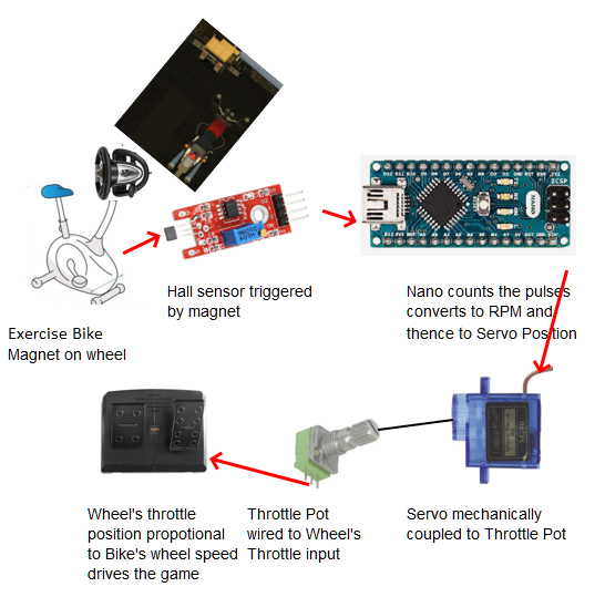

    I have overcome the road block in using the exercise bike’s pedaling speed to control the car/bike driving game. In essence, a magnet attached to the exercise bike’s wheel triggers the Hall sensor. An Arduino Nano counts the pulses and converts it to RPM and thence to Servo position. The Servo is mechanically linked to a potentiometer wired to the Game wheel controller. I used the potentiometer removed from the Pedal of the PXN-VIII gaming wheel (very cheap!).
    I tested this setup with the City Car Driving and it works well. Next step is to add motion. The sketch below shows the set up.
    I will keep posting the details in due course.
