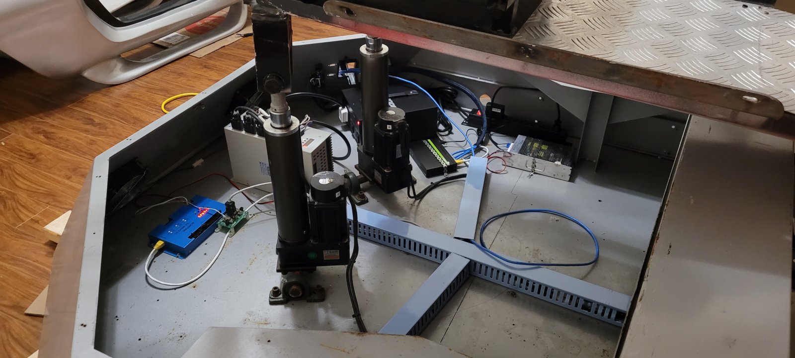

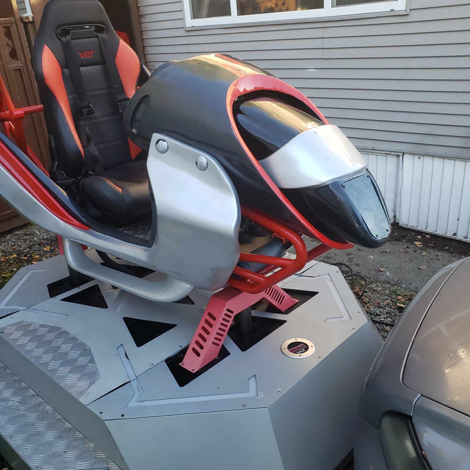

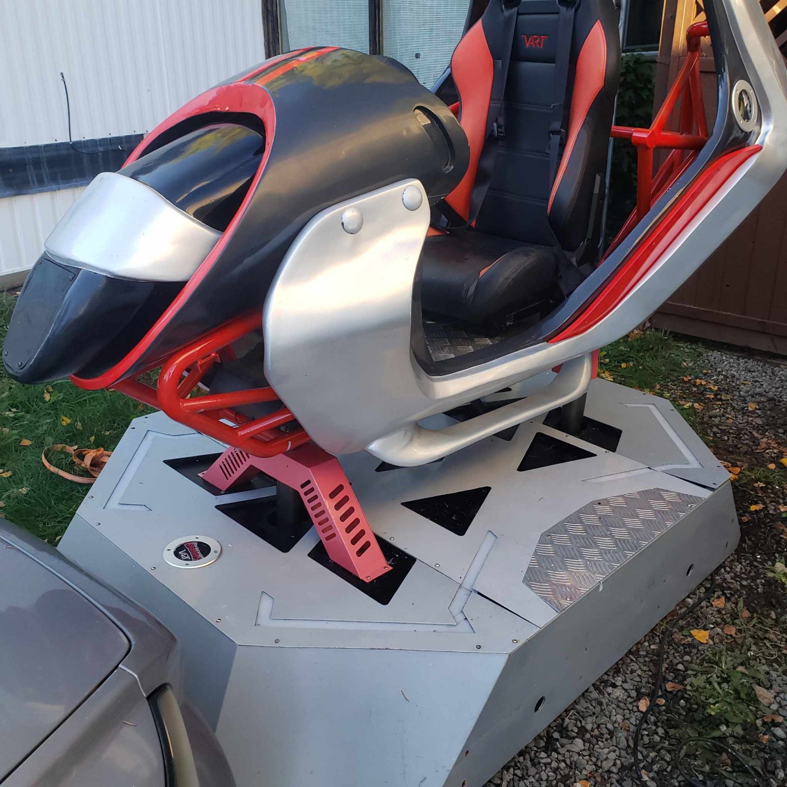

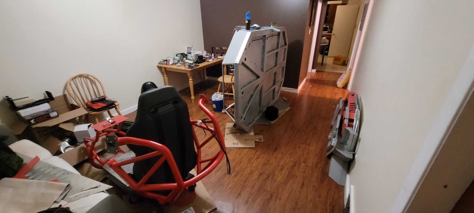

    Picked up an abused VART 3dof. The previous owner got it from a mall after a VR arcade shut down and abandoned their equipment. Got it at a steal, but it had been stored outside for a few months in a coastal region. Had a bit of water damage and interior and electronics where caked in damp dust.
    Loaded the thing up, that took some doing, and brought it home. First thig was to brush it out and wipe it down.
    Cleaned up the electronics next. Disassembling the low voltage poer supplies, servo driver and interface and scrubbed them down with alcohol to remove curosion.

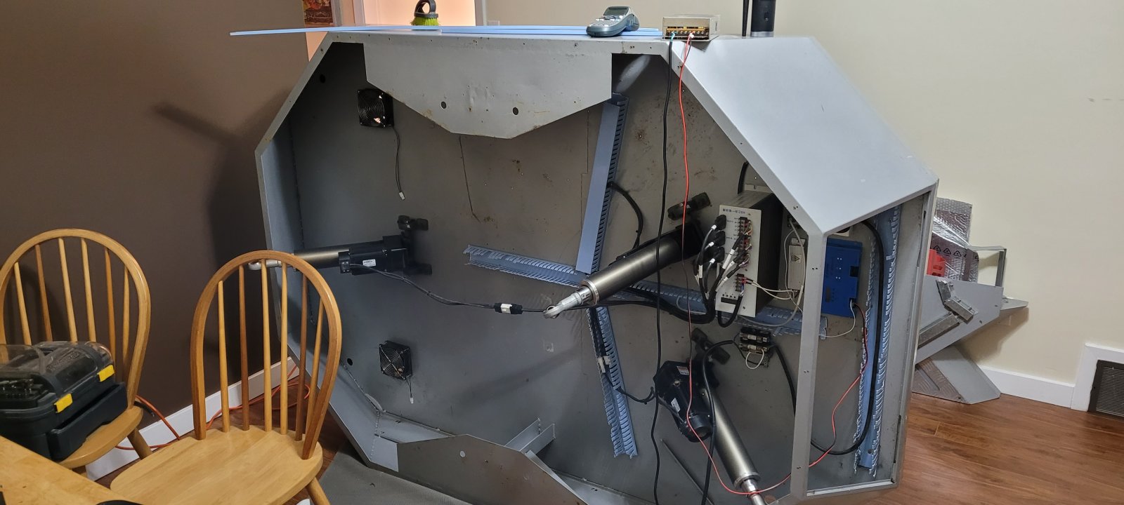

    All the low voltage equipment was switchable 110v / 220v so I could run it no prob on my 120v 60hz home electricity. The servo driver however is AC 220v 50hz, so with a line filter and some very scary wiring I placed it all in the shell and temporarily wired. Everything powered up and the servos homed to start position. This is when I came here after exhausting myself trying to get software from the Chinese manufacturer or one of their resellers.
    @yobuddy and @noorbeast were immediately helpfull and with some back and forth and plenty of testing we got a SimTool 3 interface plugin for the SC-MBOX / MD-MBOX interface.

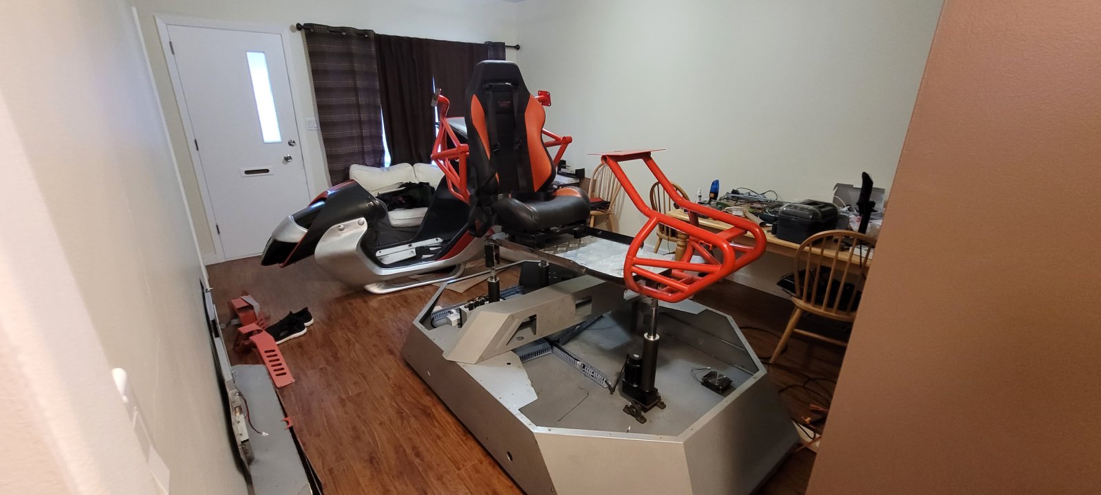

    During this back and forth I dropped the frame and mounted the cockpit.

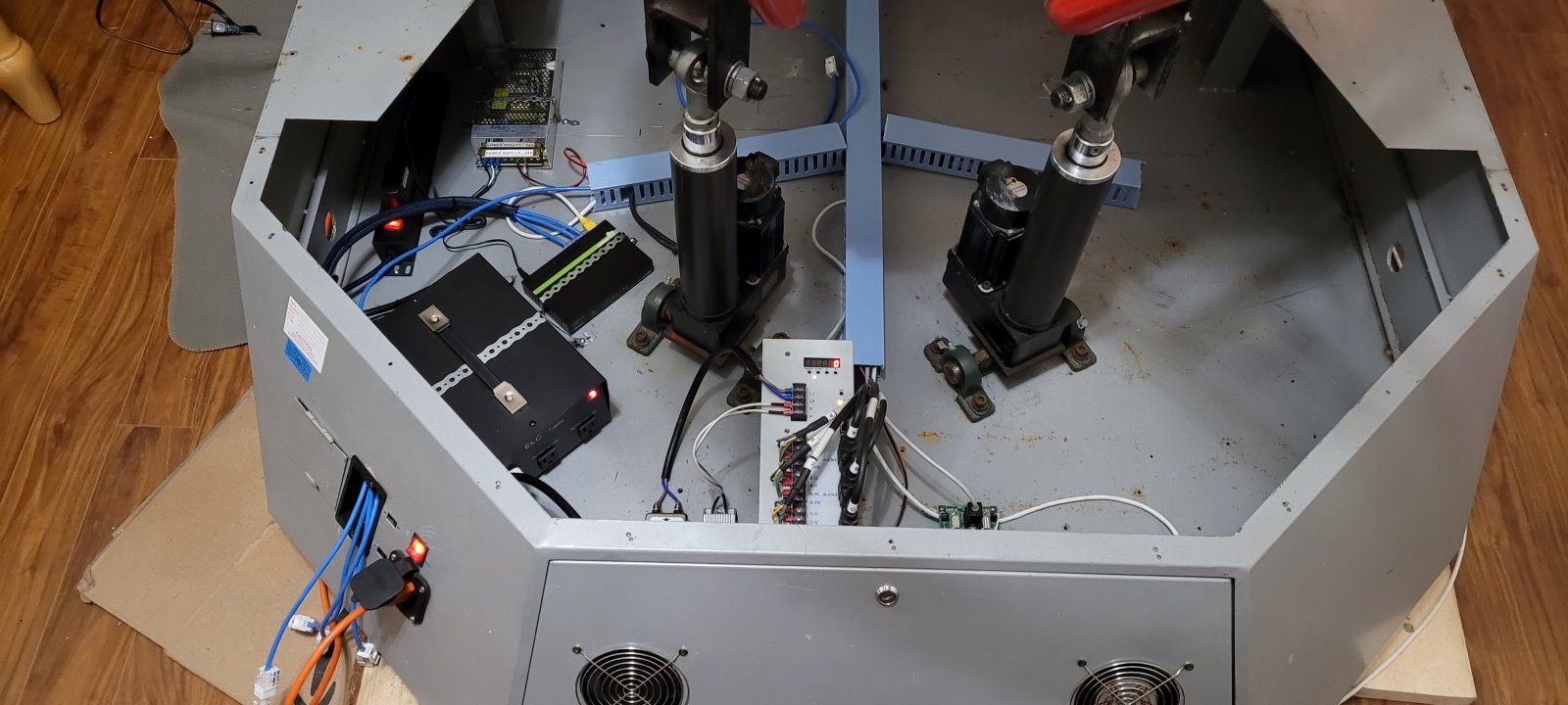

    Just recently we nailed down the interface plugin settings. And with the arrival of some parts I ordered I whent to work re mounting and re wiring the electronics. Now just waiting on a face plate to mount the network ports.
    Probably whent over board with the onboard switch and accompanying ports, but this way I can run it as it is now, wired to remote pc, or drop an onboard rig in, or connect to rear with laptop for testing. Have 1 network port seperate for USB over ethernet extender to run remote periferals. Now just need to figure out mounting solutions for e-brake, shifter, throttle and stick.
