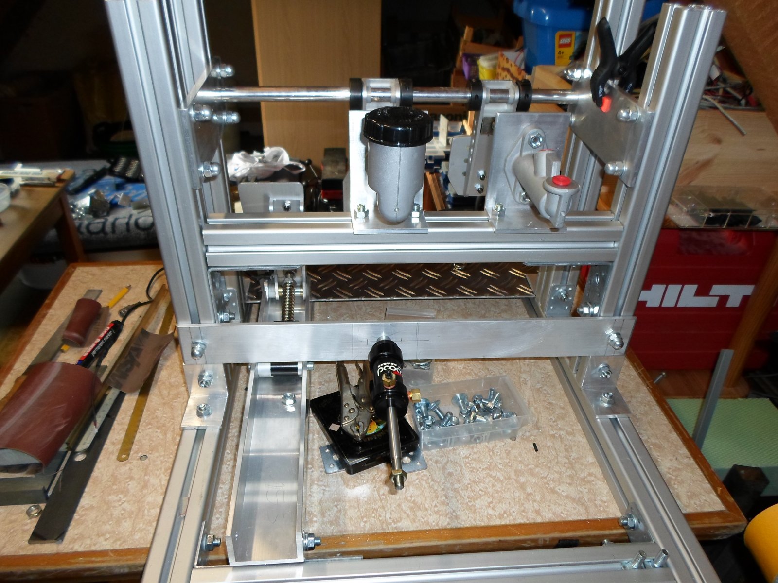

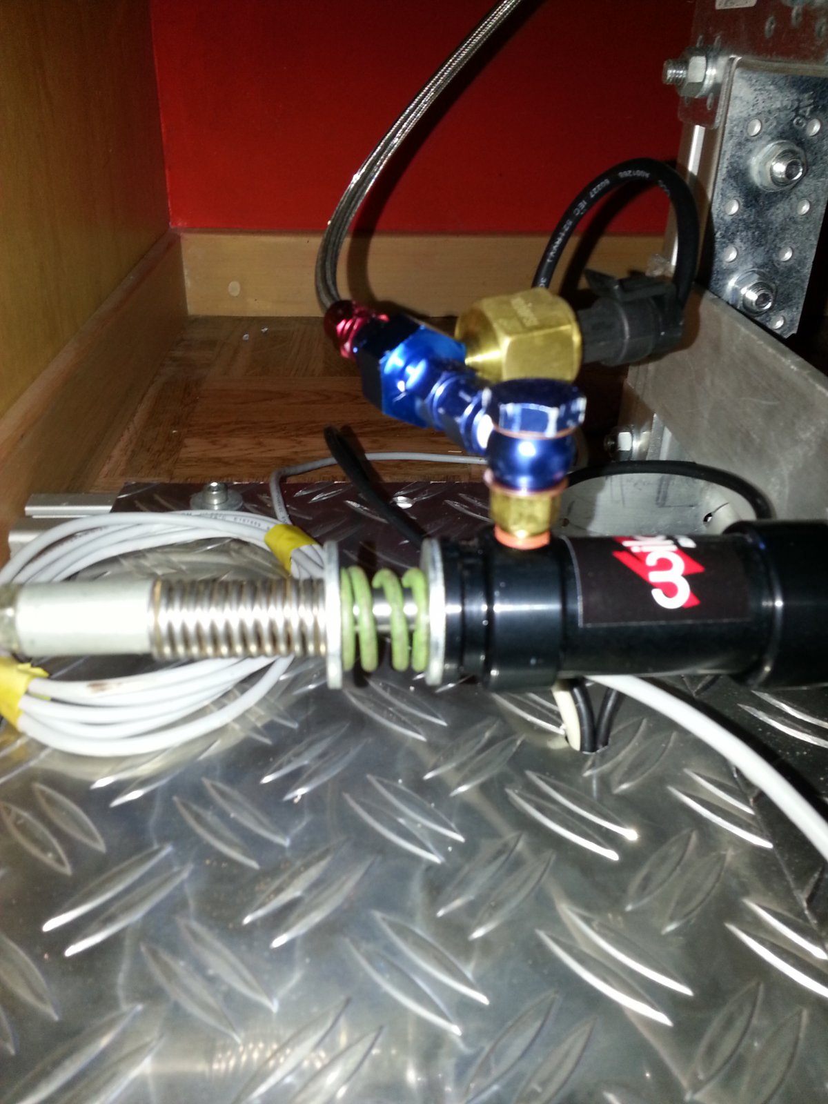

    hi all,
    after 3 month of working around on my hydraulic pedals they are already finished.
    at this point a big thanks to tommy06 , who is helping my along this cool project.
    for total partlist watch tommy thread http://www.xsimulator.net/community...d-hydraulik-pedals-stockcar-nascar-dash.3277/
    very good explained and illustrated!!!!!

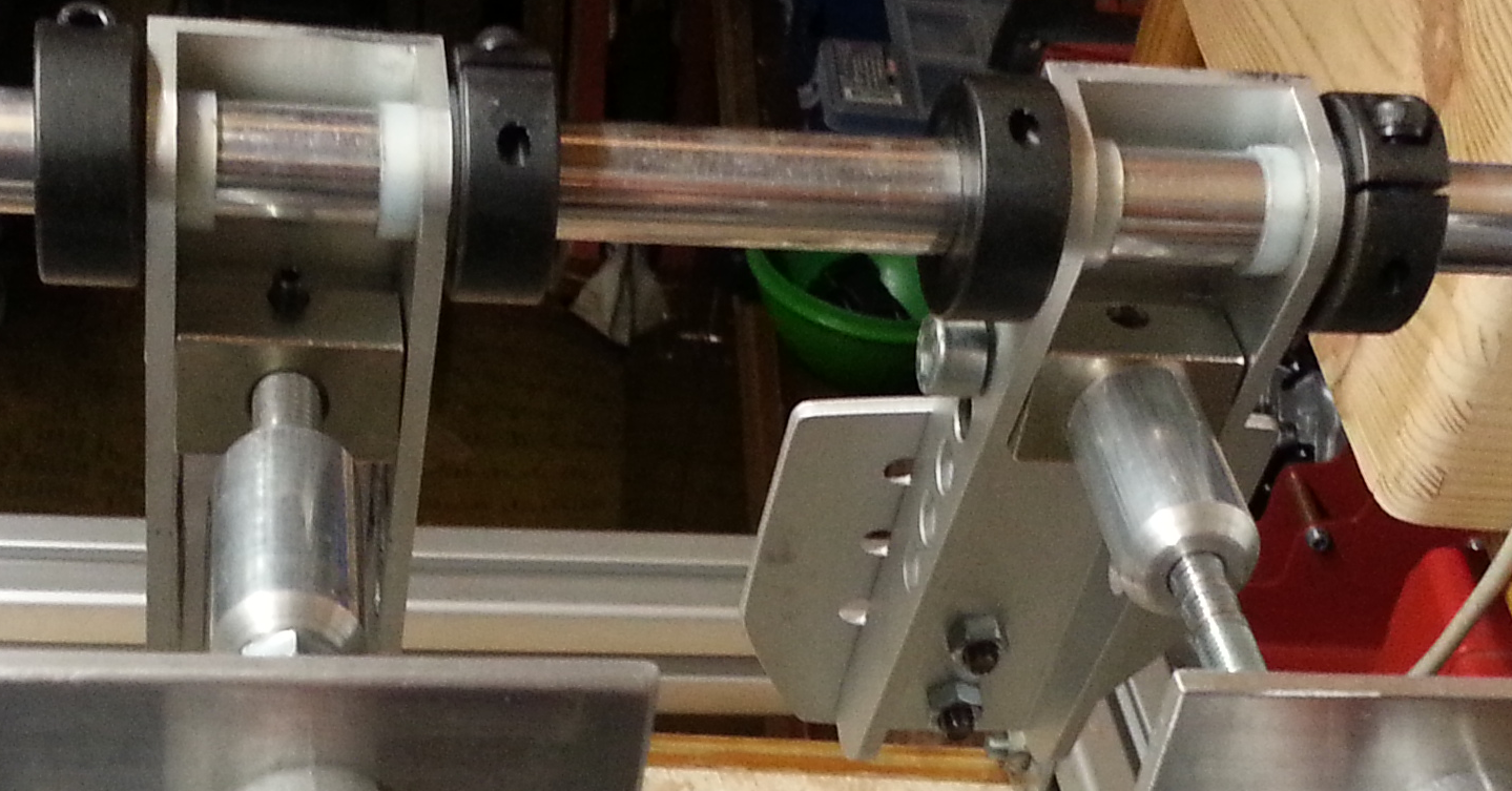

    after 4 years of racing with the good old csp from fanatec i decide to modify this pedals with a hydraulic clutch and brake.

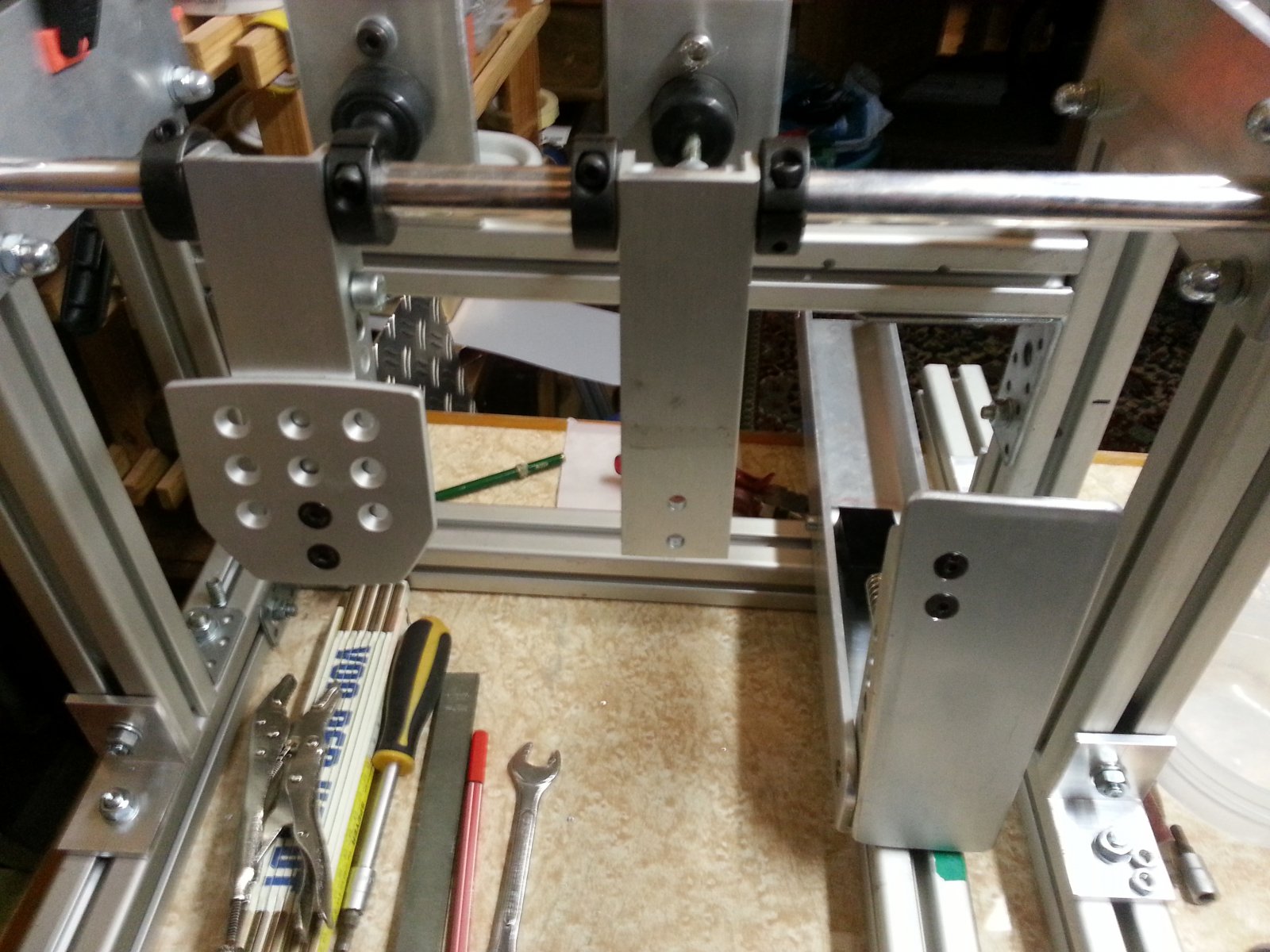

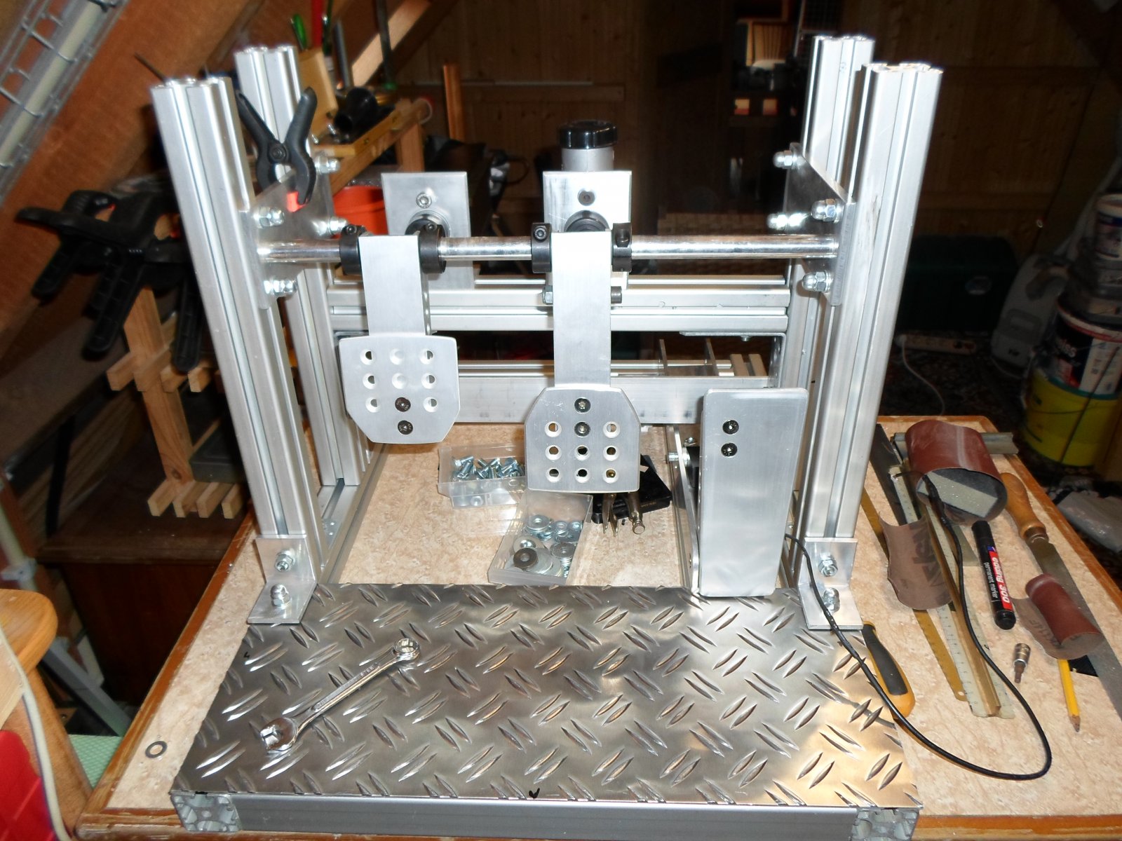

    starting with stand of 4cm x 4cm aluminium sqaure i order the other aluminium parts here: https://www.aluminium-online-shop.de/de/shop-aluminium-kleinstmengen/shop-index.html
    ->round rod with 16mm diameter (same as the csp use)
    ->10mm x 80mm falt rod for holding the round rod on both sides
    -> L form aluminium 5mm x 100mm x 50mm for mountig the mastercylinder brake and clutch
    -> u form aluminium 5mm x 50mm x 60mm for the throttle
    -> 5mm x 50mm flat rod for mountig the slavecylinder
    ----> the length of all the alu parts depends on your own needs<----
    for the cylinders and the fitting parts you can look for tommy thread.
    for holding the pedals in place i watch here for the lock rings(black ones pic below) https://www.maedler.de/Article/62311600
    the adapter (m10 thread on m8 thread) for connect mastercylinder and clutch/ brake pedals i got from a buddy at work.

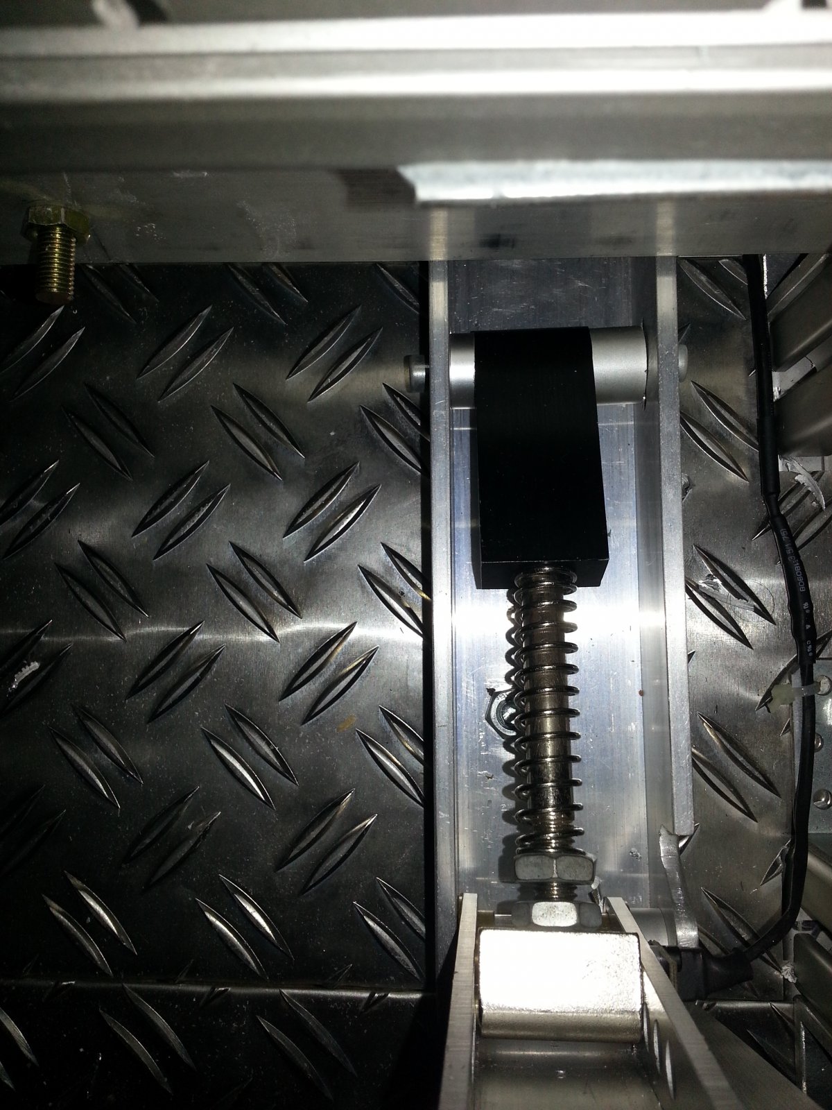

    left and right on the round rods i drill a m8 thread( clutch and brake) also for the throttle.
    because the big lock ring wont fit in the u form aluminium, i go the fanatec way with some matching sized tubes.

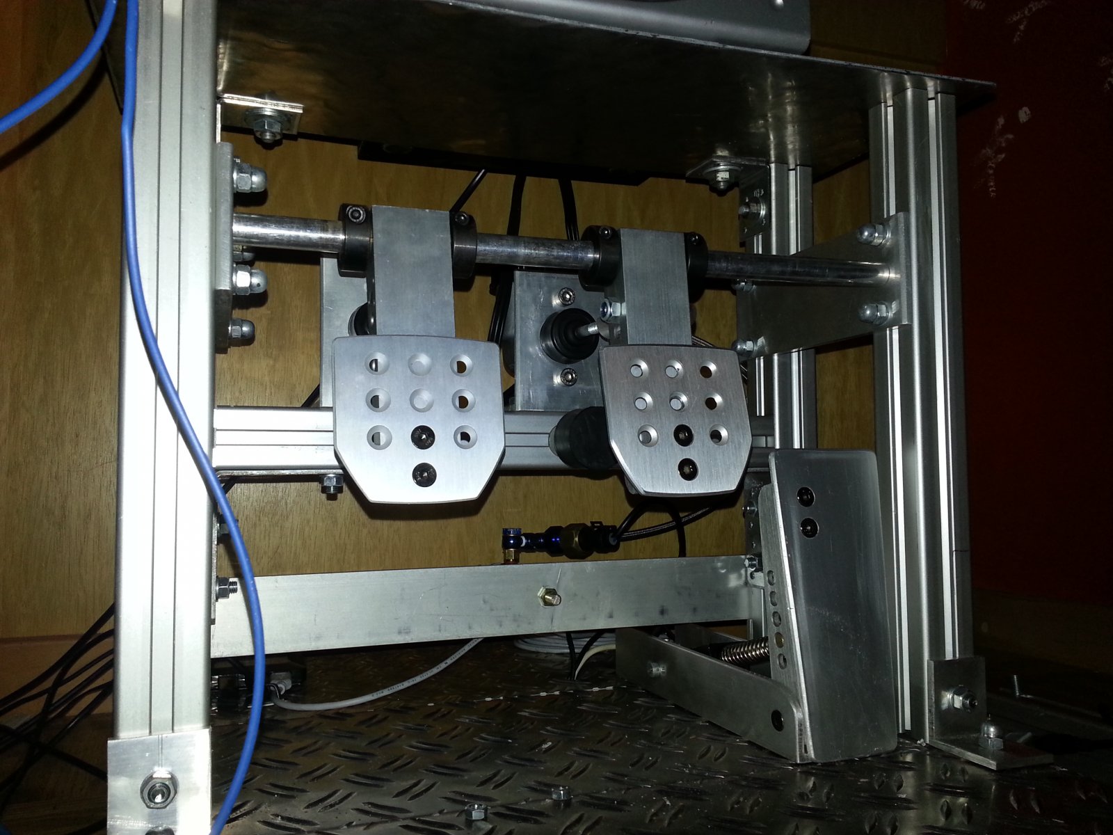

    for electroic i use a leo bodnar board for the pressure sensor, throttle and clutch drive with the fanatec board.
    for the full usage of the fanatec board i mod my handbrake withe the load cell from the old csp brake.
    slavecylinder and fittigs for the clutch are already ordered and wait for assembly.
    the clutch/ brake pedals can be use hanging and standing. all pedals are free adjustable in distance and height.
    since three days i test the pedals on my rig. after that i paint some parts. pics followed.
    short presentation of my pedals. if you have any questions feel free to ask.
    best regards
    seppel
