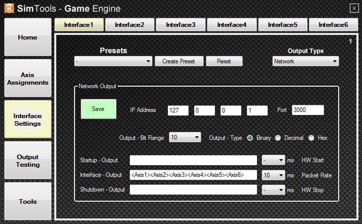

    No output interface yet. I will built my own serial or maybe usb.
    For now just trying to get and understand values.
    But I could not managed to see any data eventhoug I ve read the maual.
  4. yobuddy
    5,375
    50,307Coins
    +5,149 / 18 / -0
    Without an output interface SimTools is smart enough to realize it does not need to do anything.

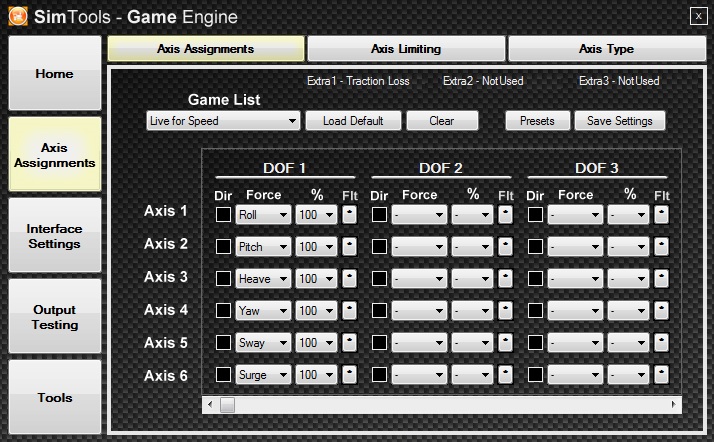

    Lets give it some settings so that you can see stuff happening.
    First lets give it an interface.
    Use the NET output type and use these settings. (be sure to save)
    Now settings for LFS in the axis assignments. (be sure to save)
    Now if you have patched the game (I believe you have if your getting a blue banner) you should see it work then next time you run the game.
    btw, with LFS, you must be in first person view in the car
    If you haven't read the manuals yet, they hold a lot of good info!
    http://www.xsimulator.net/simtools-game-engine/
    http://www.xsimulator.net/simtools-game-manager/
    hope this helps!

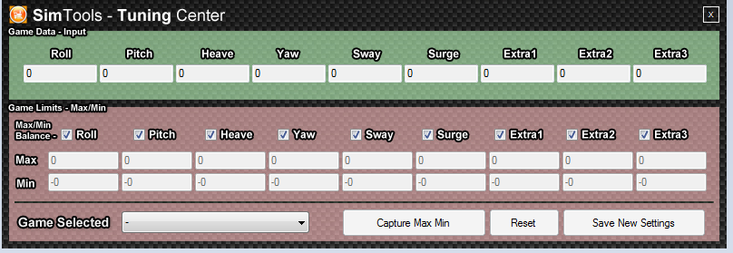

    There is program named "Game Engine Tuning Center" when I press ALT+TAB. But It is not reachable.
    What is this? I click 2 icons but 3 programs running.

    When started the SimTools Game Engine minimises to the system tray. If you right click on its icon in the system tray you can open the Settings and Tuning Center from there.
  8. insanegr
    insanegr !N$@n€
    Jan 14, 2014
    504
    Athens
    16,721Coins
    +499 / 1 / -0
    @yeniuser right click on game engine icon near the clock
    tuning center is a "feature" inside game engine.
