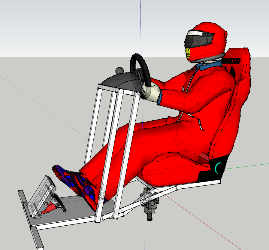

    BSFT, how do you feel about the Foot Motor Mount vs the Full Frame Mode Seat Mover here? I'm leaning toward the Foot Mount Motor design. Here's my rough design as of now. I don't have the motors in, but I was going for the end of the pedal platform, on those arms sticking out...
    The material I have in abundance (for basically free) is 1" x 1" O.D. square steel tubing.
  7. bsft
    wipers will do the job to start you. The long distance from the pivot is excellent leverage and a good place if you do not have the room behind you for shoulder mount and also the overall width needed for a full frame. With the wipers, leave the standard arm as a longer one on it will strain the wipers. So you will have short sharp motion.
