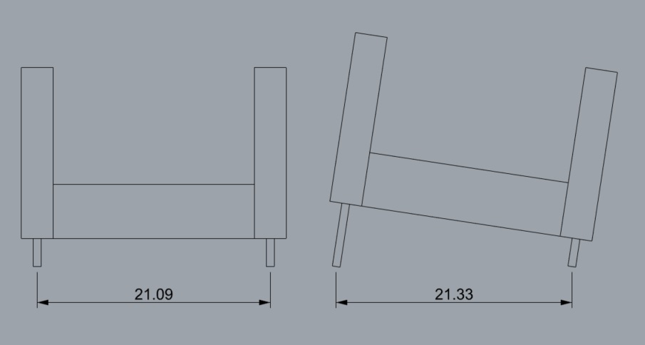

    I was thinking fixing the actuator legs to a frame at ground level which is slightly wider than the main sim structure may help with stability..
    Using the 4th motor on a lead screw design may serve me well for a push/pull surge function..?

    Instability can be solved a lot of ways. I currently solved mine by lowering the intensity of motion in the sway/roll direction. You could make your frame wider than mine, or your actuators shorter than mine, etc.
    My future idea is to flip the actuators upside down and attach them to a bottom frame. This not only takes the actuators weight off the moving part of the rig but it also allows me to attach the actuator high up on my rig so the center of ration is closer to the center of mass.
    I think this is a win because right now with the center of rotation below the rig, any pitch or roll feels like surge or sway. I want to make a g-seat for my rig so I'd rather feel pitch and roll vs surge and sway from the motion platform. This would definitely solve the instability, but I need to change the actuator to a folded design because it would all be way too tall otherwise.
    You might have trouble attaching the actuators directly to a bottom frame. The legs move quite a bit during rotations.

    Sure but its not just the angle of the actuator that changes. The distance between the actuators change too, so there will some amount of bind in the actuators.
    Maybe not enough to matter, especially for small angles. Perhaps not a deal killer. It will be an experiment.
    You also need to deal with the sfx design not being a push pull actuator. Because if the rig wants to tip over it can just pull the steel rod right out of the actuator on its way over.

    I see what you mean with the distance variation between actuators through movement. That hadn't occurred to me...
    Will take some creative thinking and experimenting for sure.
