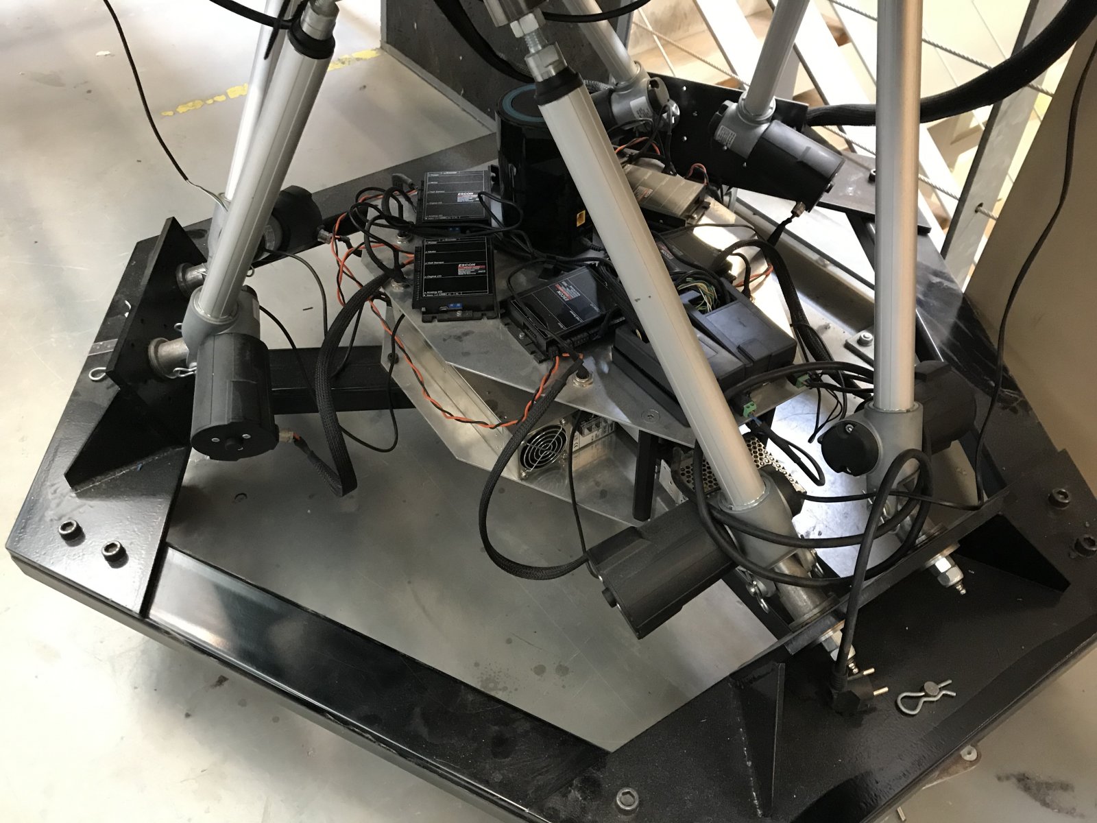

    Hi guys!
    I have gotten the opportunity to take over a 6dof motion platform that has been standing in a corner collecting dust for a few years now.
    Obviously I am very excited, but a bit worried that I have gotten in over my head.
    It has been working, but now there is noone with insight in the arduino code or Simulink model that comes with it.
    My idea is to convert it for using with SimTools instead.

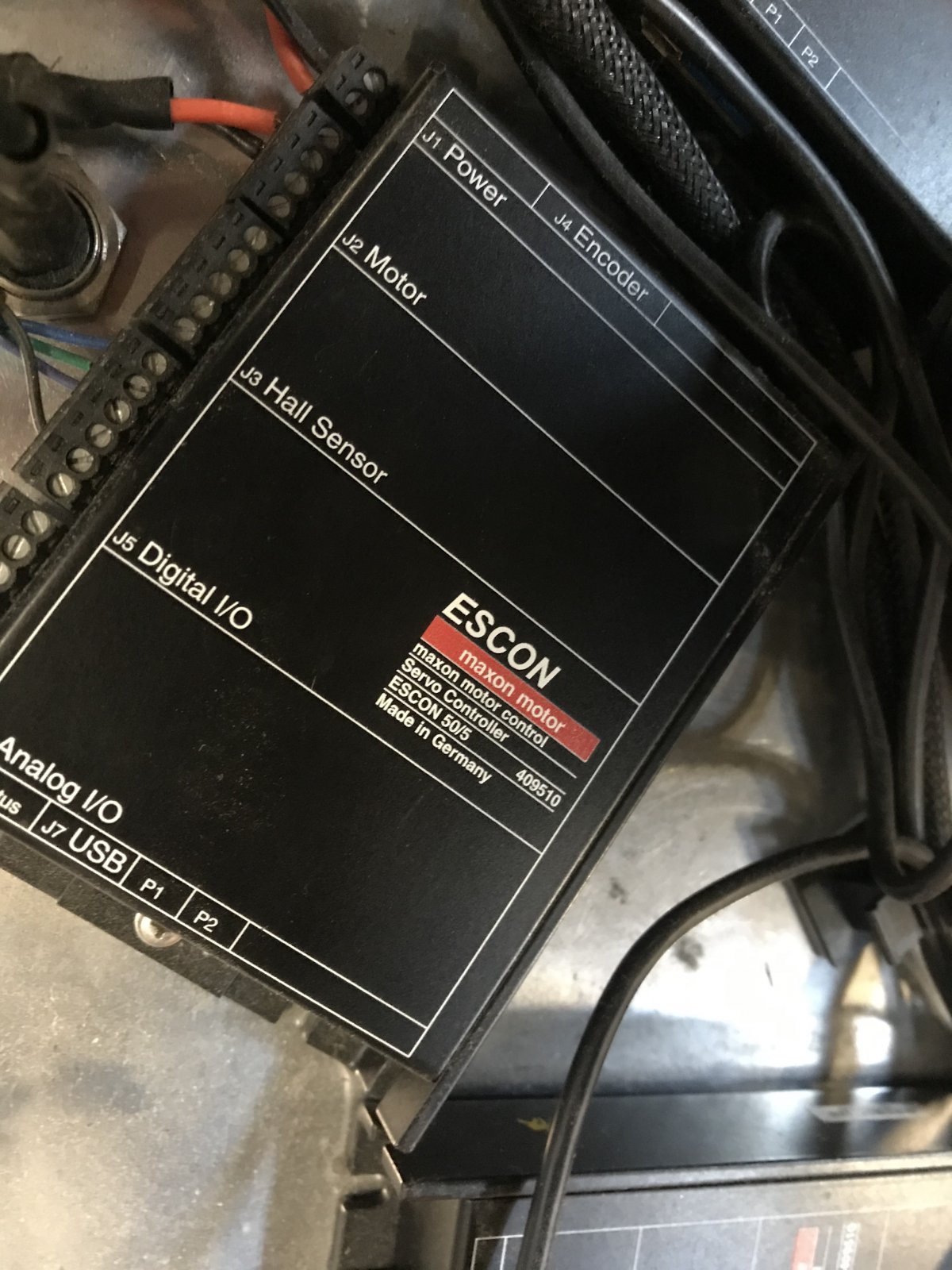

    It has 6 SKF CAT33H linear actuators with encoders (incremental I assume) and one ESCON maxon motor controller per actuator. It has one Arduino Mega with an Ethernet shield and another plain Arduino Mega. The one with the ETH controls the motor controllers and communicates with the server and the other Arduino Mega handles all the encoders.
    I have been on here searching for similar solutions, but can't really find any. I can absolutely change the Megas to something faster or change other components if needed.

    I assume these are brushless motors... perhaps you can use odrive...

    I think the motor controllers will work fine. They are DC motors.

    What motor drivers does it use ?

    To my current knowledge, it just needs a PWM signal and direction from the Arduino.

    Its actually an ESC controller, for brushless motors or 4-quadrant PWM servo controller for permanent magnet-activated brushed DC motors, meaning these motors have four poles, not two poles that DC motors have.
    https://www.maxongroup.com/maxon/view/product/control/4-Q-Servokontroller/409510
    See some info on these four quadrant type servo motors:
    https://circuitglobe.com/four-quadrant-operation-of-dc-motor.html

    It was made at my univeristy as a Bachelors thesis about 6 or 7 years ago, and has been standing still since they finished.
    It has one Arduino Mega that communicates via ethernet with a server running SimuLink. I think the Simulink model got data from the simulator "Racer" (Now Crudens Panthera) and ran it through a vahicle model and then sent data back to the Arduino for controlling the actuators.
    Another Arduino Mega reads the encoders and sends the data through serial to the first Mega. That sketch is quite compact and uses the encoder.h library.
    The ethernet connected Mega's code looks more complex obviously.
    The sim is scratch built, without much documentation.
    During the process they had a lot of contact with Cruden and my university ended up buying a HexaTech motion rig from them. Needless to say, it outperformed this one. Thats why it ended up in a corner, but now I want to adopt it. <3
