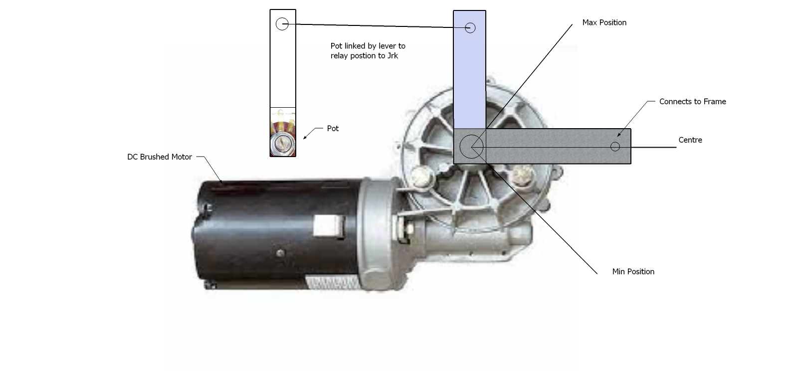

    Hello All, Question: how would one connect a pot to a 12vdc wiper motor having a small area to work in? I am somewhat confused on how the pot would mesh with the geared output of the motor. Any ideas?

    Turn the wiper motor over and you'll see the back of it. If you have a thin metal or plastic back plate you can drill through the middle and attach the pot to where the shaft comes out the back of the main round gear. There's a thread on here somewhere showing pics of one done like that.

    I don't think so. I found the pics by accident one day a while back. It might even have been a link to another site. I suspect there are lots of different types of wiper motors too so it may depends on what type you have. Have you taken the back off yet?

    If room allows a simple lever connection works too.

    Thanks RacingMat and eaorobbie, this is what I was looking for. I will let you all know how it works out for me. I am going to start the "big" build this week. My proto type works great. I will post pictures and presets as to what and how my platform is to work. again, thank you
