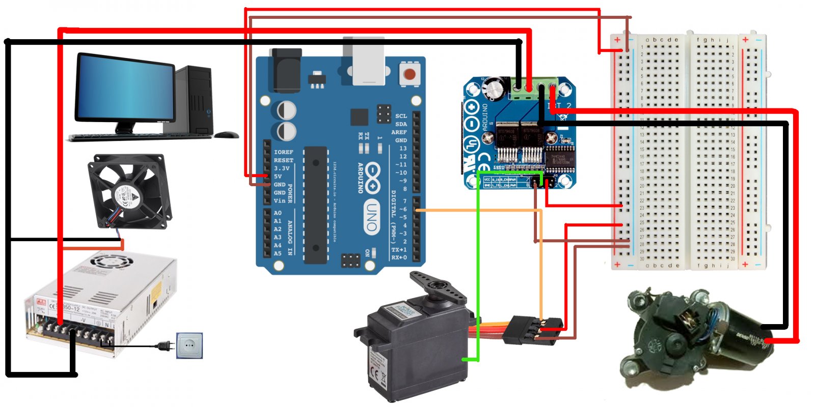

    I'm so sorry, maybe it's been 4 years I can't continue this project, also because I don't have a steering wheel
    and other supporting devices at that time. Grateful, because I now have a steering wheel, oculus dk 2 and gaming chair..
    In the Corona Virus Lockdown, at home, I have more time to do this project ... Yesterday, still using miniservo code. I did an experiment using a small servo as a Potensio, before I used the motto monster as a bridge but it always failed, this time using H-Bridge IBT 2 and then succeeded. , I'm very pleased.
    I hope in this month I can build it, :) sorry for my english (it with google translate)

    I also started like this, use 1 cassette motor and check that it worked, but I advise you to use 2, because the program does not work well if the 2 are not connected, for example I connected a single motor to an ibt2 board and then with the The same engine was testing the other board and it did not work well, but when I used the 2 engines at the same time, each one on its board, everything worked. sorry use traductor
    Cheer up, it's easier than it sounds.
