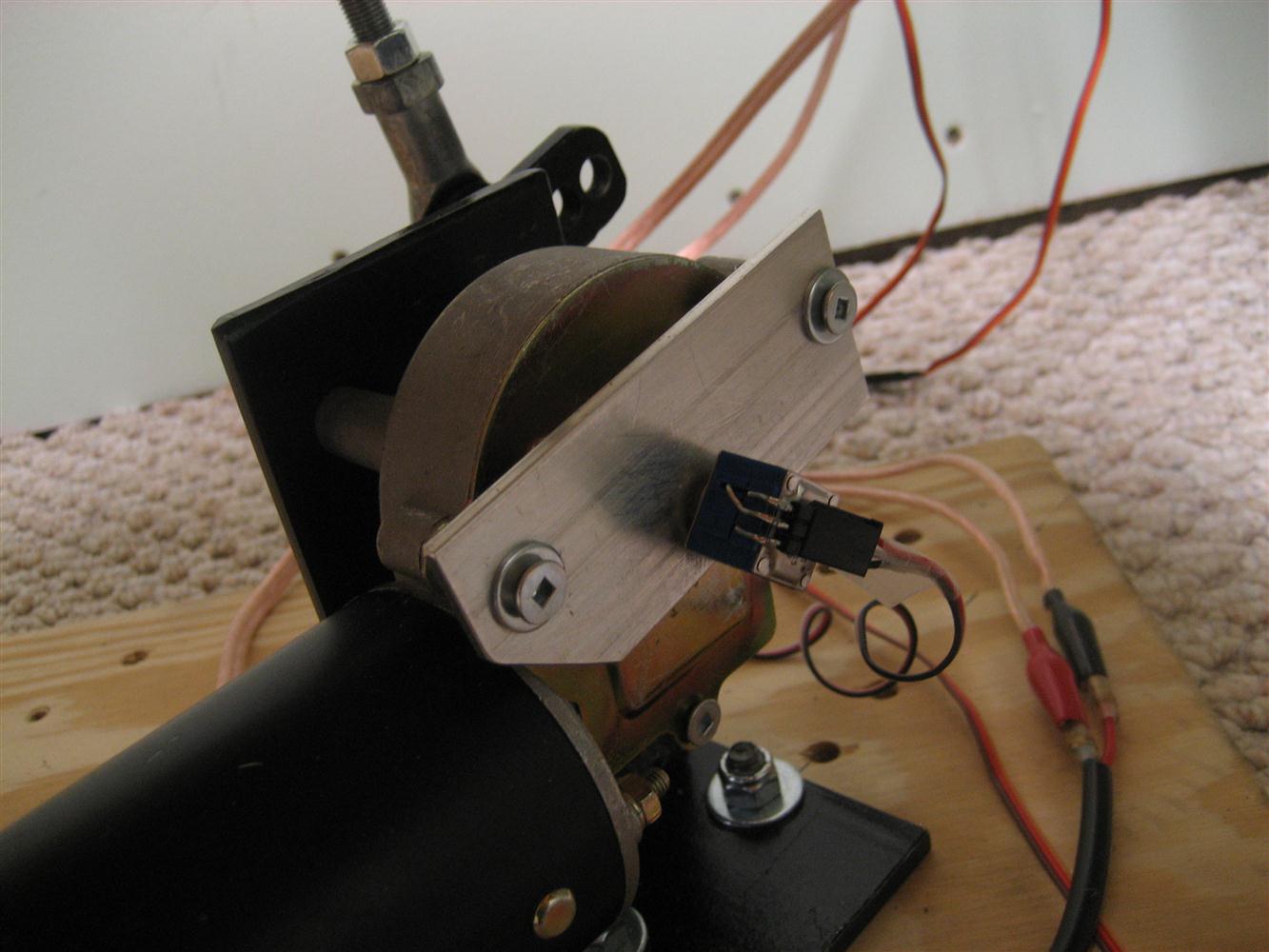

  8. bsft
    Yes, pot mounting can be a bit tricky
    This is a pic or two of what I did.
    In regards to potentiometer mounting, I noticed that some people connect the shaft of the pot direct to the shaft motor. Only one problem, most single turn pots are a 270 deg rotation, whist a motor is 360 deg rotation. If by some chance you have a feedback disconnect, the motor may spin freely and break the pot. The pot may still work, but it would have issues.
    Some people use a lever type system, so as the pot moves between 90 and 180 deg rotation. Use plastic arms.
    I made a lever system and set it up, then with the motor running I moved the pot on the bracket to a point where it moved ok, then I screwed it down
    Heres a video, the levers are now different but you may get the idea.
    http://www.youtube.com/watch?v=Kr2QqH55byc
  9. bsft
    There is a simple and cheap way to fix backlash from worn gears in wiper motors.
    Heres what I did, I attached a compression spring of considerable force ( no I do not know how hard), I know its a STRONG accelerator or handbrake cable spring. I fitted to the other side of the motor. I have backlash in my motors. It creates a consistent load on the motor gears in one direction, despite the motor changing direction. The springs cost me $5 each and they work. I chopped out 2 motors before I fixed the problem.
    Also it can be seen in this video.
    http://www.youtube.com/watch?v=hu6BfD9jqaE
    A suggestion would be to try this first, as it may save you a fortune in re-development.
    :cheers:

  16. Frakk
    Frakk Active Member
    Apr 15, 2009
    1,144
    328Coins
    Linear pots mounted to rotating arms = loss of linearity, the feedback will be inaccurate.
    Pots connected to rotating arm with a rod = loss of linearity, the feedback will be inaccurate.
    This means: at different positions, the same movement will cause less or more movement in the feedback. :thbd:
    If you want to keep any sort of accuracy, the feedback has to be mounted to: 1) motor shaft, or 2) output shaft
    I mounted it to the back to avoid breaking it and for easy adjustment of the 0 position.

    1. What happens if the motor spins around (if xsim crashes or you turn the power on before opening the xsim my motor spins around. Wound't this break the pot?
    The seat goes up and down, the pots starts slipping on the shaft as they reach their stops.
    2. How did you get the shaft to also come from the back? My shaft is only on the front.
    I drilled the back cover and drilled into the plastic worm gear to fit the pot's shaft snugly, but not too tight to let it slip.
    Instead of doing nothing? Something is always done... :D
    You can try and reduce the sine deviation, at the end of the day you still end up with: 1) more complicated mechanics, 2) worse reliability, 3) still inaccurate feedback.
