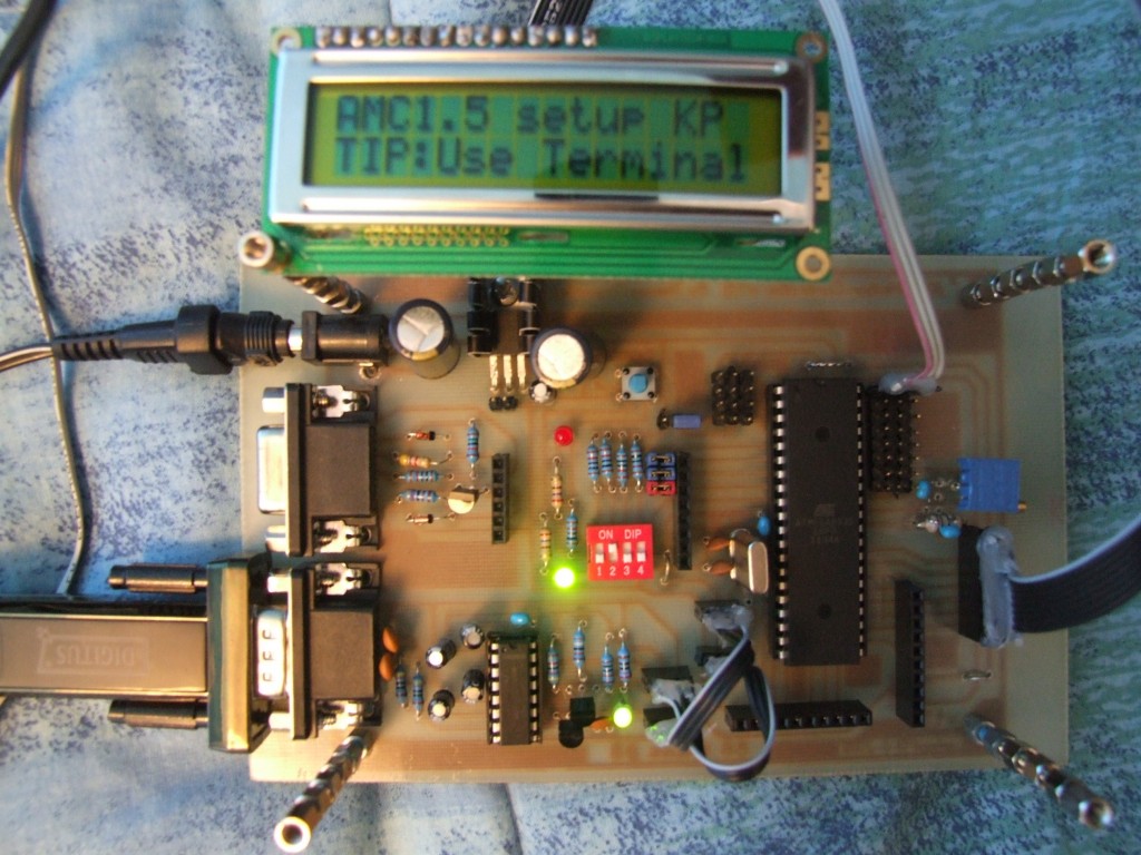

    Hi all,
    I'm new :blush: , I apologize if I'm posting in the wrong section,
    I wanted to thank you all for the information that you have decided to condivere with everyone!
    I built AMC and DSMHB,
    I programmed with AMC ponyprog and everything went well.
    Now I stopped to set the values ​​KP through the HyperTerminal program, I can not get AMC to communicate with the software,
    imposed the correct port and speed, I followed the guides that are on the site
    x-simulator.de but I am not come to the head.
    Can you kindly help me?
    Thanks to all!

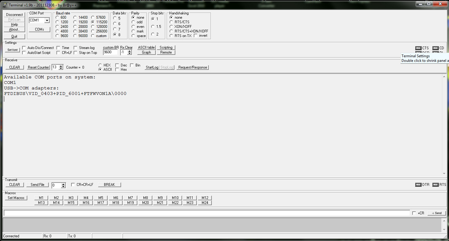

    I unzipped the folder and started the program, the port sector, the speed and data connectors. but nothing happens,
    attached photo

  6. tronicgr
    tronicgr
    After you connect to the serial port, press the reset button on the AMC board...

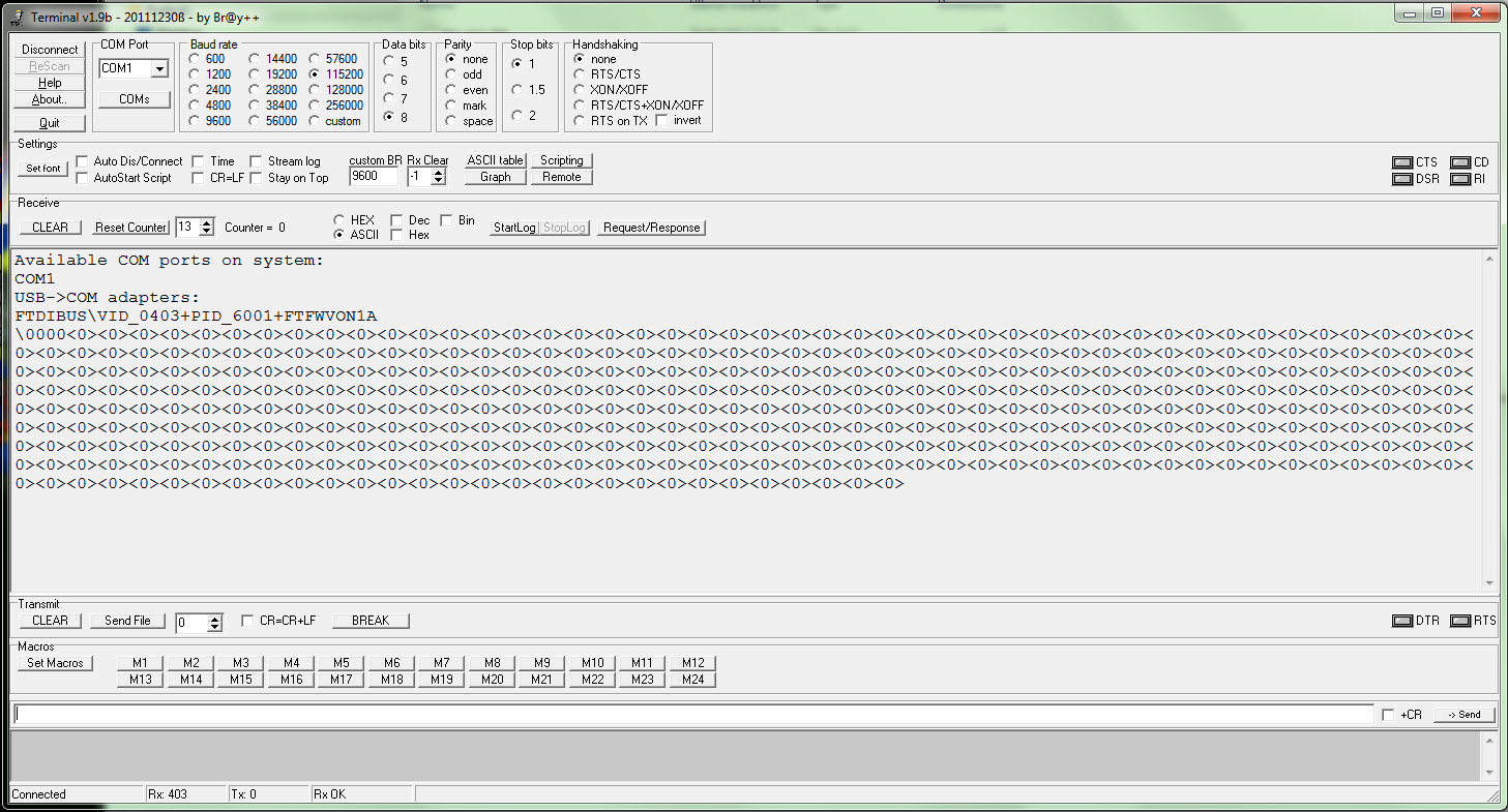

    Well, I press reset and see this (photo attached)
    as I do now to set the values​​?
    Thank you!

  8. tronicgr
    tronicgr
    [strike]You type in the numbers you want to use and then enter.[/strike]
    Just seen the photo, It seems that your com port is not correctly installed. Did you install the FTDI drivers?
