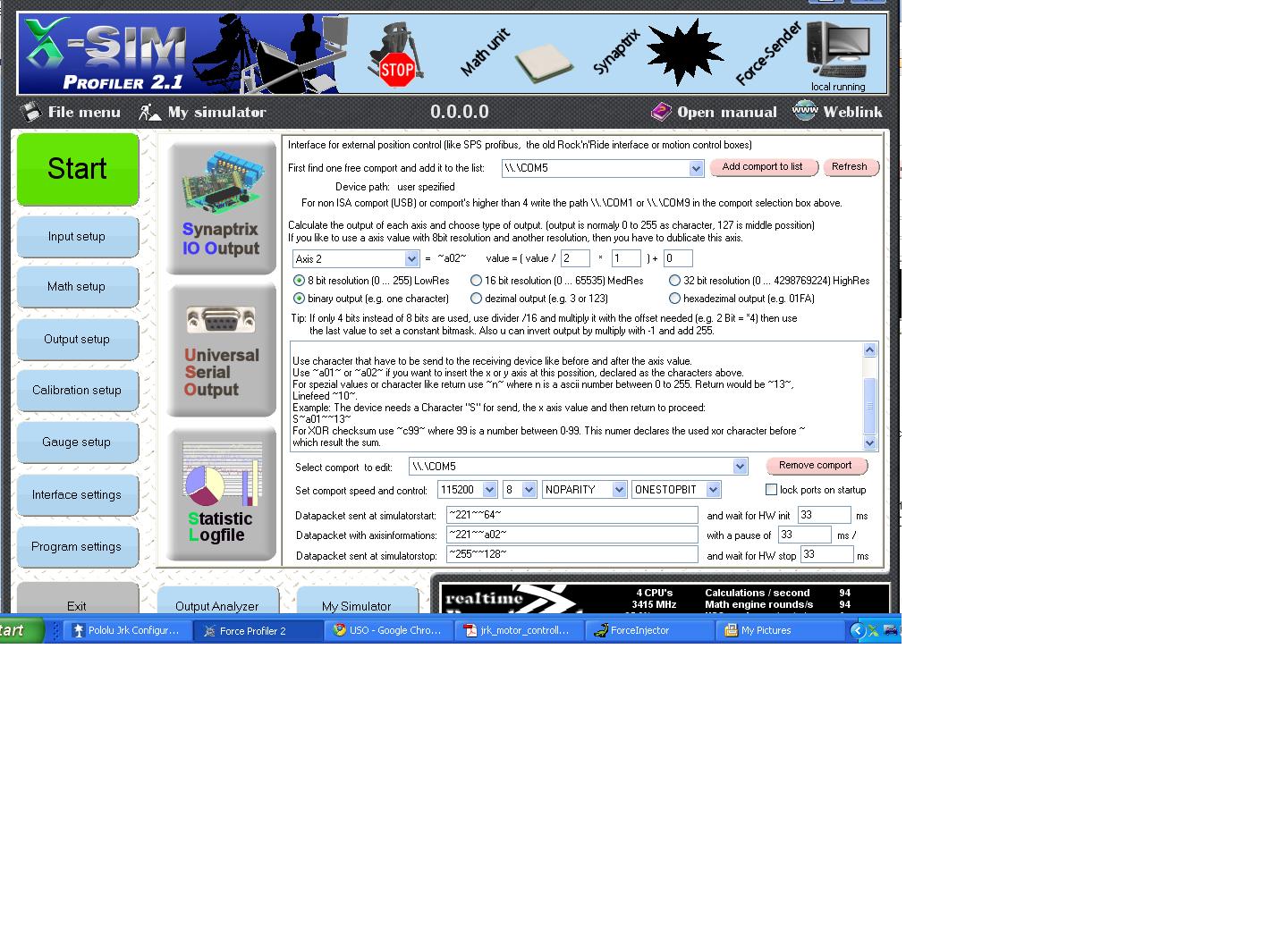

    Hello Guys
    i have a problem with my jrk.
    I can control my motor with the USB software kit. Everything is ok . I can move the motor forward and backward.

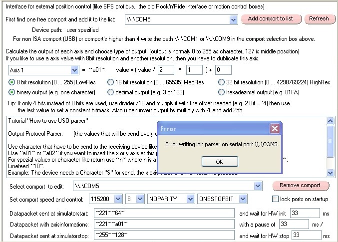

    But when I start X sim profiler 2.1 i get the message Error writing init parser on serial port COM4
    My settings in the output setup are
    Datapacket start ~221~~64~
    Datapacket axxis ~221~~a01~
    Datapacket stopp ~255~~128~
    I use the com4
    Polulu JRK Command port (COM4)
    Maybe some had the same error message and know what i had to change.
    Best regards ThomasD
  8. bsft
    Have a look at the picture, and try the suggested settings, although try datapacket set at simulator stop of ~255~. Check that you have only set up the comports that you need, go to select comport to edit, click the drop down menu and check via the device manager that you only have the two comports you need. They will be different to what is in the picture.
    Try that. :cheers:

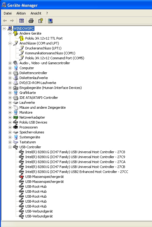

    Must I configure the jrk with the pololu software before I can use it with X-sim ?

    Make sure when you connect the jrks, that the computer will ask for you do tell it where to find the software via a new hardware wizzard, let it search a few times and program the jrks.
    Yes, set up the jrk in the configuration utility program. You will need to set feedback for the pot mounted ( if you have one), and the other settings , read teh pdf manual from pololu, check pages 10-16 explains how to connect the device via a usb cable to the computer and setting up the software so the device is recognized by the computer as well as where to find them in the driver manager of windows.Page 18 is PID options, this assists with speed control of the motor. Myself and others have started with PID of 2/2, 0/3 , 1/1. This works well. Feel free to fiddle with this later after you have everything running. Page 22 is error responses, note them down and set them!

    Next use comport 5 as shown so you are right there.
    For datapacket sent at simulator stop, try ~255~ on its own.
    Make sure in the select comport to edit list, there is only the comports you need an delete the rest. Remeber to name each one axis1, axis2 and so on. :cheers:
