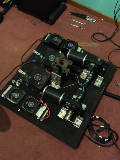

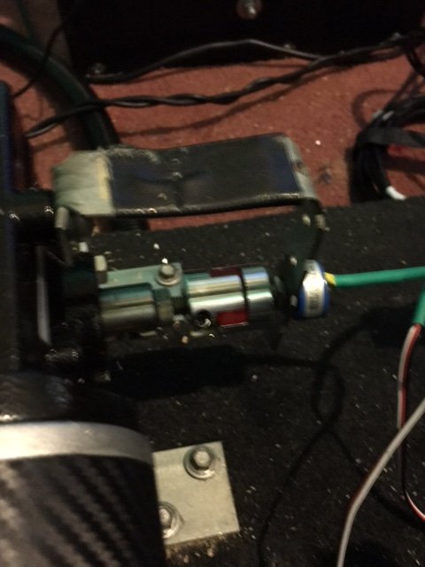

    Nothing amazing, but changed my shoulder mount to a "thigh" mount to save space in my room, and to make it more portable as I am likely taking this into work over Christmas for our annual Games week.
    I've put the 50:1 motors on and boy... does it ever throw me around.
    I had to re-do my profiles to ease up on the Jumps for DiRT Rally.
    In fact, dialled back everything now I'm using VR. (as per @noorbeast 's advice that less is more in VR)
    Overall, I'm happy with the Sim now, and won't be doing much more to it, bar a few cosmetic touch ups.
    I'll take a video of the new motion when time permits. (and when I've put the seat back on it!)
    The new "half size" base:
    New Feedback pots and couplers.

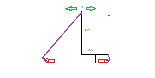

  6. Nick Moxley
    17,057Coins
    +2,506 / 30 / -2
    "The throw is much quicker and more forceful." You got me confused there bud, How can a slower 50:1 motor with same length lever **looks like** be any faster than a 25:1 ? Forceful....meaning what exactly ? You obviously re did your balance pivot with the new setup.......im thinking if the 50's are "faster" to you, than you likely had your pivot point set wrong with the 25's and had too much weight on them. Being the 25's will be the Ultimate in Fast, neck Snapping, Utter crazy oscillations when you allow them to.
    21,909
    153,065Coins
    +11,117 / 56 / -2
    I think what @Archie is trying to convey is a design difference in seat speed, not one of linear speed at the motor.
    If you picture pitch from a side view, with a normal base pivot, in a compact design you don't need to move the base far to move the top of the seat a long way, though you do need a bit of torque compared to a shoulder mount. In the compact design the seat back height amplifies the movement of the base.

    Hey @Nick Moxley - Yeah, @noorbeast did a good job of summing it up.
    Yes the 50:1 are slower, but the torque (newtons) is almost 3 times as much when given such a short throw at the "thigh" level the feeling is forceful and rapid movements.
    Pitch is so strong now that I have had to dial it back so that in a climb in AeroFly I don't "flick out my legs" to counteract :)
    In my old shoulder mount, the motor arms pretty much went the full 90 degrees from the centre. (180 full range), at the moment I'm using about 30-45 degree from the center, so about 120-135 from top to bottom of the throw.
    Something I have noticed is that your brain is more aware of movements coming from your legs, it must be a lizard brain thing. Imagine being sat on a chair and someone grabs your shoulders and moves you, you'd be quite comfortable as your COG is lower, however, if someone grabbed your legs and pulled them up, you'd suddenly be top heavy, so the feeling is amplified.
    I noticed this effect on my old foot mount sim, but could not compare till I had made a shoulder mount then back to thigh mount.
    Again - I'm in VR all the time now, so that makes a huge difference.
