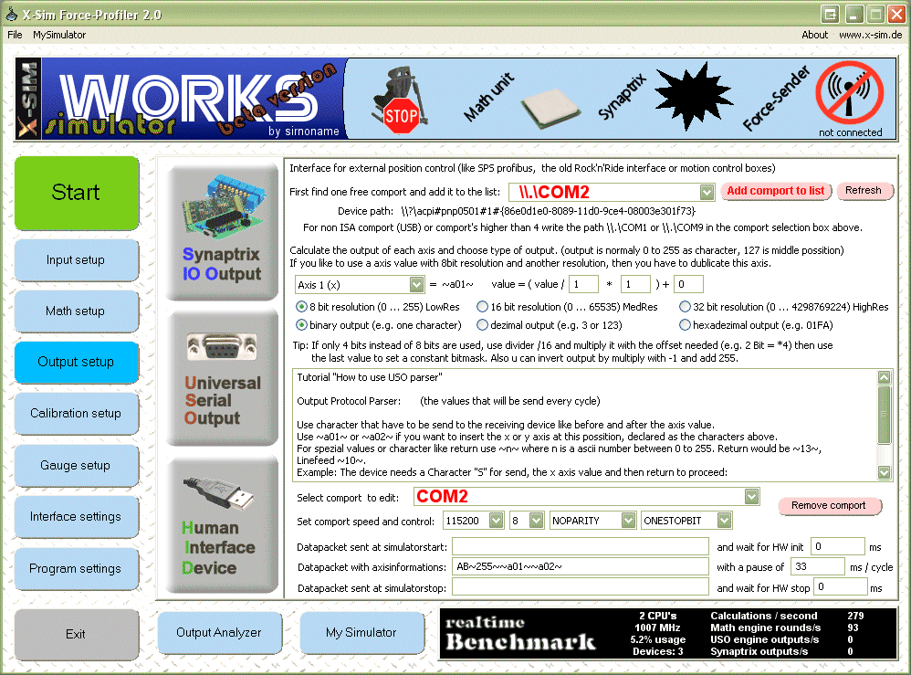

    Did you try to add the comport manually in the USO tab? Type \\.\COM2 into the First find one free comport and add it to the list:-field and press Add comport to list-button. Make sure to remove any unnecessary comports in the datapack section via Remove comport button! Probably this solves your problem. Profiler2-output-USO-mod.gif

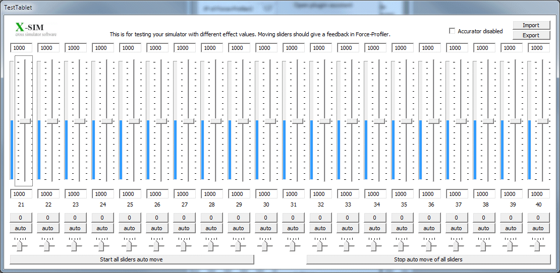

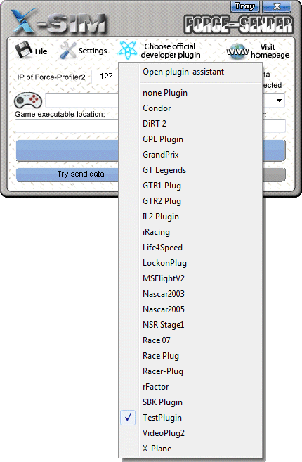

    There is a TestPlugin in the Force Sender (under Choose official developer plugin). Force Sender TestPlugin.gif When you select this plugin an additional tablet opens, where you can simulate game input: TestTablet.gif

    Can you post a printscreen of your USO screen? Which slider are you moving? And what's the math setup you're using? Are the values 49,50 even when you start (Start button in profiler) the profiler *after* having moved the slider?
