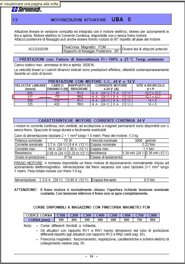

    On my research on web i found this italian actuator, for me is good.
    Is this actuator compatible with tronic motion controller and h-bridge and x-sim software ?
    The electric characteristic is similar to firgelli but the performance is more interesting.
    Thank for your response

    From electrical matter, they will work, but is the speed they have, true? 317 mm/s ??
    My joyriders actuators, for example, has speed of 40cm per second!
    Thanos

    Hi Thanos
    Thank you for your response, Also I am still surprised from the velocity performance.
    Now i phone to this company for more information and then i post the information to the community.
    If the performance is true this actuator is very interesting

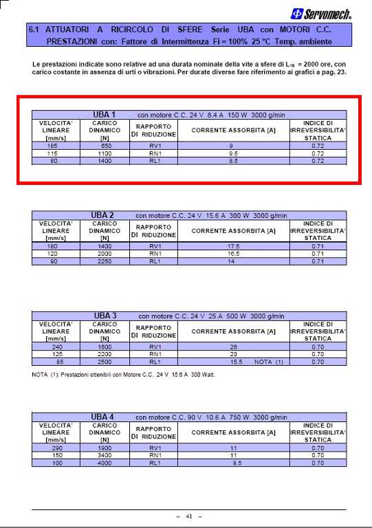

    Thank you Sirnoname
    I have found another actuator of this italian firm, with a cc motor with power 150 w.
    But it is possible to control this motor with a thanos controller and x-sim 1 ?
    Thank you

    Yes, I believe my DSMhb1.2 (h-bridge driver) will be able to drive fine this 24volt 9Amp motor.
    But You have to add temperature probes to the mosfets and watch the ampere rate with an amp monitor gauge. Normally you should have temperatures ranging from room temperature to max 45-50 degrees of Celsius.If you keep the ampere to the motors specifications and be careful not to stall the motor, it will be fine. Another thing to watch out is to use separate power input cables for each motor to avoid overheating and eventually burning of the cabling. Not all cables are capable of letting 20ampere pass through them!!
    And yes, you can use my AMC1.5 and DSMhb1.2 with both old x-sim profiler1.8 and with the new xsim2 profiler2.0 , later! :thbup:
