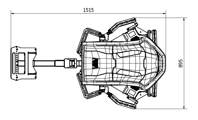

    The floor foot print of my simulator can be seen in the image below:
    It is only 865mm at its widest point. It is a little longer than the DOFreality H6 but this is due to having more of a single seater style design. Also the peddles are adjustable. The H6 uses a separate control box that is not included in their floor foot print dimensions, so this is additional to the sim. My design is fully self-contained, with all electronics situated in the base.

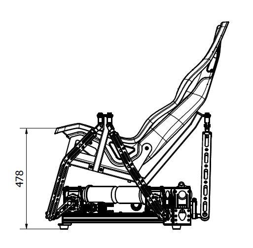

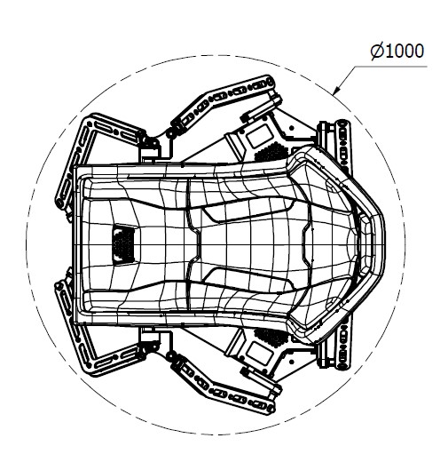

    The goal was to ensure that the main base, arms and seat stayed within a 1m diameter area, which has been accomplished:
    I also wanted to ensure that the seat was easily accessible, so the seat height is similar to what you would find for an office chair, at 480mm.
    One of the most important aspects of the design was to ensure the arms connect to the top frame at approximately the height of the centre of gravity. This makes it much easier on the motors. In order to do this I had to design the arms so that they bend around the frame, as the compact nature of the sim meant that they clashed with the frame if they were straight.
