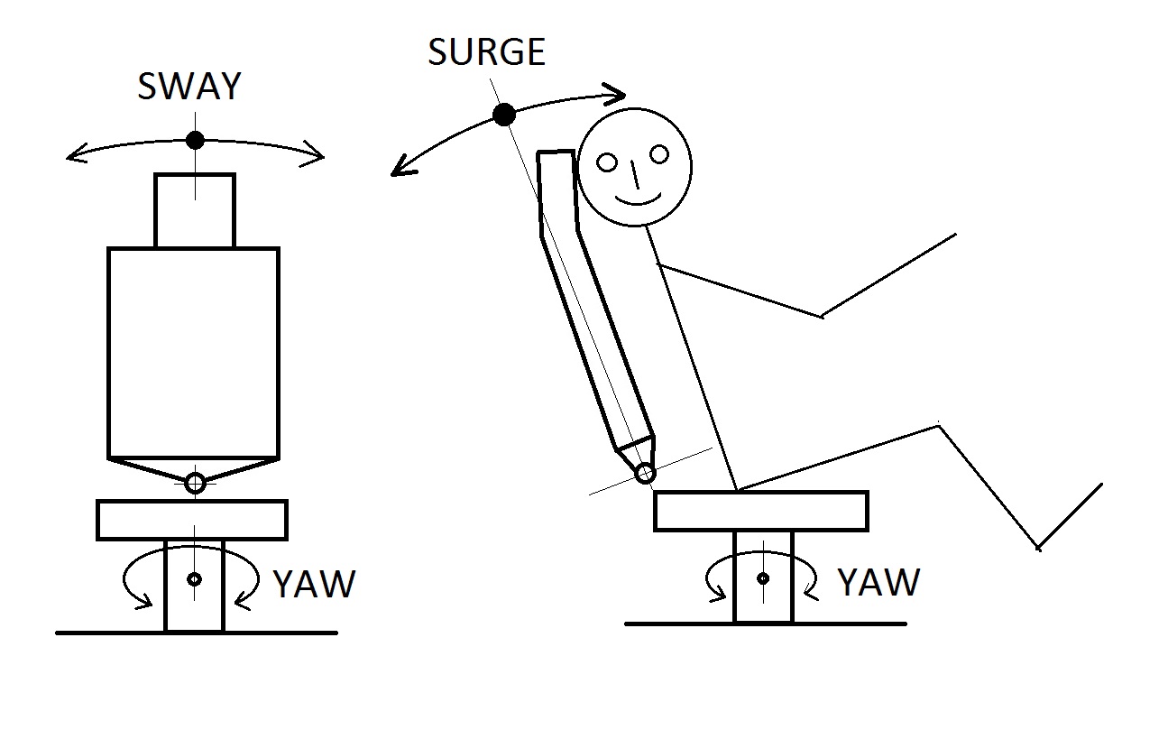

    hello designers,
    I'm starting my project.
    I want to divide the movement of the seat into two parts:
    1.the movement of the backrest will be announces the magnitude of inertia and centrifugal force. Size of movement on the shoulders +/- 100mm for surge and +/- 80mm for sway.
    2. the movement of the sitting announces oversteer or understeer of vehicle skid.
    Rotational movement +/- only a few degrees.

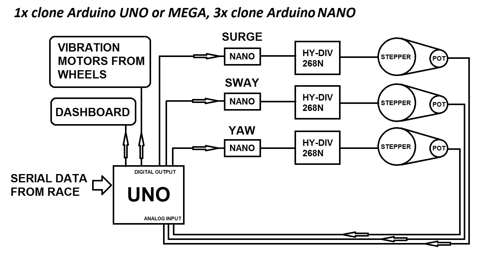

    Hi, I am adding a scheme.

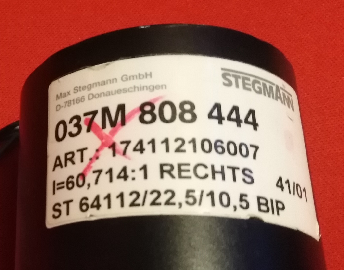

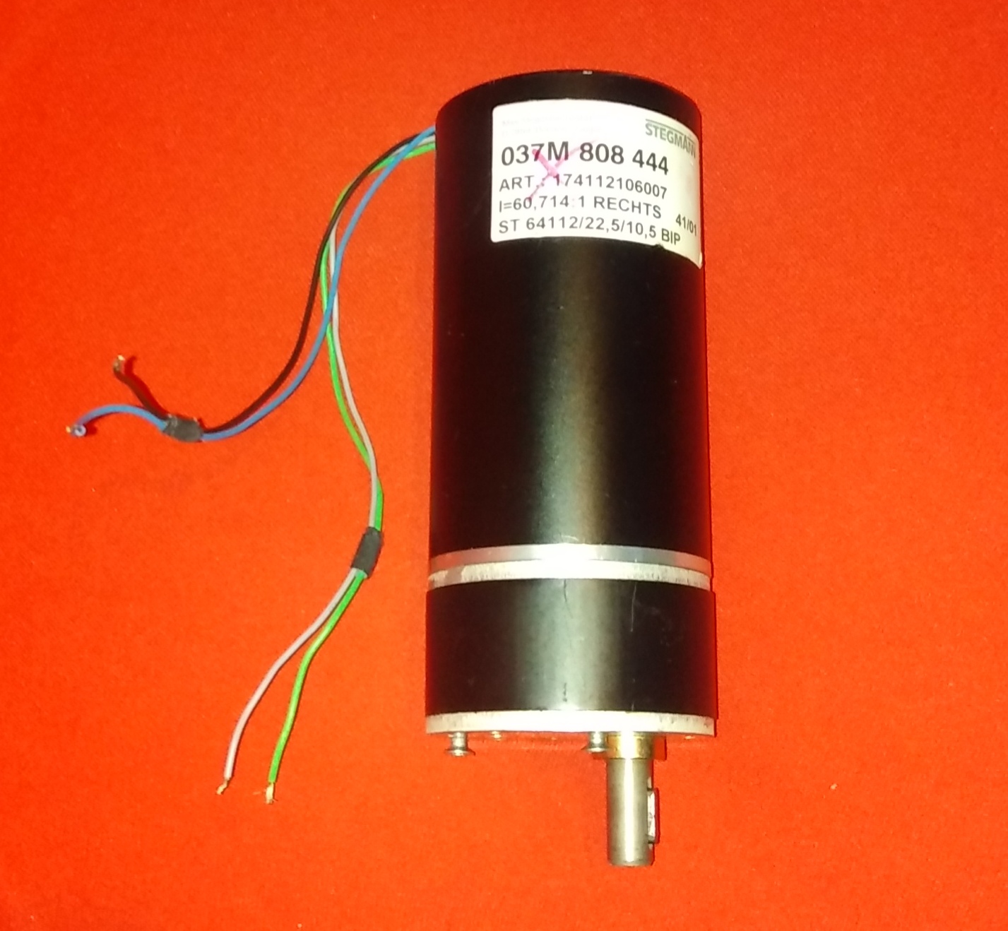

    These geared motors I plan to use, they are gifts from an electrician from the company.
    It is at 24V, but I am currently testing it at 12V and the current consumption is up to 2A.
    The output shaft is 10mm in diameter.

    I'm not super familiar with 3dofs, but I don't think a 24-48 watt motor will be sufficient for motion simulation.

    when I connect the motor 24V, the power from the transmission is great, I can not keep in my hands (100mm lever).
    And if it is not enough, I can use 2 motors per axis

    For days I tuned the arduino code. And I did an LFS test. I think that's good. It's smooth and has no trembling.

    Just for consideration, traction loss (pivot near feet) is more realistic for a race sim than yaw (center rotation).

    - 12V vs 24V will lower the speed by half, that's a pity. You may consider using 24V PSU!
    - hands are not representative...
    your seat + your weight will induce high inertia when doing forward/reverse movments even with a short lever
    - using two motors per axis is not easy (if not synchronised, they will conflict each other...) or you have an idea about this?

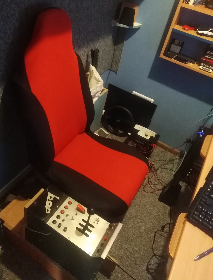

    Thank you for their suggestions. I have to build and test.
    I'm limited by the size of the racing room.
    If the seating was fixed, but would the pedals move laterally?
    This option would also be better, because next to the seats I have H shifting.

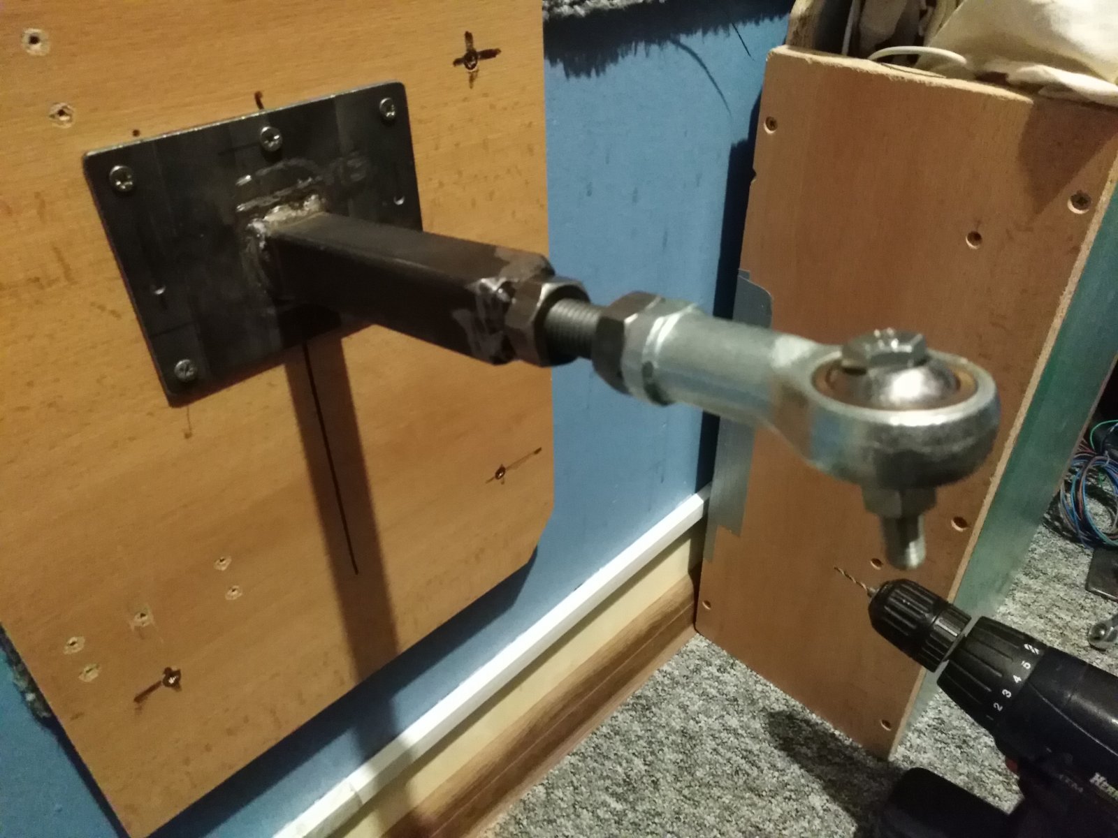

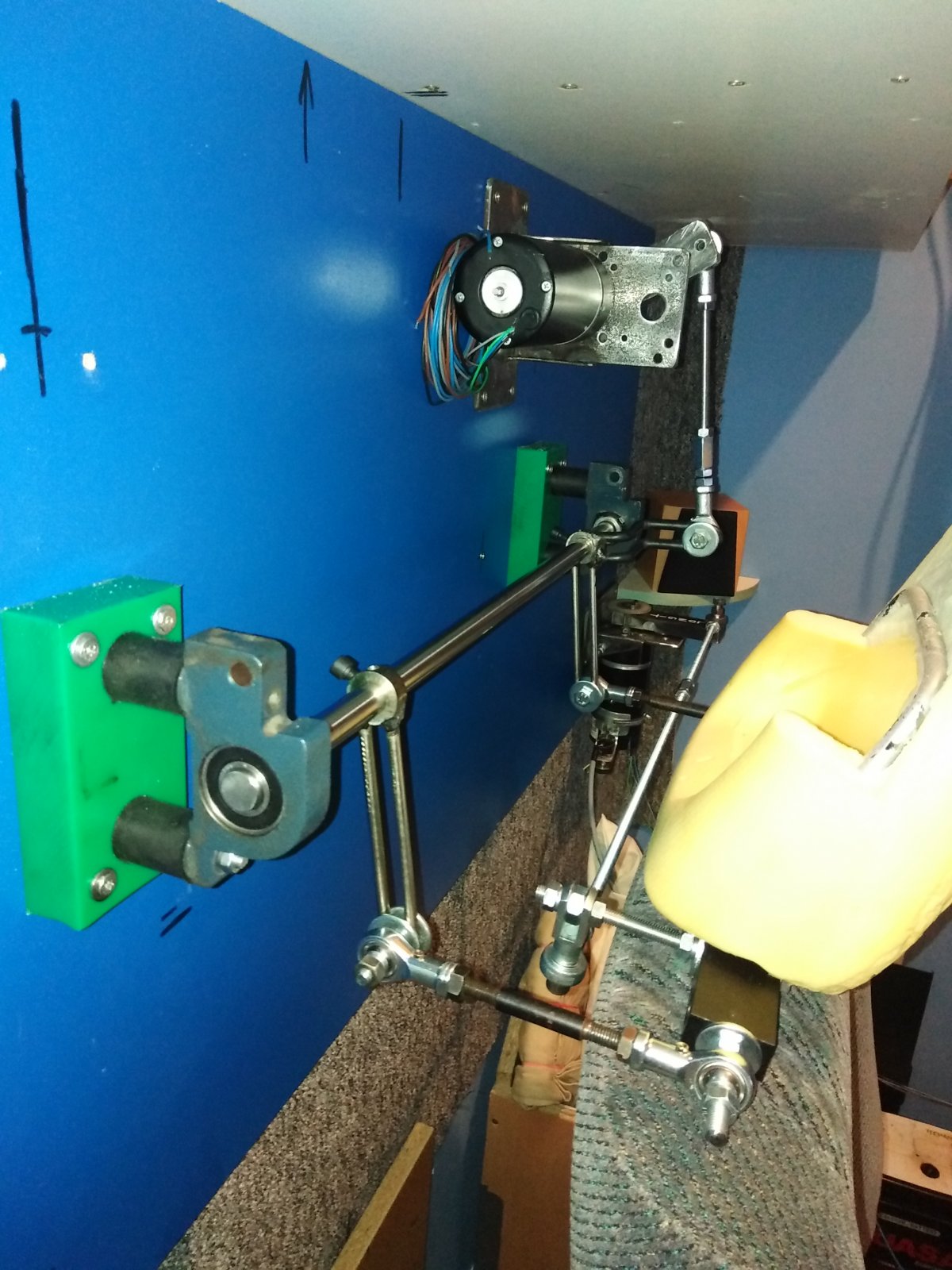

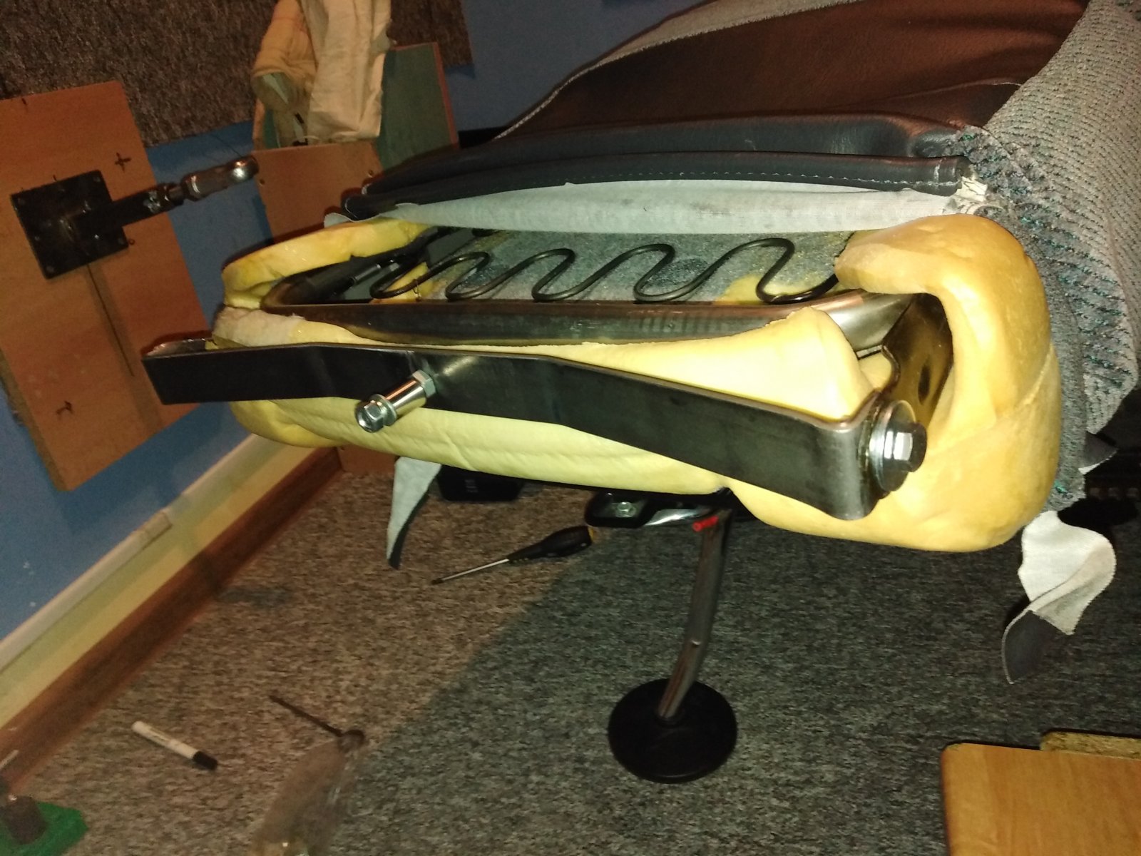

    Hi, I split the seat and the backrest is moving.

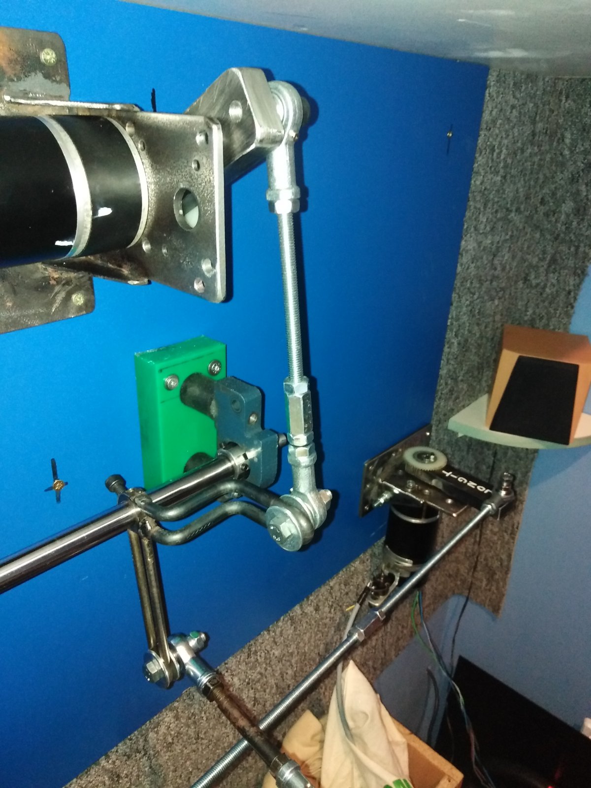

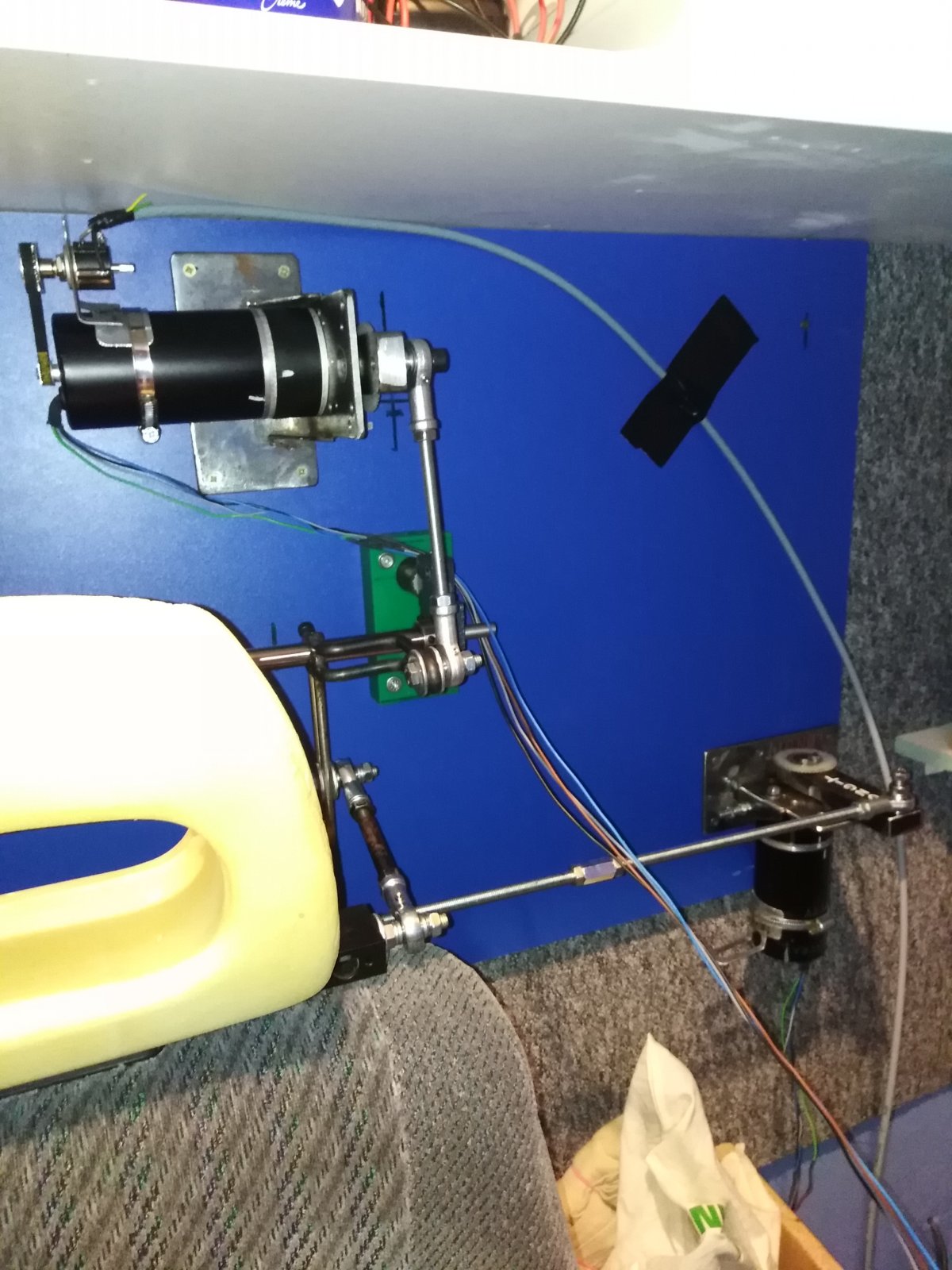

    I installed the rods and motors.

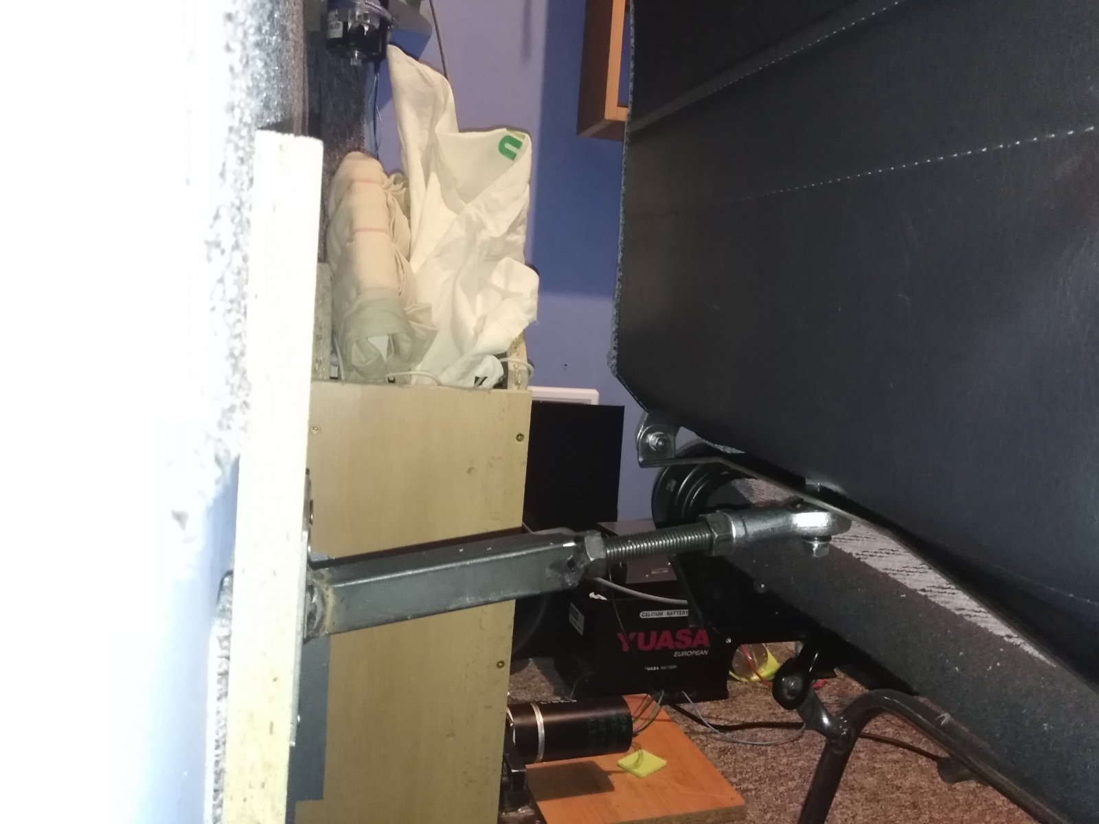

    And I tested.
    So far only one axis. I'm waiting for the delivery of the engine drivers.

    Great to see your rig in action :thumbs
    Looks like a race harness will be necessary, to keep you pinned to the seat.
