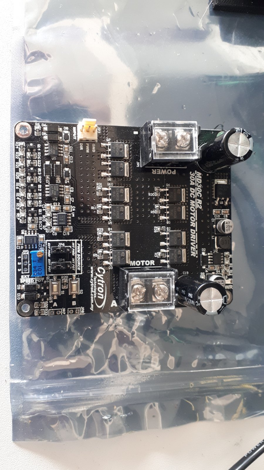

    Arduino Uno x1,
    Md30c rev2 X3 Motor controllers, Have started testing using Blame73's updated code had a few dumb moments last night but managed to work it out and had a succesful test on with motor motor

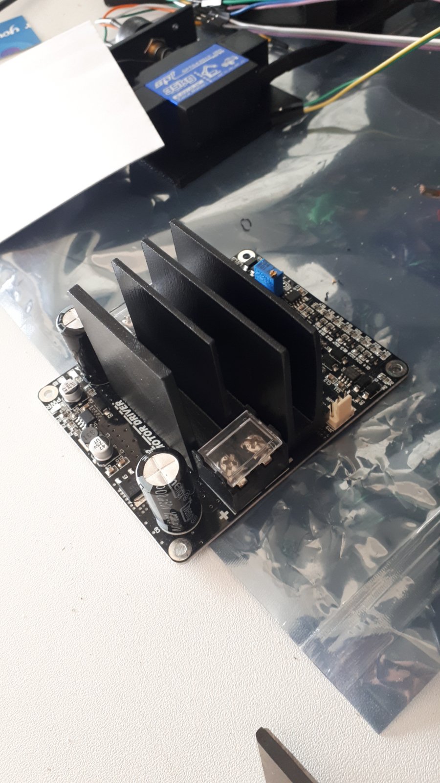

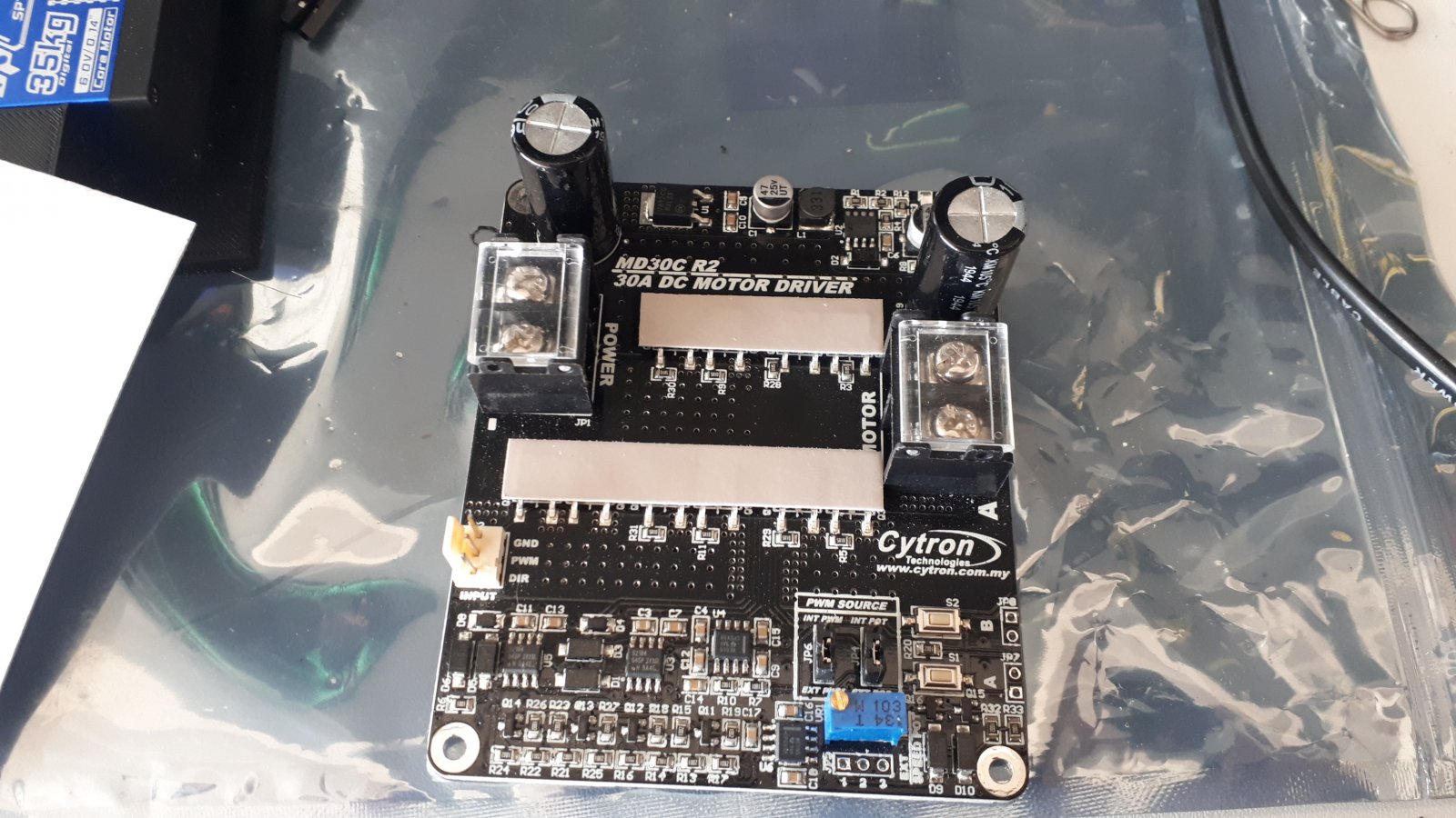

    Also @Blame73 @p00ky Do i need to heatsink these or will fans be ok?
    Stay Tuned.....

  10. Blame73
    Blame73 Well-Known Member
    Nov 6, 2014
    1,215
    8,300Coins
    +1,127 / 2 / -0

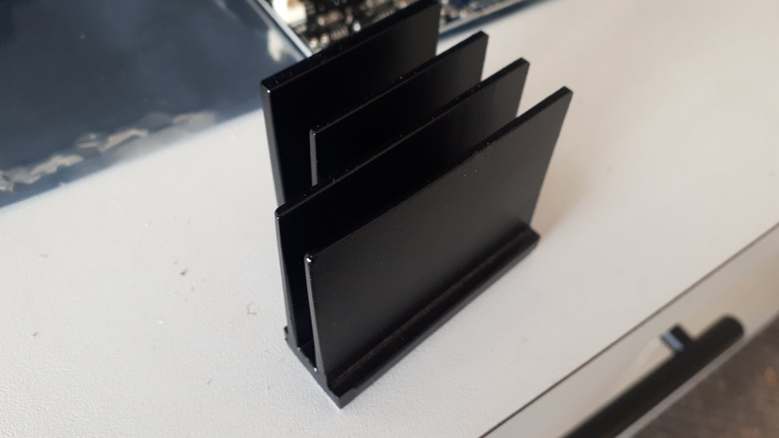

    I always use heatsinks and fans.
    You could probably be fine with just fans, but what you'd want to avoid is to find out that an heatsink would have avoided a damage when it's already too late.
    A few bucks for heatsinks won't surely break your budget

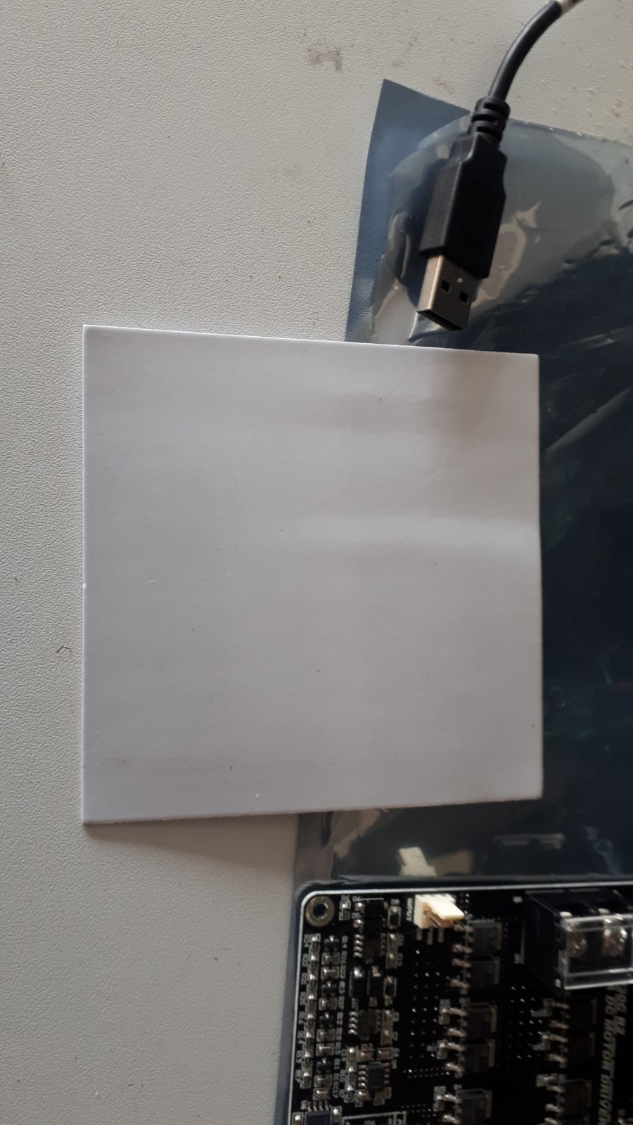

    yeah too easy mate cheers for the input, How did you mount them?
    Just looking at them i wonder if i could thermal paste them and then in the middle section where its all open put a small dob of sika, put a weight on it while it sets, Thoughts?
  12. Blame73
    Nov 6, 2014
    1,215
    8,300Coins
    +1,127 / 2 / -0
    I use the ones made for arduinos, raspberries... they already have an adhesive strip, ready to use
    edit: unless I got heatsinks from cpus, in that case I cut them to size and use thermal adhesive stripes

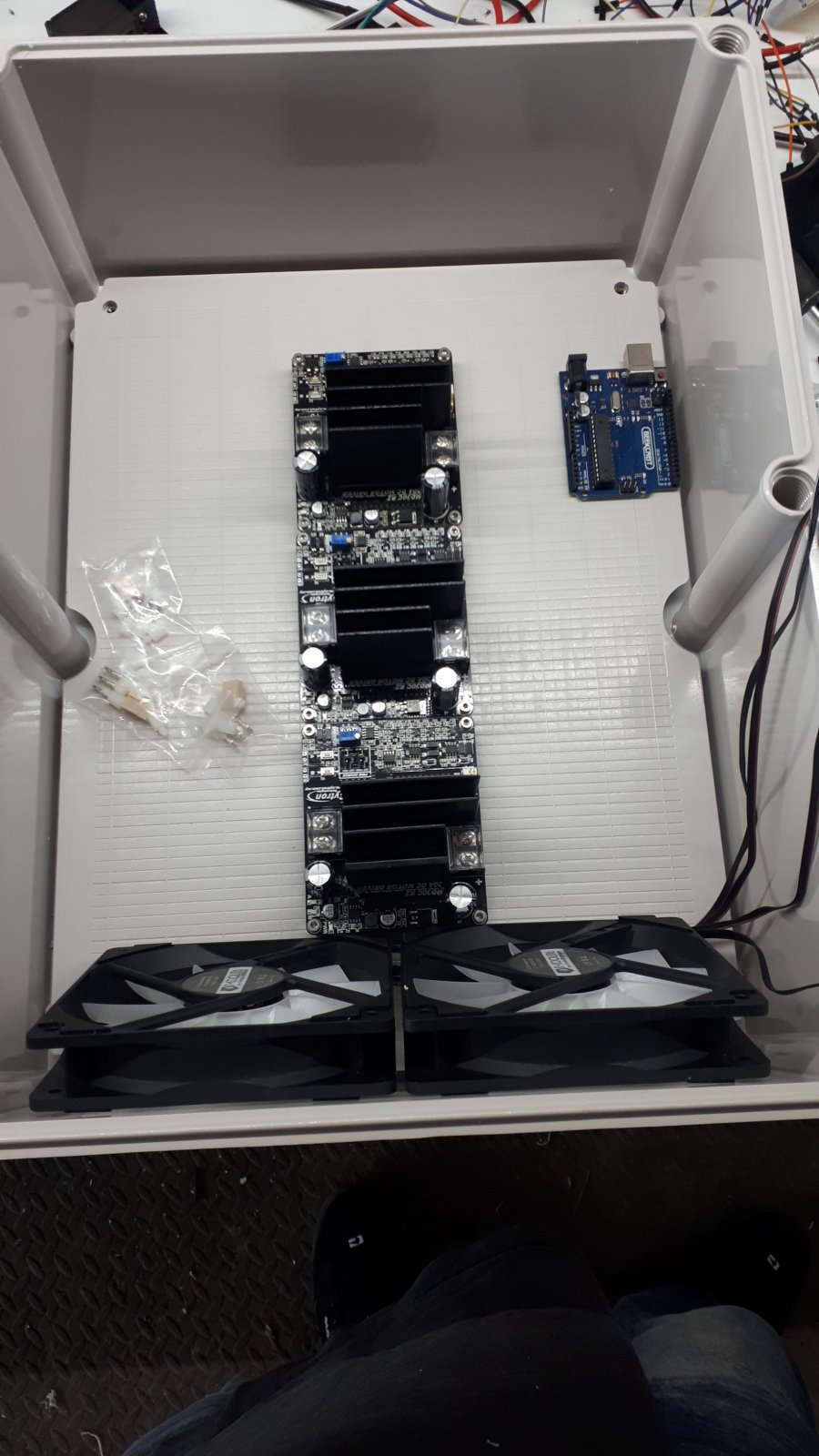

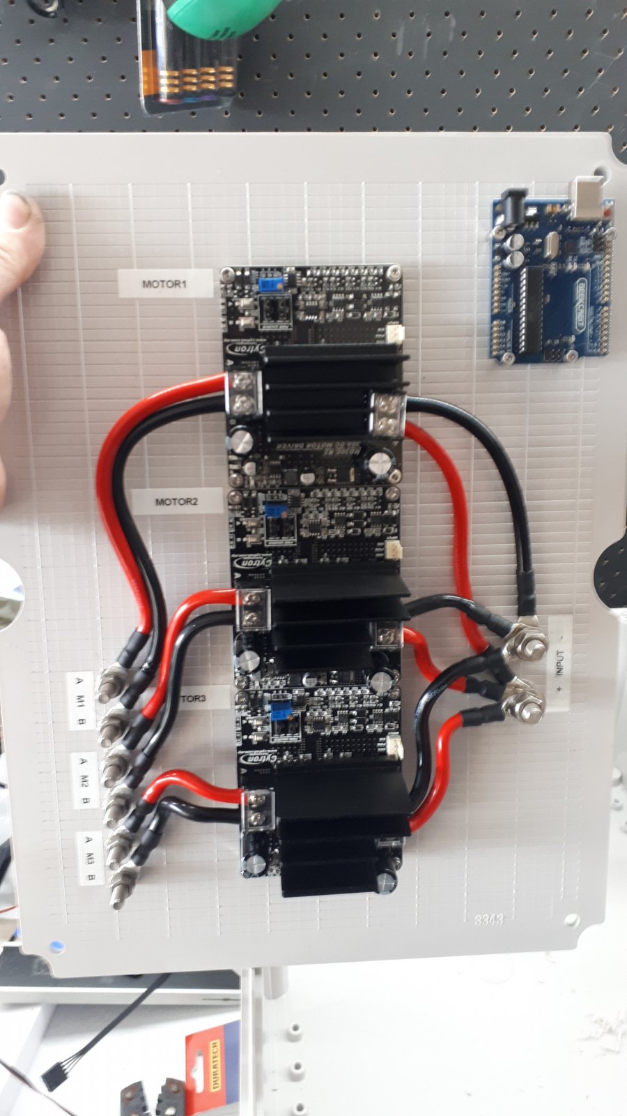

    Update Time..

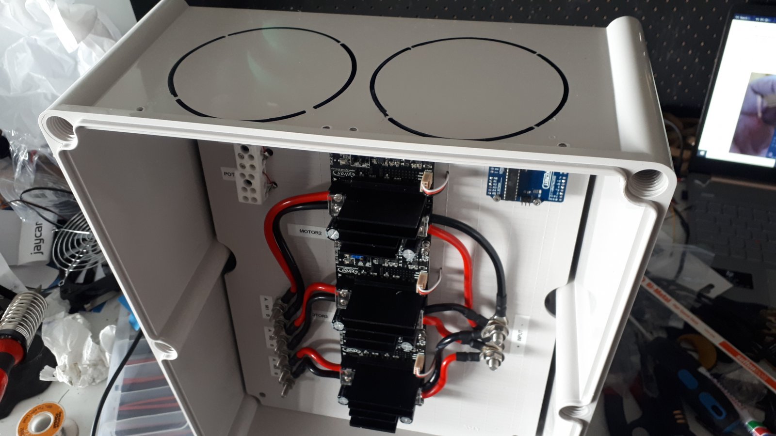

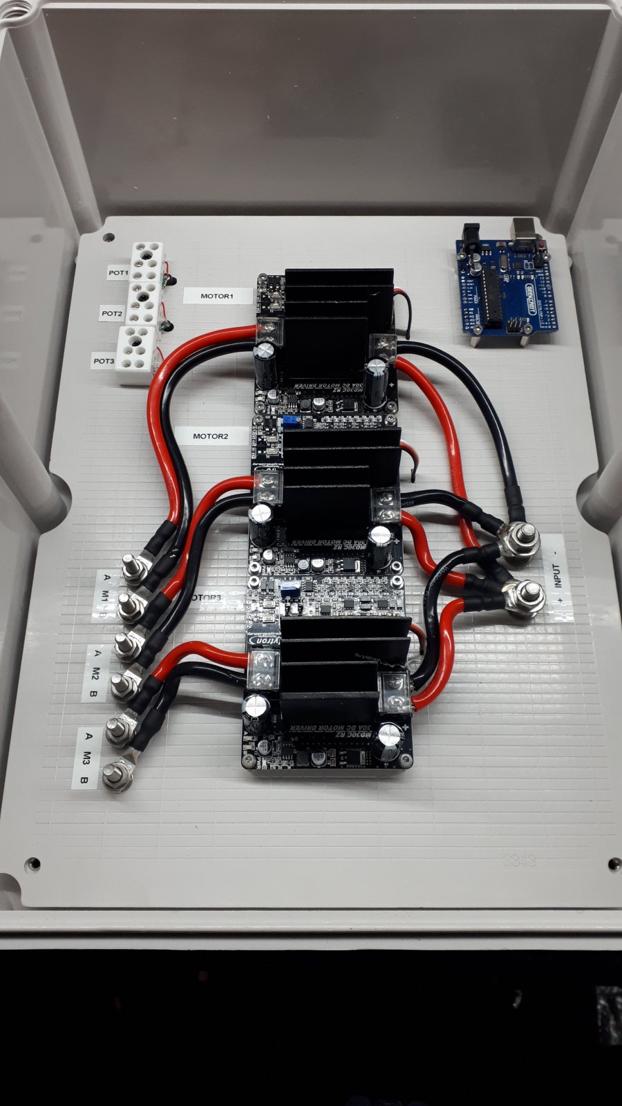

    So over the weekend i started on the control hub and got my hands on a driveshaft for the uni joint,
    I'm using a rather large box but i wanted everything well spaced out and easy to get to, The threee motor drivers are wired up as is the arduino, i used some servo lead for the wiring between the arduino and the driver plug, and i chopped up a usb extension lead for the pot wiring,I'm hoping i dont get to much feedback from the pot lines as i have little ceramic blocks where the wires are terminated as per pics attached,
    Need to buy two more Rgb fans and cut the holes out, Also need the large relay and cable glands.
    Will this size relay be suitable? Automotive Relay 150A SPDT From Jaycar, On the input to all drivers
    How does everyone prefer to isolate thier rig? before the driver or before the motor?
    Another Question
    Fuses: I relate most of this to cars as thats what i'm used to so: I would put a Large main fuse at the battery, Relay for emergency stop right at the drivers inside the box, then say 40A fuses on each motor? or is that too high or low? or set them at 30A as thats the continous rating of the controller?
    Forgot to take a photo with the lid on :( I will grab one tonight!
    Any Input Apreciated!

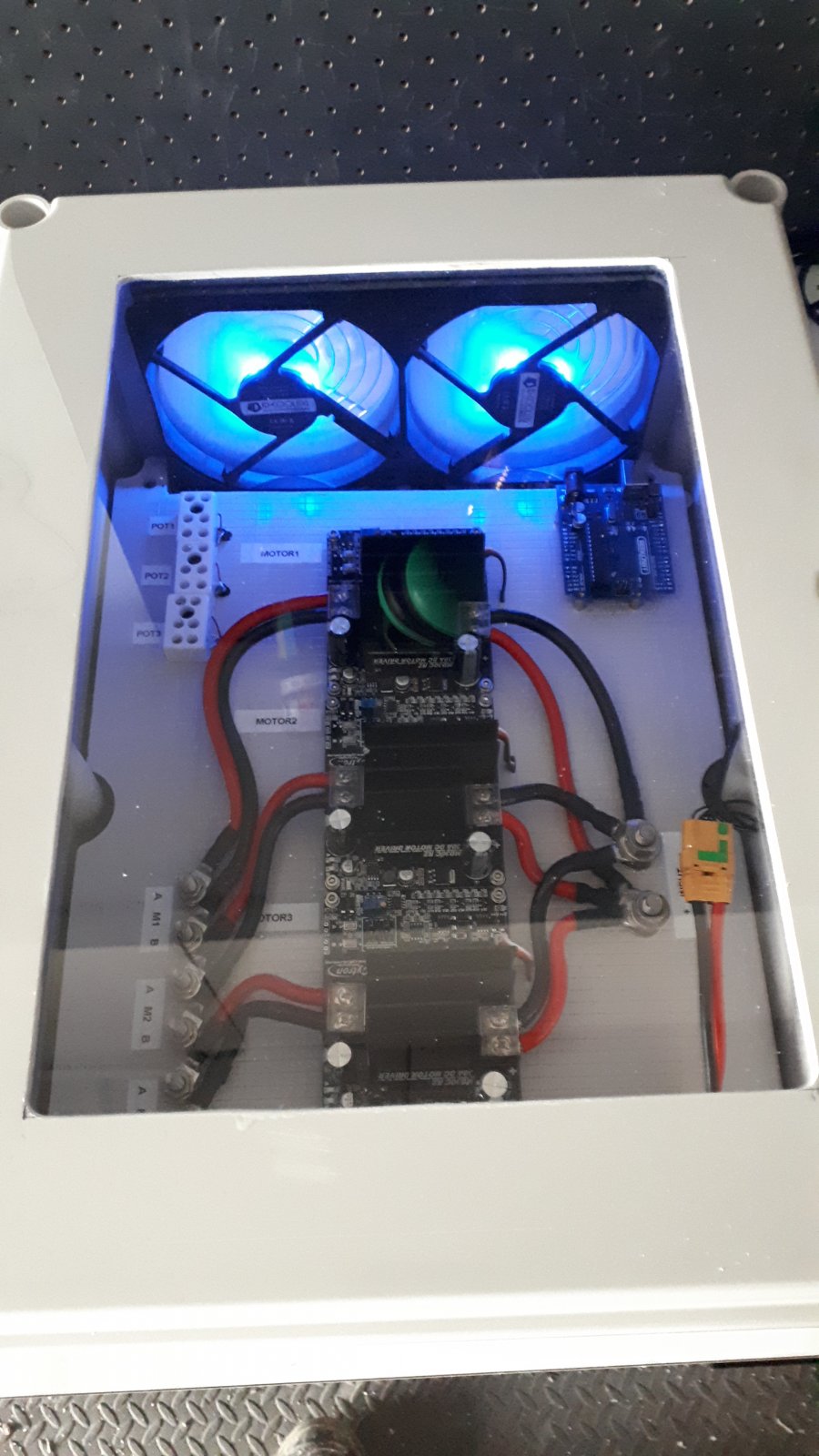

    Update.....
    More work on the control box, wiring almost complete, Still need the final two fans, lid is done now, Trying to decide whether to paint :think
    Then onto the frame next week :grin
