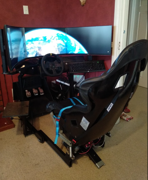

    I wanted a triple screen rig but didn't have space for a big one or want to spend a whole lot so I built my own.

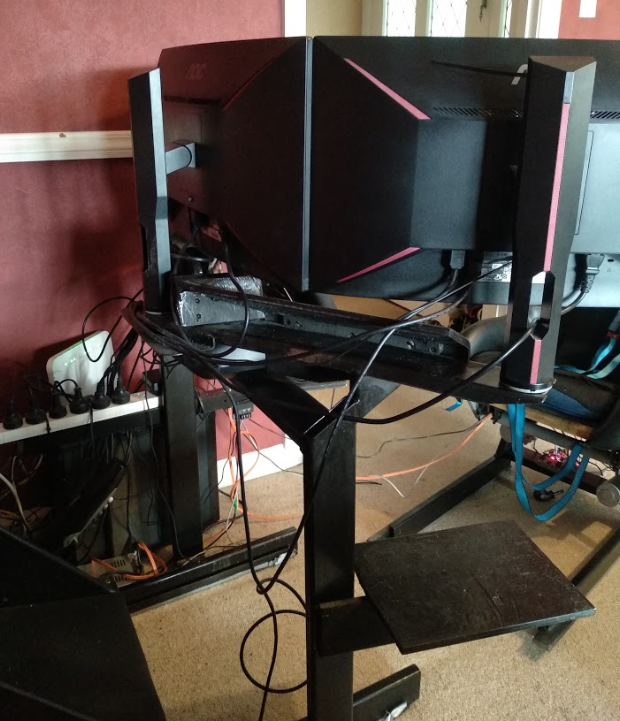

    The three main things I did to keep the footprint small (for triples):
    1. using small screens mounted close
    2. having the seat adjustment via telescoping the frame so when I push the seat in, the frame tucks in also
    3. a fairly unique motion system which doesn't need extra space for rig movement
    I ended up building the frame from 25 x 75mm RHS welded for rigidity. I worked out all my cut lengths so it could all be cut from the one length of material and adapted the original screen mounts to retain the adjustment features an reduce fabrication and materials.
    There were quite a few minor revisions along the way but the result is detailed below

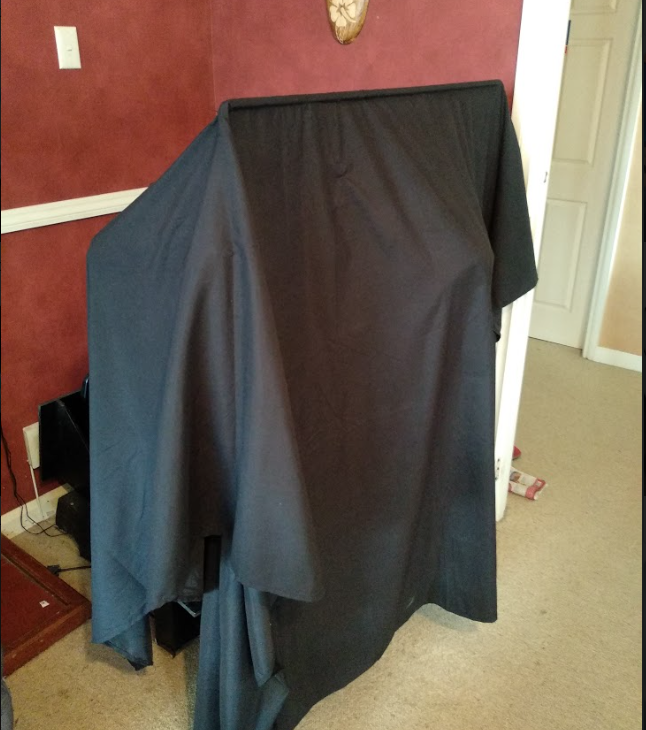

    Here it is tucked away in time out...
    And stretched out for use...
    (the hood actually stays on for use but took it off for visibility in the photo)

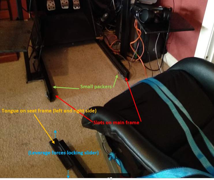

    The seat sliders lock up by levering the tongues against the slots as pictured below. Small packers at one end of the main frame set the slots at a slight incline relative to the ground ensuring my weight in the seat provides initial preload/lockup. Force exerted when braking adds to the levering force locking the sliders even tighter. Doesn't budge at all even under my heaviest braking, but if i take my weight off the seat it is free to slide.

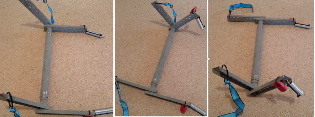

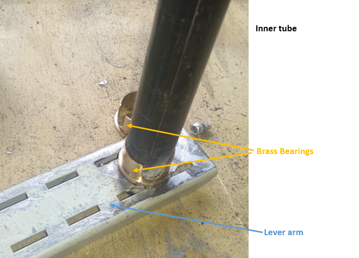

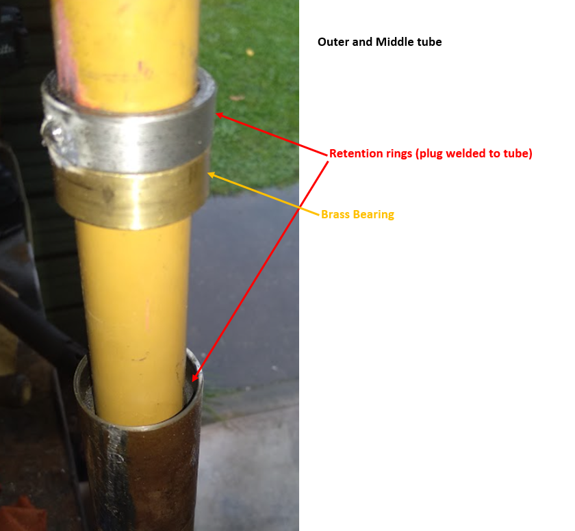

    To meet these findings I needed to transfer forward pull from the left motor to the right side (and vice versa) without crossing straps. I did so using fairly simple lever mechanism detailed below.

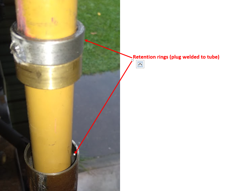

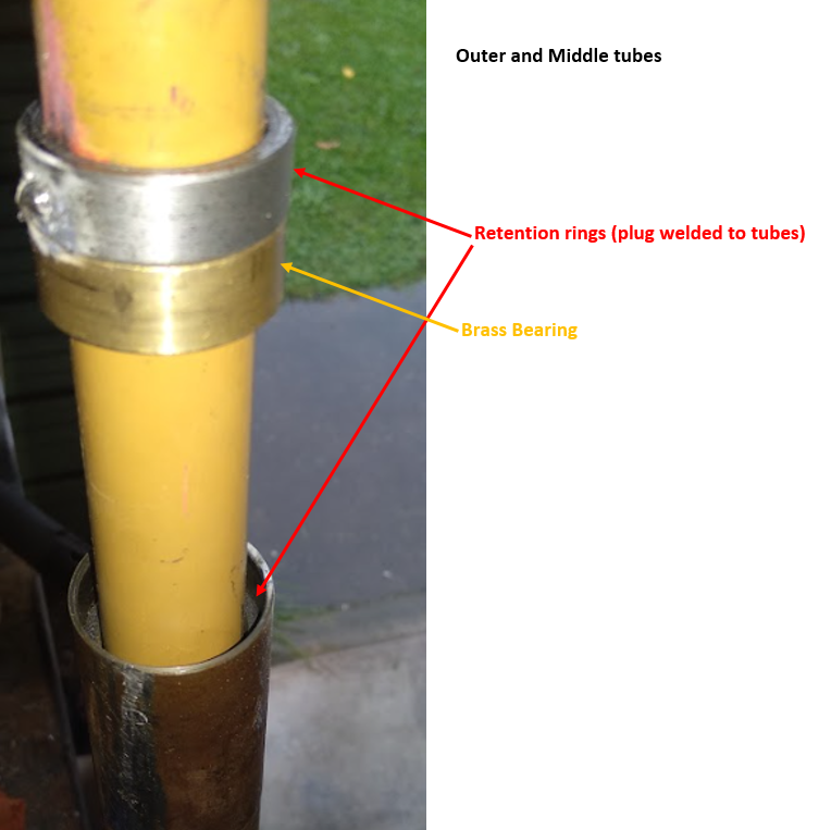

    So there is three tubes running inside each other, each welded to their respective levers at either end.The rear levers on each side are then linked to the motors. I was lucky enough to find a broken swingball set and an old shock absorber giving me three tube diameters which fit accordingly. I found some brass scrap, machined up some bearings to make it fit and some steel retention rings to weld into/onto the tubes for the brearings to shoulder up against. Had to use dodgy gasless wire as it was thin material and I had no gas for MIG
    Done, few pics in different orientations
    It works well, running Arduino Uno clone, SMC3, Moto-Monster motor shield, 2 x 12v 60W motors and a 30A 12V power supply.
    The only issue I have to resolve is a clash between my SimHub shakers and Simtools. I can get the port forwarding to work, but Simhub seems to want more detailed telemetry from LFS than Simtools will accept, so I can either get Shakers to work well with poor motion, or really good motion with poor shakers. I really want both, my shakers work really well so I won't go without them. Any help would be greatly appreciated - maybe it is not an issue with plugins for other games?

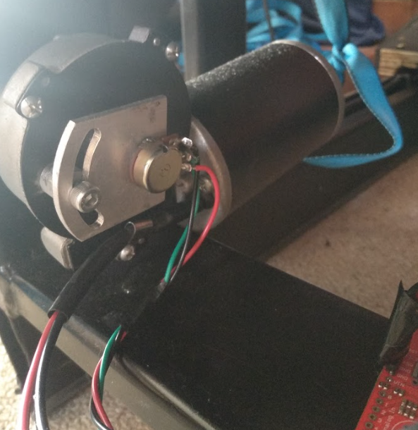

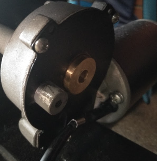

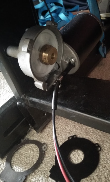

    Potentiometer drive - machined a drive bush corresponding hole thru my gearbox casings...
    Machined and welded threaded bush to casing... upload_2021-5-29_20-57-17.png

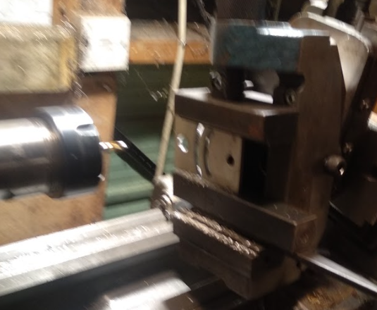

    Terrible pic of machining radial slot in potentiometer index plate... (i clearly don't take time for photos when im busy building)
    Pot mounted in indexing plate... What a godsend... was a nightmare before i added this adjustment
    motor mounting and slotted drive bush... (many holes and marks from previous trials...)

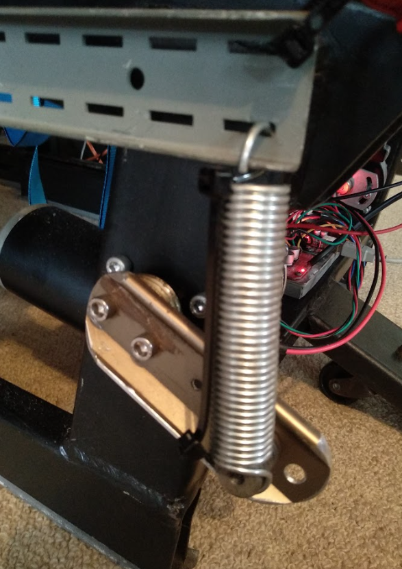

    Bedspring instead of rod end to deal with angular misalignment.... cable tie to limit stretch (YUCK! it works * shrug*)

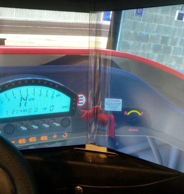

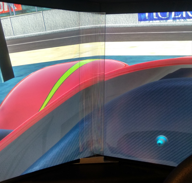

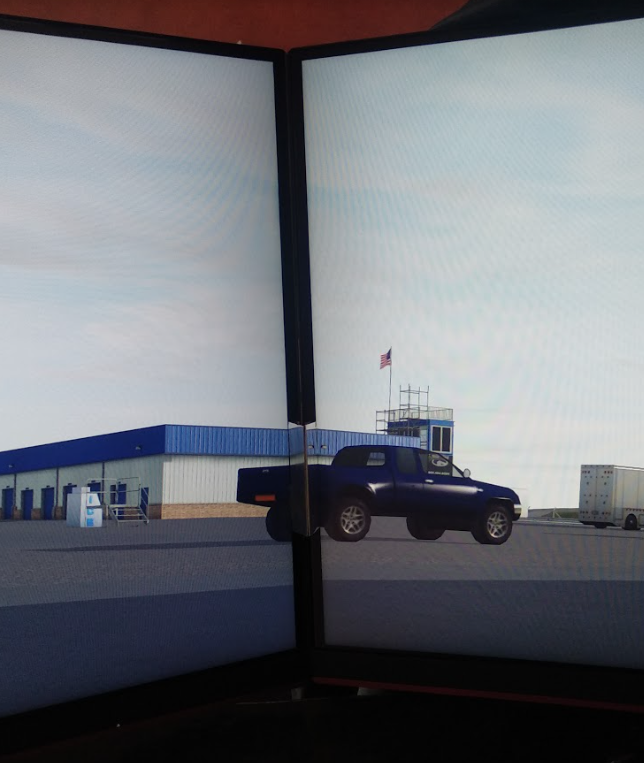

    test piece for effectiveness of my super cheap bezel-free kit... with small screens I didn't want to be distorting a significant portion of good image with a fresnel lens so i went reflective instead. Fully done now but this test piece at the truck shows the difference well

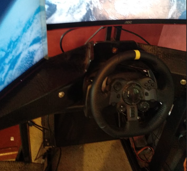

    laid carbonfiber over over a plywood dashpanel, drinks stand and mouse pad. The dash really serves to hide cables holds the suction cup behing my wheel for attaching phone (running SimHub Dash)
    Screens still go up and down, handy for when i'm not racing and don't want the wheel obstructing my view

    Liking your sim,
    Can you explain how the 'bezel free' works, is it a mirror tape?

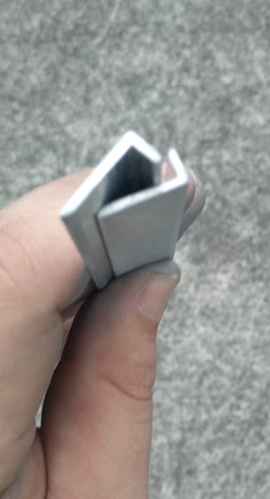

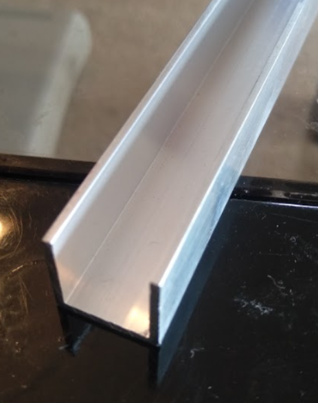

    Yeah no problem - it was a super cheap idea that worked really well!
    It is aluminium angle, polished, clearcoated (so it doesn't oxidise and lose its reflective properties) and stuck to the black edge of my screen.
    I had seen someone do something similar with mirrors, but on old screens with big bezels which i couldn't replicate on modern screens with thin edges (plus I had no idea where to get custom mirrors made?) I had a think about it and clicked that aluminium is cheap, light and easily polished so gave it a go.
    Do some measuring to figure out what will work for you. In my case i needed aluminium rightangles 20mm x 7mm to fit my screen - my screen edges are 7mm, and at 7mm in from the edge, the 2 right angles would intersect at less than 20mm out from the display (16mm was enough, but my screen mounts can rotate so a few mm gap between stops adjacent screens crashing into reflectors if i shift them)
    Find the cheapest, lightest aluminium section you can find to do the job at the local bunnings or similar, some double-sided tape, a cheap can of clear and some polishing compund (the stuff which is used with a buff in a battery drill makes life easy)
    I already had everything except the aluminium, I bought 1m of 20 x 20 x 1mm channel for about $12NZD, cut to length then split down the back as in pics below:
    polish 'em up, clear coat, stick 'em on - job done!
    A tip I would add is best results are achieved by sticking them direct to the screen surface if possible and make sure the reflector covers all the black portion next to the pixels, as any remaining will be reflected and it interrupts the illusion somewhat. Pay particular attention on the side screens, parallax becomes a factor as these screened are viewed from an angle and have a clear layer between the pixels and the surface. Simple solution is to check from the normal driving position as you fit the reflectors, ensuring all the black is covered

    your bezel free solution is really neat !
    i have a friend who has a glass company and may be able to cut me some mirror !
    do i want a mirror on each bezel frame or one mirror between the 2 bezels ?

    I have 2 reflectors back to back where screens meet, so one on each bezel, reflective surface at 90degrees to the display. 4 reflectors in total - 2 on the middle screen and one one the inner edge of each side screen if that makes sense. Your friend could maybe do something in one piece but it would need 2 reflective surfaces, the angles and fit would have to be perfect too - the result would be good though if you could get it right.
    I thought about prisms but going down this path would likely lead to linear fresnel lenses instead, as this is what the commercial options appear to have settled on.
    I did investigate Linear fresnel lenses somewhat and it would be interesting to try, they are plentiful on Aliexpress etc in a good range of options, you would need to do a bit of R+D to find figure out the right width and focal length.
    I had not seen the reflective wrap post, but my first trial actually was aluminium tape. I quickly realised i could polish a piece of aluminium instead and it could be a lot smaller, more rigid and durable which was the next trial piece i show in my first post. My final solution turned out to be a lot easier to handle and arrange than tape/cardboard, would definitely recommend going straight to aluminium section rather than tapes/wraps

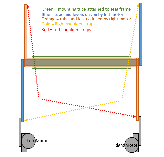

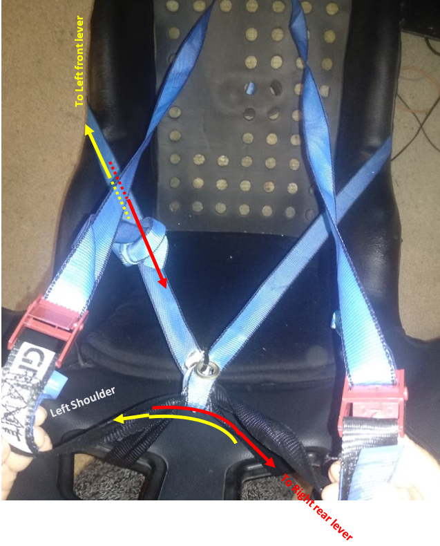

    I'll try to explain here by focusing on one shoulder and one motor. This photo still distorts the situation as the straps wrap around your body rather than running straight but the following points should locate everything:
    • The red buckles on the end of the black straps are sitting over your shoulders
    • The rivet where all the straps meet is on your back right between your shoulder blades
    • the blue vee of straps joined at the rivet run from center of your back - the left one we are talking about in this example wrapss diagonally down across your lat towards kidney then out the front to left front lever.
    • The left front lever is rigidly connected by a tube/axle under the seat to the right rear lever as per the diagram posted earlier (ignore the straps in the previous diagram, that is a slightly different configuration also possible with this setup). When one lever pulls the other does the opposite and loosens. This double acting lever is driven both ways only by the right motor.
    • When the left front lever pulls forward (yellow arrows) you feel a push in your back as it pulls you forward and to the left from the center of your back where all the straps meet. At the same time, the rear right lever loosens the strap over your left shoulder, allowing the movement forward and left
    • When the right rear lever pulls back (red), it pulls your left shoulder firmly back and to the right and the front left lever loosens it's strap behind you.
    • Note that the black strap over your left should runs through the right seat belt hole in the seat. This allows significant force to the side
    Along with the left shoulder control described there is of course an opposite setup driving your right shoulder/flank:
    • when these systems work in opposing directions, they can provide strong sideways forces/body movement into your fixed seat, and best of all they can but sustained as long as you continue cornering
    • when they work in the same direction, the will either apply pressure from the back (accel) or tighten down and back on your shoulders, also sustainable.
    • Interestingly, this is a combination of reflecting true G-force (when cornering/sway/roll) and the not so-true Reaction force (when brake/accel/surge/heave/pitch). As I mentioned other configurations are easily achieved, I originally set this this up with as all true G-force, but i found i preferred the reaction force for front/back
    • heave is also surprisingly effective in this config, pitch and roll less so (they give false cue of surge/sway if too strong, a shame because they feel great in a big crash)

    I have finally traded out the springs and cable ties for proper rodends which became necessary with increased force of the lever ratio I run now.

    Hi @JBung gotta say i loved the Bezel idea ,so crazy thought , would this work with say 2 x 32" monitors , Thinking mainly for F1 Sim with HALO .. Cheers GYI im going shoping for monitors tomorrow and might need side trip to DIY store now lol , Thanks for posting

    It can work with 2 monitors as long as you bring them in on enough of an angle that the edges of the reflectors meet nicely in the middle, and the sim will need to be able to correct for screen angles (angle correction is often built around triples but it might work?). Getting the edges to meet nicely will be important (with triples you hide hide the edge of the inner screen reflector just behind the edge of the outer reflectors, not sure if the same can be done with 2 screens as the join is directly in front of you) .
    You may also need to set your in game viewpoint quite close to the halo so that the reflections don't include the sky/scenery (would be more distracting than black space to have reflected scenery in the middle of the halo. Moving closer makes halo wider, until there is enough halo either side of the reflectors nothig else shows in the reflection.
    The in game dash could be messy with reflected text, but if you run an external dash (ie simhub on a phone)in front of the game dash that won't matter

    Curiosity got the better of me again. I bought a single linear fresnel lens from ali-x (300x100xf40) around $25USD +shipping/tax.
    My setup is likely a little different as i run small screens up close and wanted to minimise distortion/obstruction of my center screen. My lenses mainly take the image from the side screens and stretch it to hide the bezels rather than blending from (distorting) both. Plus I am cheap and wanted to only pay for 1 lens. To achieve this I split it down the middle to make 2 opposite lenses, the cut edges (formerly the center of the lens) sit against the outer screens.
    The trickiest part of the whole thing was mounting the lenses. Best solution ended up being stands the lenses clip into which i made by cutting and folding some aluminium angle as pictured (with some soft foam feet to allow them to be squeezed under the screens and held firmly in place)
    Still need a coat of black paint at some point...
    Results are pretty good (pics below). Probably not as good as the more expensive off the shelf options with slight distortion of the sidescreen image at the merge point but I achieved my goal of leaving the main center screen almost untouched. In theory a slight performance bonus as i am no longer rendering extra resolution to compensate for GPU bezel correction.
    I do prefer this over my previous cheaper reflector mod, purely because the the reflections could produce slightly distracting images particularly with shapes which ran at an angle over the meeting of the screens, as the reflections would be at opposite angles. BUT the reflectors were really effective for the minimal cost. upload_2022-2-18_10-59-45.png

    oh yeah and I converted my G29 pedals to 100kg Loadcell.
    This worked great, using INA122PA (so direct pot replacement, no need for arduino or extra software etc) based on a combination of info from @RacingMat and this tutorial https://imgur.com/gallery/gOjAf#SXX5zrY
