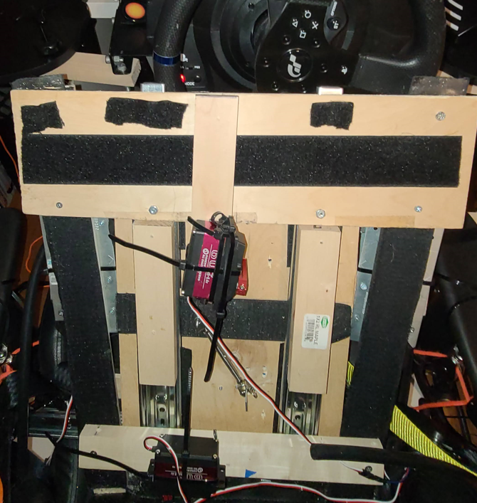

    4) Move lumbar support sideways for sustained traction loss
    With the same idea for sustained heave, I added sustained traction loss. Using a 14 inch drawer slide connected to a small piece of plywood, I added a lumbar support that moves sideways one inch in either directly for traction loss. It's a simple trick, but it has helped to maintained sustained traction loss and better catch slides. Previously, I mostly just felt the onset of traction loss since the back of the chair was only sliding an inch in either direction.
    Here's a picture of the back of the frame, which is velcroed to the actual chair:

    Four 10x10 inch zinc plated hinges https://www.homedepot.com/p/Everbil...Plated-Heavy-Duty-Strap-Hinge-15406/202034149
    Arduino board (I used a Mega 2560, but really an Uno would work just as well)
    Four 11x4 inch air wedge bladders for seat https://www.ebay.com/p/4011529979?i...OGIY3AkWtWYWj-qi2p_2ObJDRScAiedxoCFbMQAvD_BwE
    Four 6x6 inch air wedge bladders connected to servo/hinge
    15 feet of cable 5mm (3/16 Inch) inner diameter high performance silicone vacuum hose line (for connecting servo air bladder to seat air bladder). FYI I recommend getting 20 feet .
    Four 5mm (3/6 inch) nylon tee vacuum connector (one for each pair of air bladders)
    11 inch male-to-male dupont wires
    Three 3x7 inch galvanized plates for attaching servo for office chair spin as well as office chair caster wheel stoppers https://www.homedepot.com/p/Simpson...X-Galvanized-Heavy-Tie-Plate-HTP37Z/202329565
    One 8 inch zinc-plated corner brace for connecting office chair to servo for spin https://www.homedepot.com/p/Everbilt-8-in-Zinc-Plated-Corner-Brace-15215/202033926
    Two 4 inch zinc-plated corner braces for attaching three 3x7 galvanized plates to milk crate https://www.homedepot.com/p/Everbilt-4-in-Zinc-Plated-Corner-Brace-2-Pack-15309/202033899
    Four 3 inch zinc-plated corner braces as a safety stopper in case the zip ties ever break https://www.homedepot.com/p/Everbilt-3-in-Zinc-Plated-Corner-Brace-4-Pack-15307/202033902
    Two 2 inch zinc-plated corner braces for connecting chair spinning servo to three 3x7 inch galvanized plates https://www.homedepot.com/p/Everbilt-2-in-Steel-Zinc-Plated-Corner-Brace-4-Pack-13611/203170052
    Two silicone caster wheel stoppers (I like the ones with a dip in the middle to prevent any kind of wheel slide
    RC camber linkage rod (to attach to servo to extend arm for office chair spin)
    One 8.75x6.25 inch plastic cutting board (for attaching 8 inch corner brace to chair for spin https://www.ikea.com/us/en/p/ikea-3...BoL05uw65uQg4nvwYifua1BKS4xTnE3BoCcWYQAvD_BwE
    Old to-go food container for propping up wires and Arduino (in case anyone ever spills something on the floor)
    Reusable plastic bag for base of g-seat
    Two foam pool noodles (for side support) (https://www.walmart.com/ip/SwimWays...epjABOXCfyksCRDTJh-NY6jXVfhCnTHxoChoEQAvD_BwE
    Velcro strips to position air bladders to seat via reusable plastic bag
    Velcro wire tie for connecting 8 inch corner brace to servo for spinning chair
    Duct tape for connecting foam pool noodles to reusable plastic bag
    Electric tape
    4 inch 8.2KGF zip ties for servo arms (I then used the 11 inch 22.6 KGF zip ties to connect to hinge) (https://www.homedepot.com/p/Commercial-Electric-4-in-UV-Cable-Tie-Black-100-Pack-GT-100MCB/203531918)
    14 inch zip ties for securing cutting board to seat
    11 inch 22.6 KGF zip ties for connecting hinges to milk crate and 4 inch zip tie to hinge. (https://www.homedepot.com/p/Commerc...able-Tie-Black-20-Pack-GT-280STB-20/300645008)
