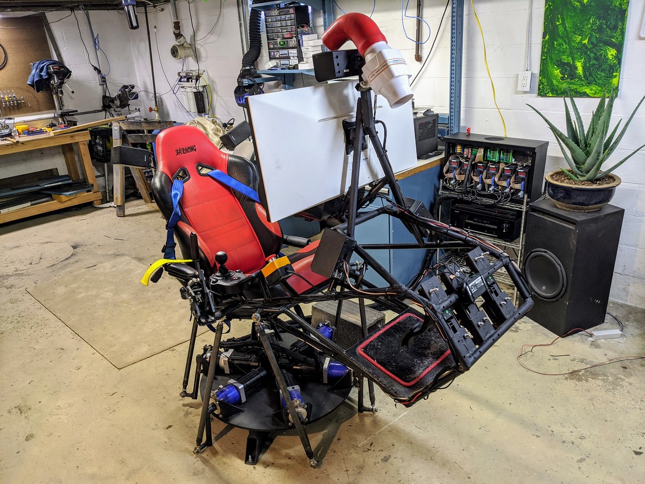

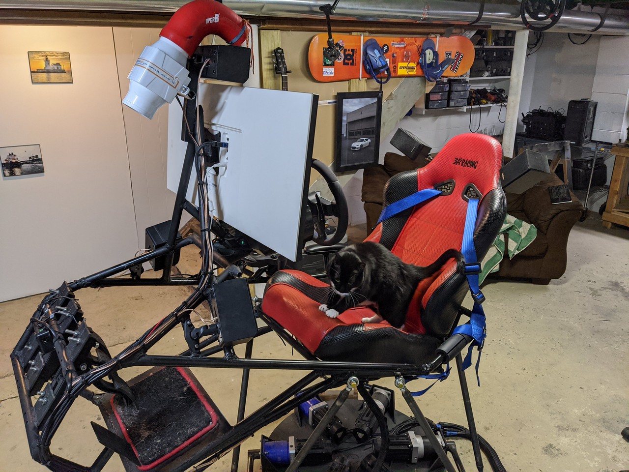

    A compact 6DOF platform I have been designing/building for the last 2 years, wanted to finally get it properly documented here, as I used this site as a wonderful resource that help guide me to my ultimate design. The design focuses on being compact in size yet still toss a rider around like a ragdoll...

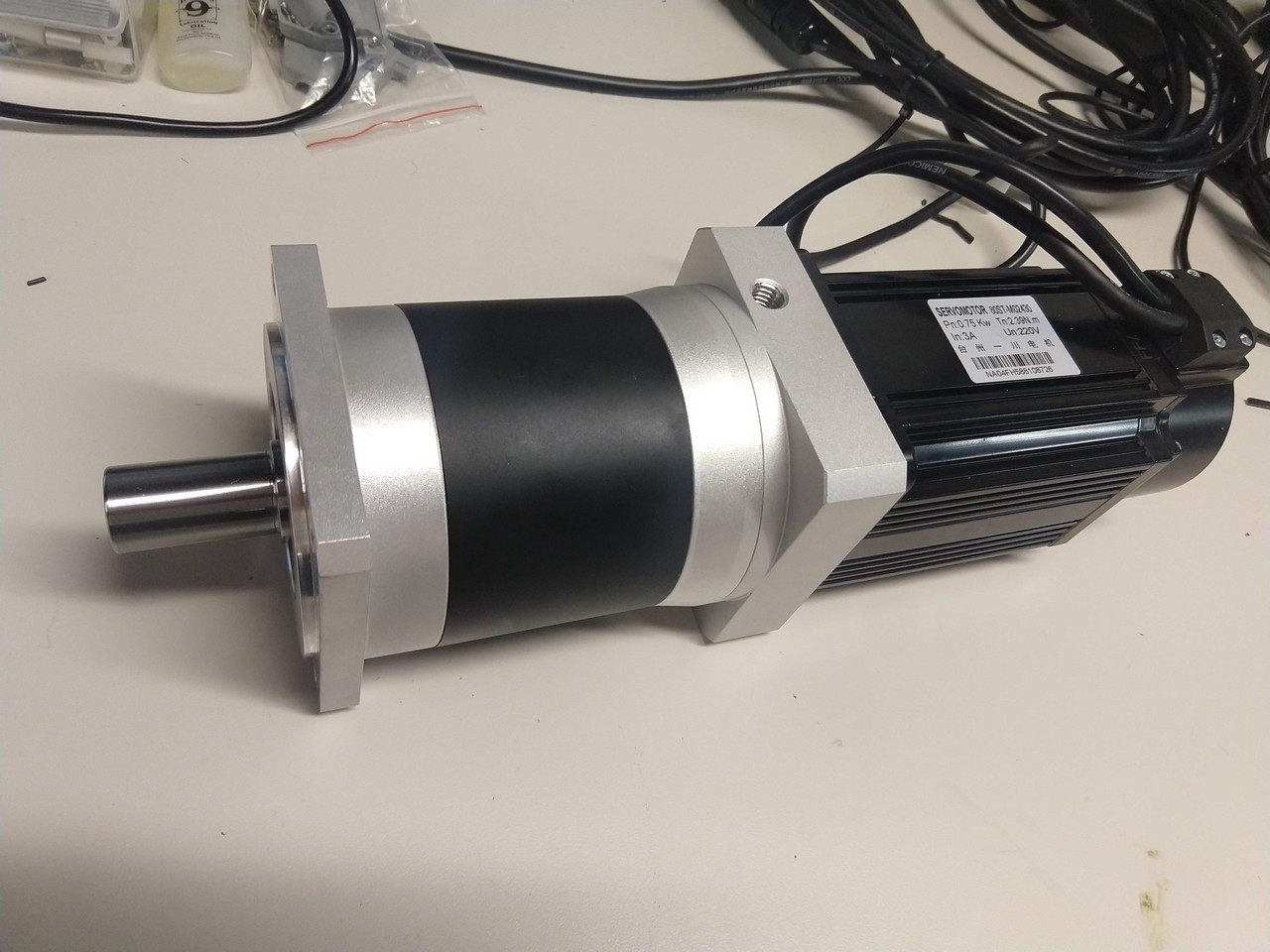

    Rotary Stewart Platform using 6 - 750 W AC servo motors w/50:1 high precision planetary gears.
    Custom PCB that hosts a ESP32 microcontroller for interfacing and controlling of the motors.
    It's also very much so... Bolted to the concrete floor!! It would leap into the air majestically otherwise
    The project is on Github, PCB, platform code and major parts used, so to help anyone else in their hunt.

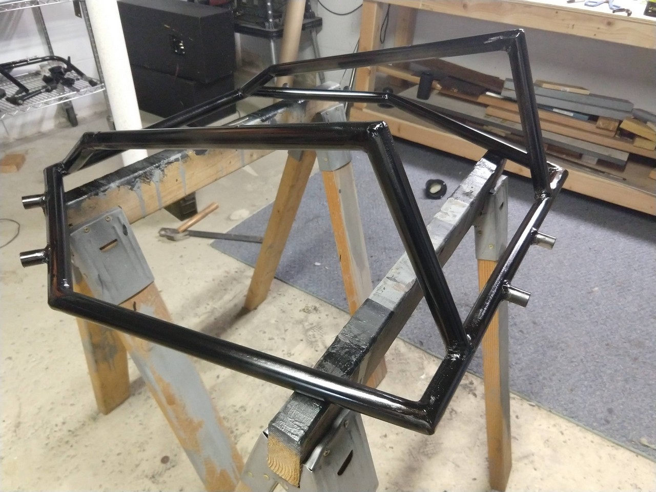

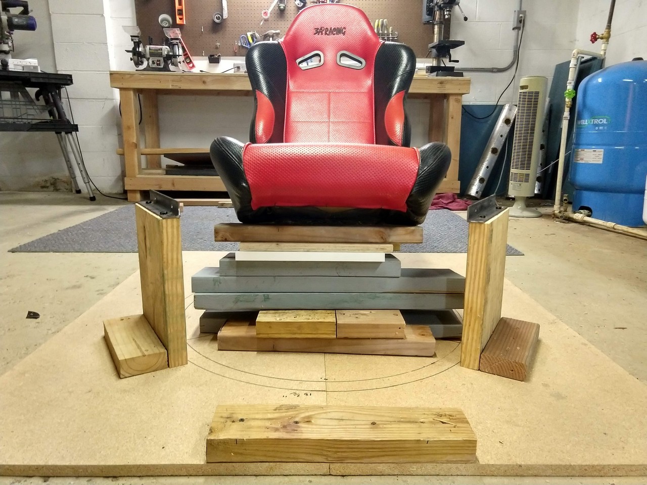

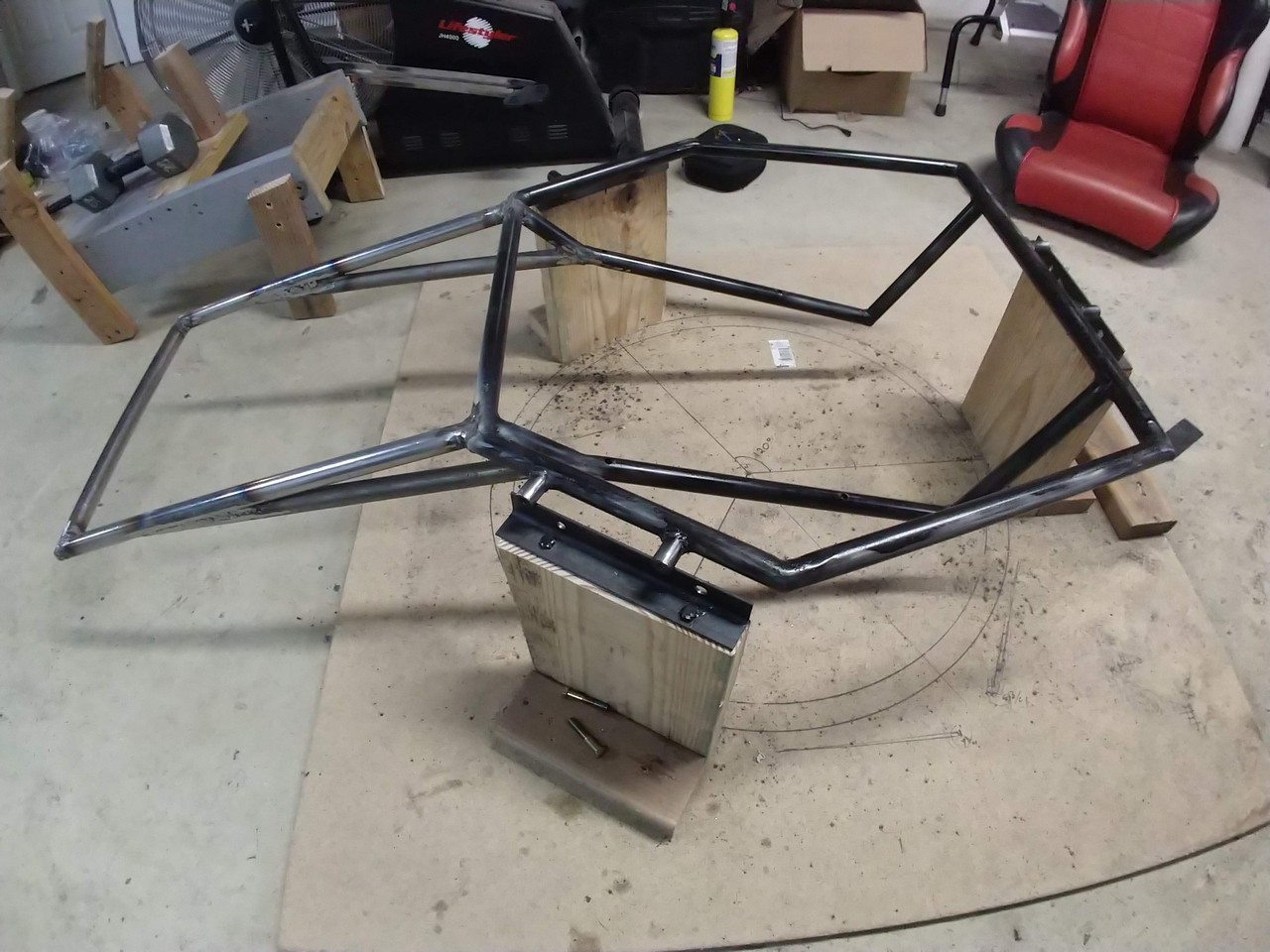

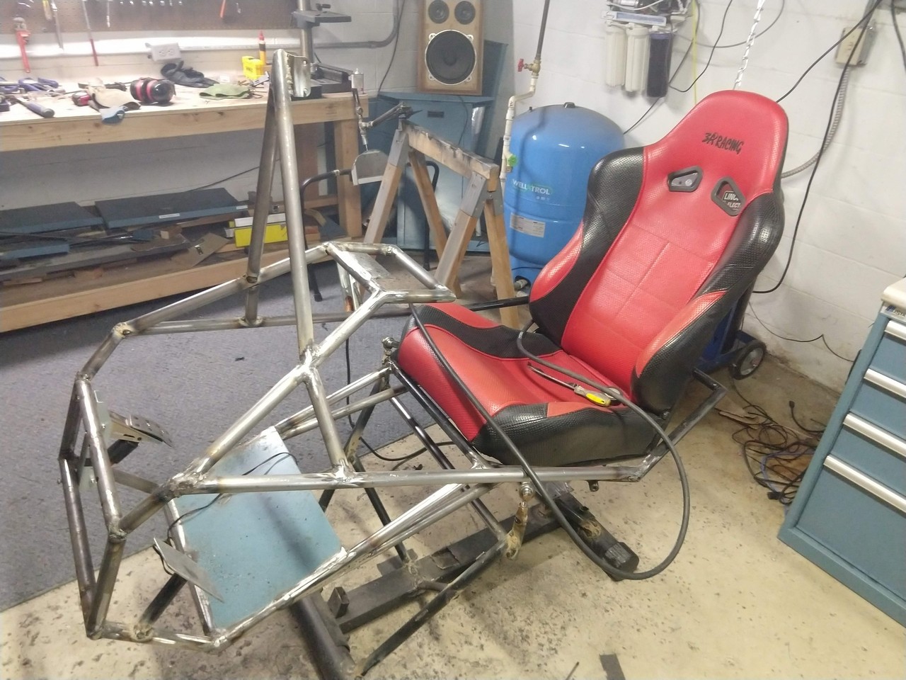

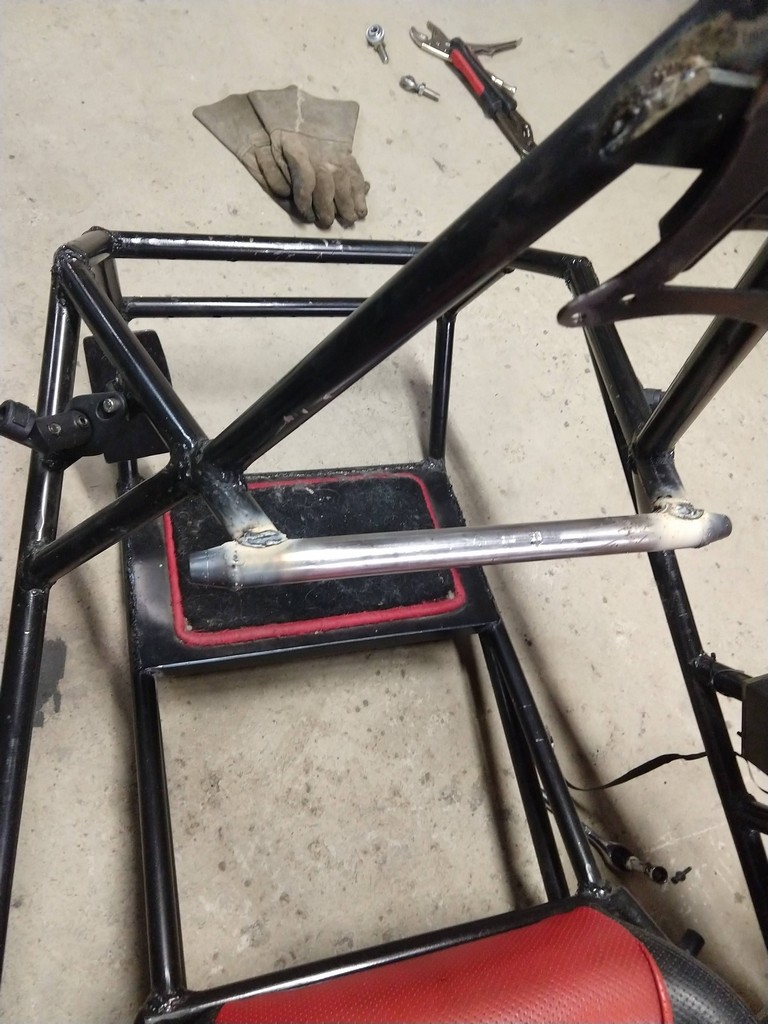

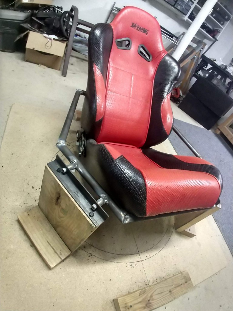

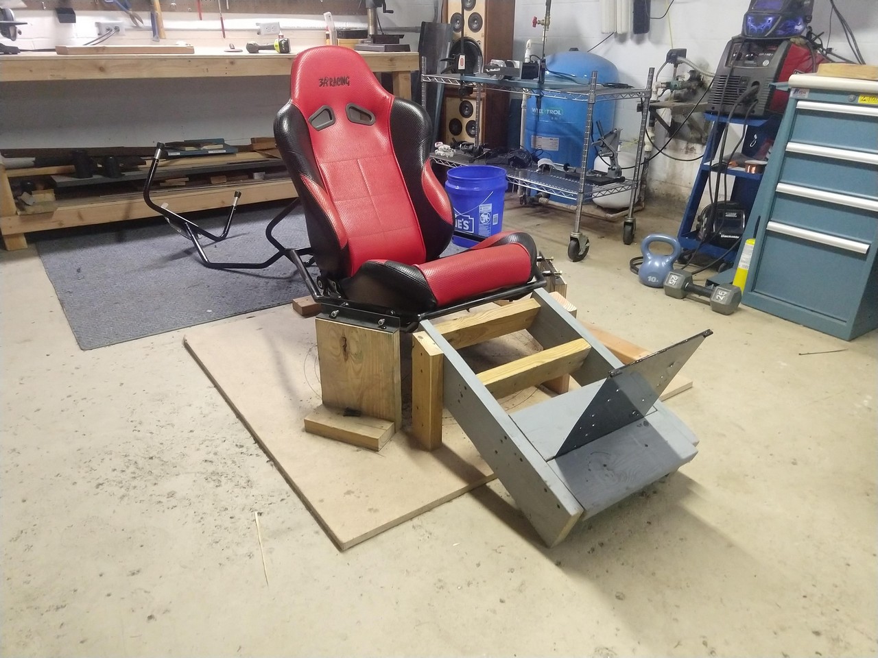

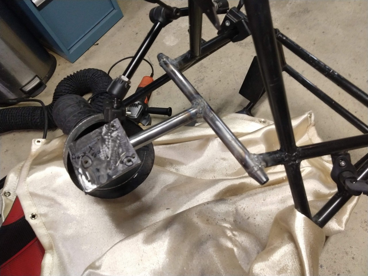

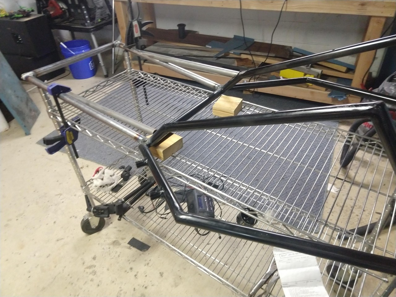

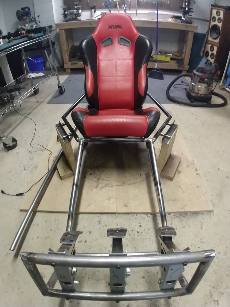

    Chassis was created around the seat itself

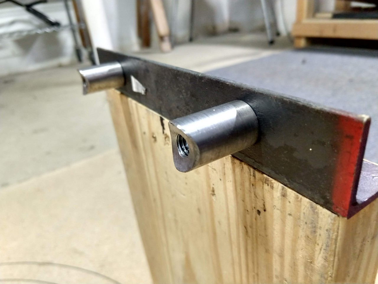

    Threaded bungs held in place by a jig
    Eye balling orientation
    Welding the Chassis to the bungs
    More,.. Eye balling orientation

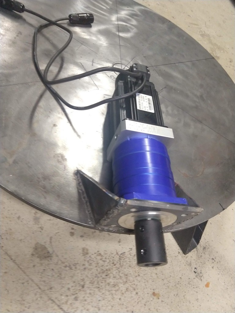

    First mating of my gear and motor trial
    Imagining more motors and lots of more work to do....

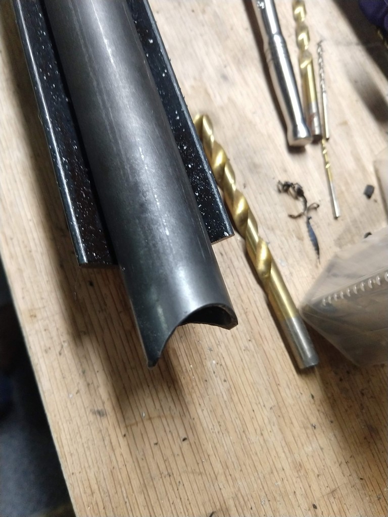

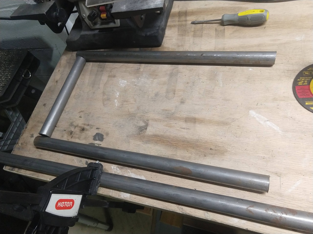

    Coped tube ends so they can be welded as cleanly as possible
    Seat bracket made, all that eye ballin payed off...
    Prevent rust, paint protection.

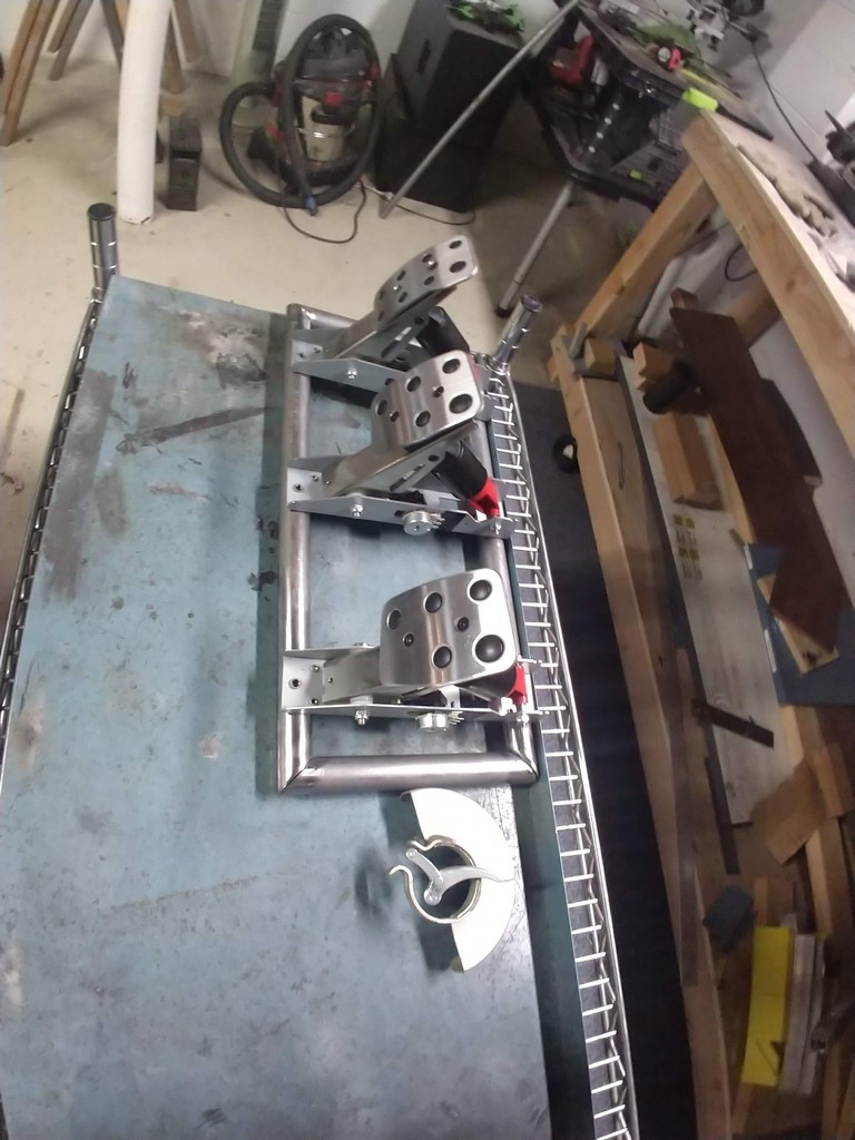

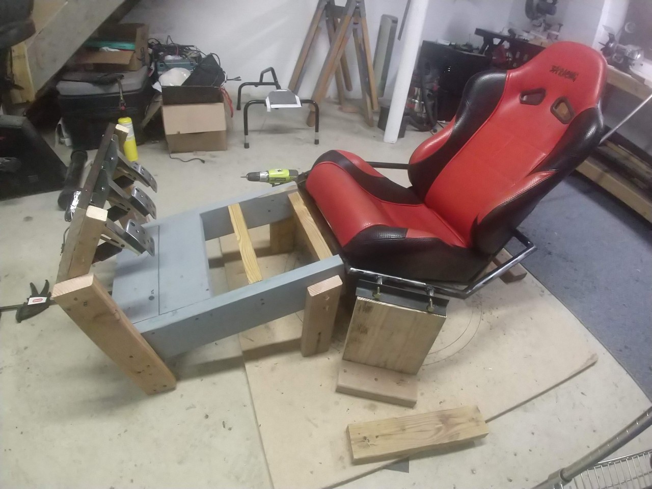

    mocking up pedal box area and slope
    Test mounting of pedals for sizing chassis
    Pedal Bracket start
    Helper
    Pedal Bracket END!

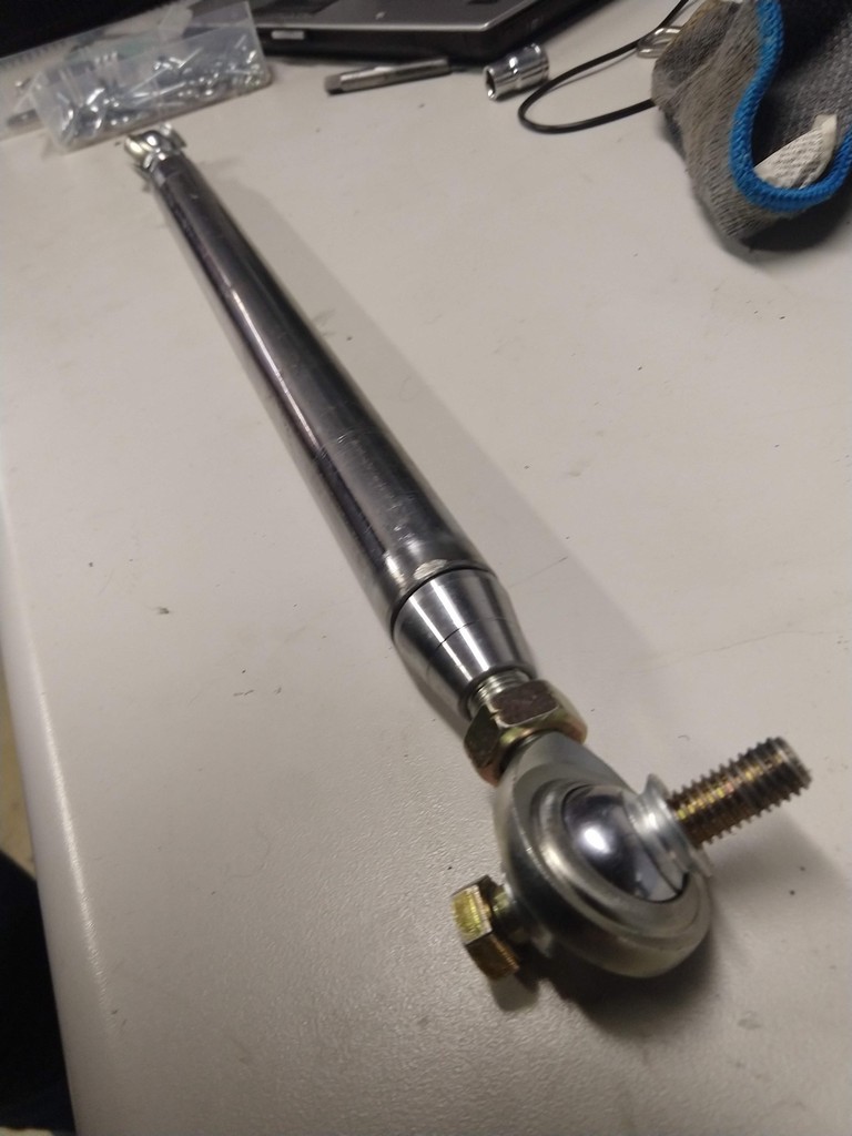

    First arm assembly - with High misalignment heim joints

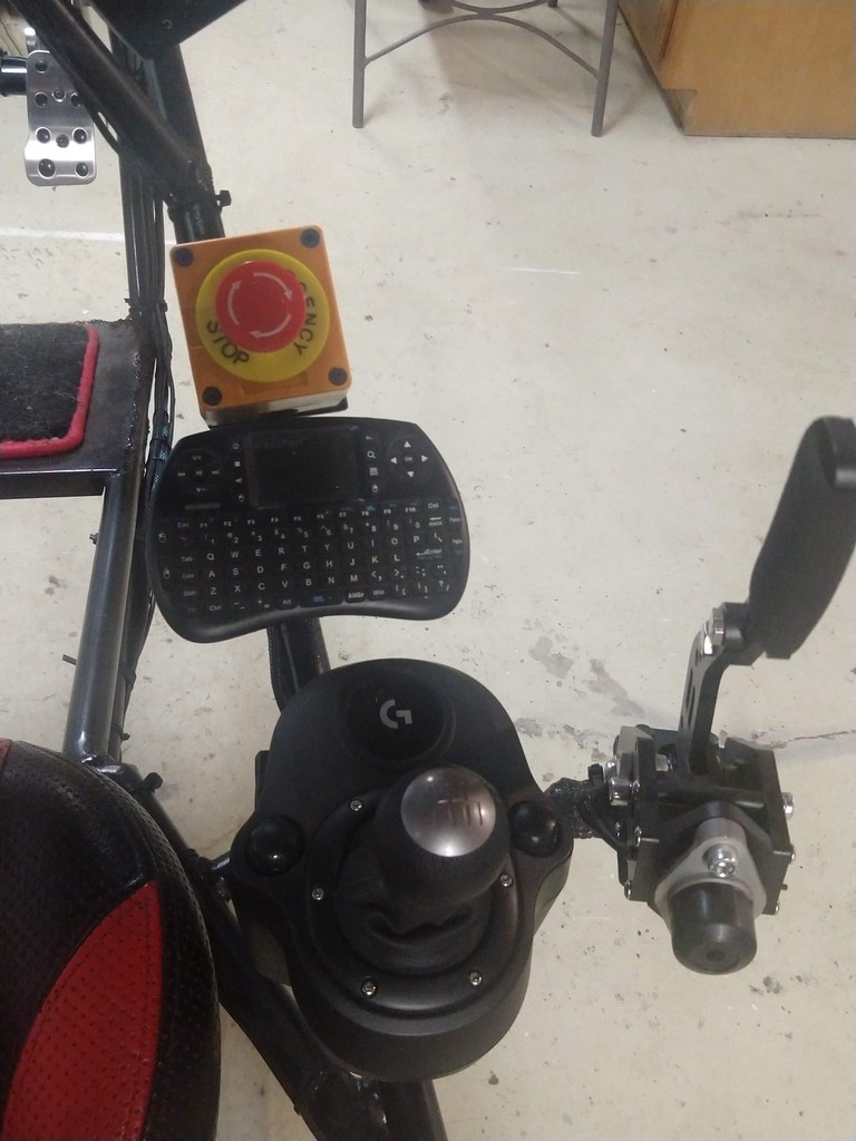

    Shifter, custom ebrake, and tiny keyboard solidly attached...

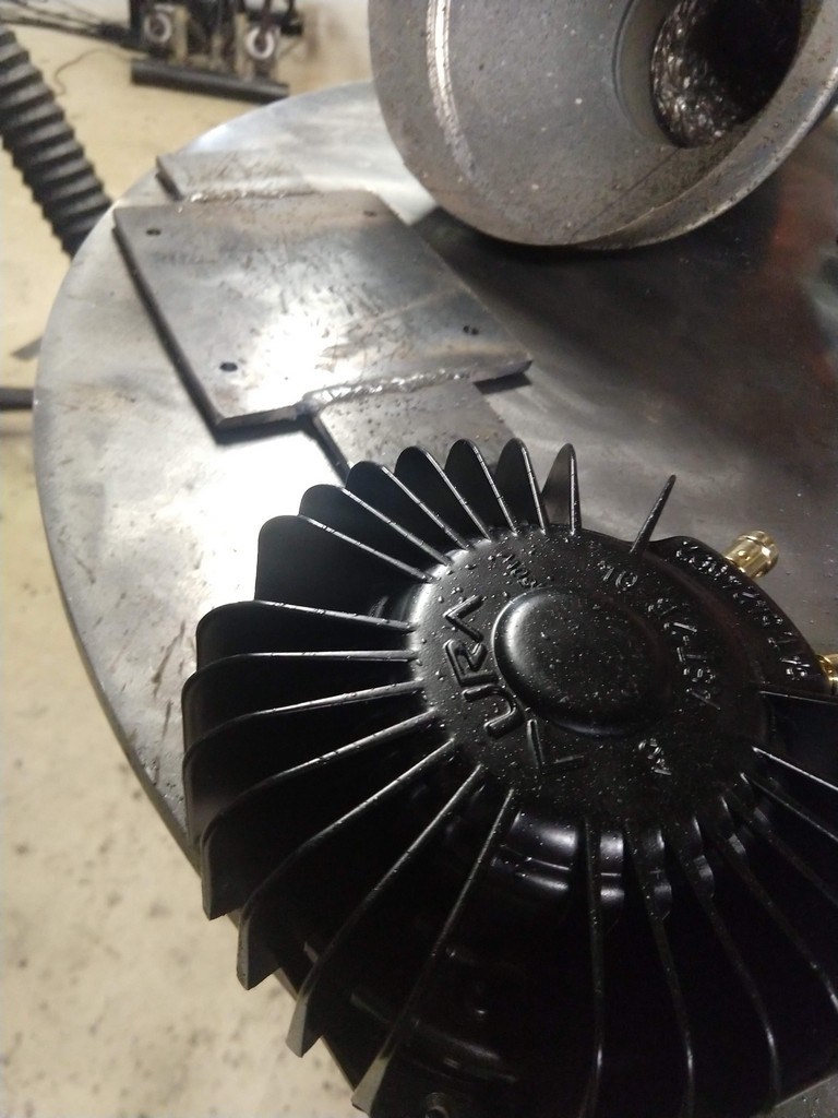

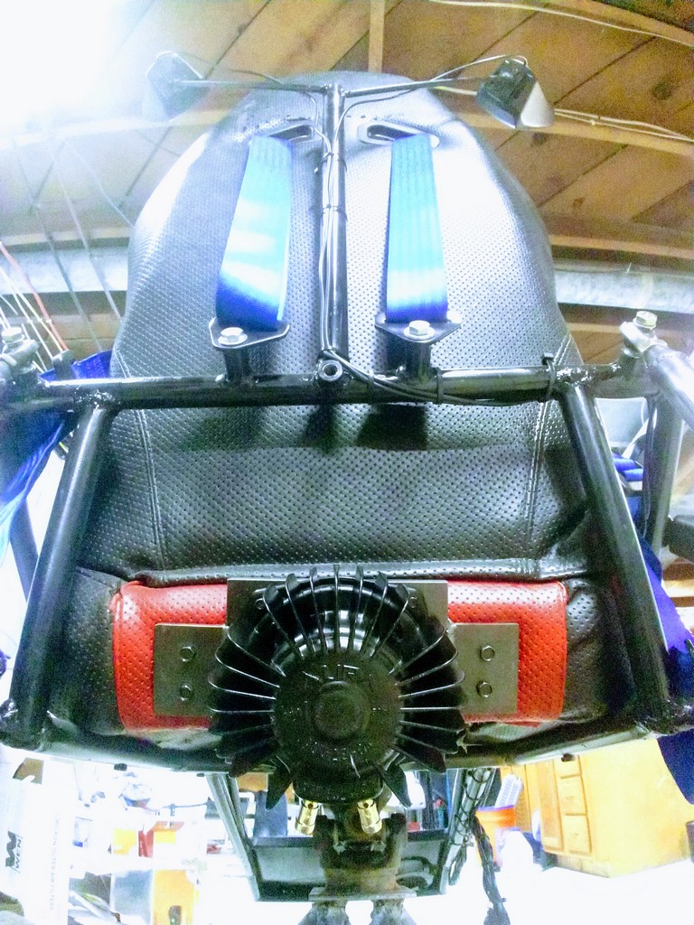

    Tactile transducer bracket...
    Tactile transducer bolted to frame of seat

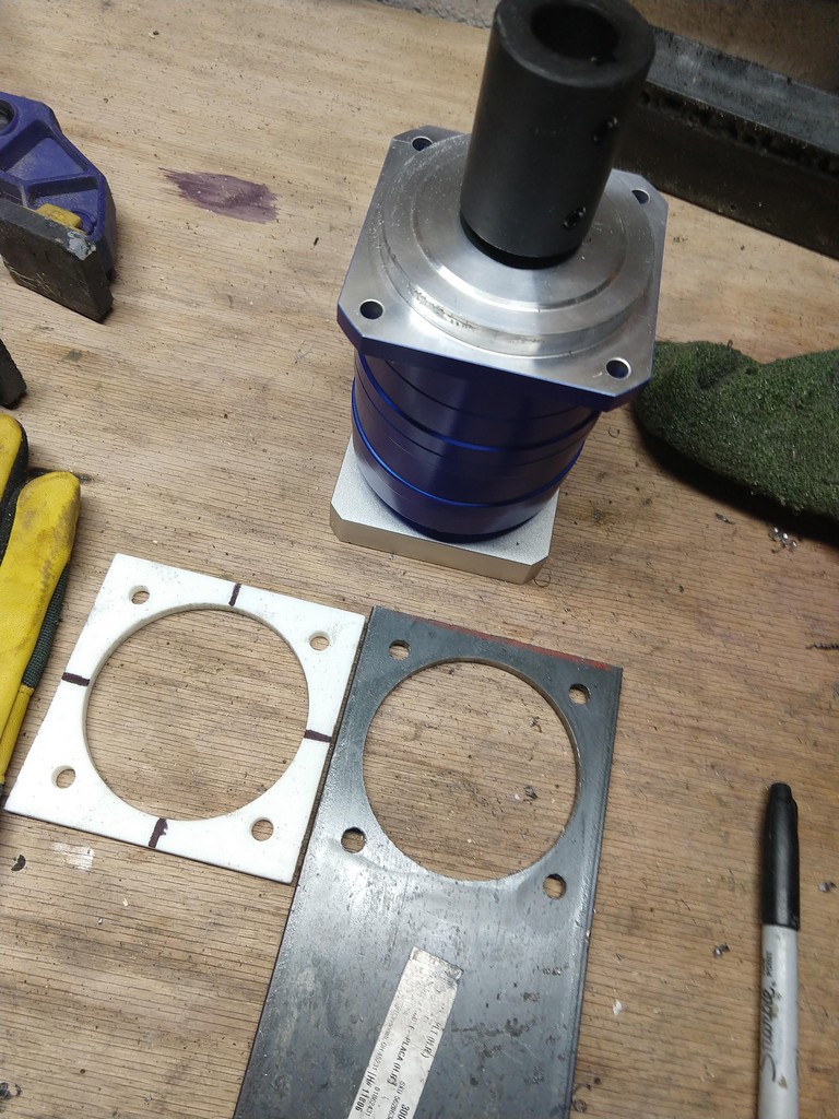

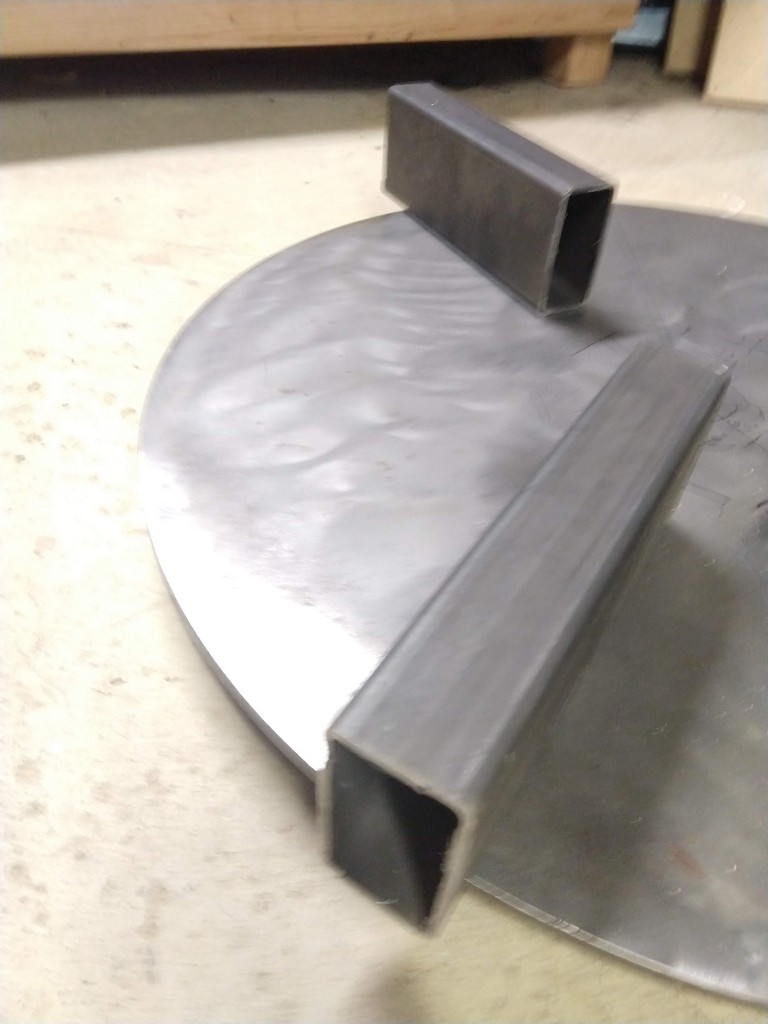

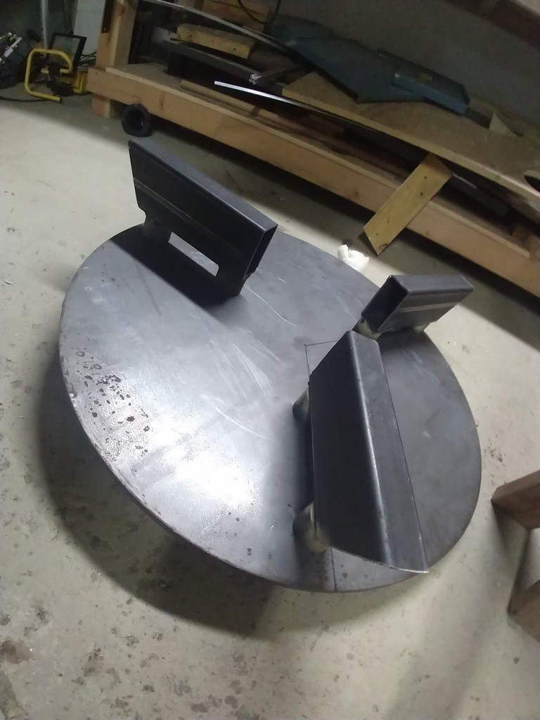

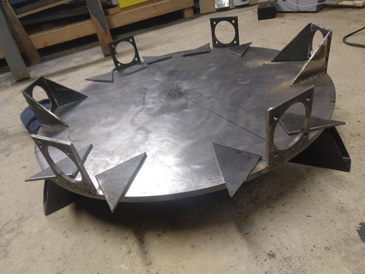

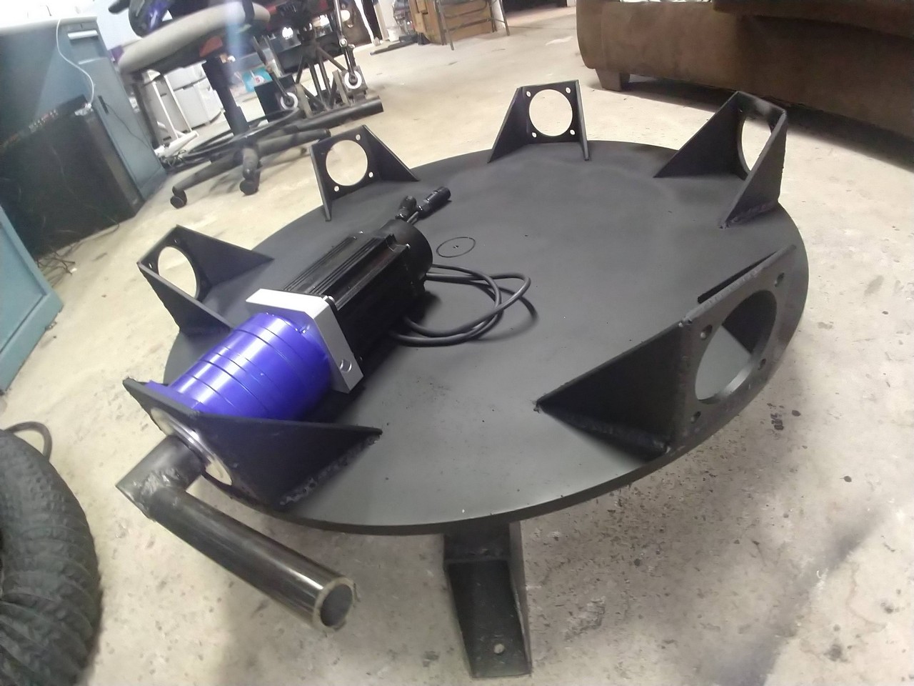

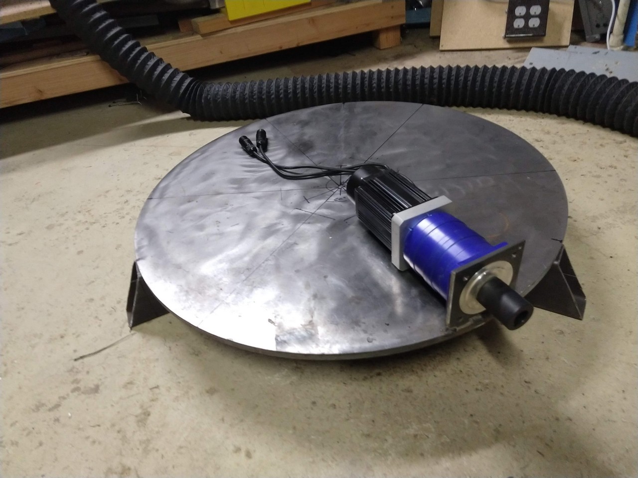

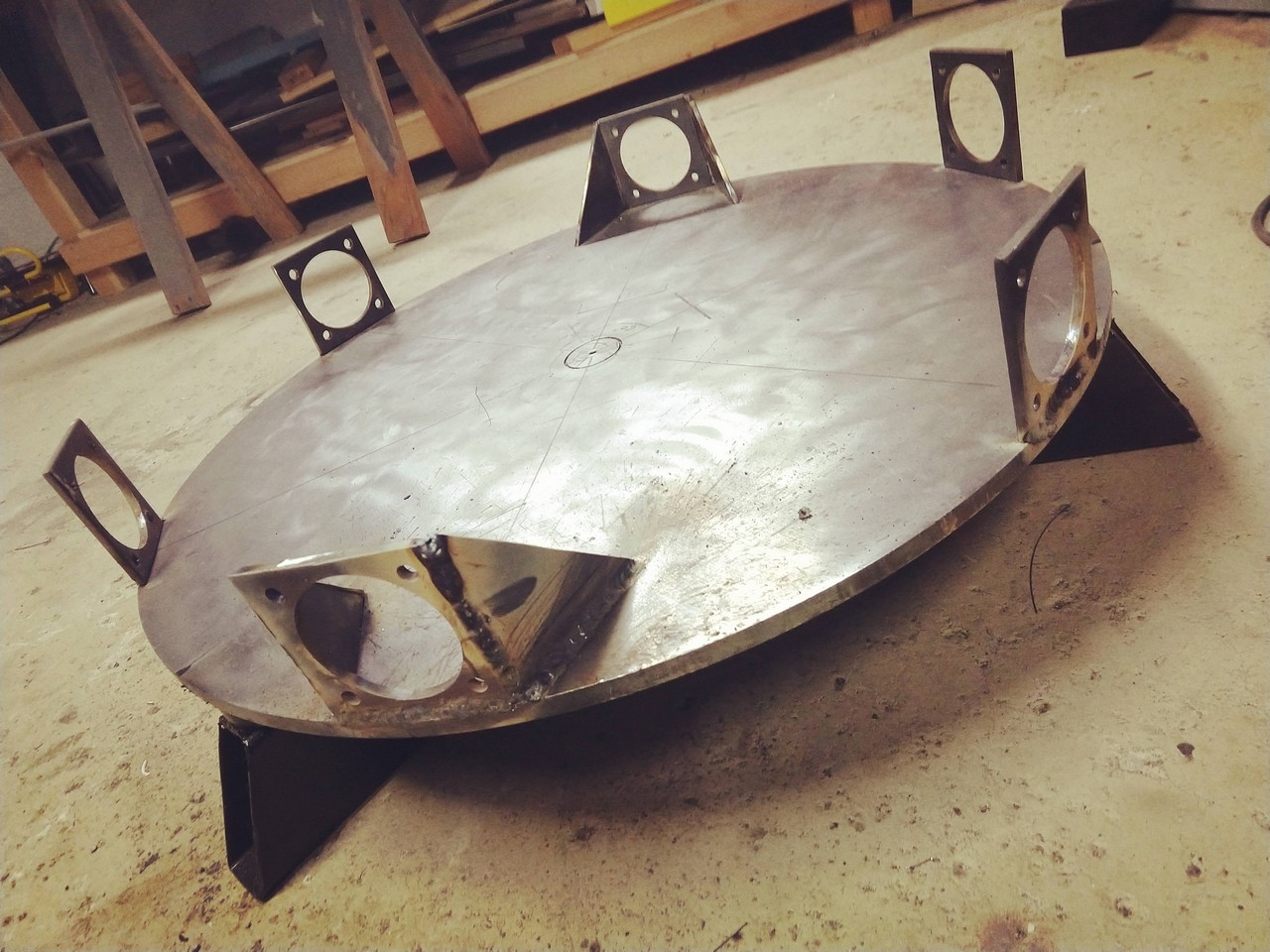

    Newer gear(less backlash)/servo sitting on a 100 pound steel plate

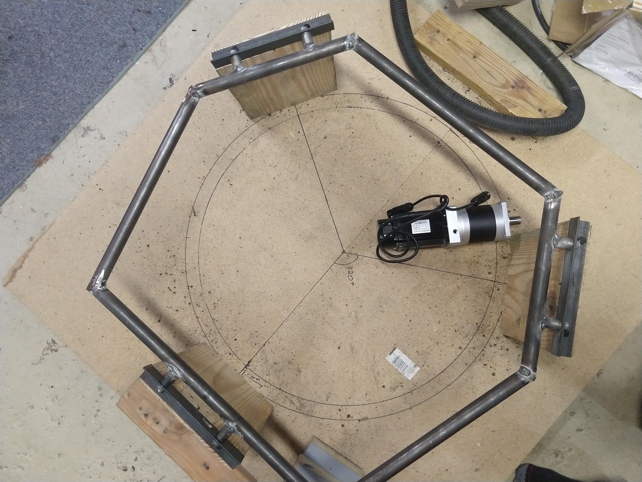

    Fabricating Gear bracket 1/4" steel plate
    Welded first Gear bracket onto steel plate

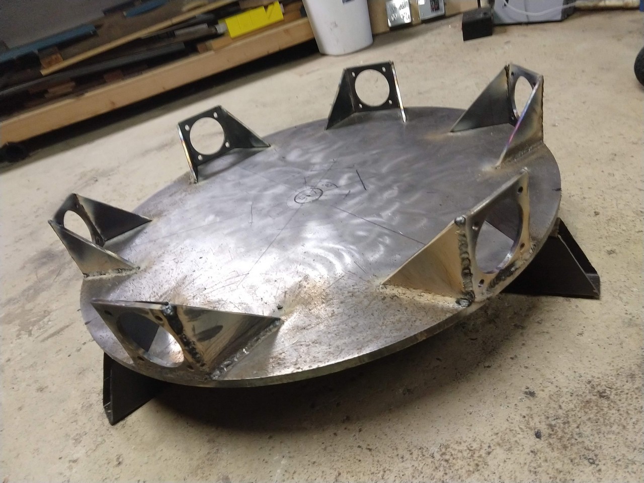

    2x3 inch steel rectangular tube, to lift the platform off the ground
    Mocking up the bottom feet area,.
    Gear/motor in place on base for first time -- Giggidy,..

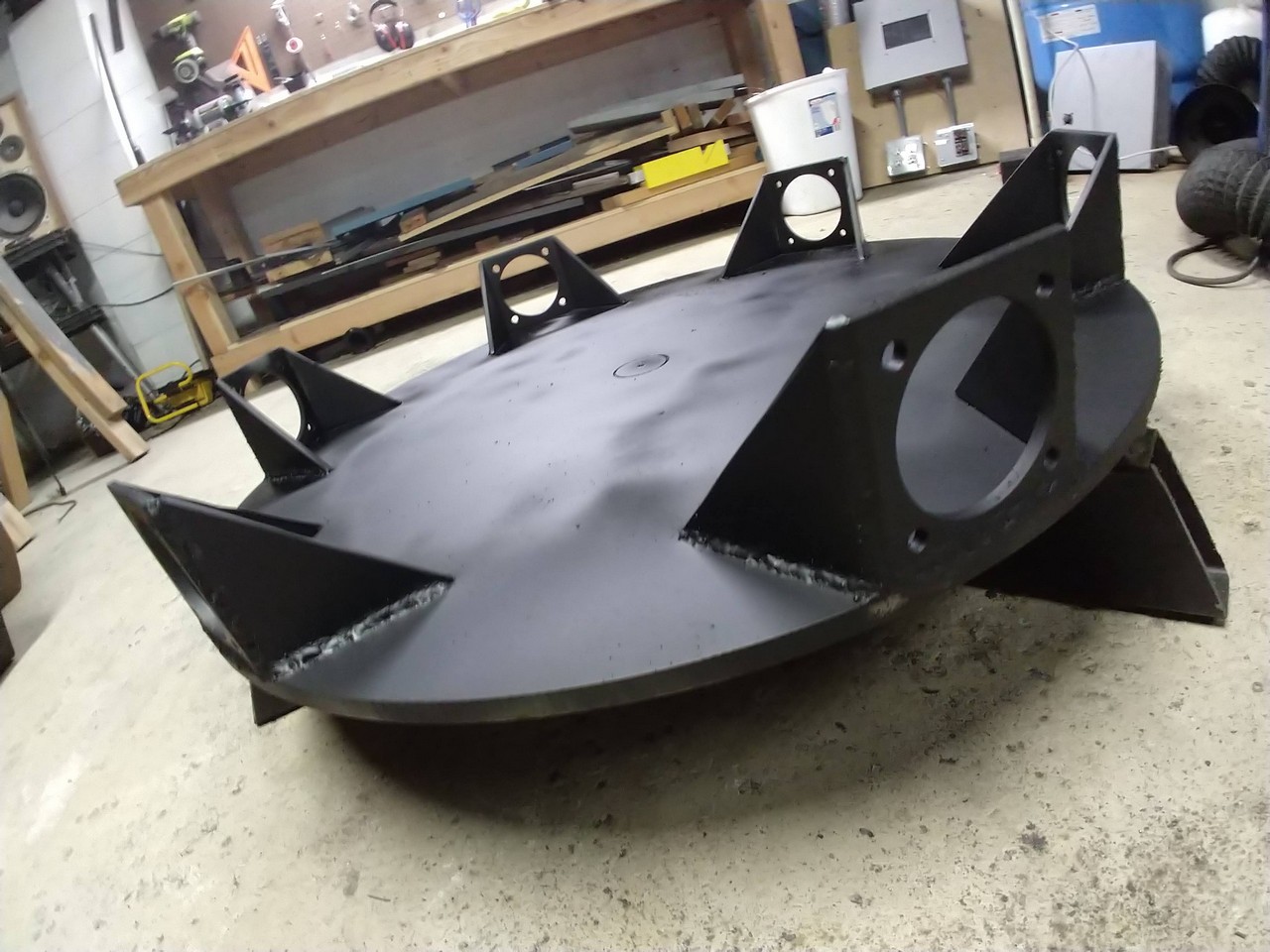

    Needed the base to be higher than the rectangle tube would allow, thick steel tubing for an extra few inches
    Pre welding mock up

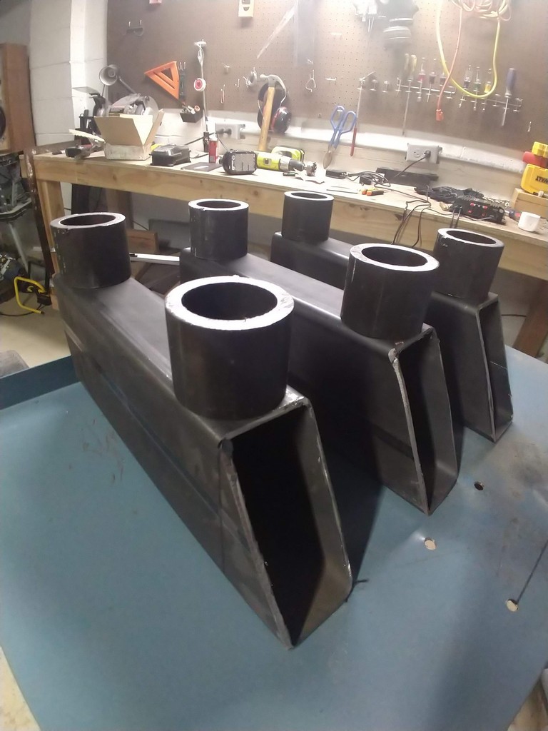

    Welded and painted
    Gear bracket support added so no flex occurs
    More Brackets
    More welding
    oh snap,..This is pretty
    Rust protection!

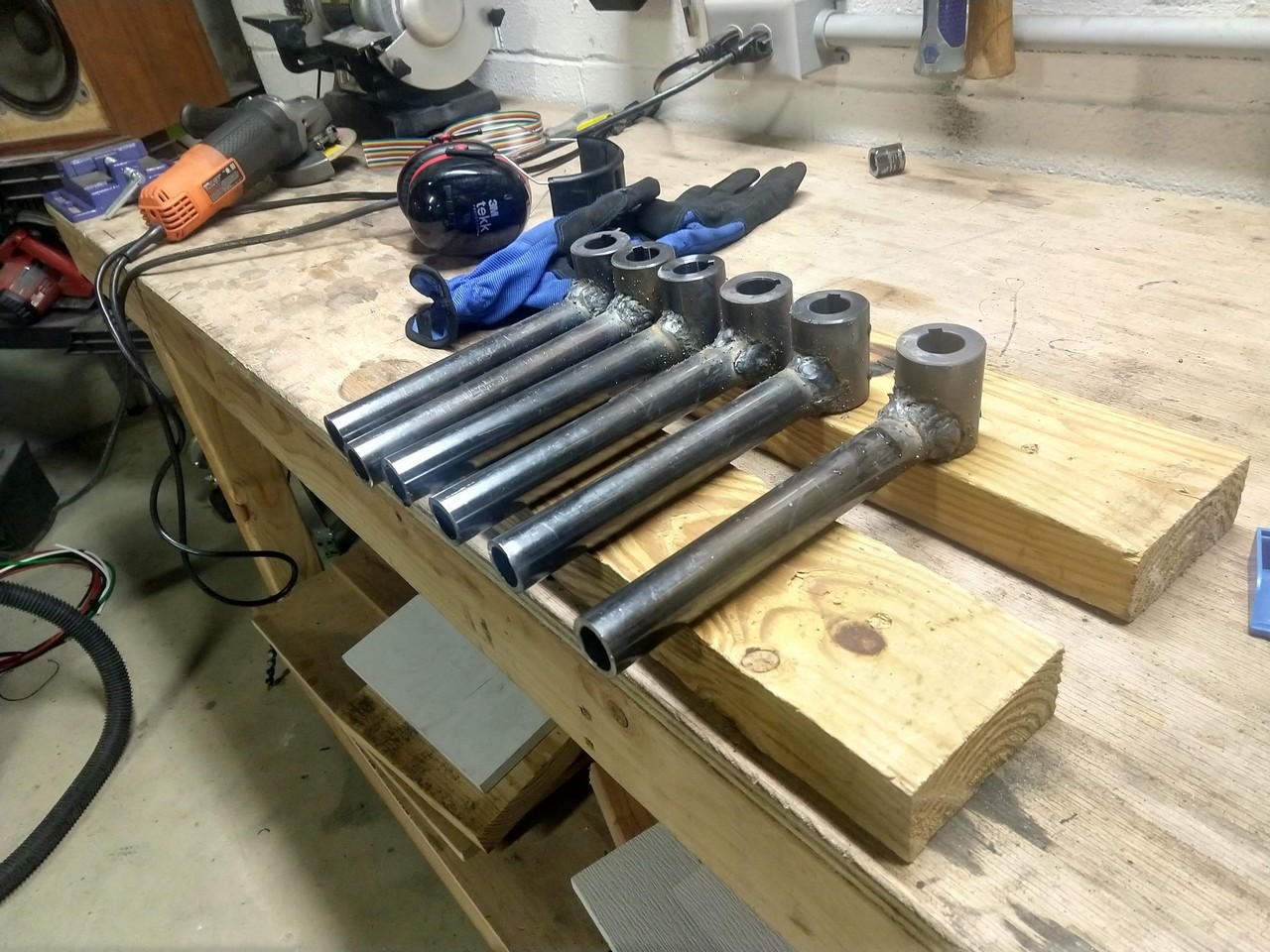

    First swing arm in place 7 1/4" long

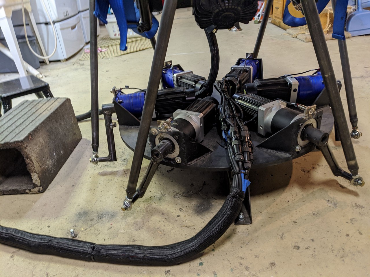

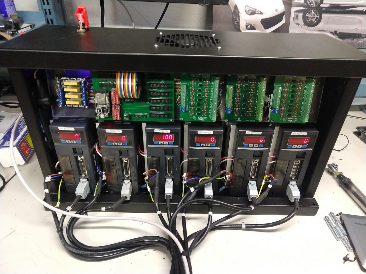

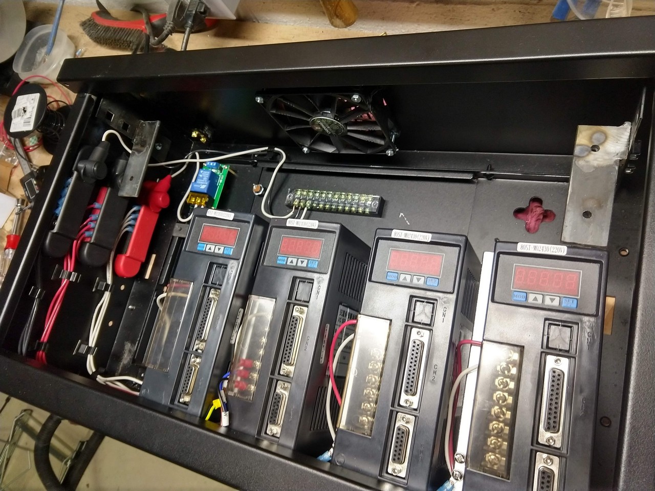

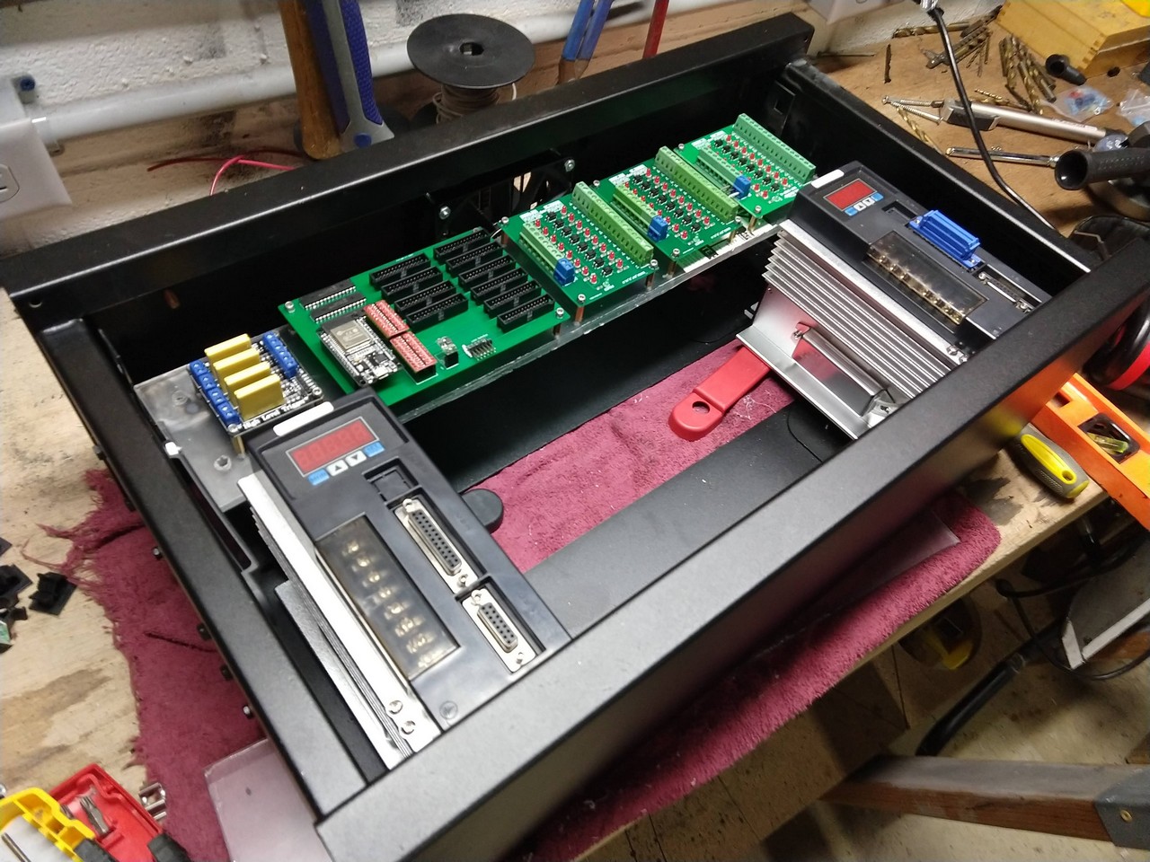

    Got a tiny server case to use to mount all of the AC Servo power supplies.. now to figure out how to stuff it all in there...

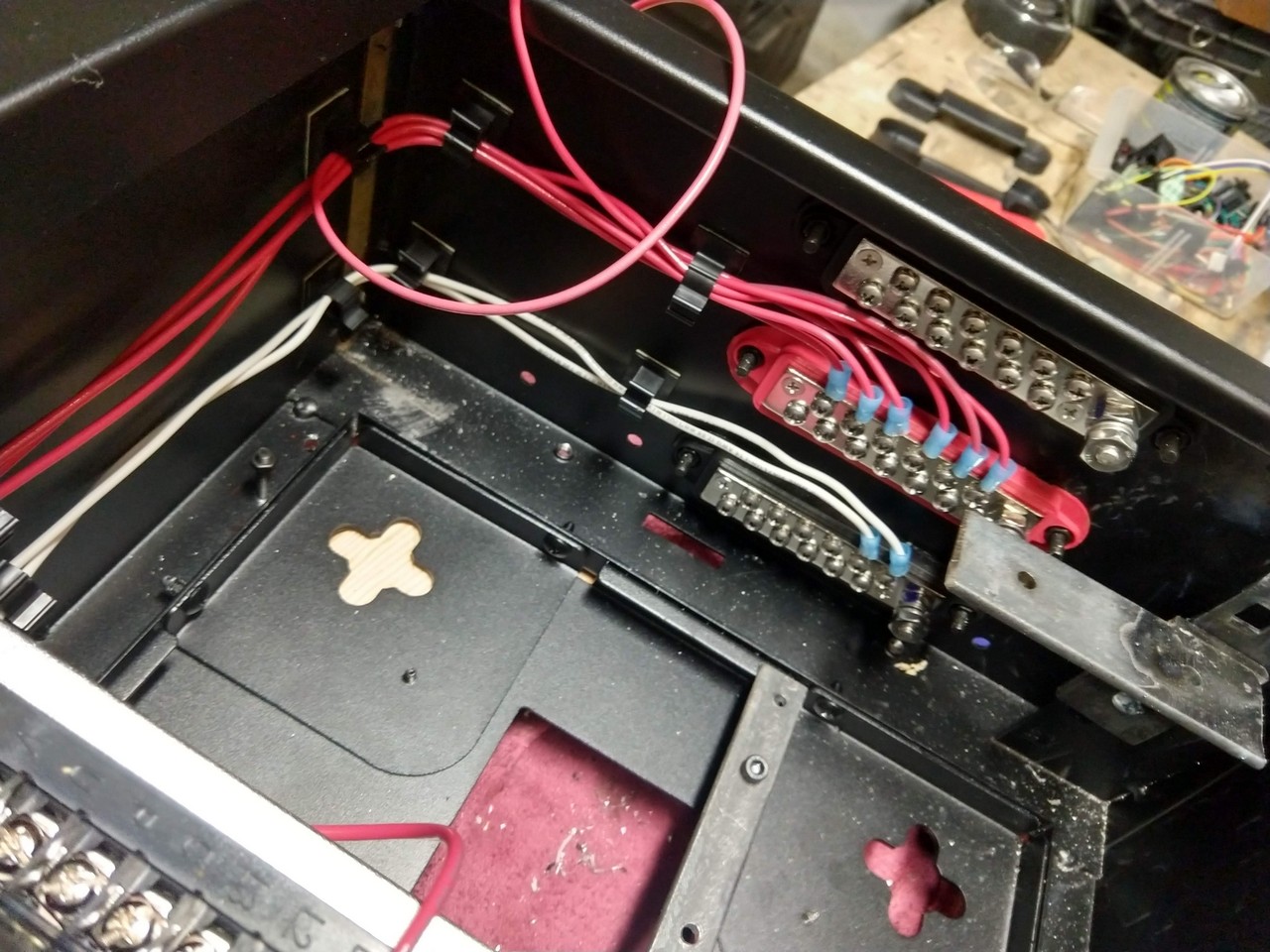

    Running the wires for 220v and distribution blocks
    Filling it UP!

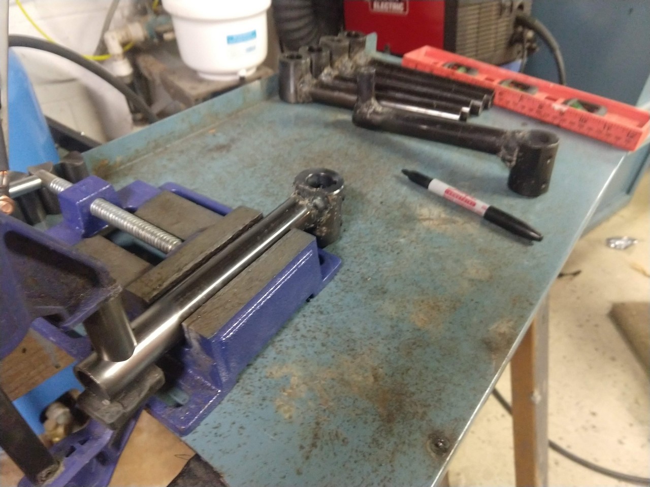

    Swing arm production line...
    AC Servo control box all wired up and TURNED ON!!!!

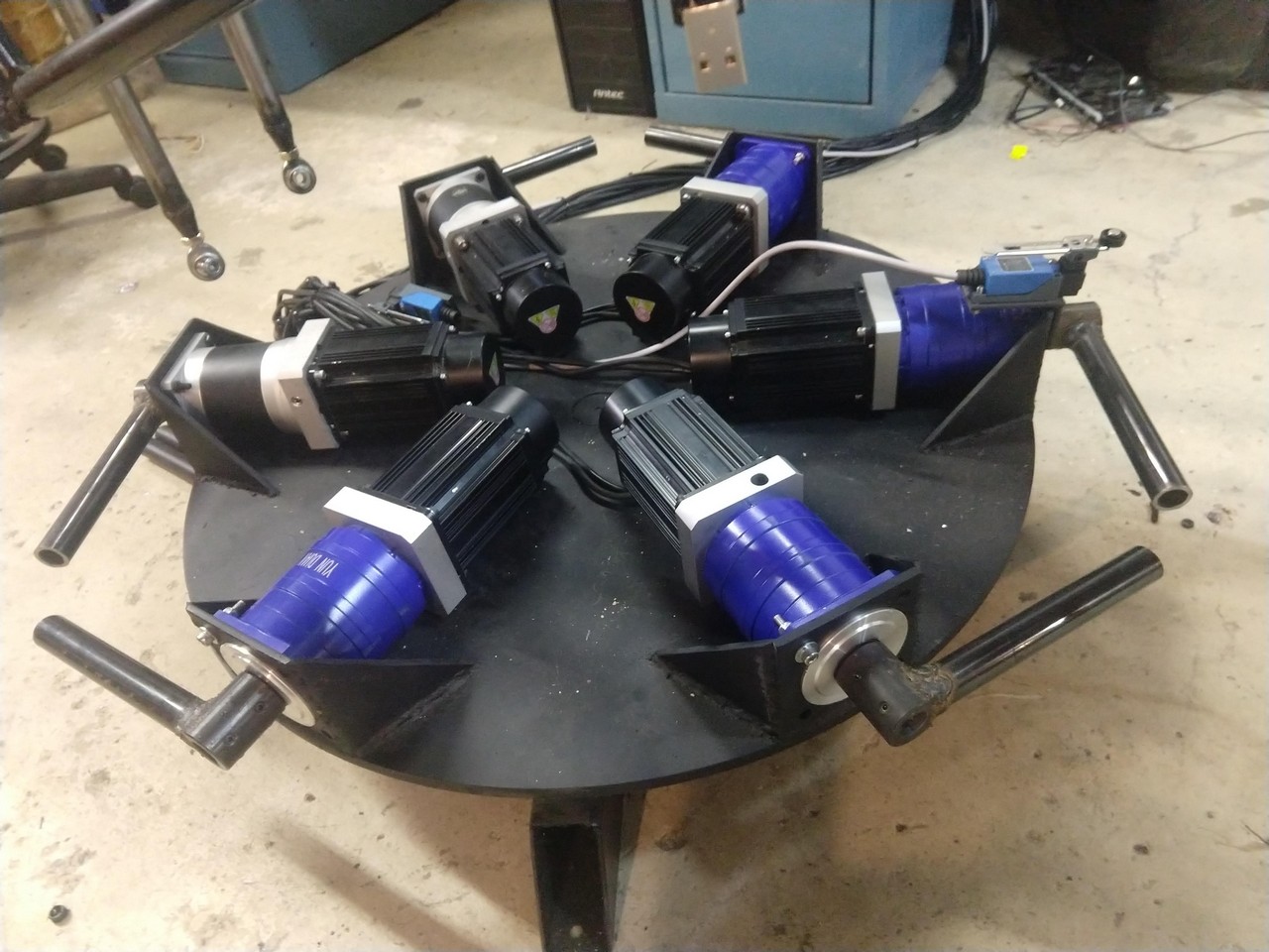

    All motors mounted for first time
    Adding threaded bungs to the swing arm for attaching the chassis platform/arms

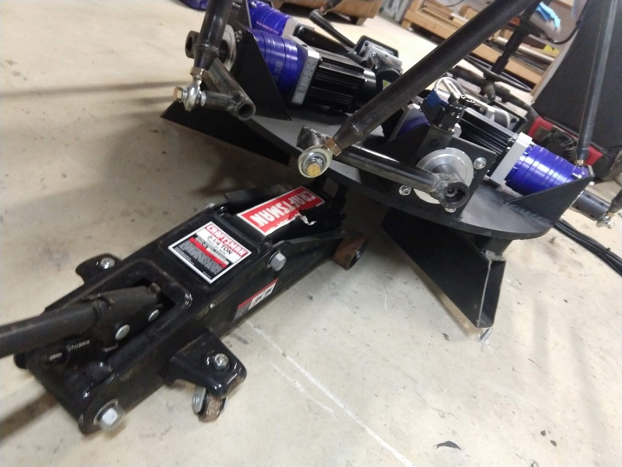

    Lifting the base onto the threaded anchors in the cement floor. using a car jack...

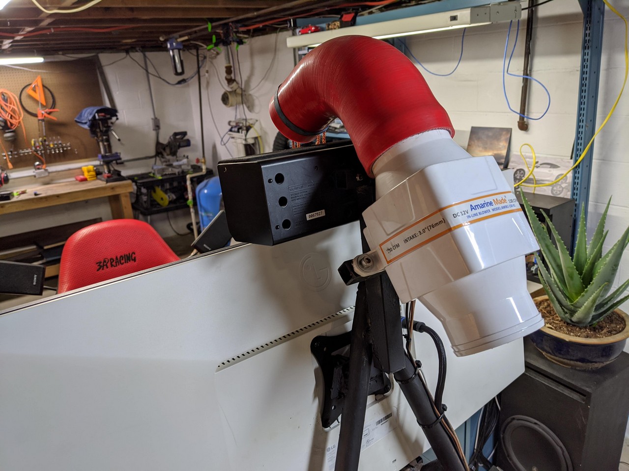

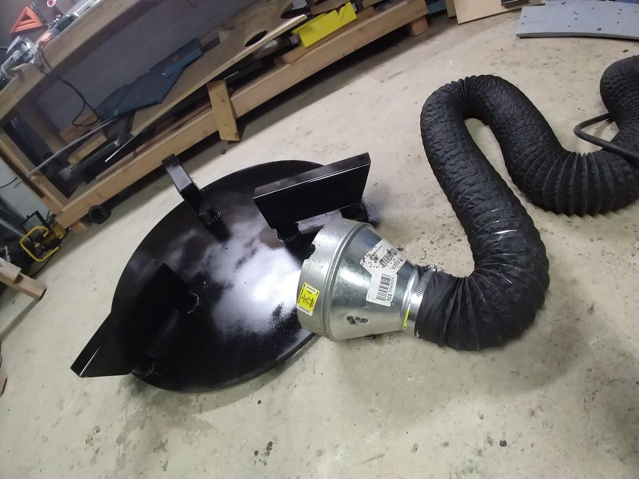

    Blower Fan with 90 degree (car air intake) tube for wind feels

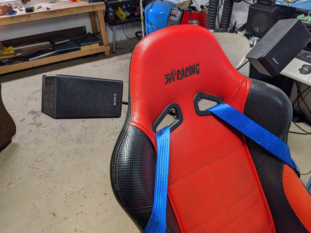

    Rear surround speakers
    Oh look,.. its almost done,... Giggidy...

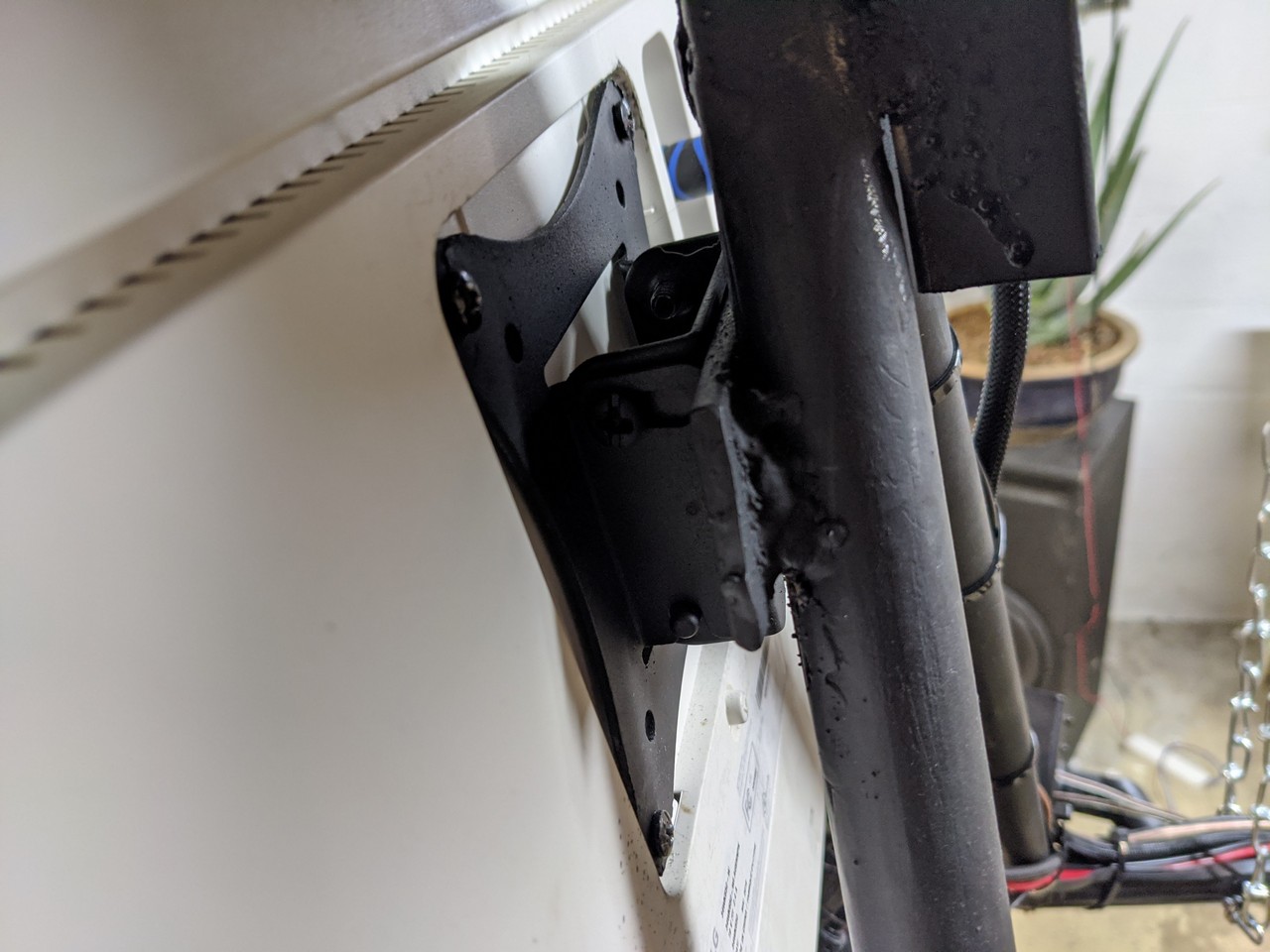

    Monitor bracket, welded to chassis. (Universal Vesa mount, then I took a angle grinder to it to get the piece i wanted...)

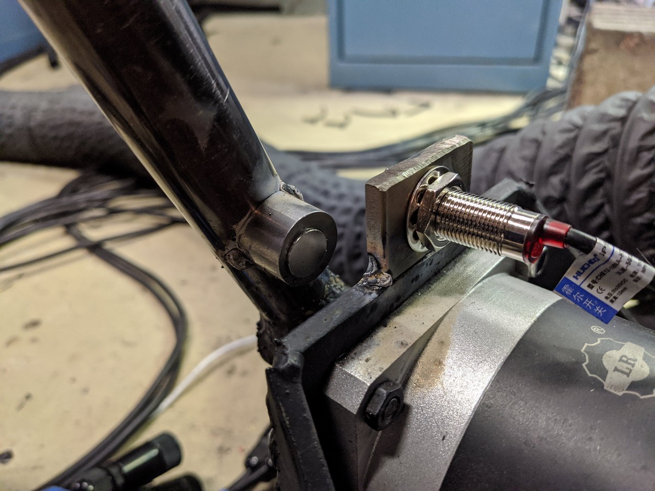

    Magnetic limit switch installed

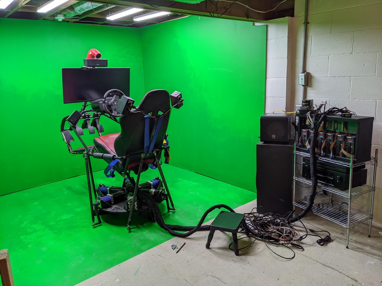

    Green screen room!!!
    Needed a room for the rig, May as well make it green!

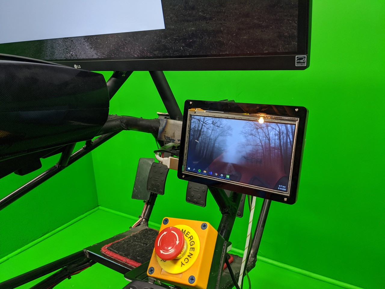

    Small monitor attached below the main monitor for SimHub, or video recording display

    Love the sim! Was wondering how you liked the reclined position for your rig, is it optimal for you or would you prefer a different geometry if you did it all over again? I'm considering doing a similarly reclined rig only with actuators and your rig looks like a good place to start copying =)
  14. knaufinator
    knaufinator Active Member
    Nov 16, 2017
    217
    Simulation Engineer
    akron,ohio
    1,909Coins
    +248 / 1 / -0
    AC motor, 6DOF
    Thanks!, The reclined position was intended to balance the load out as much as possible when a rider is in the seat, to counter balance the mass of the monitor/pedal box area. Once you are in place, the reclined position feels natural, and I would do it the same or similar if I was to do this again.

    +157 / 3 / -0
    IMO your cranks are a little long,dont you have any problem with your motors power for lifting.
    anyhow nice setup mate...
    :thumbs
  17. knaufinator
    Nov 16, 2017
    217
    Simulation Engineer
    akron,ohio
    1,909Coins
    +248 / 1 / -0
    AC motor, 6DOF
    Not at all, the longer the swing arm, the more movement I could get out of it. I first did quite a bit of testing to make sure that a motor/gear could handle the weight... I found that a single motor/gear could lift a rider ~14 inches in less than a second, with a 7.25 inch swing arm. I am a skinny guy @ ~180lbs, but I have had dudes ~250lbs in the rig and it handling just the same.

    good mate.i calculate you have more than 715 N turq at the tip of any actuators,
