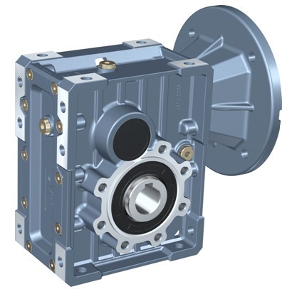

    Hi Speedy. I think I've sourced some brand new Helical bevel gear gearbox/motor units at a good price. I have some info and drawings on the gearbox (29rpm, 28mm double shaft output, 232Nm Torque). Just waiting for more info on the motors to arrive (0.75Kw, 4 pole, three phase) and I'll pm the details over to see what you think. These are £253 plus VAT each.

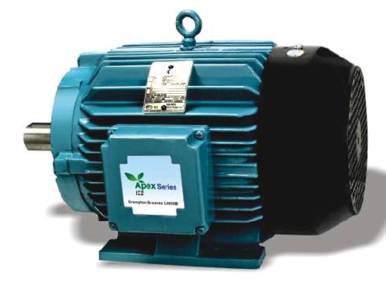

    +42 / 2 / -0
    The motors quoted for are TEC B14 units but they also have Crompton Greaves Apex IE2 motors (0.75kw 4 pole 3 phase). They're about £50 each more expensive but a better motor I think. The Helical gear gearboxes are TKM48B, specifications as above. They have also quoted on HEDY inverters so I'm just inquiring which model.
    Do these motor/gearbox combinations look good ?

    I guess the TEC B14 are just fine .
