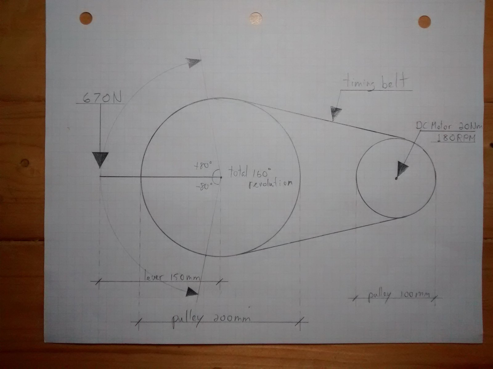

    Hi everyone. I am new here and i started to design my own 3dof simulator a few weeks ago with heave motion. I am following someone else's tutorial on an other website with a lot of detailed information that seems to have been worked out by a mechanical engineer with knowledge of physics. I am trying to take all that base knowledge and reinvent my own with my personal tweaks and mechanical systems. I have learned about the 3 classes of levers in physics, i have looked into gear ratios and pulley systems to learn as much as possible about everything and the science about it. The only problem is i'm not a scientist so no matter how much i learn, i don't know where to look to know how to combine and apply all this knowledge to my own design. Maybe for some of you, when you look at my drawing, you will instantly think its a piece of cake, well, that's good because you are the kind of people i'm reaching out to. IMG_20150830_165217.jpg It will be a 3dof rated at 200kg so 200kg divided by 3 is 67kg for each motors. 67kg is roughly 650 Newton but i round it up to 670 to make sure my choice of motor is powerful enough. 67kg is a force of gravity of 670N and it will be applied to a lever of 150mm with a range of 160 degree of revolution and that lever is attached to a 200mm pulley. By my calculations, the 200mm pulley will be pulling 502.5N but i could be wrong, i'm not sure. The 200mm pulley will be linked to a 100mm pulley with a timing belt. the 200mm pulley and 100mm pulley have a 2:1 ratio but i'm not sure it really applies here since i know ratios work with gears but i don't know if its the same with pulleys. So if there is a ratio, it would probably mean the 100mm gear would be receiving a pull of half of 502.5N? In the drawing i used a 20Nm motor with a rpm of 180 but its just an exemple and i have no idea if that will be enough. lets say the motor is 20Nm so it means the 100mm pulley can pull 400N? if the gear ratio works on pulley and i have a 2:1 ratio, does it mean my 100mm pulley will be pulling twice 400N on the 200mm pulley? As you can see here, i'm really confused. How does it even work to calculate the torque and rpm of 2 pulleys that are working against each other? There is no such teaching on youtube, all they show is simple pulley and gear system but nothing explaining what to in the case of 2 opposing forces, combined with a class 1 lever. So to help you help me, i absolutely need to have a 150mm lever receiving the 670N of force and those a 2 numbers i can't change. What pulley sizes and motor torque and rpm i should shoot for? Please don't tell me i need a 100Nm motor with the lever and no pulleys. I already know that. I'm trying to make an efficient but cheap system so by introducing pulleys i could get a weaker motor that could still do the job. Motors and PSUs are the most expensive parts and in order to get cheaper motors and gearboxes i need pulleys. I would hope to be able to get away with a 1Nm servo with a 20:1 gearbox. Do you think its possible?
    Thank you for your time

    Have a look at the overview here and play with some of the online calculators, don't forget mechanical loss: http://www.xsimulator.net/community/faq/calculating-basic-linear-speed-and-forces.89/
    There are also software applications that will let you model physical systems.
    A pulley system is a form of gear ratio, and is used in things like a block and tackle.
    You can't assume weight is evenly distributed when selecting motors, it is not in an operational sim.

    Sorry everyone, i think i just figured it all out on my own tonight while i was watching more videos on the physics of pulleys. My problem is that i was visualizing the 2 opposing forces clashing each other and fighting as who was gonna be taking advantage of the 2:1 ratio before the other and i was thinking whatever is the strongest force was gonna win but of course that's not how it works and i was just really confused and needed help to clear it up. Here's what i came to understand. I need to calculate the force of 1 side all the way to the other side to see what the other side need to be an equal force. I'll explain:
    We need to know, what will be the Torque generated by the 670N down the centre of the 100mm pulley. That will tell us how strong the motor need to be to counteract it:
    Torque applied at the centre of the 200mm pulley: 670N x 0.15m = 100.5Nm
    Now with the torque of the 200mm pulley we can find the force it generates on the outer of the 200mm pulley: 100.5Nm ÷ 0.2m = 502.5N
    We know that the 2:1 ratio between the 200mm pulley and the 100mm pulley is cutting the torque from the 200mm pulley in half: 502.5N ÷ 2 = 251,25N
    Now that we know what is the force applied on the outer of the 100mm pulley, we need to know what is the torque of that force down in the middle of the 100mm pulley: 251.25N x 0.05m = 12.5625Nm
    There it is: The minimum torque necessary on the 100mm pulley that will counteract the force generated by the weight of the cockpit of 200kg on 1 of the 3 motors is 12.5626. We know there is a loss in gears and pulleys system so its actually less than 12.5625Nm but its pretty irrelevant at this point.
    Now that we know a Servo of 1Nm with a gearbox of 20:1 would be 20Nm, we could calculate the loss that gearbox will incure to the total Nm output of the motor and to know exactly what would be the final force pushed by the motor to the lever, we could find a loss calculation for pulleys ratio but i'm pretty sure it would be overkill. I think to be safe, a 1Nm servo with a 25:1 gearbox would do just fine.
    If i made any mistakes and got something wrong or i just simply understood it all wrong and i don't get it at all, just let me know and explain why and what is the correct answer.
    If i'm right, i hope i helped someone and good luck with your creation.

    If I follow correctly what you are doing with pulleys is halving the speed and doubling the torque, so you have 40Nm at 90RPM. I don't really understand your reasons for doing this as it incurs additional mechanical loss, as opposed to using a lever directly on the motor shaft.
    However, for the sake of the exercise a 150mm lever at 90RPM gives a linear speed of 1.41372 m/s @ 266.66N, and that is not accounting for mechanical loss of either the 25:1 worm gearbox or the pulleys, which could very well be up to 50%.
    To move 200kg at 1.41372 m/s requires 282.744 N.
    Of course shortening the lever reduces the linear speed and increases the force, but would be most efficient if done directly off the motor shaft. To give a more realistic examples directly at the motor shaft, excluding mechanical loss:
    A 3600rpm/25:1 with 40mm CTC at 144 rpm gives a linear velocity of 0.6031872 m/s with 500 Newtons.
    A 3600rpm/25:1 with 25mm CTC, which is as small as it is practical to go, at 144 rpm gives a linear velocity of 0.376992 m/s with 800 Newtons.

    It would appear i made a mistake in my equations.
    When i was at step 2 that goes like this:
    "Now with the torque of the 200mm pulley we can find the force it generates on the outer of the 200mm pulley: 100.5Nm ÷ 0.2m = 502.5N"
    i used 0.2m as the divider of the Torque generated by the weight applied on the lever. 0.2m is actually the diameter of the 200mm pulley and its wrong. I have to use the radius which is 0.1m. The 150mm lever and the 200mm pulley act as a class 1 lever. In this case, the center of the 200mm is the fulcrum. Therefore the class 1 lever is composed of the 150mm lever and the radius of the 200mm pulley.
    The correct equation is then: 100.5Nm ÷ 0.1m = 1005N
    So now that we know the forced delivered to the 100mm pulley from the 200mm pulley is 1005N and NOT 502.5N, we can take in account the 2:1 gear ratio and do 1005N ÷ 2 = 502.5N
    From there we can keep following the same steps i used before and find the torque applied to the center of the 100mm pulley this way: 502.5N x 0.05m = 25.125Nm
    Now its pretty clear that the Minimum Torque required from a motor to counteract the force of the cockpit weight and opposite it, is something over 25.125Nm. The ideal would be a servo or step motor of a holding torque of 1Nm and a gearbox of something like 50:1 or more. Luckily, i found stepper motors of around 4Nm for less than 60$ and a gearbox of 20:1 would be largely sufficient.

    I still have to calculate the rpm of a stepper motor to achieve 160 degree of revolution on the lever within 1 second. It means the 200mm pulley would need to achieve a full 360 degree revolution in 2.25 seconds. The rpm of that 200mm pulley would then be 26.67 rpm. It doesn't sound like much. Again, gear ratio of 2:1, the motor should have a minimum rpm of 53.34 rpm. I'm pretty sure that's manageable. Ok, with this post, i hope to help people so i'll give the formula clear and simple for the people trying to figure out their own.
    in 1 full revolution there is 360 degrees
    i need in my example to make 160 degrees in 1 second
    360 ÷ 160 = 2.25 so thats 2.25 second to achieve 360 degrees
    in a minute there is 60 seconds so 60 ÷ 2.25 = 26.67 rpm
    then the gear ratio of 2:1, big wheel to small wheel, it always go faster so obviously the gear ratio will multiply, by 2 in my case for a total of 53.34 rpm

    @Onsc3ne I strongly dislike the way you've been treating one of the most helpful and experienced members of this forum, but I'm going to try to point you in the right direction.
    You fail to account for motor power output (Power = Torque x Angular Velocity). A motor delivers maximum torque at stall speed. It delivers no torque at maximum speed. A motor that has sufficient torque at stall and meets your speed requirements at no load will not be sufficient when you put a load on it. You need to find a motor that meets your power requirements, then use whatever mechanical means you wish to meet your speed and torque requirements. Reducing the required torque does not reduce the size or cost of the motor you'll need.
    You are not only holding up the mass that is placed on your simulator against the force of gravity, but you also need enough power to accelerate it (Acceleration = Force / Mass). The load is not going to accelerate linearly, meaning you'll need to watch a lot of YouTube videos about calculus if you wish to solve your power requirements mathematically. It's a lot easier to be kind to those who have already solved this by trial and error and learn from their experiences!

    Short answer is no.
    You will sacrifice speed for mechanical advantage. A motion simulator needs to be fast and precise, both of which will need a fast (100 - 200 rpm) yet powerful (150 - 300W) motor. There is a reason that almost all simulators you see in this forum or elsewhere have got either wiper motors (40W - 60W) or motors that are close to, even exceeding 200W. Yes you could probably "imagine" an ideal motor in mathematical terms but at the end of the day you have to find what you can actually purchase and what the cost would be to modify that system. Usually 9 times out of 10 it's far easier and cheaper just to buy a big ass motor.
