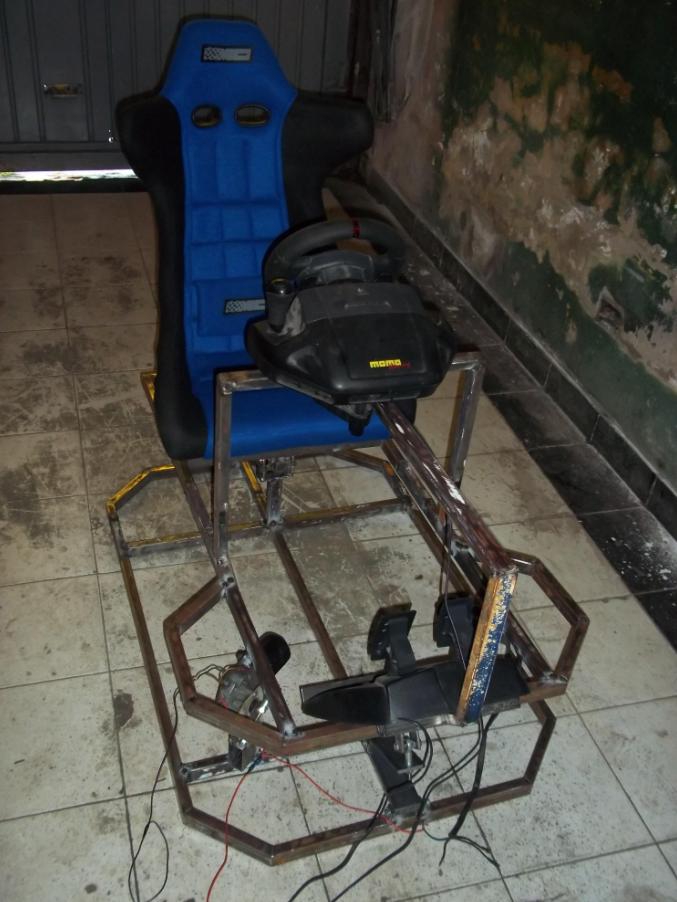

    I´m searching for the best simulator engine.
    My idea is to build a 2DOF simulator with AVR Motion Controller v1.5 Dual Simple Mosfet h-bridge v1.2b designed by Thanos.
    The 2 boards work, and I have built the simulator, a photo here:
    I can't find any big and cheap wiper motors because in my country they are very expensive.
    I found some motors of 120W, but I have some doubts whether they is going to work or not in
    the simulator. Here are the specs:
    Voltage: 12Vcc
    Current: 14A
    Revolution: 3,200rpm
    Output: 120W
    Torque: 3.66kg/cm
    and here's the link:
    http://twt.manufacturer.globalsourc...or/1001681587/Small-DC-Motor-Geared-Motor.htm
    The engine model is the 10SGN-F
    The reductor model is the 5GN75K
    The engines are vented, unvented can be 10SGN of 65 W and 1800RPM
    The reduction is of 1:75 and gives me a speed of 43 RPM
    5GB75K reduction is with straight clogs and not as the wipers.
    Does this cause any problem?
    Are the 14a consumed a problem for the H bridge?
    What is your opinion about these engines and reductions?
    Thank you very much!

    Yes I have two of these motors fitted to my simulator. I am currently testing and setting profiles to get them to move properly. They have good solid motion.

    Hello Martin, yes the motors I use are not ventilated, however, they do not even get warm under use. The worm gear I am told by the supplier is very strong. I am seeing good results so far, but more testing over time will tell.
    From what I can see in your photo, you are mounting the motors at the front, so they will be under less strain than where I have my motors. Mine are under the back of the seat and under more strain.
    The motors that you have listed should work. Only one way to find out. Buy them and set them up.
    Thanks, David.

    Then I'll have to try, but I'm very wrong with the engine I chose? Or it should work?
    The final data are:
    Engine:
    120W
    3200rpm
    3.66kg/cm (0.36Nm)
    Reducer:
    Ratio: 1:75
    43RPM
    274.5kg/cm (26.91Nm)
  11. eaorobbie
    20,465Coins
    +1,686 / 23 / -2
    variables look ok just beware the wipers have a plastic gear system and if ya load them up too much, ya just end up grinding the points of them, so really balance is the key.
    Do ya have a link for the proposed motors and gearing for us to see, thanks

    I see the gear supports up 100kg/cm of torque while the engine is 274.5kg/cm.
    I would not use all the torque which has the engine, better I buy a 65W motor with these specifications:
    Voltage: 12V
    Current: 9A
    Revolution: 1,800 rpm
    Output: 65W
    Torque: 3.5kg/cm
    And because of the engine RPM, would have to use a 1:36 gear ratio to go down to 50RPM. The 5GN36K.
    And so get 126kg/cm, which I think are sufficient.
