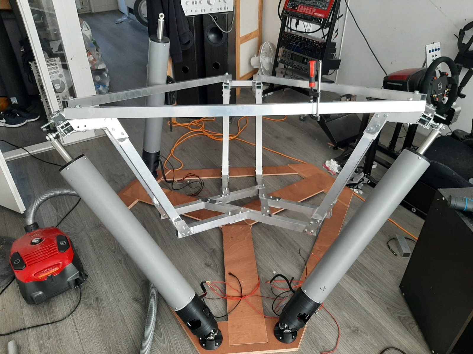

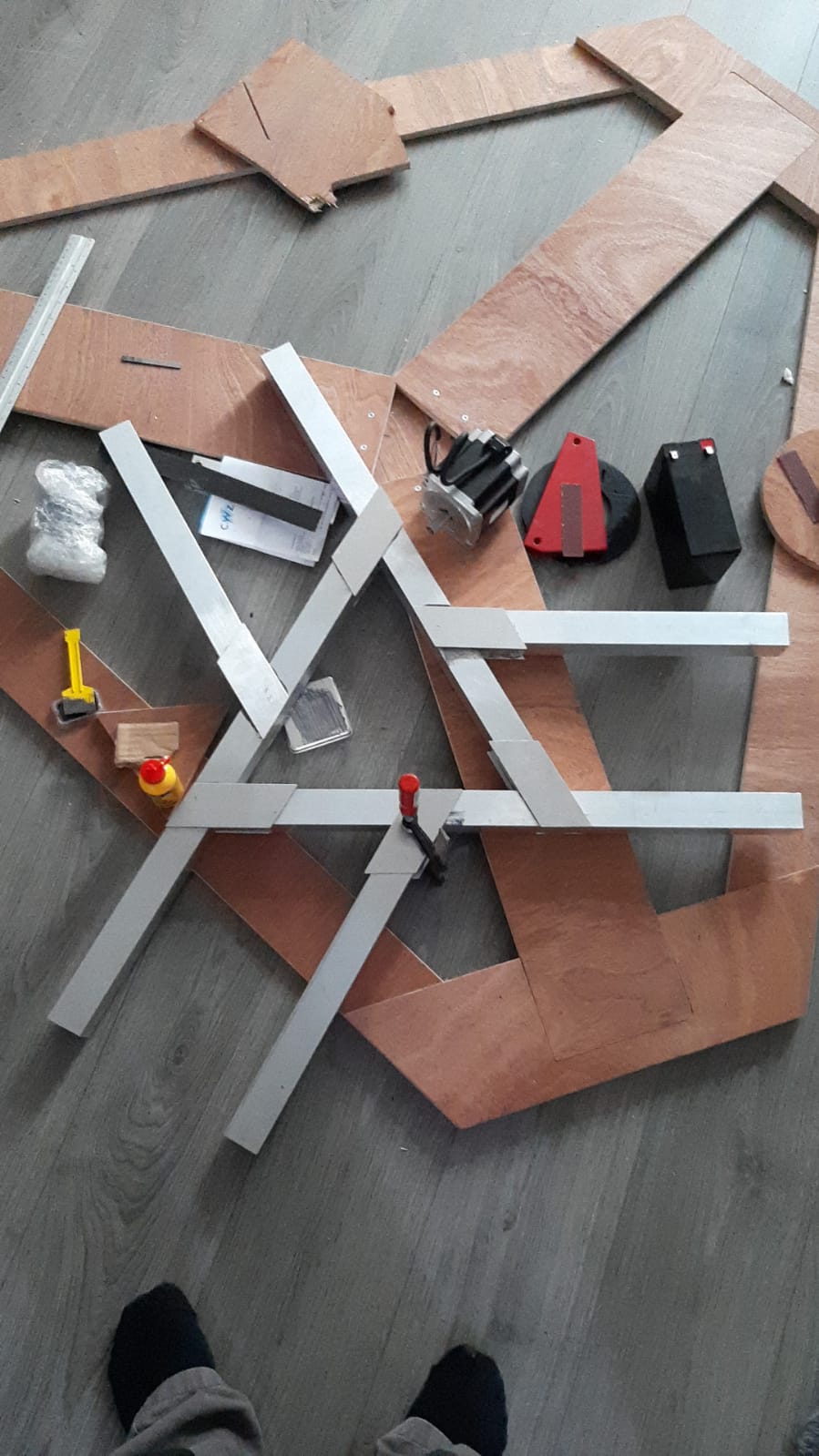

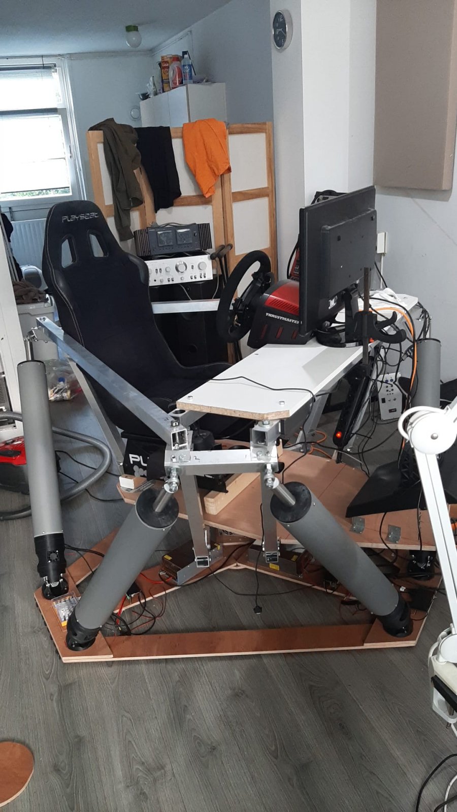

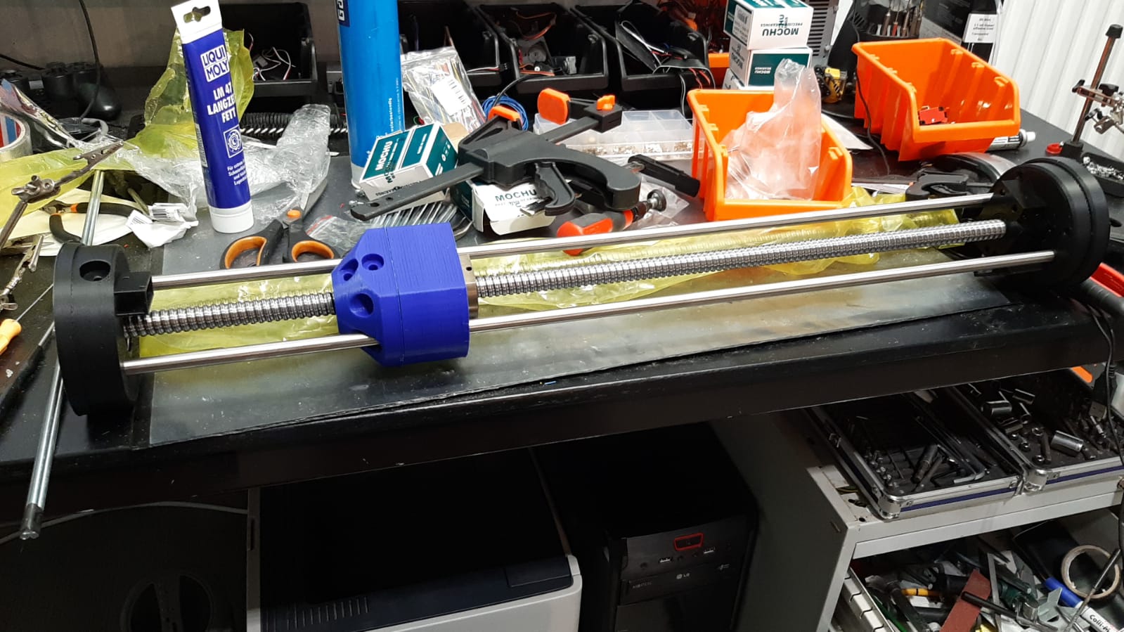

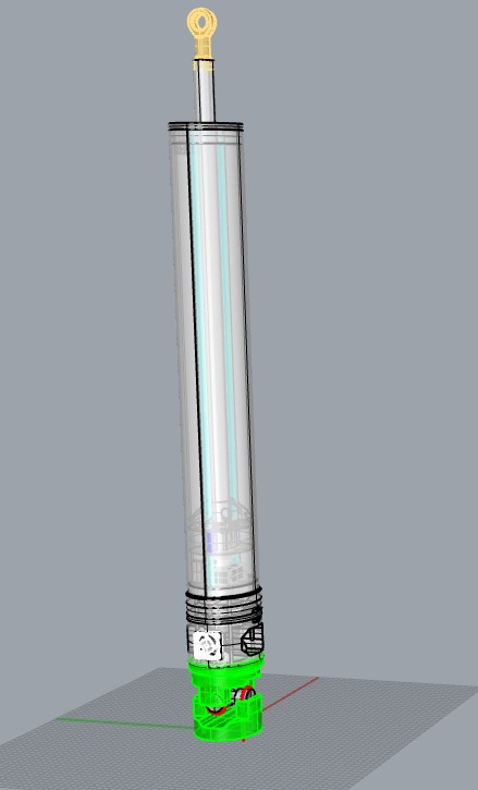

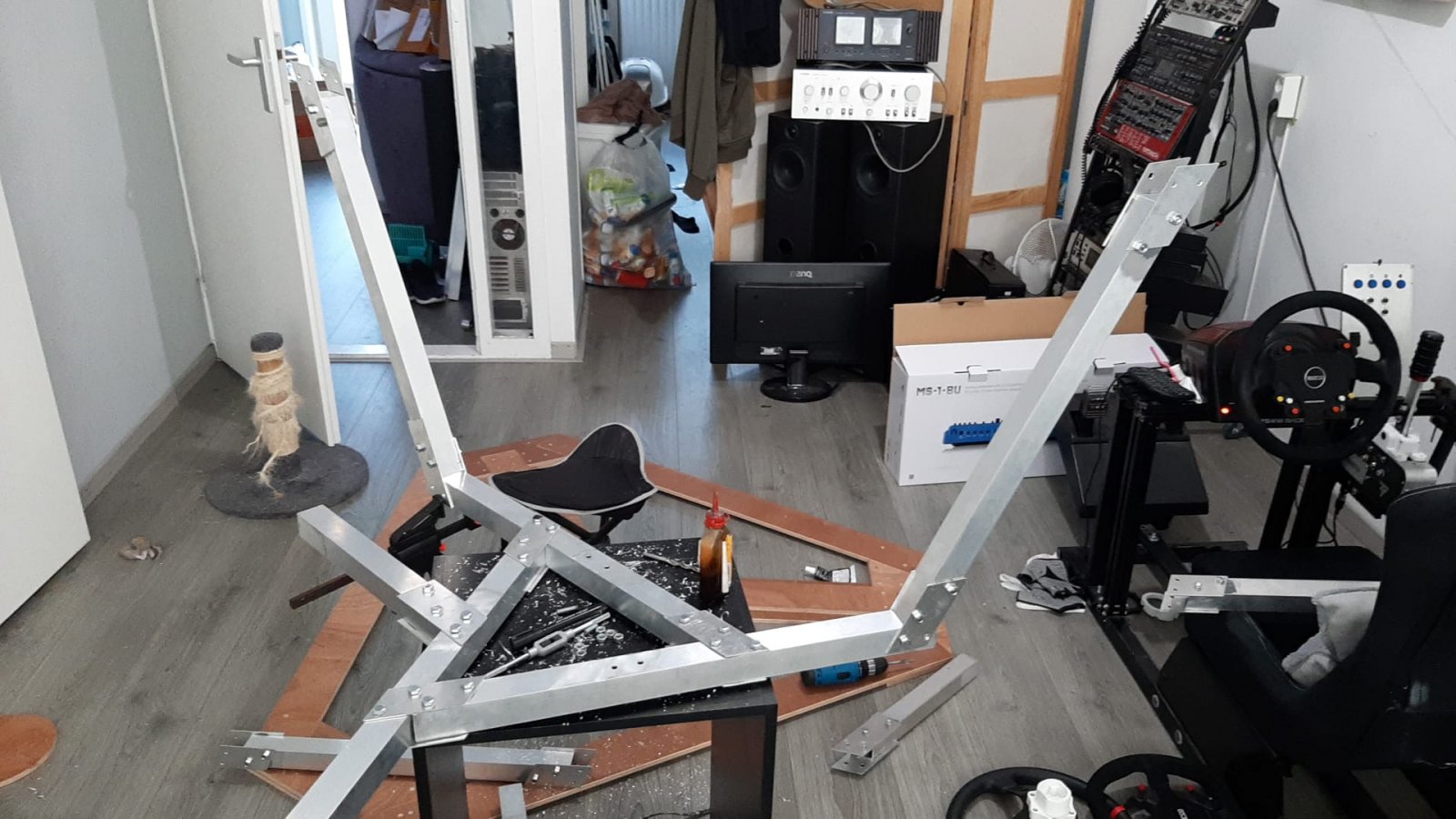

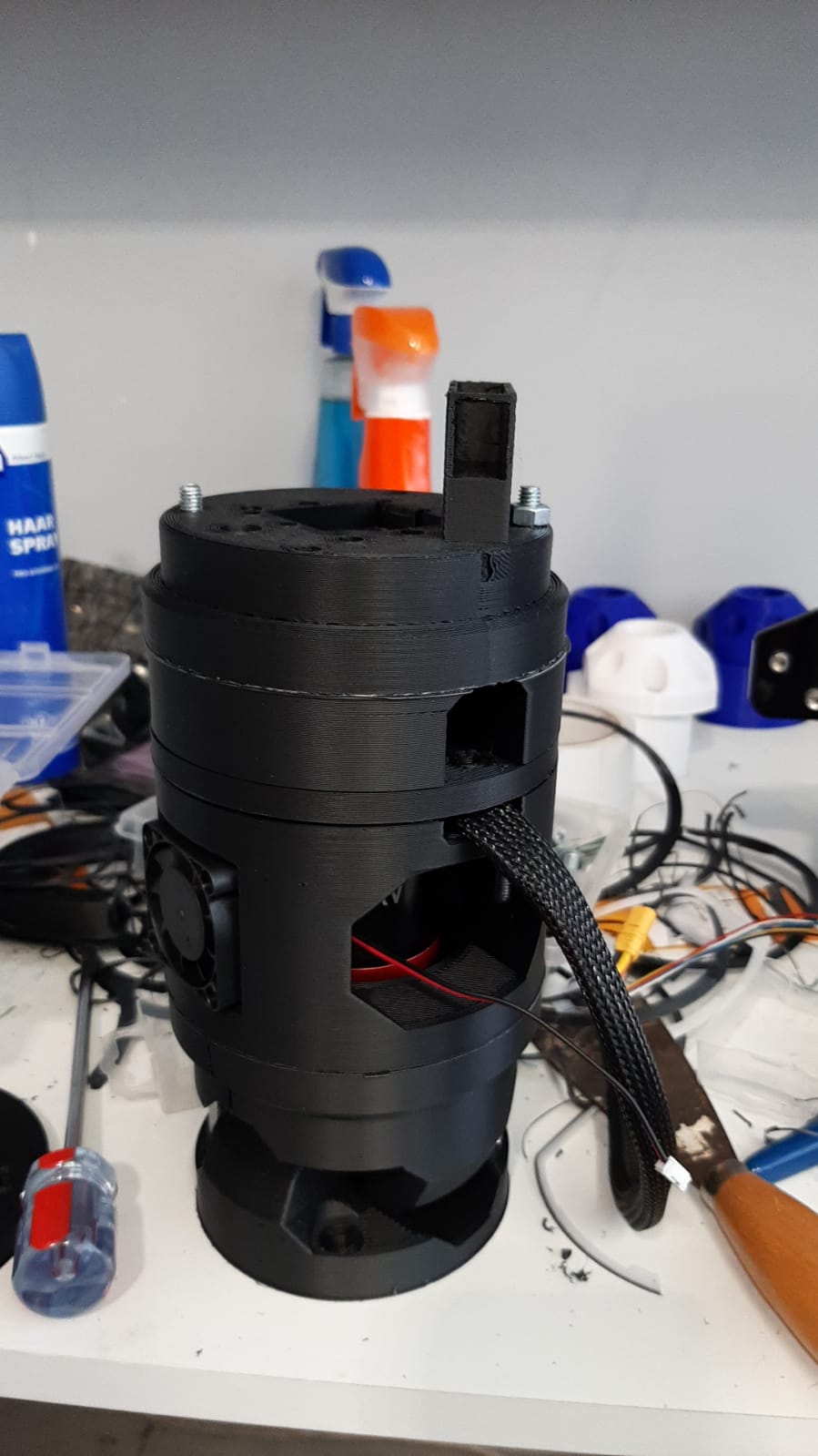

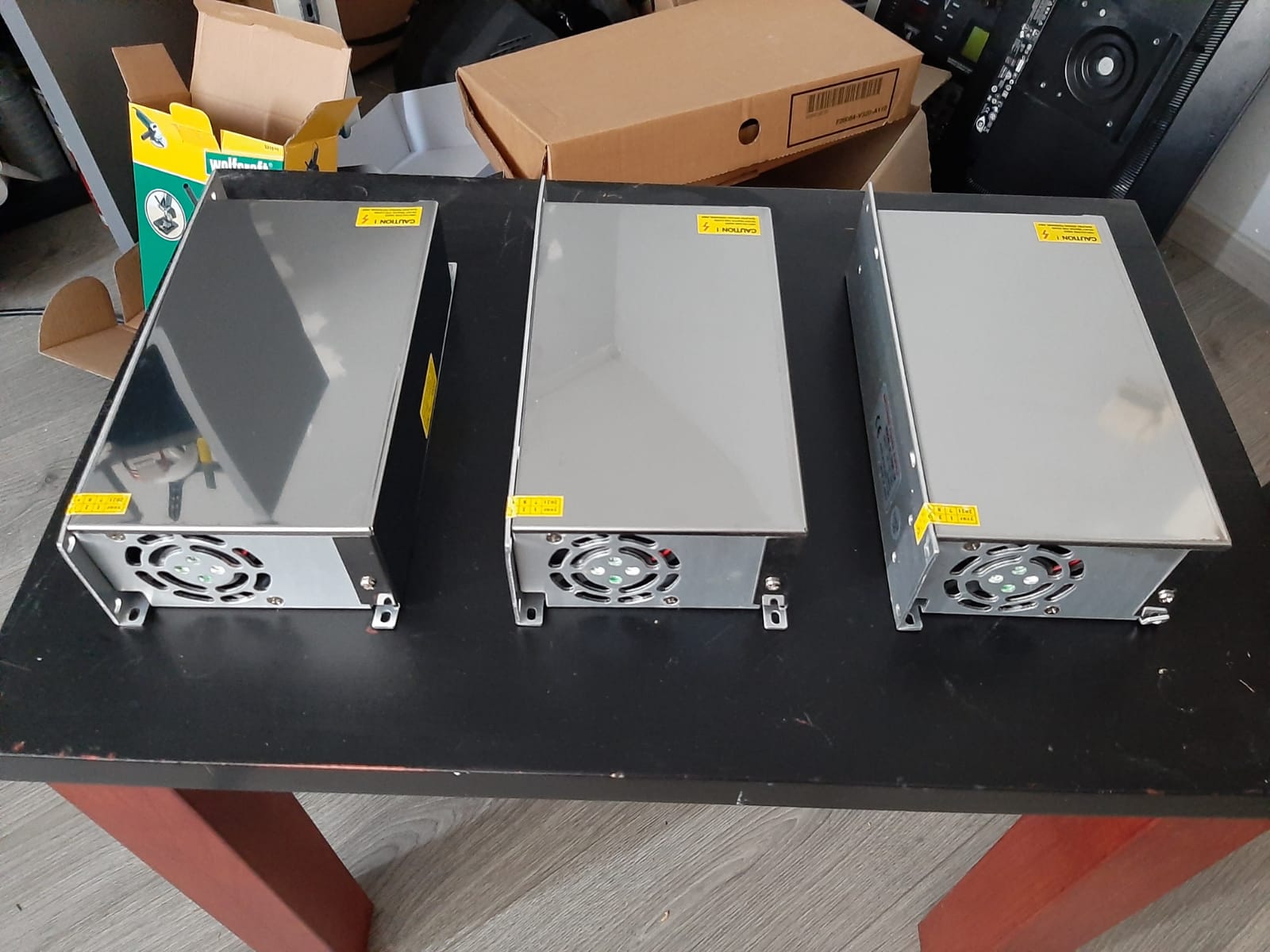

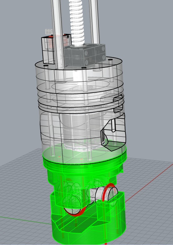

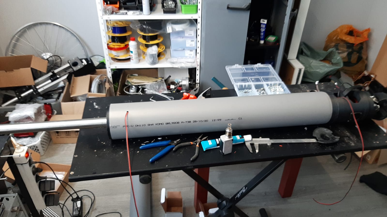

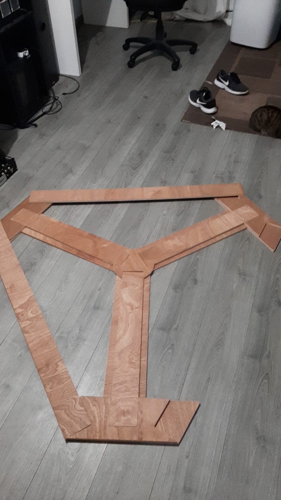

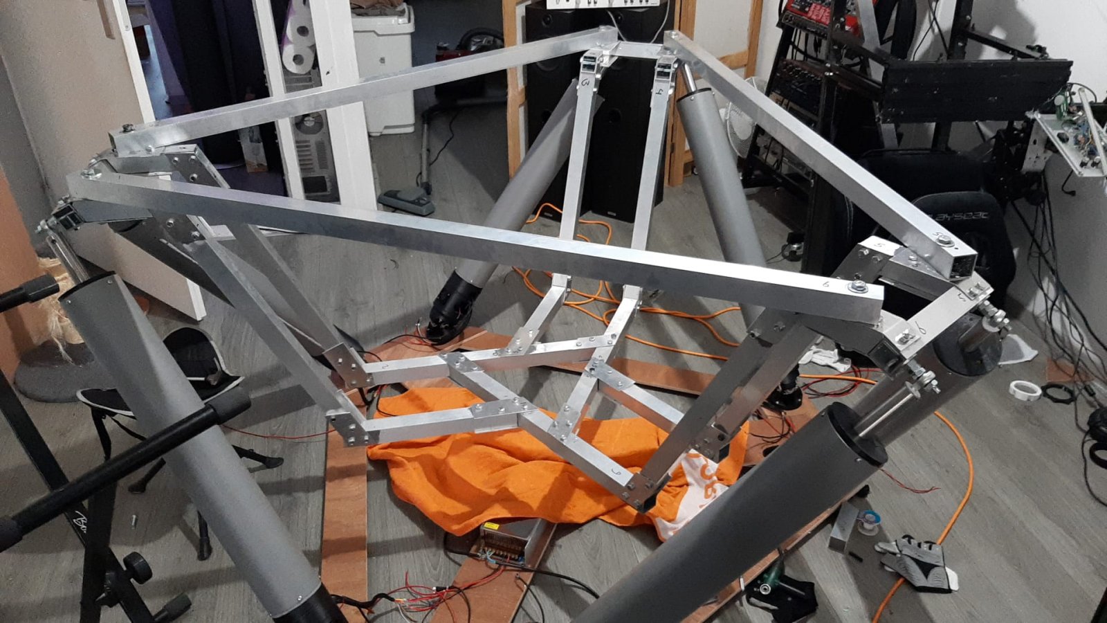

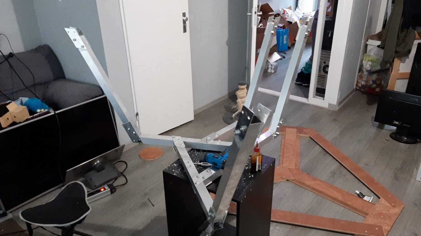

    Hi all. After having tried to build a 2 dof system and not really liking it I'm back at it with some upgrades.
    IMG-20210630-WA0006.jpg IMG-20210601-WA0001.jpg IMG-20210601-WA0009.jpg IMG-20210617-WA0001.jpg

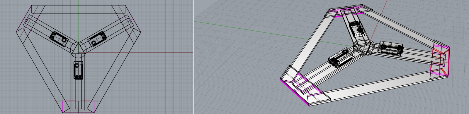

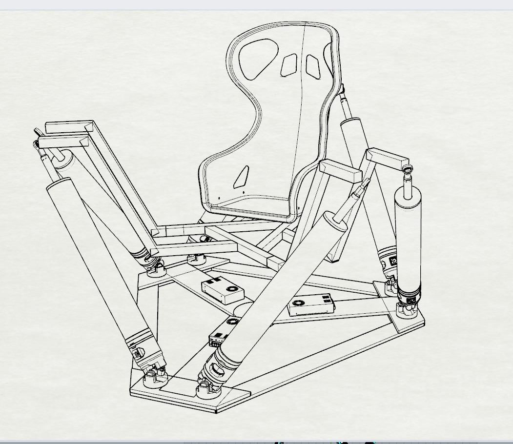

    Some cad drawings.
    IMG-20210513-WA0006.jpg IMG-20210516-WA0001.jpg IMG-20210516-WA0006.jpg IMG-20210517-WA0004.jpg

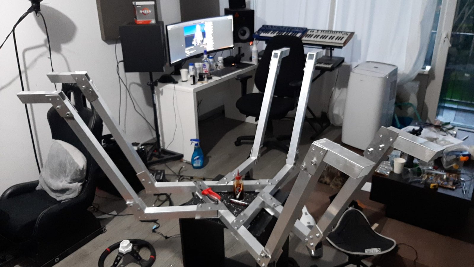

    Some building
    IMG-20210626-WA0009.jpg IMG-20210626-WA0012.jpg IMG-20210630-WA0005.jpg IMG-20210630-WA0012.jpg IMG-20210707-WA0002.jpg IMG-20210708-WA0011.jpg IMG-20210709-WA0004.jpg IMG-20210815-WA0008.jpg IMG-20210815-WA0010.jpg IMG-20210816-WA0003.jpg IMG-20210908-WA0002.jpg IMG-20210916-WA0001.jpg IMG-20210917-WA0005.jpg IMG-20210919-WA0010.jpg
    Some testing.
    IMG-20210707-WA0002.jpg IMG-20210908-WA0006.jpg .
    And now i'm stuck with some major odrive issues ^^

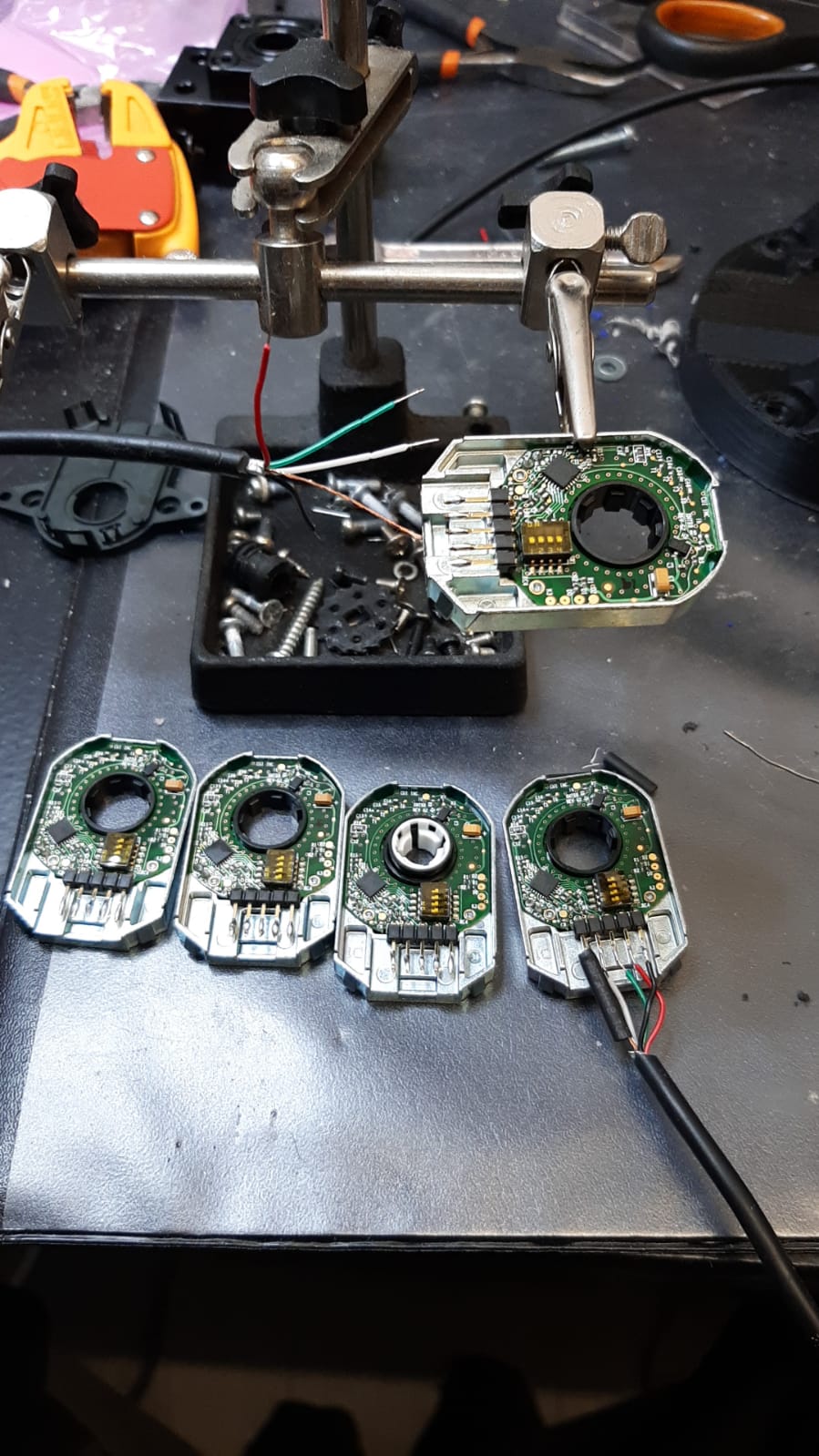

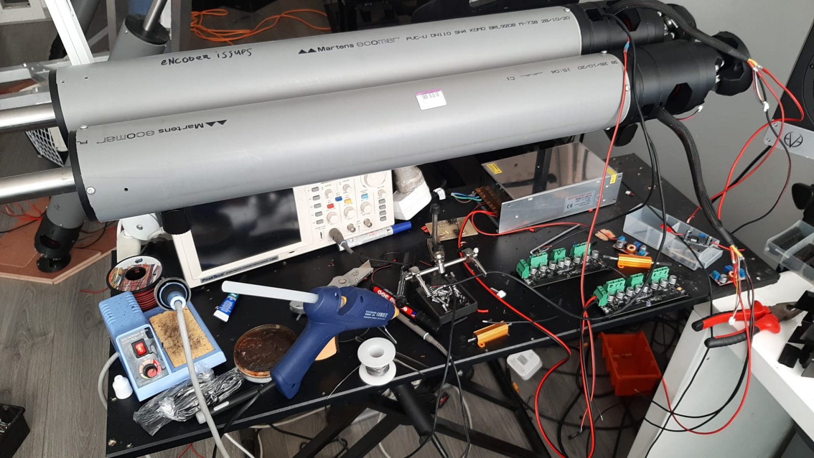

    It only works when you don't crash haha. I keep getting current violation errors. Absolutely tried everything. Upping the current limit. limiting the speed, expanding the current limit tolerances. I also keep having actuators intermittently not wanting to calibrate. One second they work and 5 min later they don't . Even after resetting everything. double checked all the connections and took apart every actuator for inspection but noting i could find wrong with them...
    And for those wondering about the plastic motor mounts being the issue i've already upgraded those for aluminum ones.
    To no avail...

    So first question: what brake resistors do you use ? And could you upload or send your Odrive - config for a first look?

    I'm using the standard 50w 0.5ohm resistors. They don't run hot, cold actually so i figured they're fine?
    And here you are:
    Side note: In this config file I lowered the current settings. Its how its setup now for testing.
    Update: I've got some 50w braking resistors from a friend. 6 of them each 0.5ohm so if i put 2 of them in series that should give me 100w 1.0 ohms right?
    Lets hope it works ^^

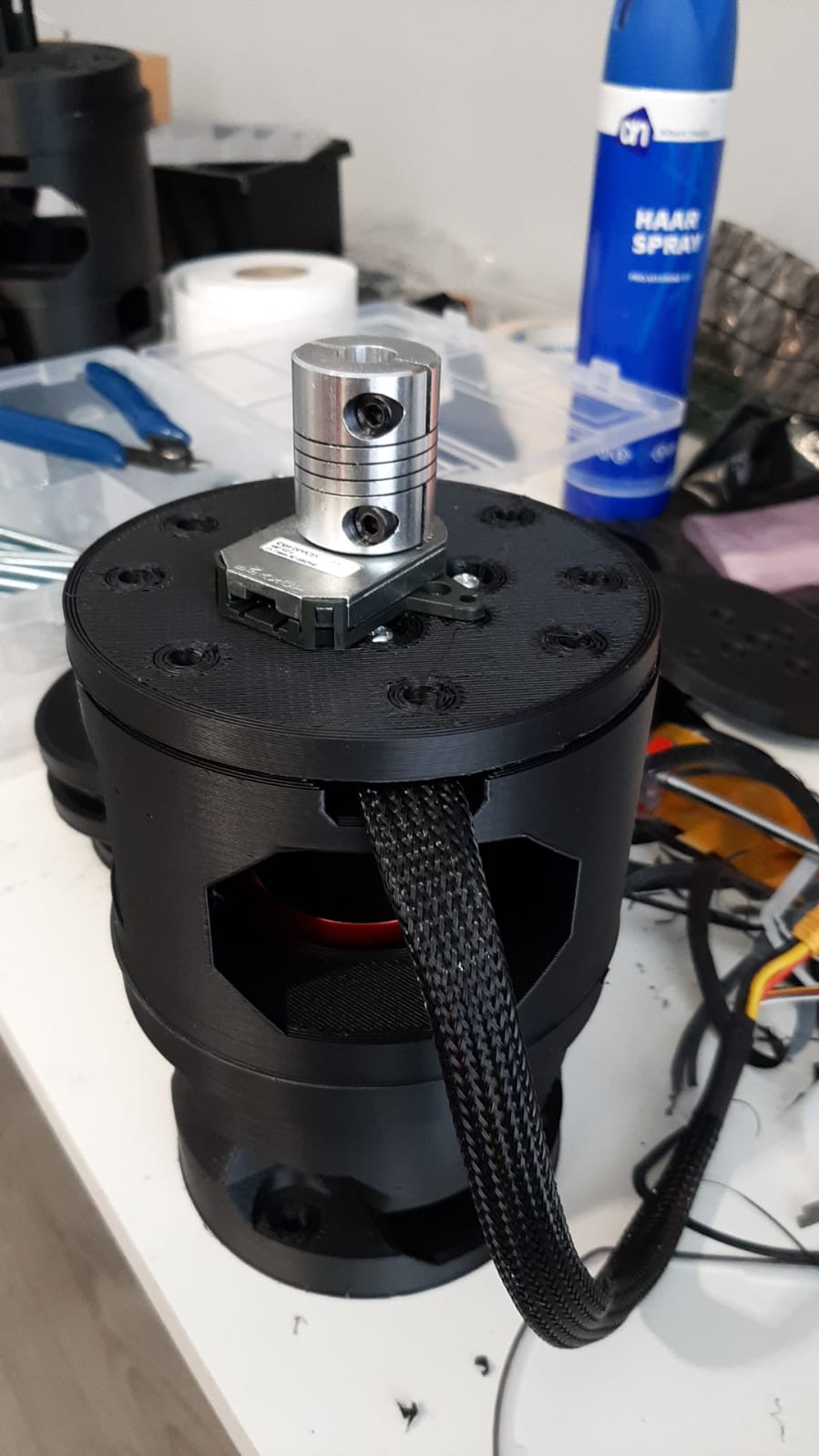

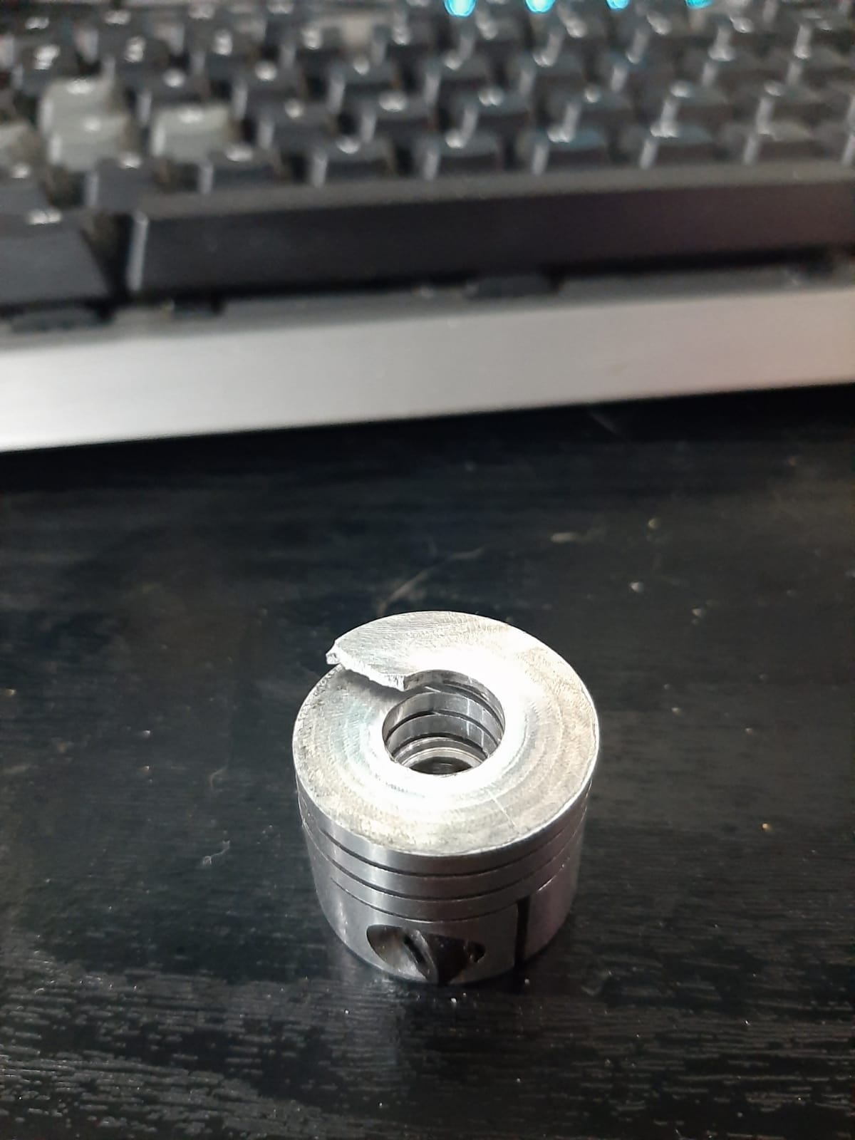

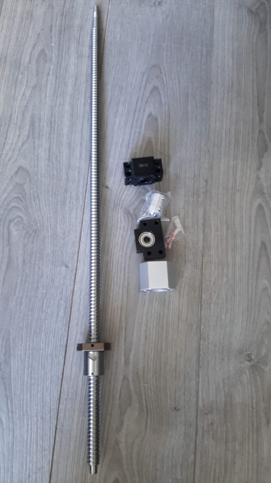

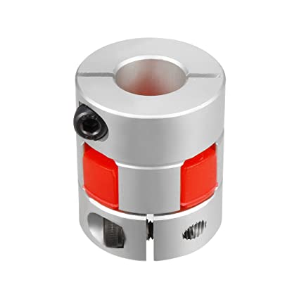

    Motor coupler snapped clean off :D
    And still fighting with those damned odrives....
    I've tried about everything I can think off but nothing seem to work... Very close to giving up and just buy a thanos system:think
  6. wannabeaflyer2
    Jun 12, 2015
    724
    london uk
    8,322Coins
    +957 / 7 / -0
    Hi @Joey those flexible couplers are not really designed for the type of loading your likey to see in our actuators they are better for slight misalignment axially but not great at torque transmission (in my opinion ) the better type is what i call the Cushdrive coupler basically 3 piece assembly made up 2 drive couplers end fittings with solid rubber middle insert which allows limited axial movment but allows for great torque transmission .. will posta pic later these are usually found in SFX type actuators will be better suited , so dont give up yet as youve invested a lot in this so far and by looks of things your close to having the system you need :)

    Yup already ordered 6 of those ;)

    Up and running finally

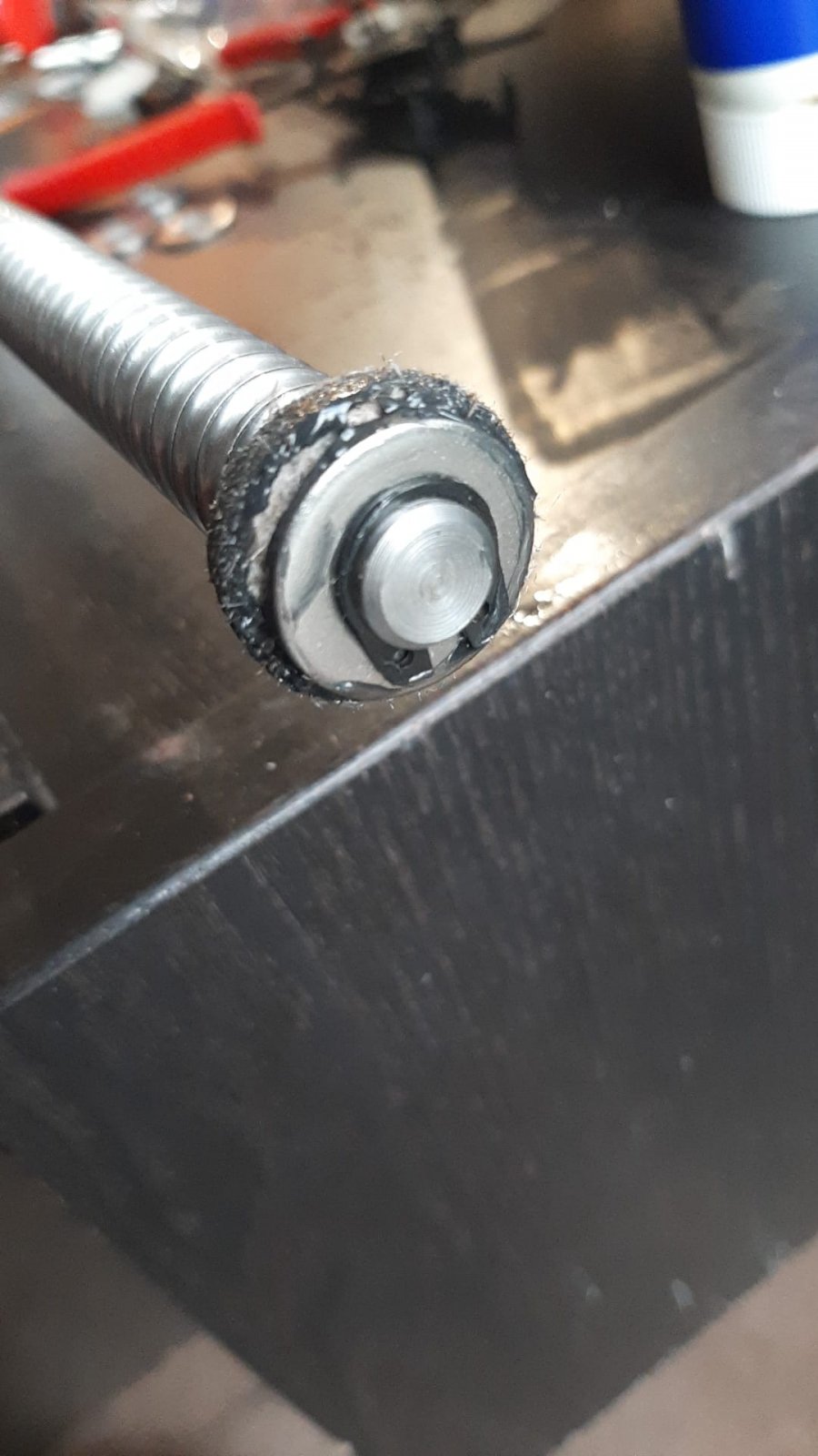

    Now working on getting rid of the noise coming from the ballscrews hitting the metal tubes.
    Some felt rings might work for now but I don't think its not a long term solution. We'll see ^^

    Btw 100kg test succeeded
    Also fixed the ballscrew knocking :thumbs

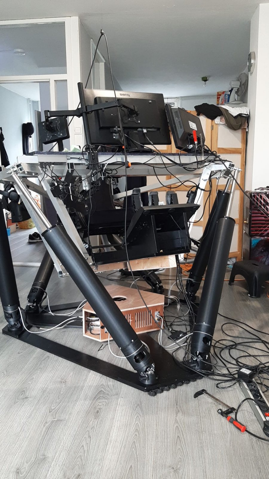

    WhatsApp Image 2022-06-07 at 8.24.12 PM.jpeg Now working on some cable management and next week I will spraypaint the frame black. And wrap the parts that are going to be touched a lot with carbon foil.
