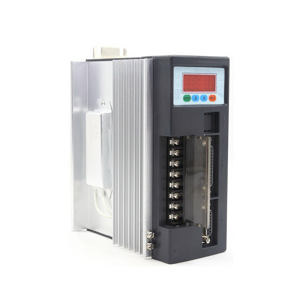

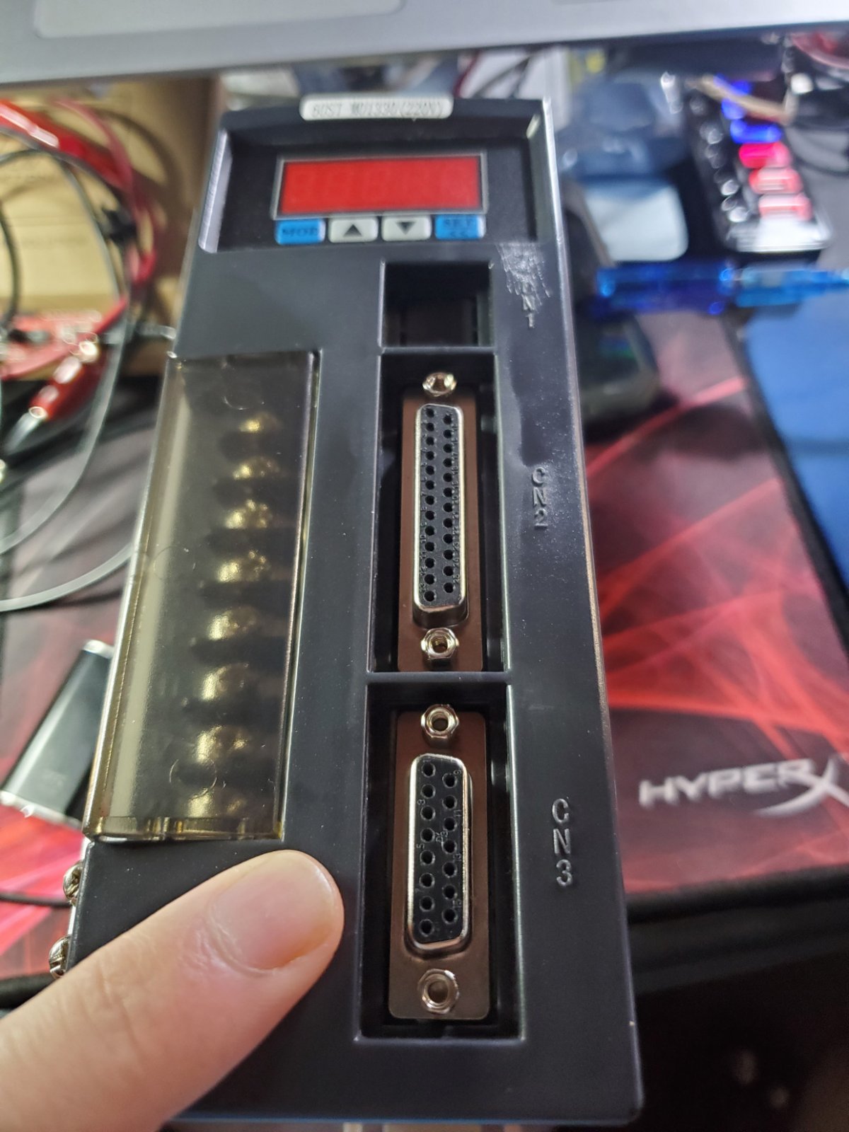

    I made a big mistake in my order and receive a DS 100s-75 driver with 26 pin connector. I contact seller and there is no way for return. There is a way to use this drivers with your controller?
  8. Thanos
    Jul 6, 2017
    1,347
    Electronics Engineer
    United States
    2,699Coins
    +1,043 / 9 / -0
    According to the manual (I think its for this servo anyway), there is no torque level output signal from the servo, which will not allow hard stop calibration. External limit switch has to be added...
    And even if you figure out the correct pinout from db25 on the AMC-AASD15A to the 26pin connector on your drive, there is still the issue of proper parameters in the servo drive to follow pulses smoothly and accurately...

    I think I will need to throw $800 in drivers to the trashcan. I focus on the specs of the servo thinking that all cames with the same driver. My newbie mistake. I'm more on the mechanic area than electrical soo I can't put this drivers to work myself without good help :/. I can put limit switches but not have idea on how to wire them to the Thanos and make them works and less about the parameters on the driver.

    Sure it could work, but...
    Have a look on the motor wiring... the encoder cable does not have same connector to be plugged in the AASD-15A servo unit.
    And generally you buy the servomotors along MATCHED servo drives, as the servo drive has to have the motor parameters and calibration done in the factory.

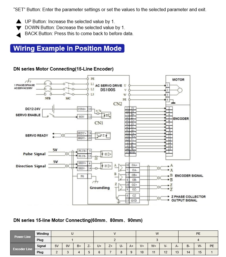

    Good good, do you have any info about wiring more than the manual? I'm trying to figure out how to connect it to the Thanos controller
  18. Gadget999
    1,897
    11,610Coins
    +458 / 9 / -0
    driver manuals attached
    it looks like you wire up pins
    3 ,13 pulse
    4, 14 direction
    is the encoder plug already wired up ?

    No worries... I'll have a look tomorrow to compile a wiring diagram and find as much parameters I can so you can try.
