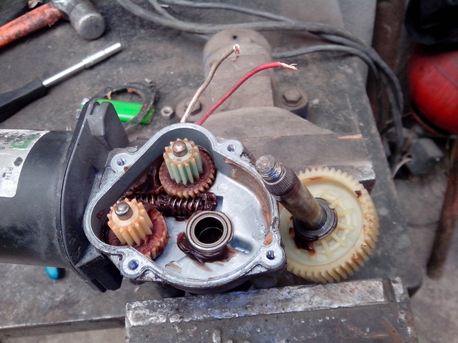

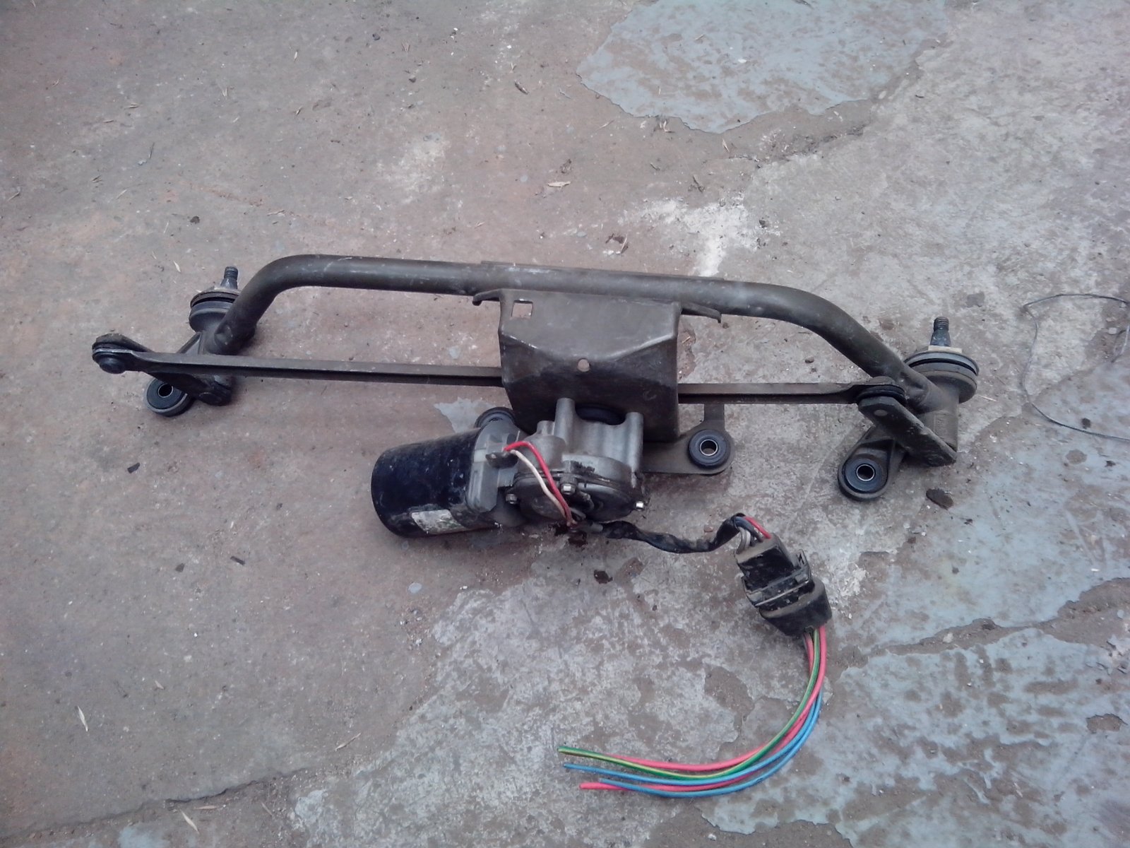

  4. NjMotion
    Dec 29, 2012
    271
    España
    1,500Coins
    +261 / 5 / -0
    2DOF, 6DOF
    Which I used in my prototype 6DOF they were of a van Citroen Jumpy or Peugeot Expert and are quite strong, have double gear in the gearbox.
  5. NjMotion
    Dec 29, 2012
    271
    España
    1,500Coins
    +261 / 5 / -0
    2DOF, 6DOF
    Image.
