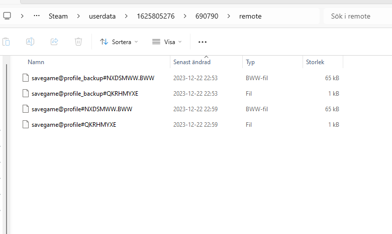

    Yes, i have. And i can see in the Steam folder that a few races has been saved. They're in the 'remote' folder, and not the 'local' folder in the Steam app. My understanding is that Steam stores saved games locally at first, then moved to the cloud storage of Steam (and moved to the 'remote' folder)(possibly straight to the remote folder, if there's an internet connection available...). I'm not sure what the Sim Tools are looking for, though, but guessing some sort of 'save game'-file format, which might be why i'm unable to patch the game.
    If games/downloads from Steam won't work, i guess i'll have to purchase the game from somewhere else. But was hoping it would work.
    Really appreciate the support!
  10. Richardh
    Richardh New Member Gold Contributor
    Dec 21, 2023
    19
    98Coins
    Here you can see the save game files.

    @yobuddy can you offer advice.
  12. yobuddy
    5,374
    50,283Coins
    +5,148 / 18 / -0
    We used the steam version of the game to make the plugin, and we patched in the my games folder too I believe.
    We are looking for the 'hardware_settings_config.xml' file.
    (I can take a closer look tomorrow when I get to my PC.)
    Chat soon!

  13. Richardh
    Dec 21, 2023
    19
    98Coins
    I think that was it! Found the file location and patched to to that folder, and the patching seems to have worked. I will get back shortly. Thanks again!
