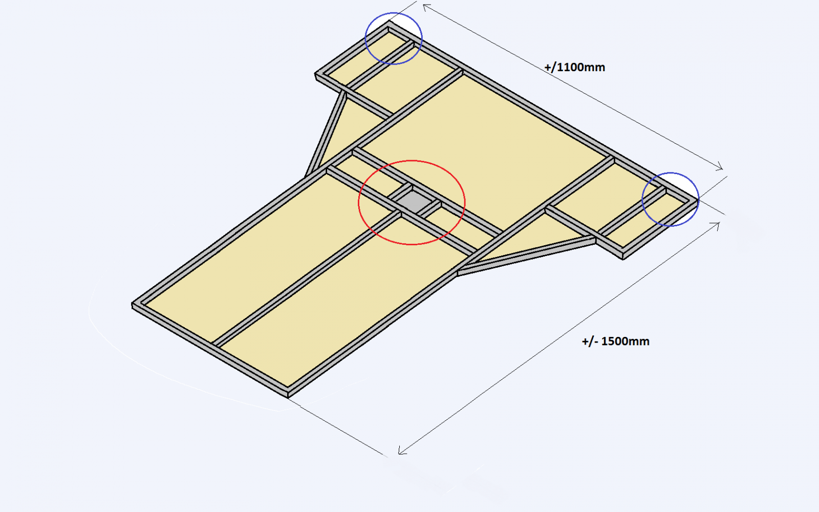

    Had a few hours to spare when i got home from work and made a rough sketch of the frame in paint, turned out it was pretty easy to do so this is what i'm going to build.
    The view is from underneath so i could also fill in the wooden plate or board that i will mount on top of the frame.
    The red area is where i'm going to mount the seat or u-joint part, there a metal plate welded on top of the frame as i'm planning to bolt the u-joint to the frame with a 4 bolt pattern flange.
    The blue area is where the motors are going to be spending their time for the rest of their lives :).
    Maybe the motors will also have metal plates welded underneath them to support them but i dont even have them yet so im not going to worry about it.
  17. bsft

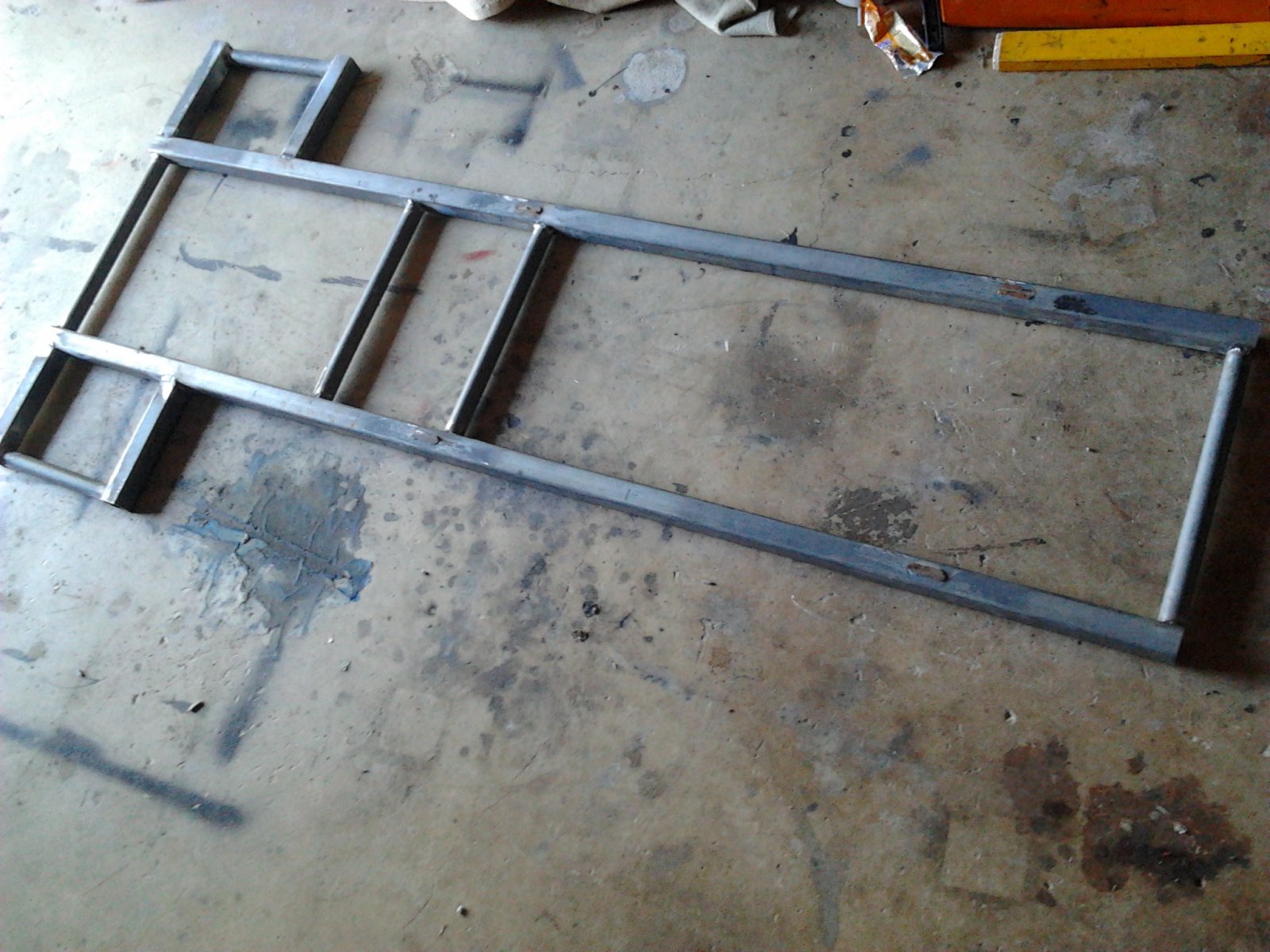

    looks good so far, similar to how I built the base for a sim I did

    I see you have the seat placed more towards the front of the frame, didnt know how much space was needed behind the seat but your picture says it all, will change the seat position bij about 20 cm so the motors can be placed further back.

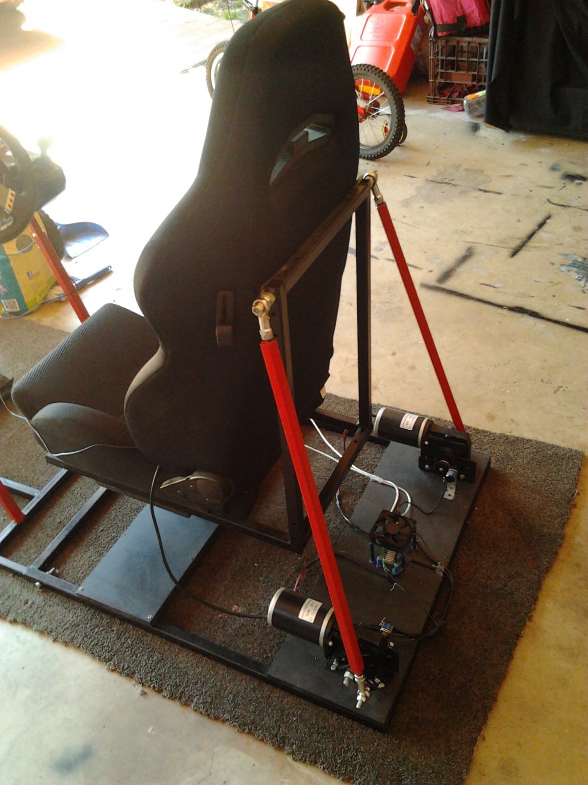

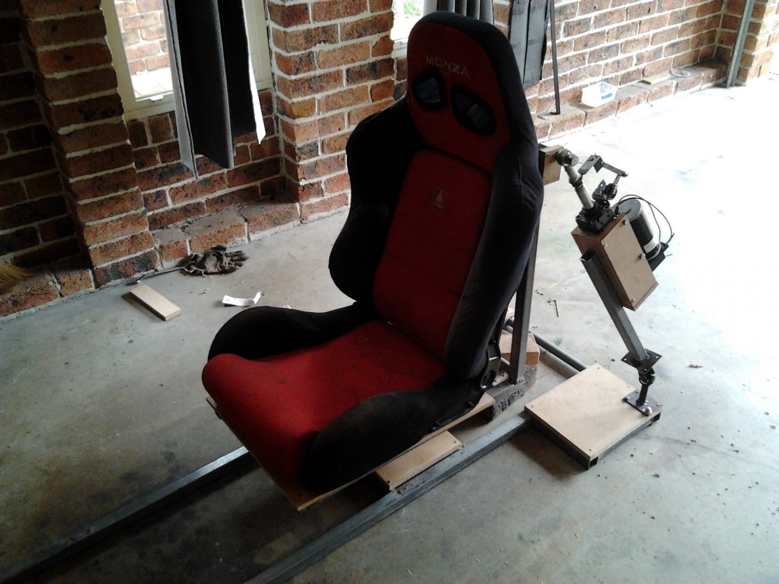

  19. bsft
    never judge a frame by the person building it.
    Pivot is at best balance point
    Heres a clearer shot
    actuators sit back about 15 ish degree
    same with former DC motor sim
