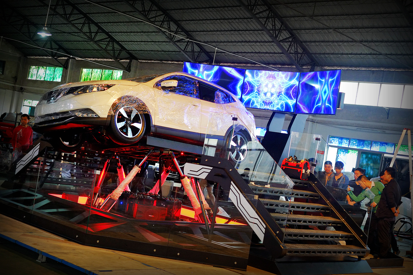

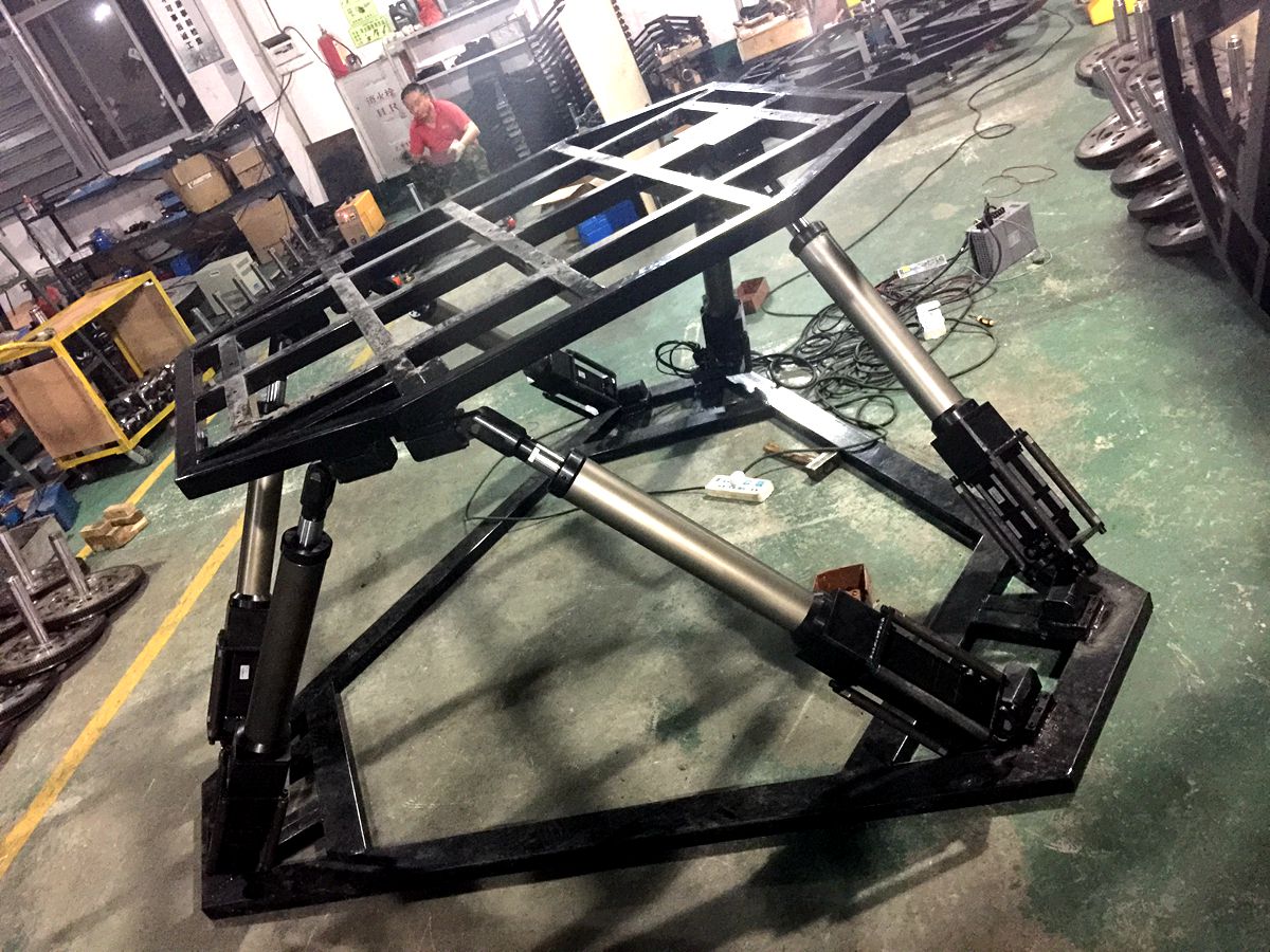

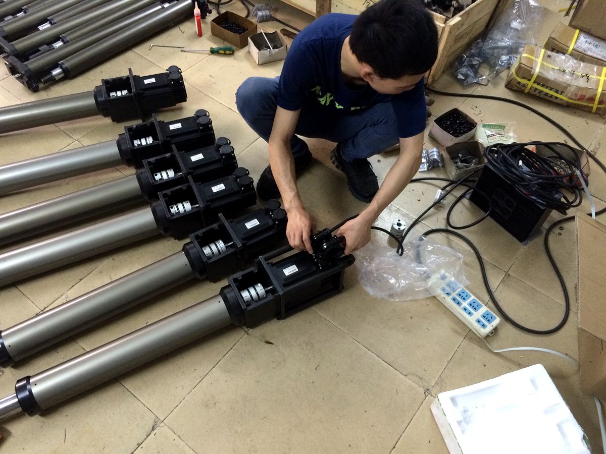

    like the pic. my simulator is not design to use for racing, it is use for VR experience。we make the vr video with 4 HMD sync play,then made the motion sync data for the 6DOF platform。
    we use Linear cylinder + servo moto+servo drive include controller . the servo drive support Modbus Protocol when use 485 have communication with computer。
    now i want to make the sensor on the wheel and pedal let the platform become a race simulator. just want to know is it possible to use Simtools? is anyone can help? or let me know what should i do can make the fast way to let it be come true? thanks~~~

    this VR Simulator is my company make for nissan to Car show.
    i already send the pm for yobuddy,but maybe the christmas,still waiting for respone。。。。

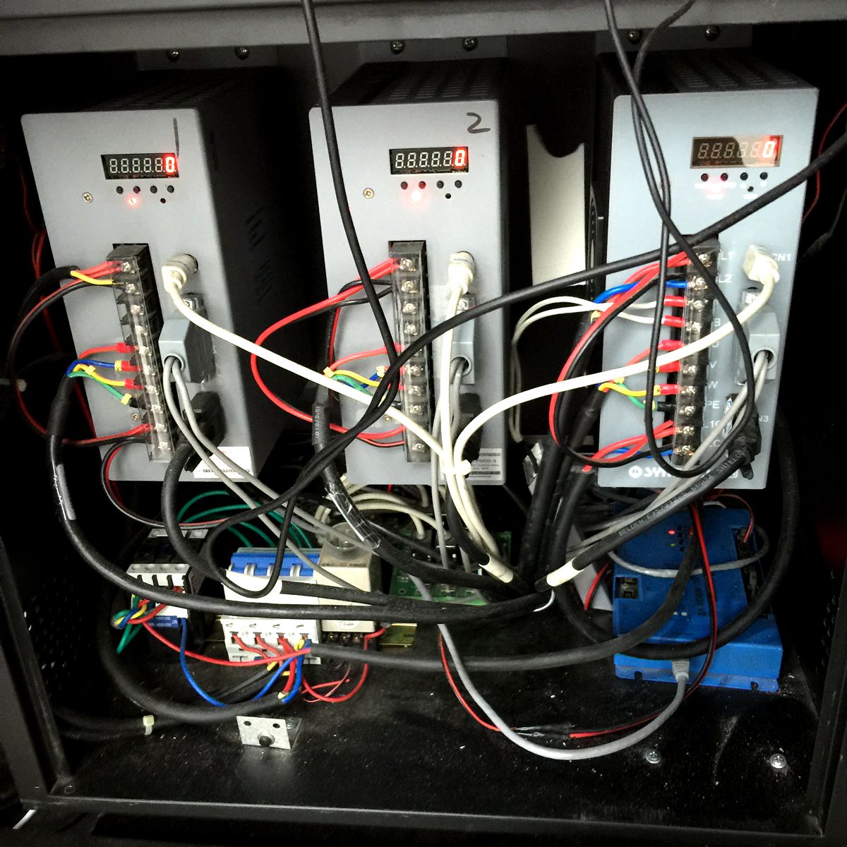

    Thanks SeatTime.u saying the point.for me,the 6dof platform and the power platform is not the problme,they are always here.my people is ok for mechanical structure.but not so pro about programming。as my vr platform.the servo drive controller brand owned
    their patent and communication standards,they make an "blue box(can saw in the pic)"for us .to use net interface to
    communication and interpretation of data from our pc sofeware ,we use unite to make the movie motion data.then use our own pc sofeware to send it back. this is my question now. i do not know much about simtools too,i try to use 485 to connect between servo drive(with out the blue box)and simtools. there is no communicate.we need an interface support and data interpretation in simtools,or some way or anothe pc software to interpretation of data from simtools.let the servo controller knows what and how much the servo motor turn.this is what feedback am i get from my people. i feel nit so complex with that....right?btw.sorry about my bad english...:blush

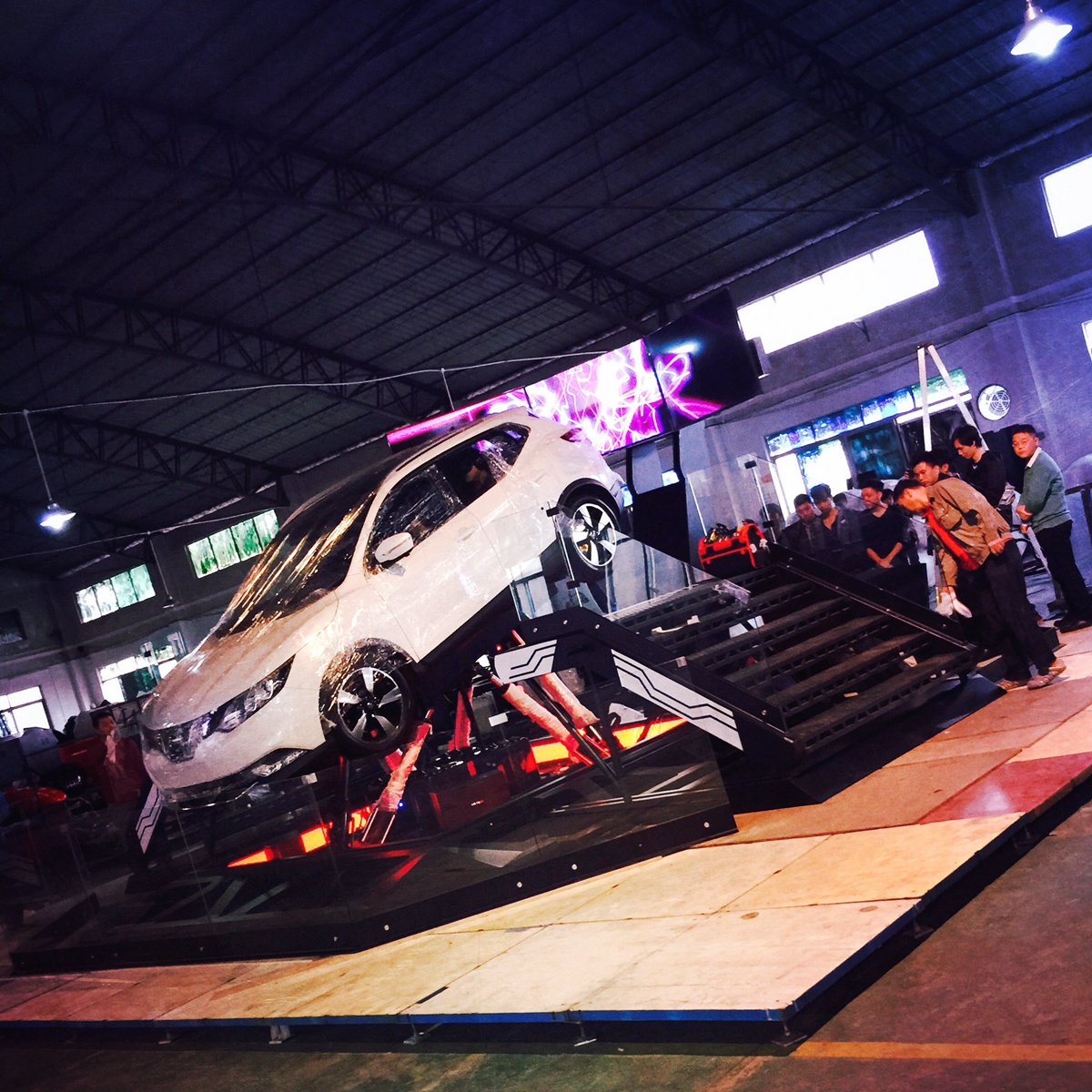

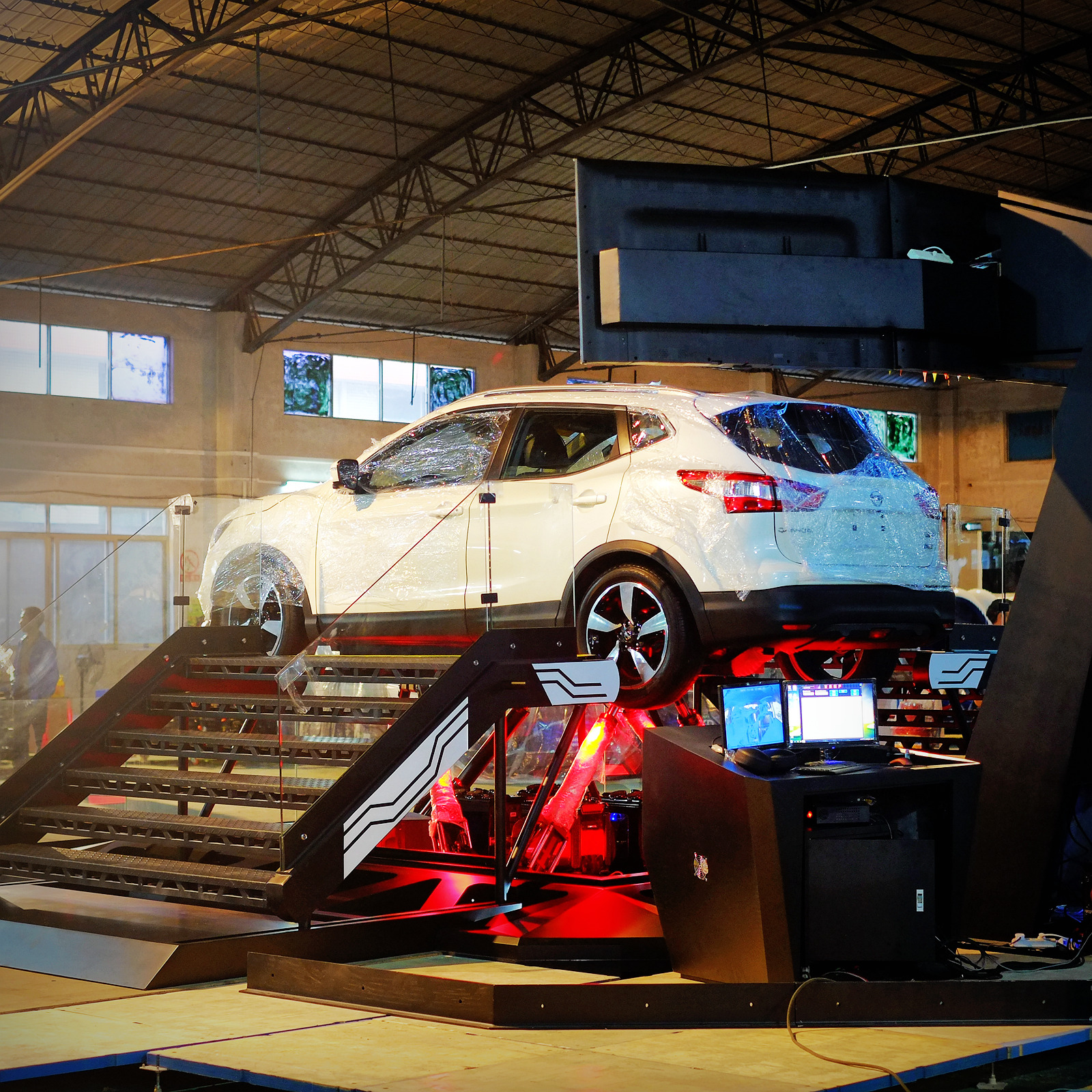

    finially.....it is done. upload that 2min video use 2 hourT.T
    the motion is sync between the HMD.depening our vr movie showing in DK2. the movie is too big.i can not upload...may uploade some pic of the people try it in the car show later
