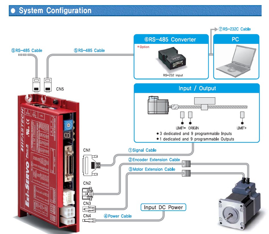

    Hello everyone. I would like to use yobuddy's motion program but first I need to reset the SCN6 i.d. to zero. I can't seem to get the TVBST utility to recognize the port I'm connected to. I suspect it's the servo blocking the signal but I'm no expert.
    Setup:

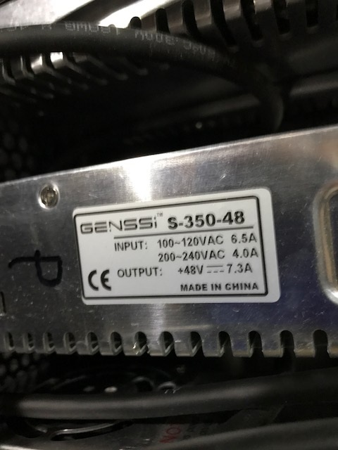

    Actuators model OLE-3508-100-NG (SCN6) 350 lbs. of thrust
    Power supply/controllers (Genssi S-250-48) -48v, up to 7.3 amps
    Servos model Ezi-Servo Plus (closed loop)
    The power supply is connected to the actuators. The Servo is connected via Cat5 cable to an RS-485 converter, then on to the computer via USB cable.
    I am unable to get the TVBST utility to recognize the port an individual actuator is connected to. I disconnected all but one of the systems but still it cannot recognize the port. Any ideas?
