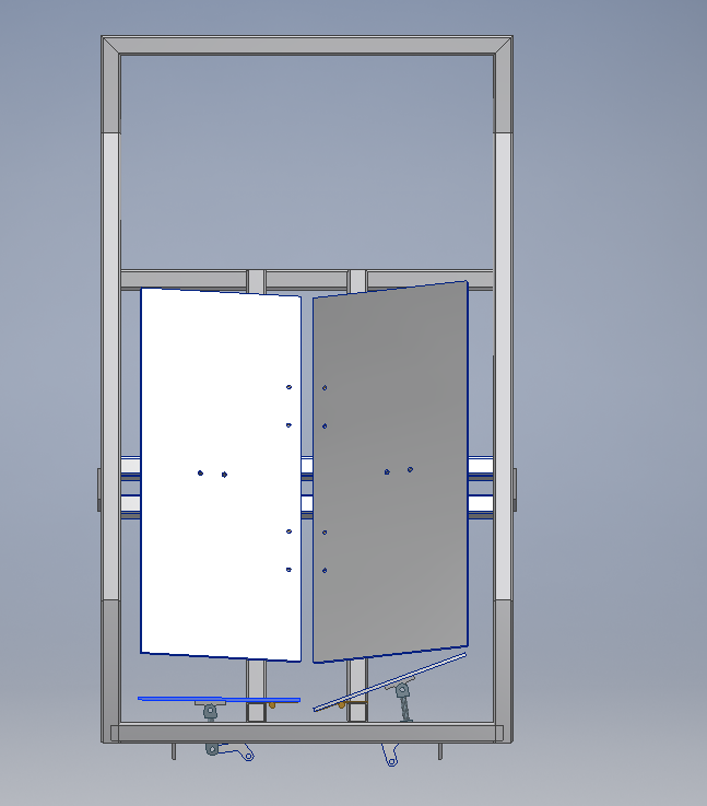

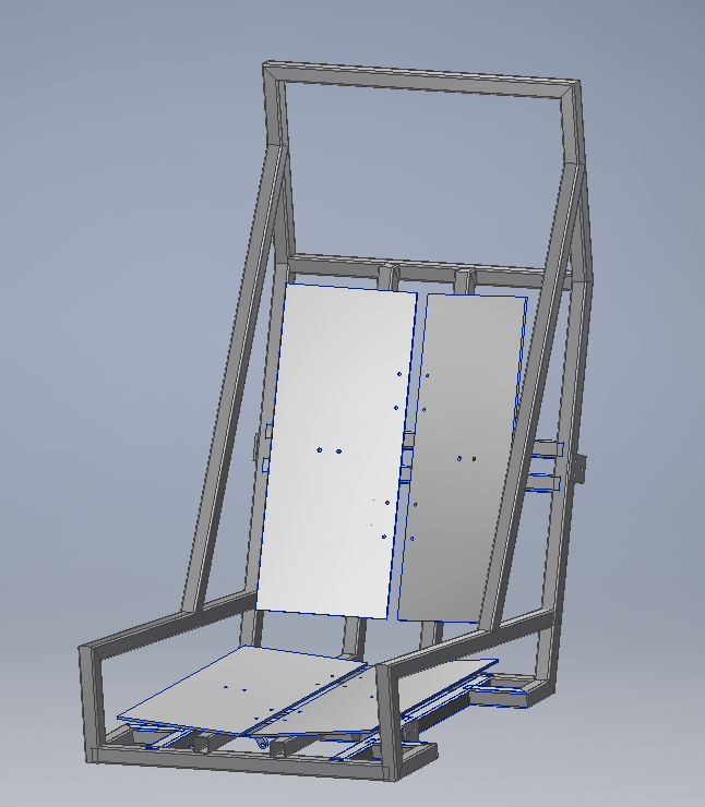

    Hi Everyone,
    While I'm waiting for some of the components for my new relatively compact 6DOF to arrive, I'd like to share some information on the progress in completing the g-seat, which I eventually plan to put on the moving platform.

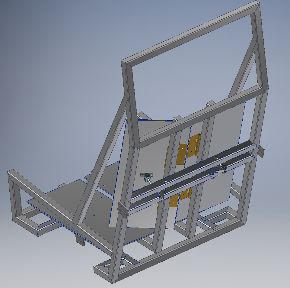

    Weight of the seat is important in my situation, so I decided to use aluminum as much as possible and to use bowden cables while placing the motors away from the seat. I have Transtecno 350/500W DC motors left from my first 6DOF, so I will be using four of these to drive the flaps.
    Here is the general design without padding:

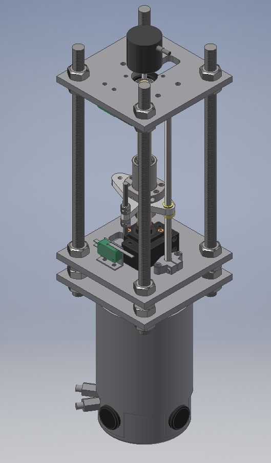

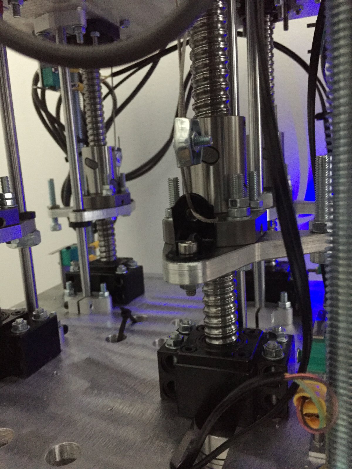

    The flaps will be driven by four motors with 200mm leadscrews:
    The motors will be controlled with two Sabertooth 2x60 + Kangaroo x2 -- again, these are left from my original 6DOF.
    The cables are the ones used for the bicycle brakes. I hope they will be strong enough.

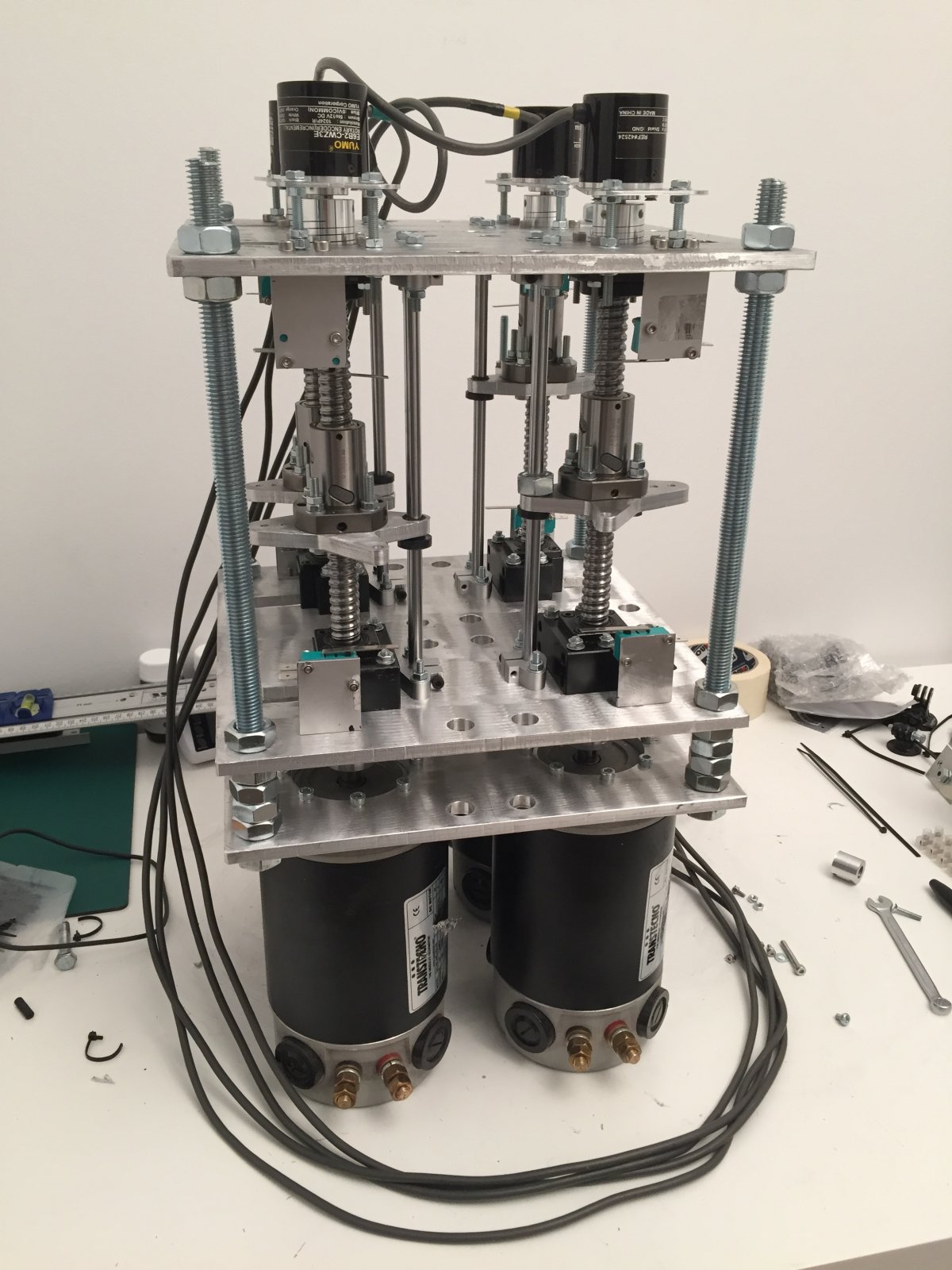

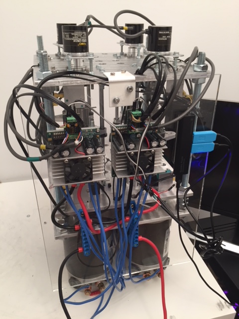

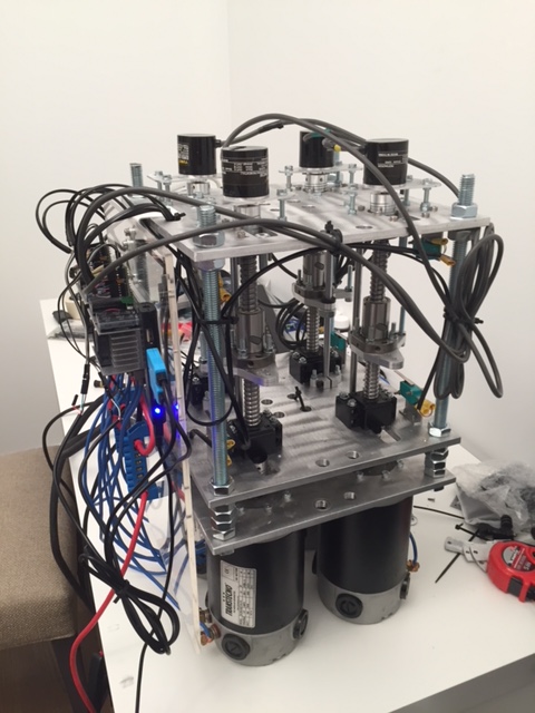

    Things are moving, the motor assembly is almost ready. I just need to add sabertooths and connect encoder and limit switch wires.

    Okay, it's alive. Everything works, kangaroos autotune just fine, but why do I always end up with a spagetti monster?!
    The plan is to assemble the seat itself and try to actually control it with cables tonight.

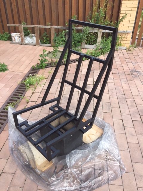

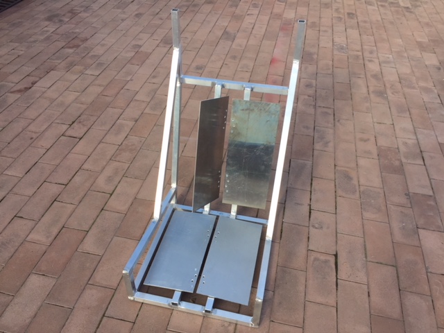

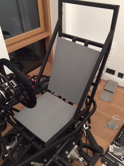

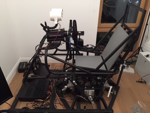

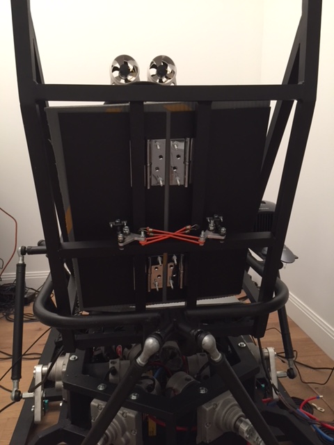

    Seat assembly took quite a bit more than I expected. I only managed to install it on the rig yesterday. Here is how everything looks now:
    Hopefully, I will be able to connect the remaining three cables tonight and proceed to testing.

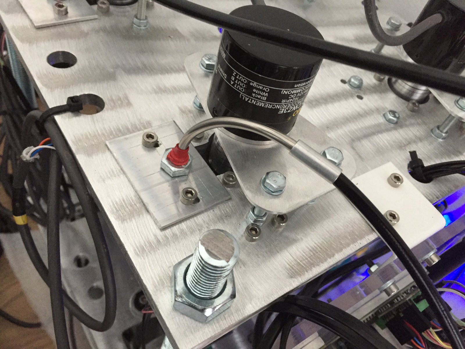

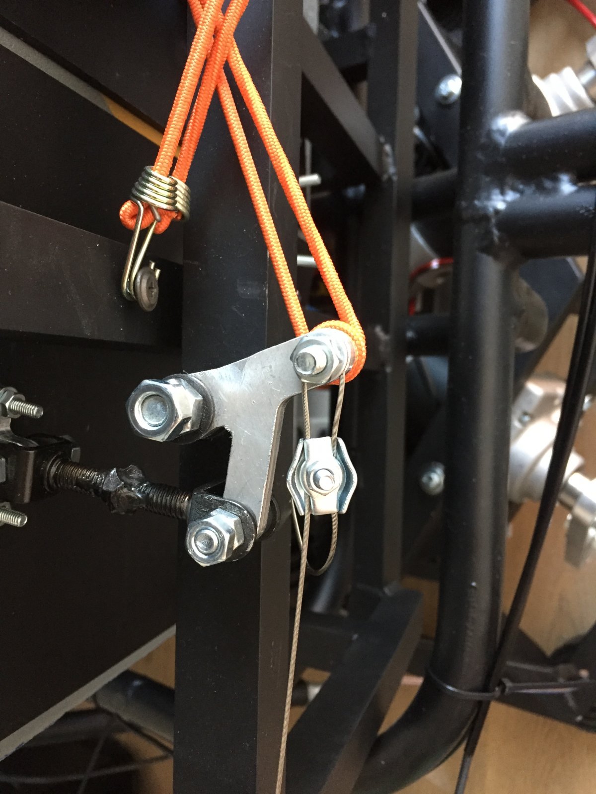

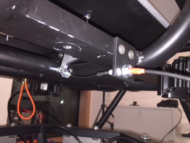

    I finally fitted the cable between the actuator and one of the heave flaps and did the first test. The test revealed two issues:
    The first problem is that the plastic end caps for the cable sleeve are too soft and get destroyed almost immediately. I’ll need to manufacture a metal replacement.
    The second problem, which looks more difficult, is that the part of the cable that goes from the actuator to the rig and basically hangs in the air twists and warps when when the actuator pulls hard. This absorbs the pull and the flap does not move as it should. I’m not yet sure how to fix that. Maybe the bicycle brake cable which I use is not strong enough for the task.
  7. Grigory
    Grigory Active Member Gold Contributor
    Jul 6, 2016
    202
    Moscow
    218Coins
    +305 / 1 / -0
    3DOF, 6DOF
    Problem solved! I discovered that while the wires in my Bowden cables were for bicycle brakes, the housing happened to be for the gears. Brake housing is considerably thicker and stiffer.
    I replaced the housing — and everything worked! No more twisting or warping problem.

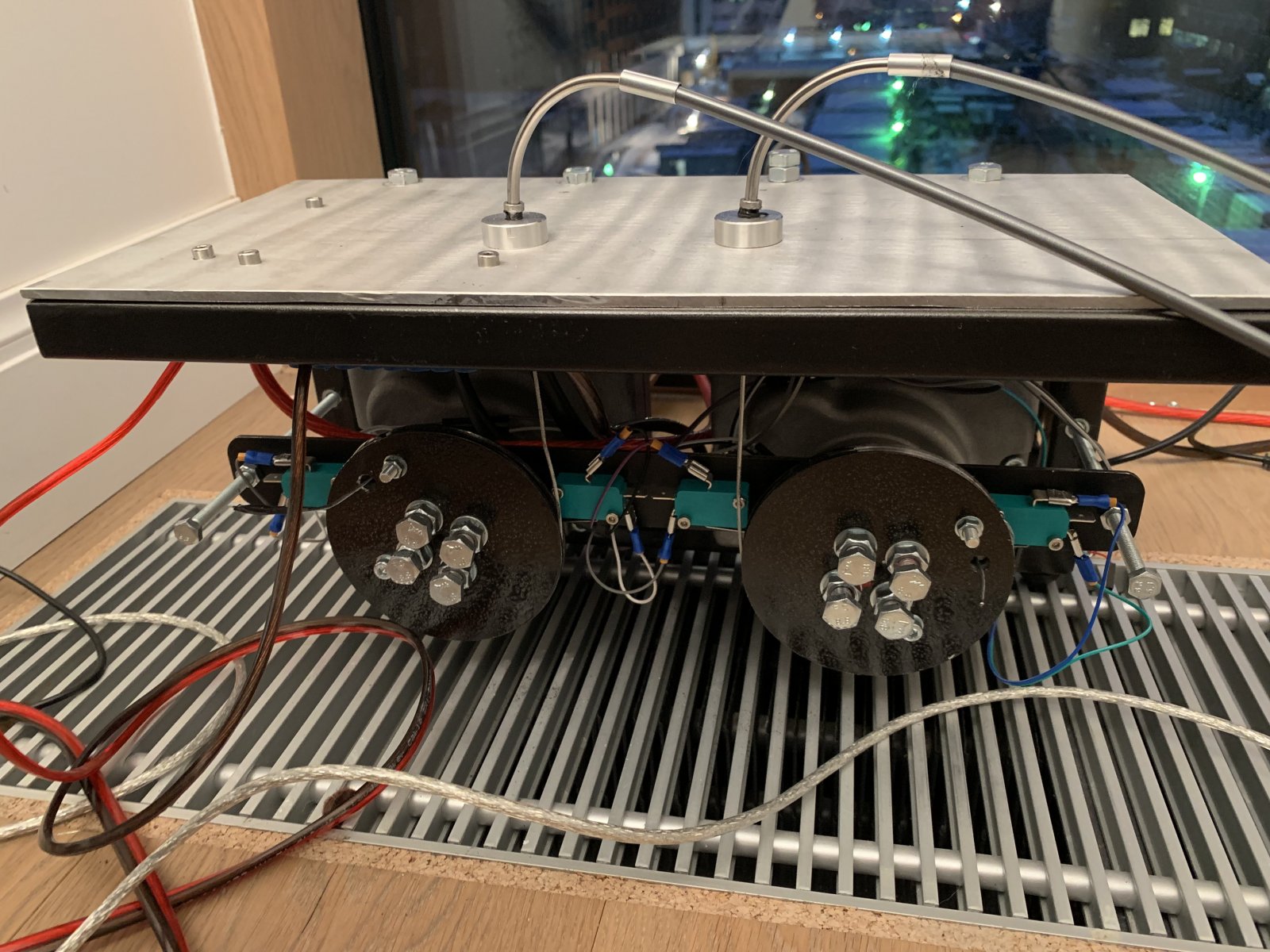

    Just as I expected, now I have a prolem with feeling SimVibe effects. My shakers are mounted to the cockpit structure and I can barely feel any vibration coming through the hinges of the lower gseat flaps.
    I probably need to somehow connect the shakers to the lower flaps themselves. I’m not yet sure how to do that without obstructing the movement.

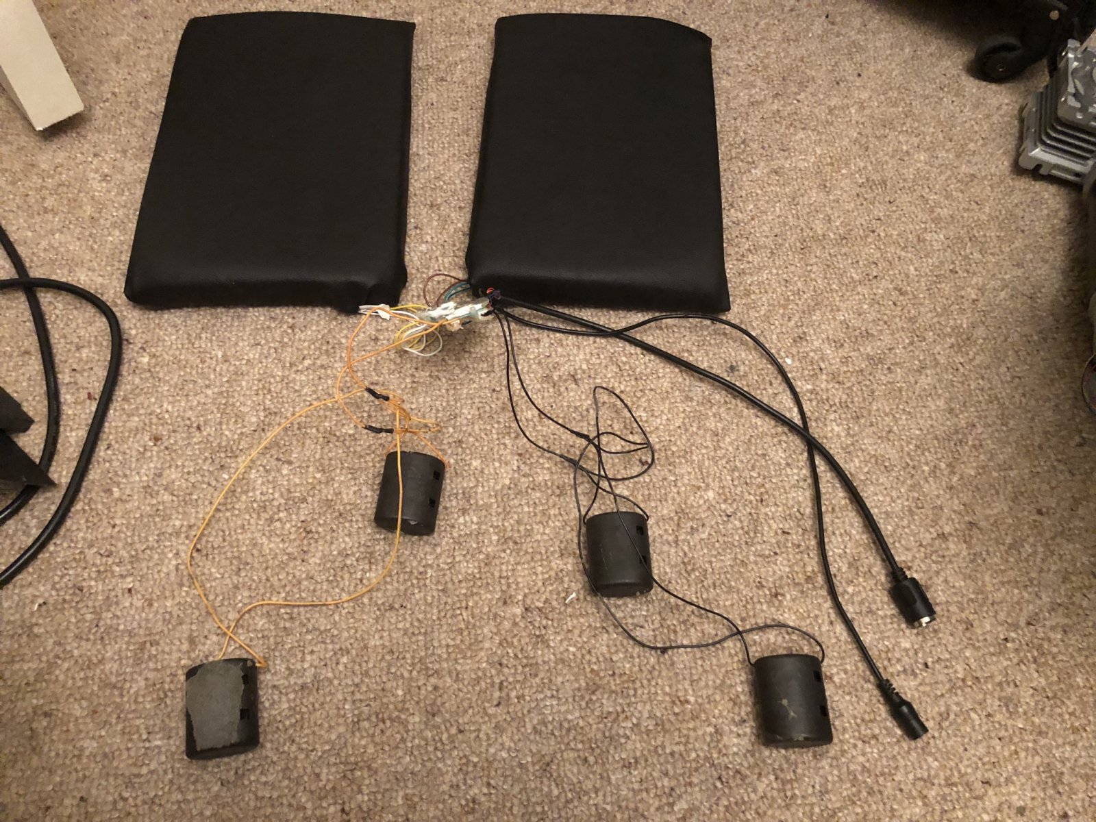

    Have you considered a jetseat or similar vibration cushion? I have a KW908 which I took apart and embedded the small vibration motors in the cushions of my backrest and seat flaps. It gives good localized effects and the intensity varies depending on how hard that particular flap is pushing against me.
    Here you can see the backrest cushions completed and the motors for the base of the seat before they were fitted.

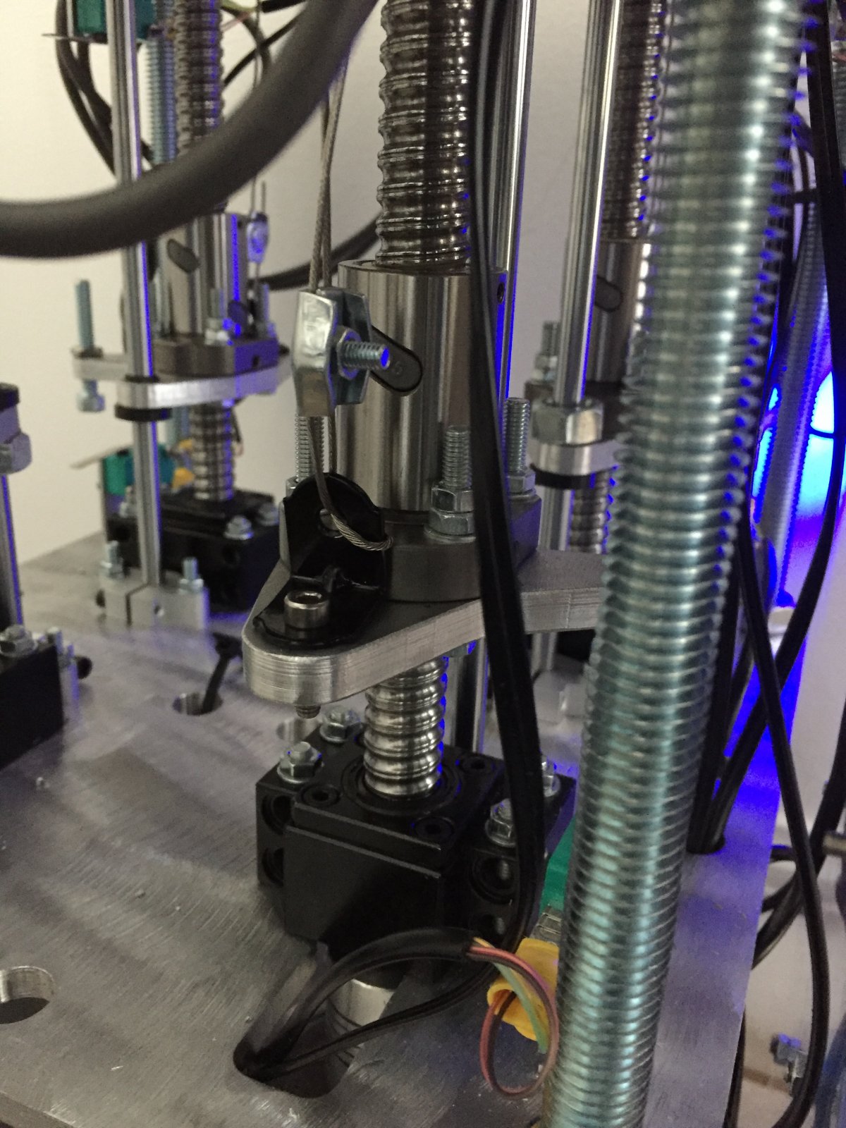

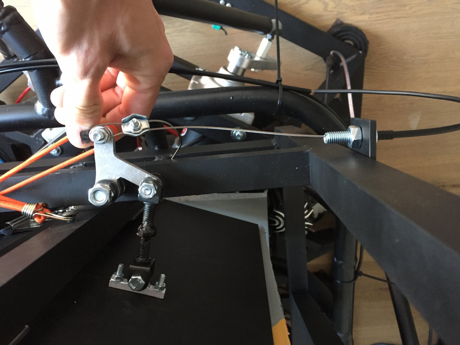

    Could you share more pictures or video of the bowden cable connection to the actuators? I’m fascinated to see them in action. Does each cable only pull (I noticed the bungees on the backrest flaps)?

    Yes, the cables are just pulling. I’m using bungee cords for the back and my weight seems to be sufficient to quickly bring down the lower flaps.
    Here are some photos:
    9D47E28A-F8C2-4155-B845-2D7C2D1EDF08.jpeg A7AD5846-5906-4594-AE8D-22E12E1F02FA.jpeg F3C5B486-C70B-44A8-BE45-B62CA34BC45A.jpeg 488643FB-28BC-4B4A-9FF8-06667F7C59BD.jpeg 48EEDBE7-7962-4E70-8230-2C75D570053B.jpeg

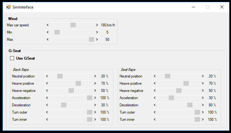

    Here's how my VB.Net app looks:
    I initially used it to get the current speed from SimDash and to generage commands for the Sabertooth running the simulated wind fans. Now I'm also using it to control the G-Seat. The app gets Surge, Sway and Heave from SimTools and sends commands to Kangaroos based on the set of parameters, that can be tuned in real time.
    I can set the flaps' neutral position and separately control how much effect negative and positive input values have on the actual flap movement. The shown settings, for example, mean that when all the inputs are at zero the flaps should be at 20% of their full travel. When going over a bump, the flaps will push using not more than 70% of the remaining travel, or not more than 80% * 70% = 49% of full travel range. When going over a pothole, the flaps may decrease the pressure by not more than 20% * 50% = 10% of the full travel range. The similar adjustments can be applied to the turns, when the movement limits for the flaps on the outer and the inner side of the turn can be individually specified.

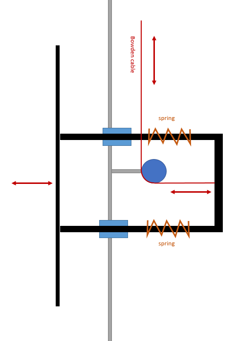

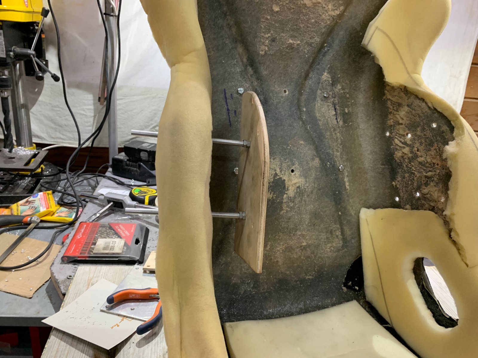

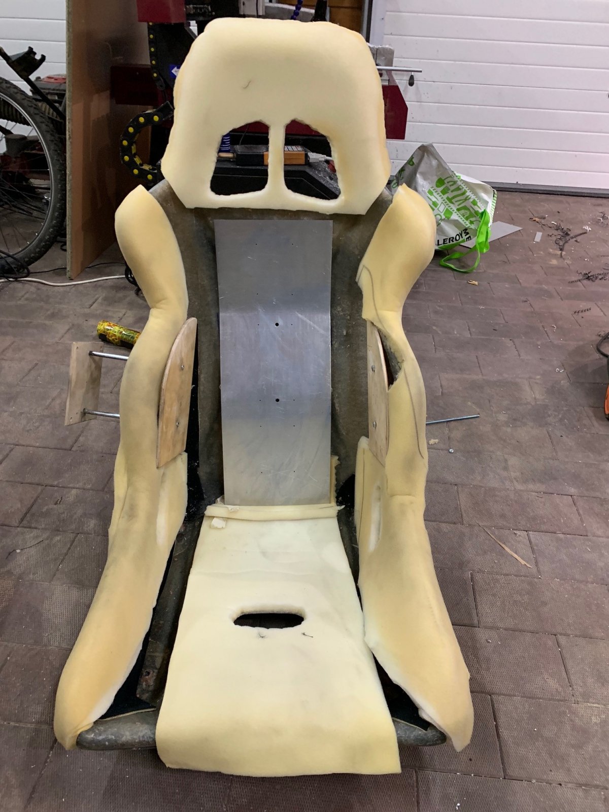

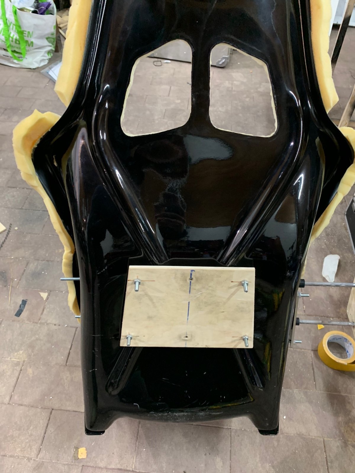

    While this seat works fine, I am thinking of making a second version, mostly to improve the looks and comfort:
    - V2 will be based on my previous fiberglass bucket seat
    - V2 will only do surge and sway. I do not even use the existing heave flaps now, 6DOF fully takes care of heave.
    - V2 will also be cable-driven.
    I also intend to experiment and replace the hinged flaps with linearly pushing plates. I did not see other people using this in their gseats, so this approach may certainly have drawbacks. However, this design is easier to integrate in my bucket seat and just requires drilling few small holes.
    This is the general idea:
    The seat will have three pushing plates: two for sway and a single back plate for surge.
    The plates will be actuated like this:

    After thinking more about the feeling that a single back plate will produce, I decided that it would not actually be realistic. During acceleration, the plate will push me closer to the driving wheel and make me counter that force with my hands, which should happen during braking, not acceleration.
    So I decided to stay with the two back flaps design, but using push rods and rollers:

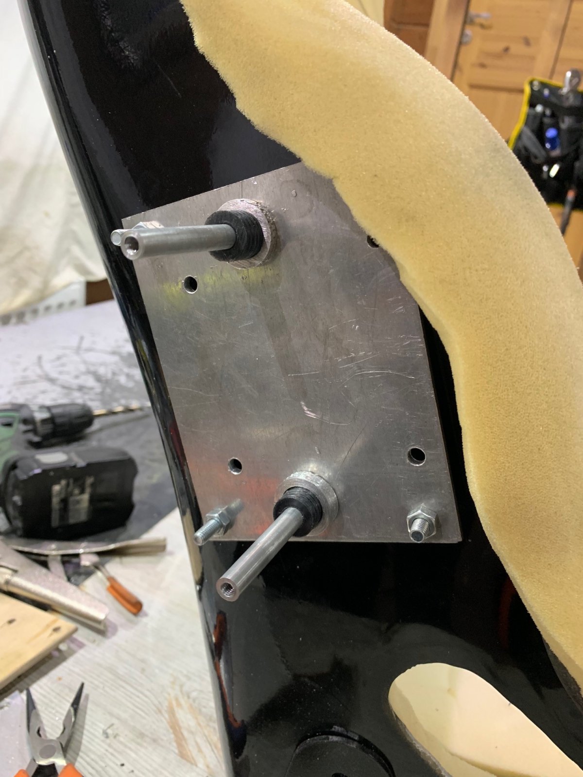

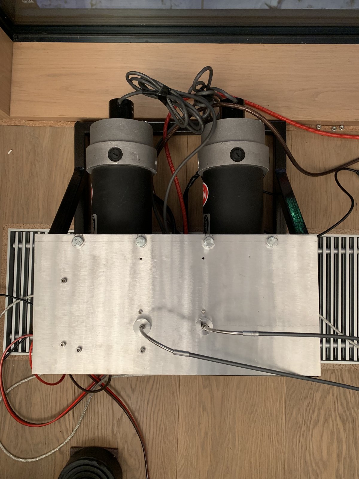

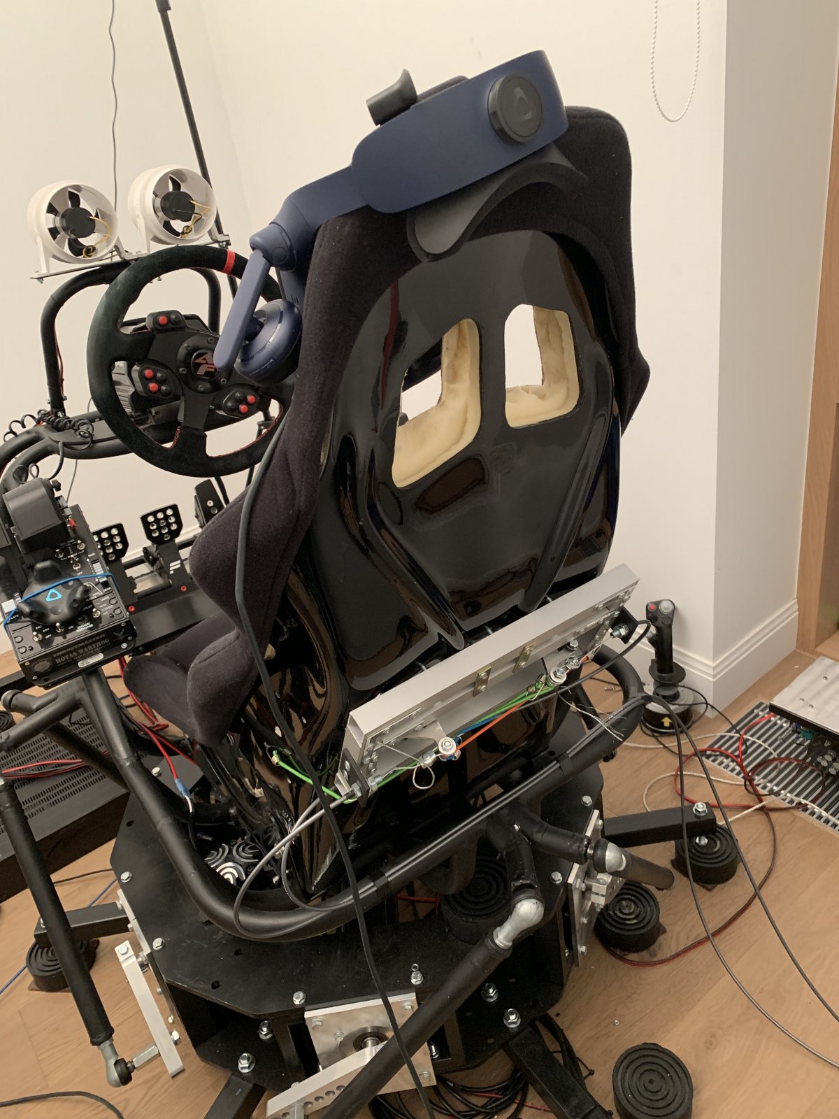

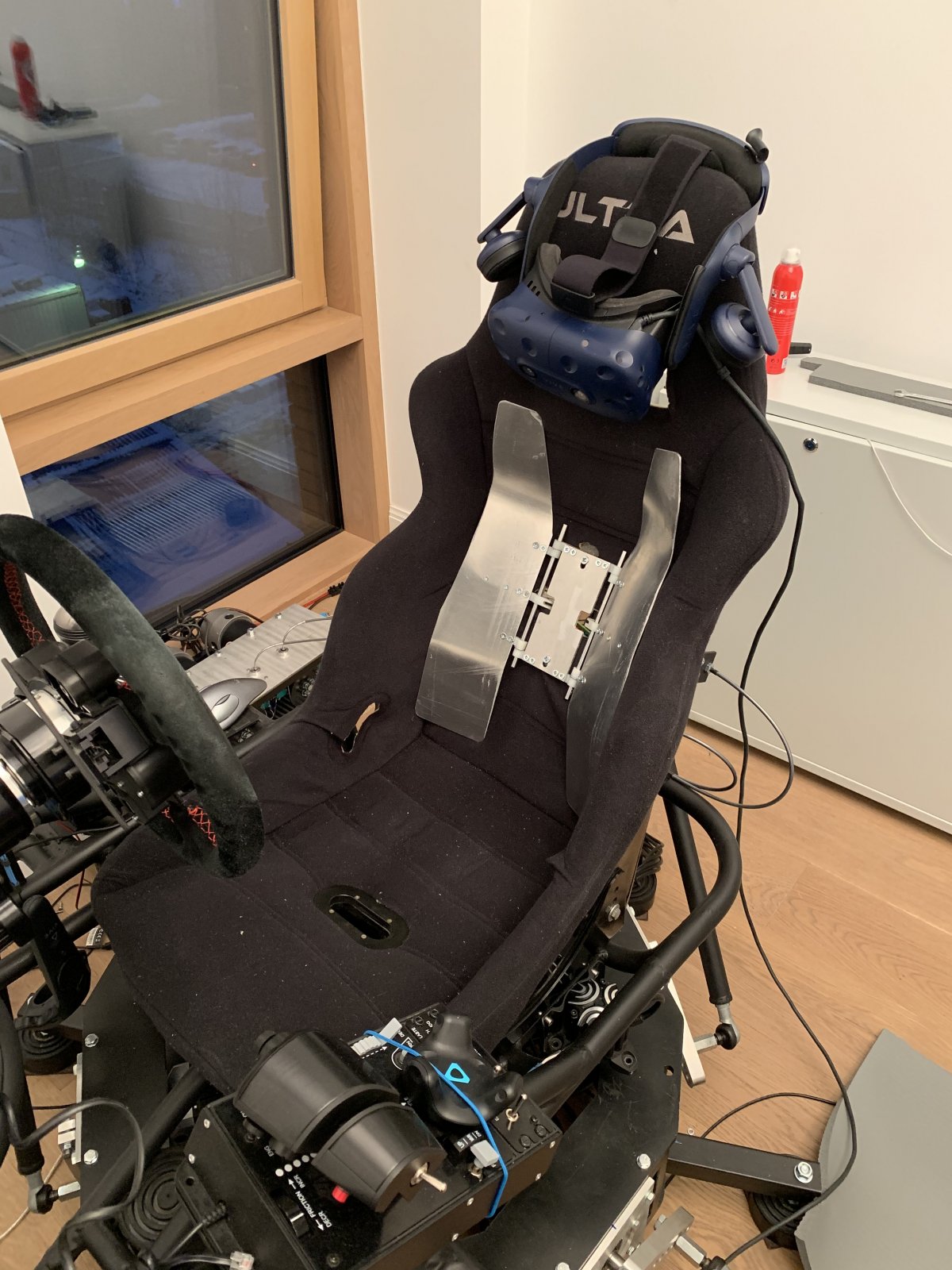

    New version of Gseat is ready.
    I finally decided to drive the flaps with the mechanism previously installed on the first seat. It’s now mounted to the temorary frame screwed together from aluminum tubes, but I will weld a new cleaner frame over the weekend.
    The cables are pulled with two NPC-T74 motors controlled with a sabertooth 2x60 and a kangaroo.

    Looks really nice. When will we see it in action?
    I really like the way you fix the Vive tracker. LOL

    it’s actually not working, I just forgot it there :)
    I have not yet been able to solve the problem with high-frequency vibrations killing tracking.
