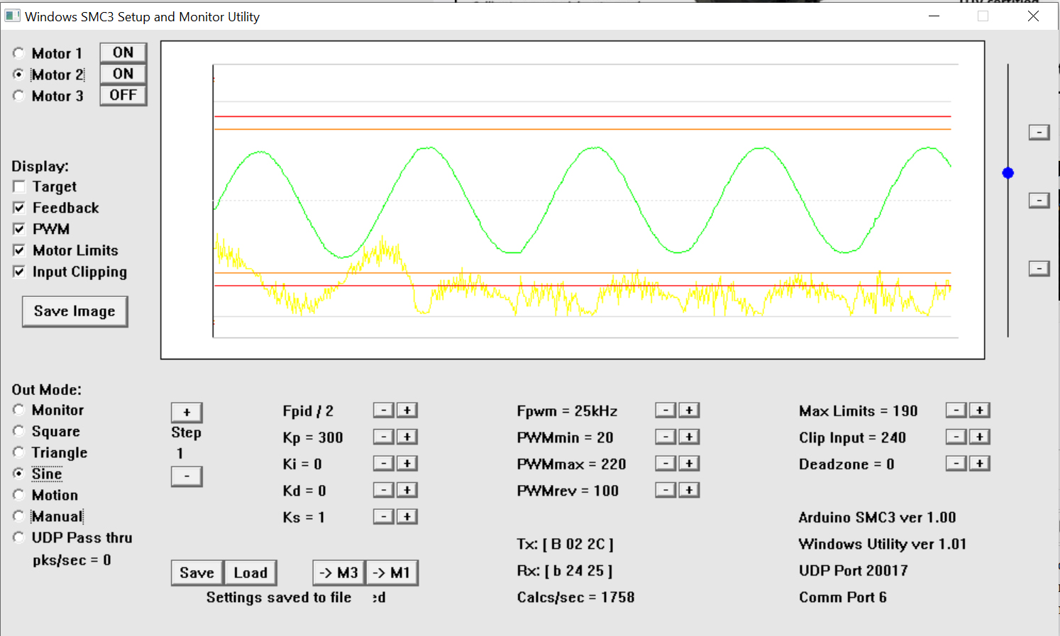

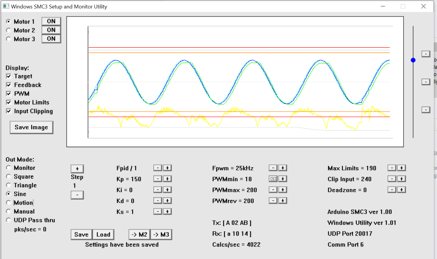

    The only thing holding me back right now is the motion of my motors are "rough" or "bumpy" feeling when the motion should be smooth. This happens whether I'm sitting on the chair or not. I've been tweaking settings while running sine motion in smc3 and I've been able to improve it, but going too far creates other problems which makes me think I'm not looking in the right place.
    Decreasing Kp improves it, but if I go below around 250, then the large scale motion starts to fail.
    Decreasing PWMmin improves it, but same thing starts to happen.... large scale motion falls apart below around 15.
    Kd/Ks don't seem to have an effect.
    I'm pretty confident my pots are rock solid. If anything there might be some play at the bottom and top, but there shouldn't be an variation mid-stroke. I'm not sure what else to try. The SMC3 screenshot is where I'm at now and it's the best I can get it. Hopefully someone will have some ideas of things to try or check.
    24v, 250w, 75rpm wheelchair motors
    IBT-2's
    360° hall pots
    2x 24v, 600W PSUs
    Thanks in advance.
  2. Gadget999
    1,953
    11,947Coins
    +484 / 10 / -0
    set pwm min to zero
    set pwmmax and maxrev to 255
    reduce clip and limits to much smaller numbers
    show us a video of the problem

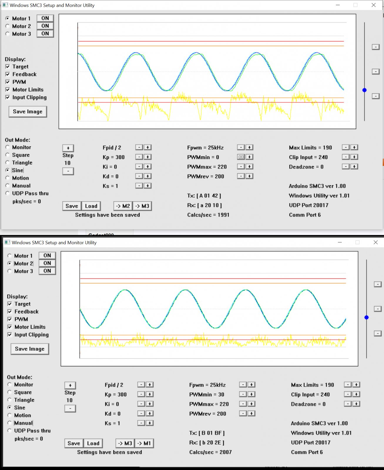

    PWMmin to zero does smooth out the motion on the way up and down significantly, but then the levers get delayed when switching direction. They stall a bit at the bottom and top. Notice the flat spots after the peaks and troughs when pwmmin is 0. 30 smooths those out completely. I think 10 to 15 is a good balance between the smoothness of the straight line motion and the stop-to-start motion. In flight with the butt kicker and all the axes active, it's imperceptible.

    Try increasing the kp.
  5. Tim Herschbach
    Tim Herschbach Member Gold Contributor
    Oct 23, 2023
    103
    585Coins
    +24 / 0 / -0
    This makes it worse. I just found that if I lower Kp to 150, it's quite smooth, but then it has trouble staying on target. (attached)

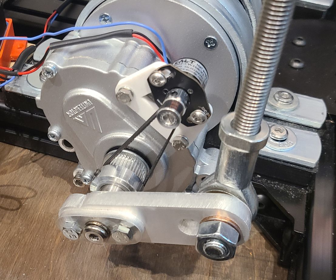

    Can you move manually the hall sensor while it is connected to the motor? I installed an elastic belt (instead of a toothed belt) that makes me able to move the hall and make the motor moving without any command from the PC. By this way the arduino will correct the position of the motor by they own. Try it (be careful manipulating the motors and sensors manually) and notice if the movements are smooth or what. If the movements are good, I'm sure the problem is in the communications between the PC and the Arduino. That way is the way I use to isloate the problem (then I discovered by chance about the jumper I mentioned)

    I would think that as well except it behaves this way whether I'm sitting on it or not. I can put my hand on the lifter rods and feel it when I'm not on the chair. It doesn't seem to change at all as I apply load.
    CTC is 65mm.
    I have toothed belts, so no. That would be a good way to take the sensor out of the equation (not to mention it would be much easier to level the levers). I could just disconnect the lifter arms and remove the belts and let them spin freely while I try to assess whether or not it is still misbehaving. It might be tricky though with such a short lever to try to assess motion smoothness, but I think it could be done.
    Fwiw, I don't think it is a malfunctioning component as both motors exhibit this "lumpy" motion. But maybe the halls don't have a high enough resolution or something? They are the 360° kind as I didn't want to take a chance with breaking them. IIRC, they're geared 3:1 so I'm getting almost 270° of travel from top to bottom.
