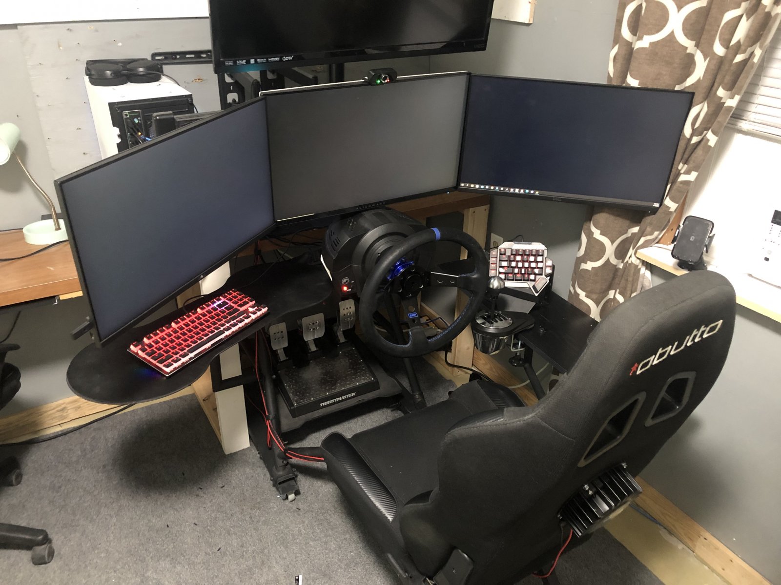

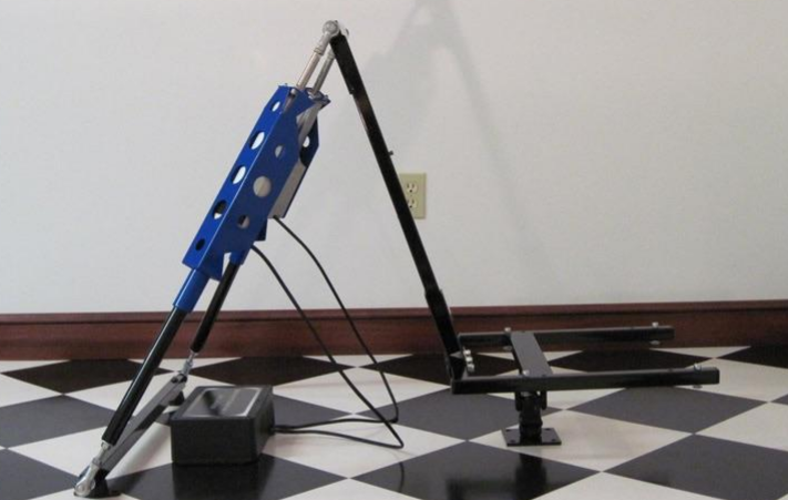

    Hello, same story as everyone else im sure. I have spent hours and hours reading and enjoying this website and now ready to build. I have an OButto Rev at this point and would like to build and fabricate a all-new seat design for a 2dof seat mover 2 replace the existing frame. Below is type of seat mover, I want to use 12v motors.
    To start was as planning on ordering (2) Yoke flanges (4 bolt) and U joint and have plenty of misc square tubing and angle iron. I wanted help choosing best design to be upgradable down the line. Thank you and big fan of everyone involved with this highly addictive website. LOL IMG_1393.jpg

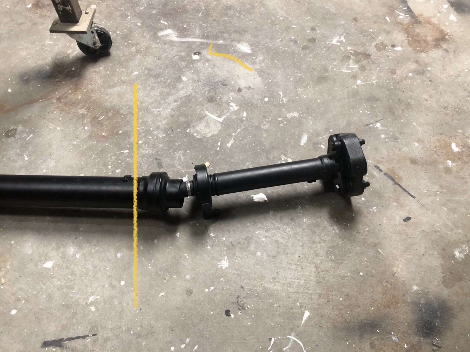

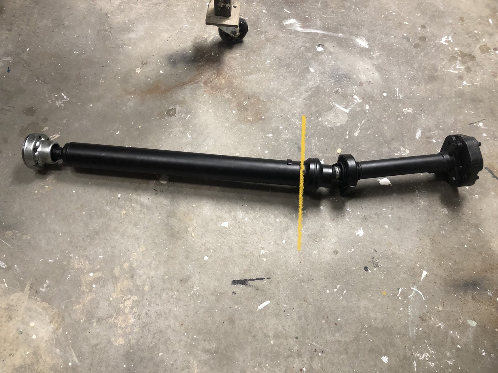

    Ok, after few weeks of deciding on plan of attack I received my first shipment of parts. Plan is to mock up controls and weld up seat and cv joint frame.
    parts received:
    $10.00 2010 Porsche Cayenne Driveshaft. Was listed because owner received for free because sent wrong part.
    I assumed there was a standard u joint at end and cv joint in center. When arrived unwrapped end and noticed has 2 cv joint setup with a 4 bolt flange and poly isolation bushing. Seems like using the flange to center cv joint will be great option after welding diagonal supports.

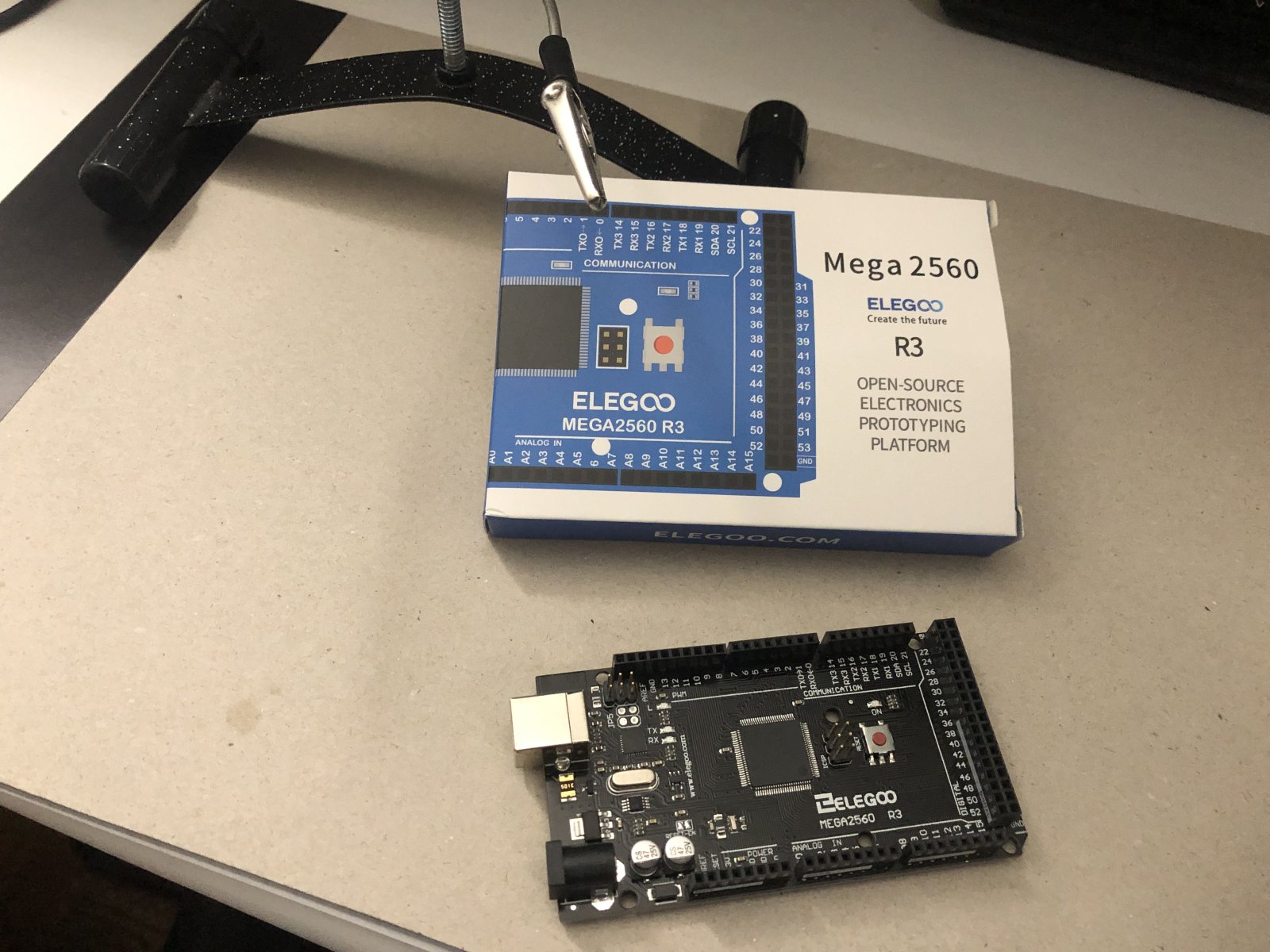

    Mega 2560 R3

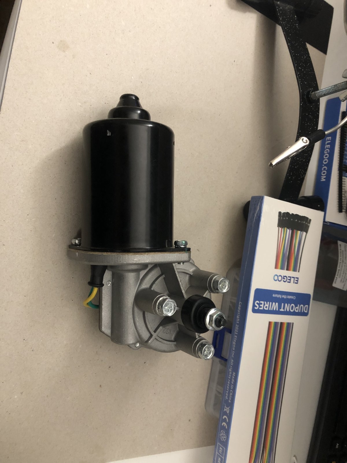

    Thank you for the help. Have you came across the 12v wexco commercial wiper motors? I could not find the 50:1 Pgsaw style motors available at this time so to start found these for a decent price new from a seller for only about 30 each.

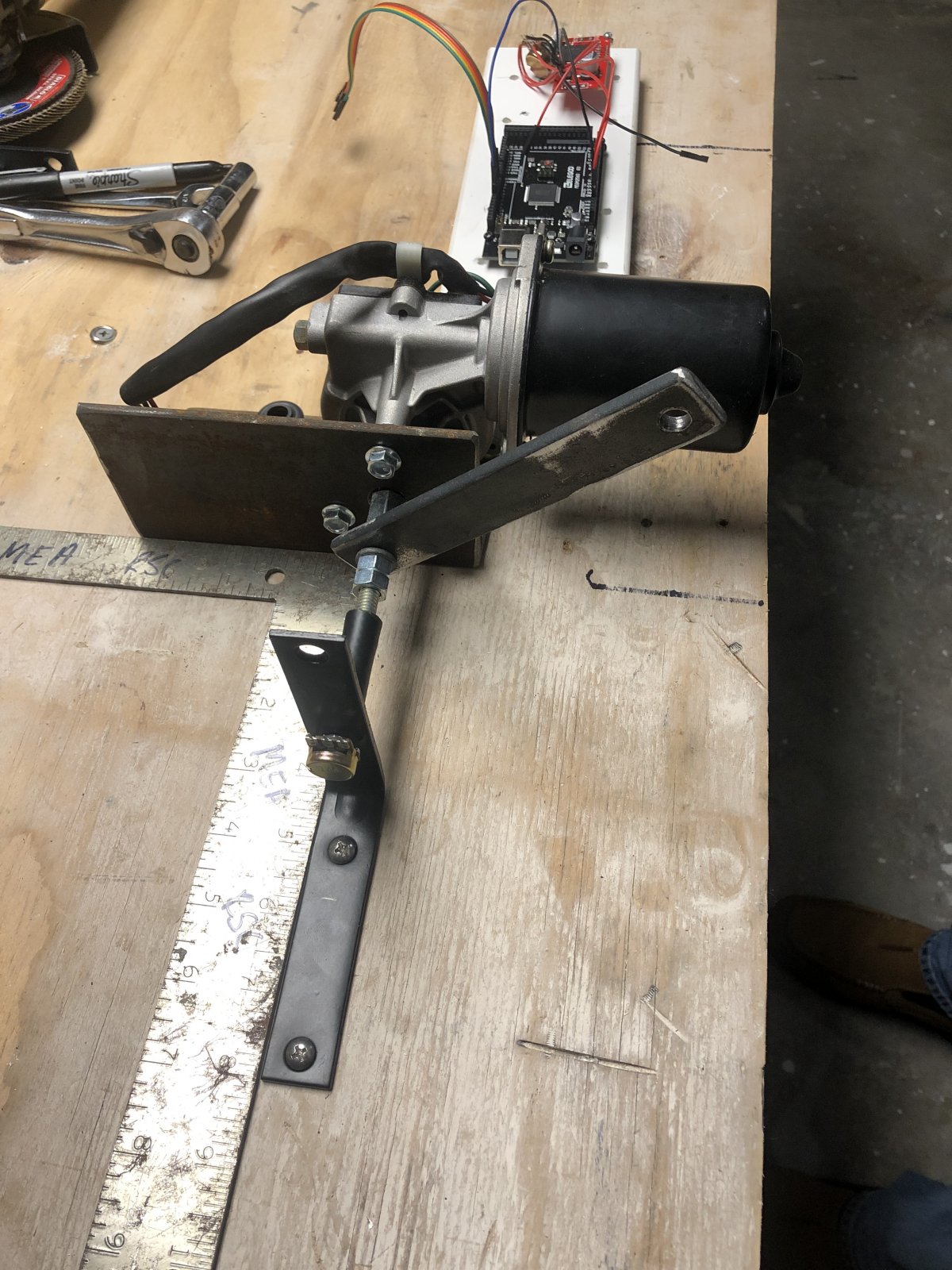

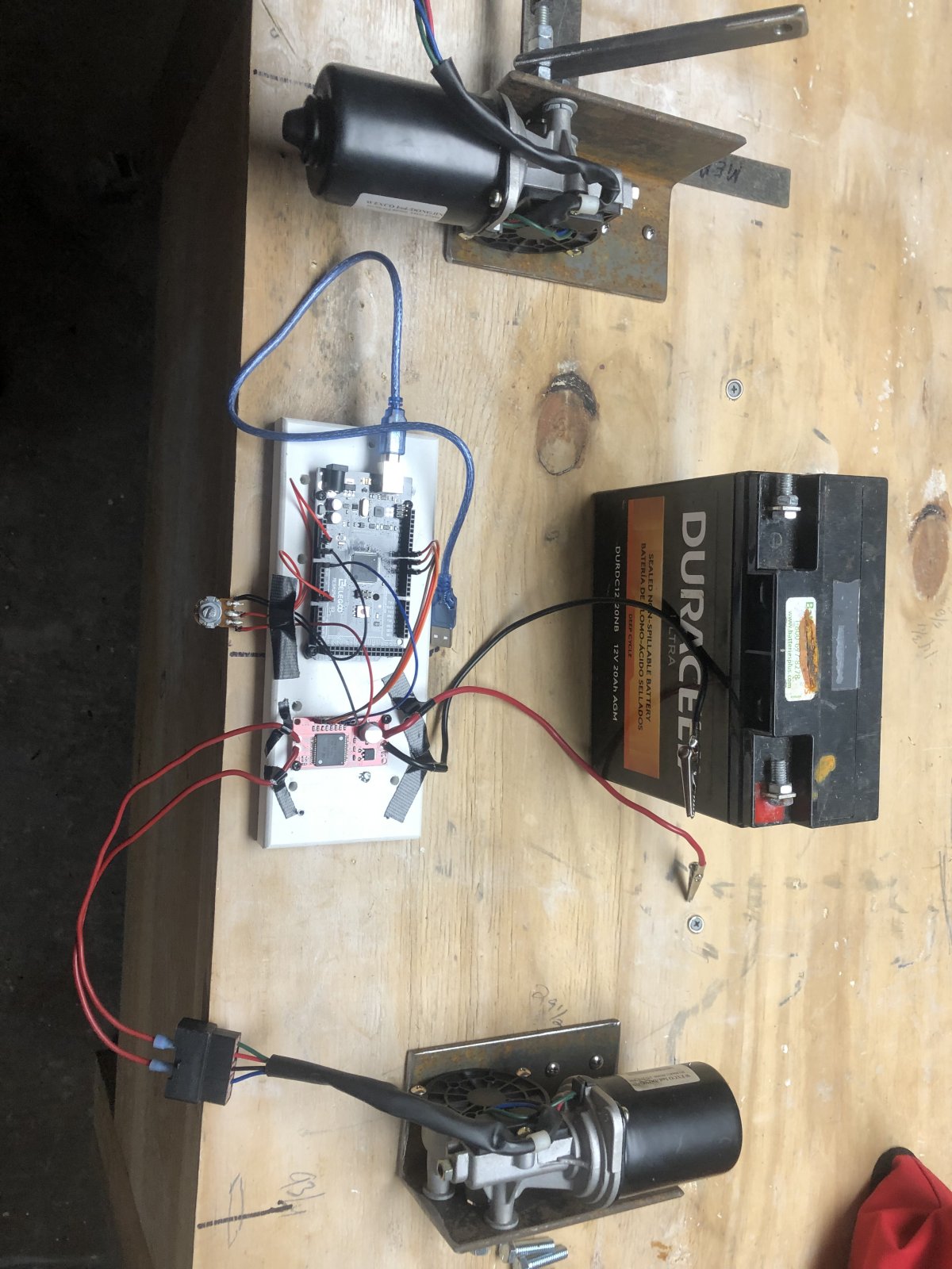

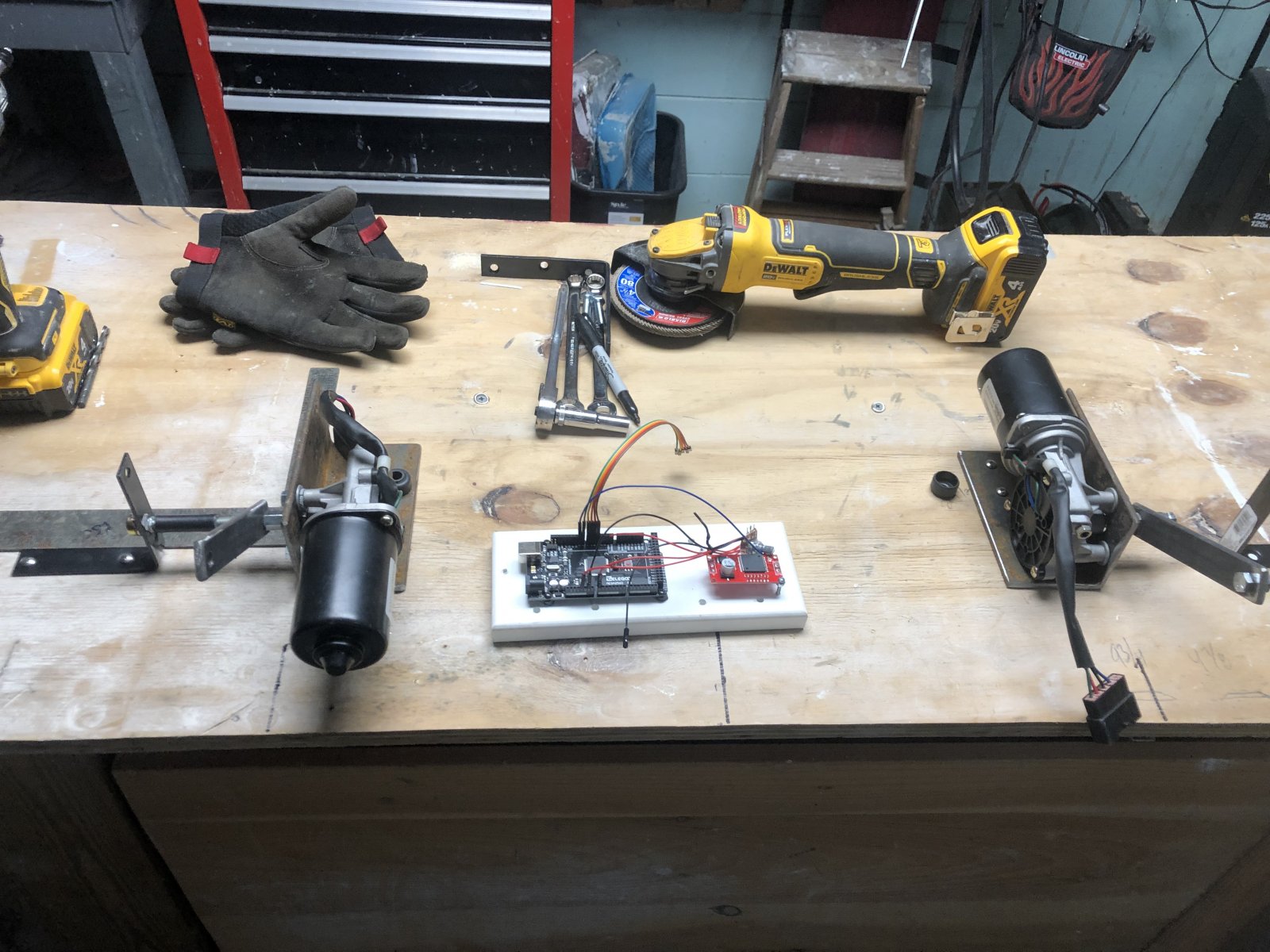

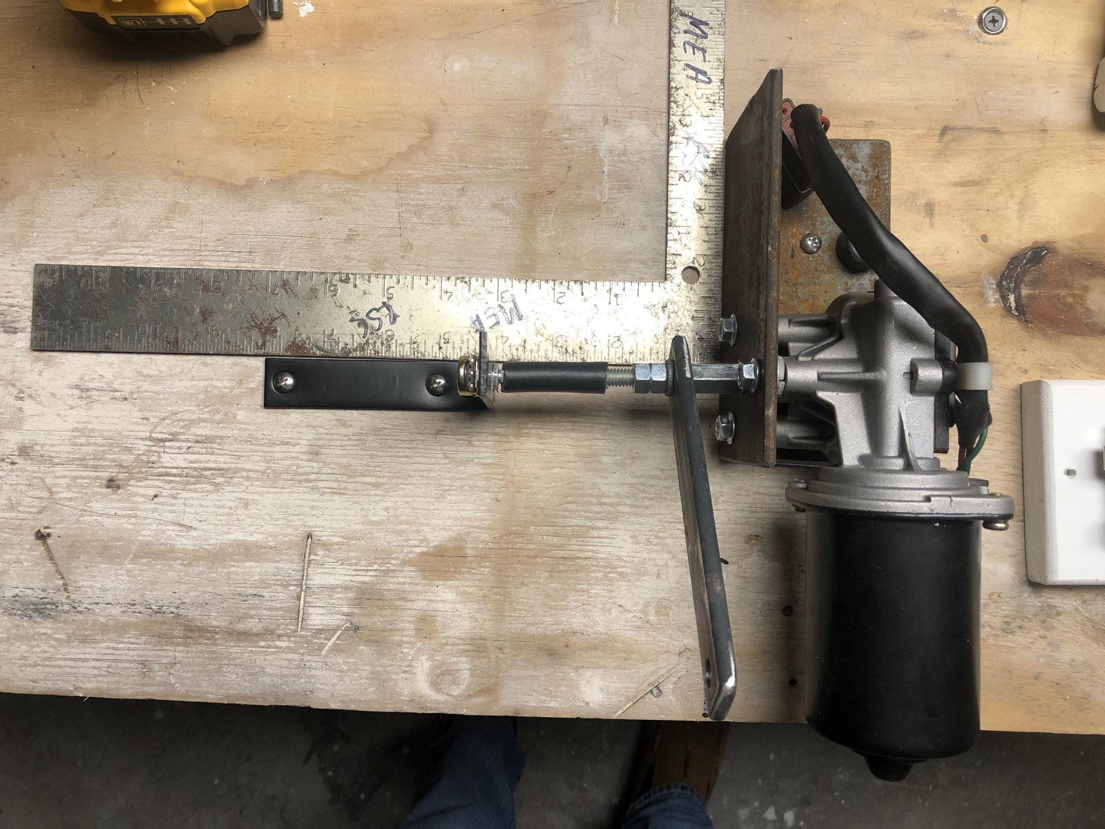

    Getting motors and hardware fabbed up for trial. 68BF03E8-78A7-4536-BA56-EB2EB355928D.jpeg CFD23A26-B1E8-47A9-8E1C-FAD2C2845E54.jpeg
  7. Michael Adams
    Michael Adams New Member
    Jan 18, 2022
    9
    54Coins
    My two issues concerned with is
    1. fabricating a arm to a spline/male thread motor drive. In photo for mocking up have used coupler / arm made of steel stock / lock washer/double nut on a section of all thread in coupler. I don’t want to weld to drive shaft and loose easy adjustments capabilities. Any ideas from past experience anyone???
    2. Attaching my power wires and motor wires to moto drivers?
    Looking for a cost efficient component to easily screw and unscrew power supply to board safely?
    im sure they make something that can be soldered or bolted. I just do not have electrical experience in this field.
    thank you

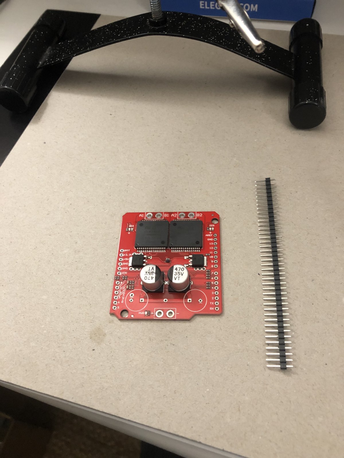

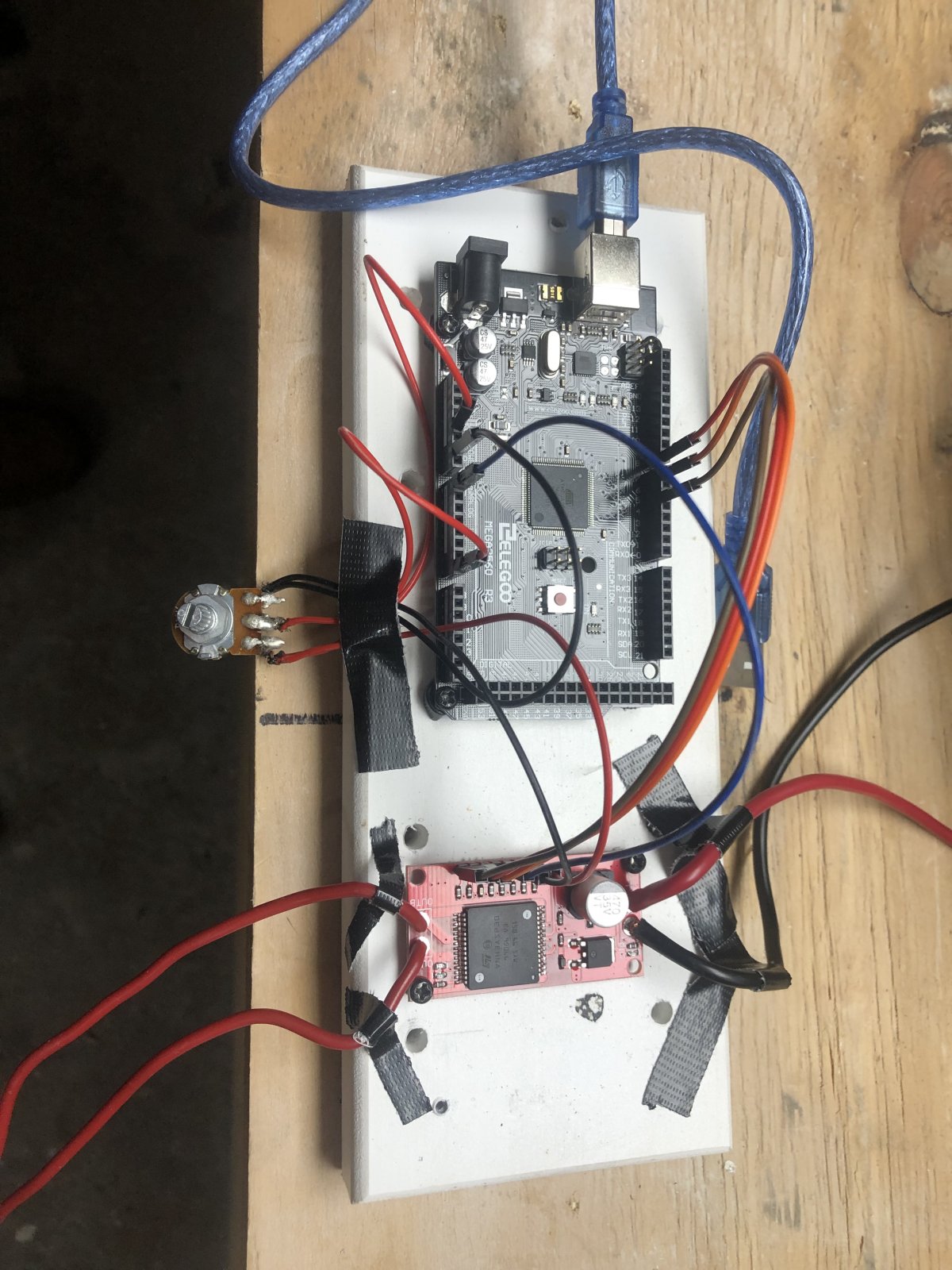

    I believe have everything installed correctly to test single motor. The moto driver tested good. I don’t see much info on the single vnh2sp30 moto. I purchased two of these for testing purposes because my dual board was bad when arrived.
    Does anyone happen to have a diagram for this single board driver?
    94ACEF16-DB82-4B21-BF9A-052040C7B494.jpeg A43CEAE7-1DC3-4735-8320-32C4FF26F02F.jpeg
    also just applied for a testing license for sim tools. Is this the proper way to test or is there another lite software version I’m suppose to use?
  13. noorbeast
    20,551
    145,124Coins
    +10,778 / 52 / -2
    The demo version of SimTools includes the fully functional Live For Speed plugin, specifically for testing purposes.

    Watch out for the wiper motor crank arm, I think it's too long for this type of motors.
