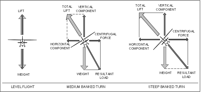

    Lets look at what actually happens to a driver/pilot when they are sitting in their seat and the car/plane is in motion or it is accelerating or decelerating
    When the Car/Plane makes a change in direction, accelerates, or decelerates the body of the driver wants to keep going/staying in the direction/position it was in due to the laws of physics. So the car say turns left and seat turns left and in turn forces the drivers body to turn left. Basically the driver body is thrown into the side of the seat/harness - if it was not there he would keep on going :). So for a simulation to be reallyrealistic especially for extended forces, it is really the Body of the driver who needs to be often in motion for any sway/surge/heave event not always the Sim rig. By moving the driver into or away from the seat, the forces are more natural as with the G-seat there is no washout required and the moving relationship between the driver/pilot and his controls is more natural. The possibility of simulating higher G-forces - (especially extended) than a normal sim is also possible.
    Forces in an Airplane
    So simply, that is the pretense of my new pressure/motion system Ie. The driver will be moved independently of the rig/seat for force events with high force :), which will be added into my 6DOF/Harness Tensioner rig - as there are some forces and orientations that these still do well. Now built and running see https://www.xsimulator.net/community/threads/seattimes-sims.11757/ Near bottom of page - 'New Rig'.
