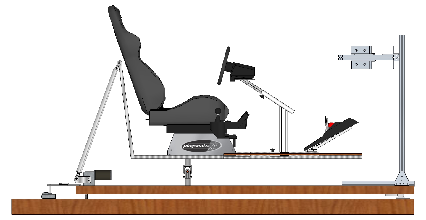

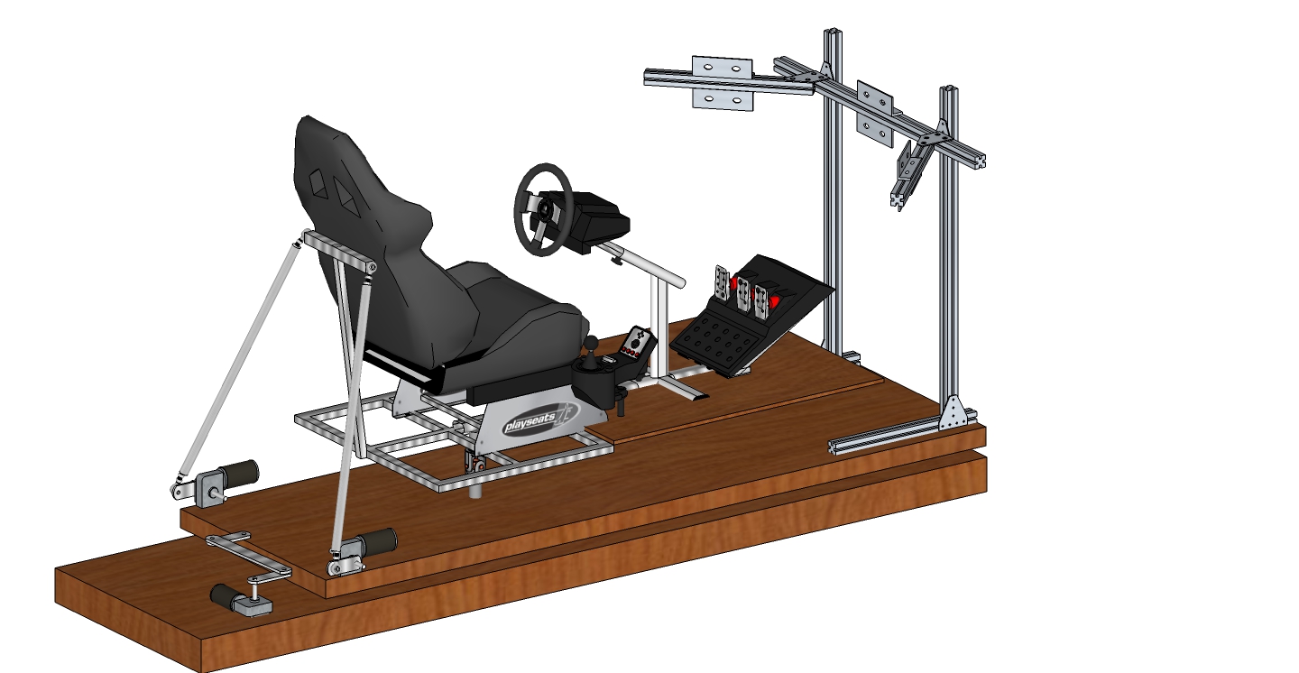

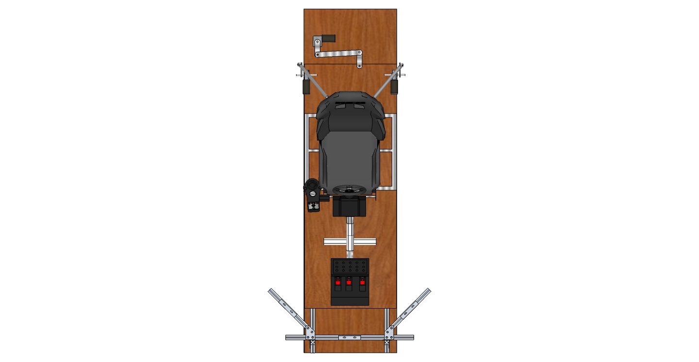

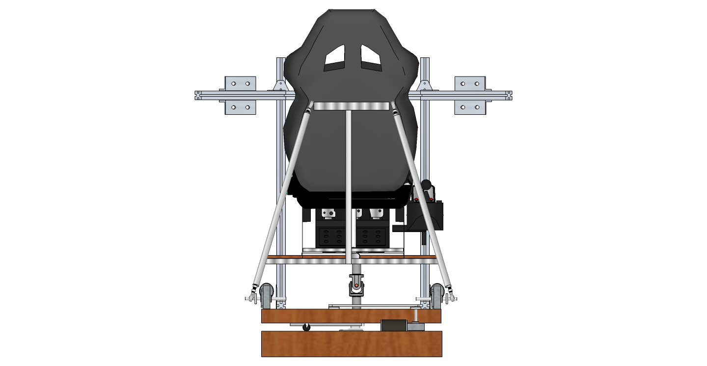

    As promised, here my Sketchup attempts. downloaded some of the parts as I only started using this program yesterday.

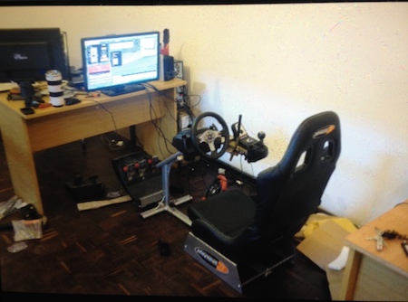

    This is what my current rig looks like.

    looks like a plan!

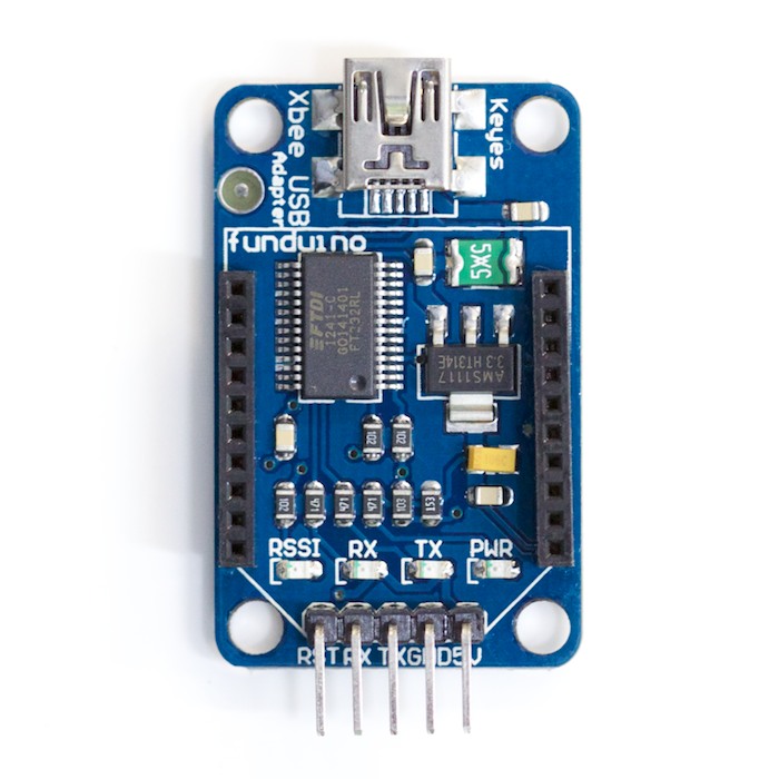

    So after that frustrating phone conversation with my courier, today I miraculously got a delivery notice, and two packages arrived. My Funduinos, TML 1638 and 1 MM, but they have not delivered my Arduino Nano. So all I can start on for now is my Shift Light and Geaar indicator Dash.
    I will be checking on you guys in a few minutes if I can retrace that tutorial with the wiring and code for this little funduino (I actually ordered the Arduino Nano but the guy delivered funduino). I am about to give that guy a bad review if he doesn't explain himself properly.

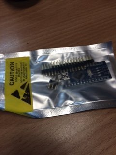

    Thanks @noorbeast but bad luck just struck. I opened the packages and realised I have been sent the wrong item. The ebay seller sent me "Funduino Xbee Usb Adaptor" instead of Arduino Nano.
    The annoying thing is that even if the seller says I return the Items, it will cost me double the purchase price since I had it forwarded to me from the UK and sending it back will cost me more. So the only solution is to get him to send me the correct items or I give him a bad review then buy the correct ones from somewhere else since my situation means any action will cost me for the forwarding service.
    So more waiting continues on my quest to improve my sim experience. The mission gets even harder.
    I hope i receive the Arduino Uno from the other seller and i hope it will be correct then I can try with wiper motors which I intend to buy next week when I am back from my photography assignments.
