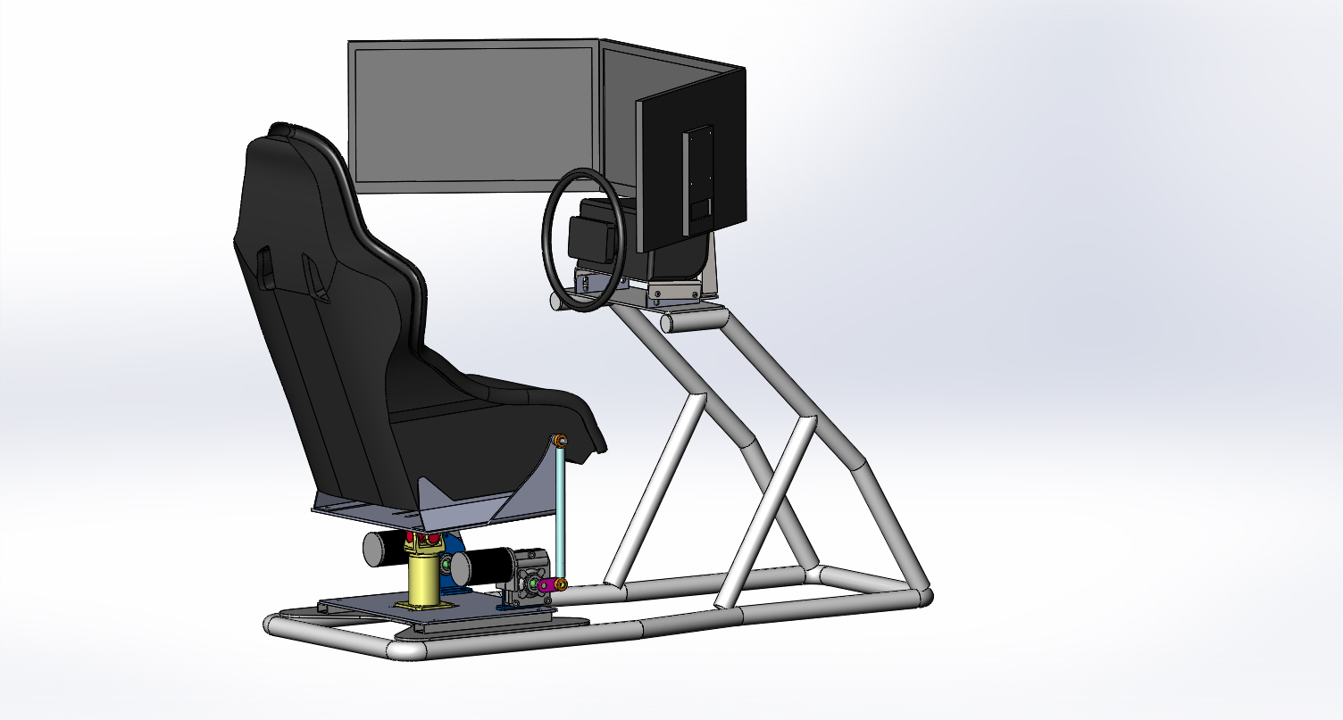

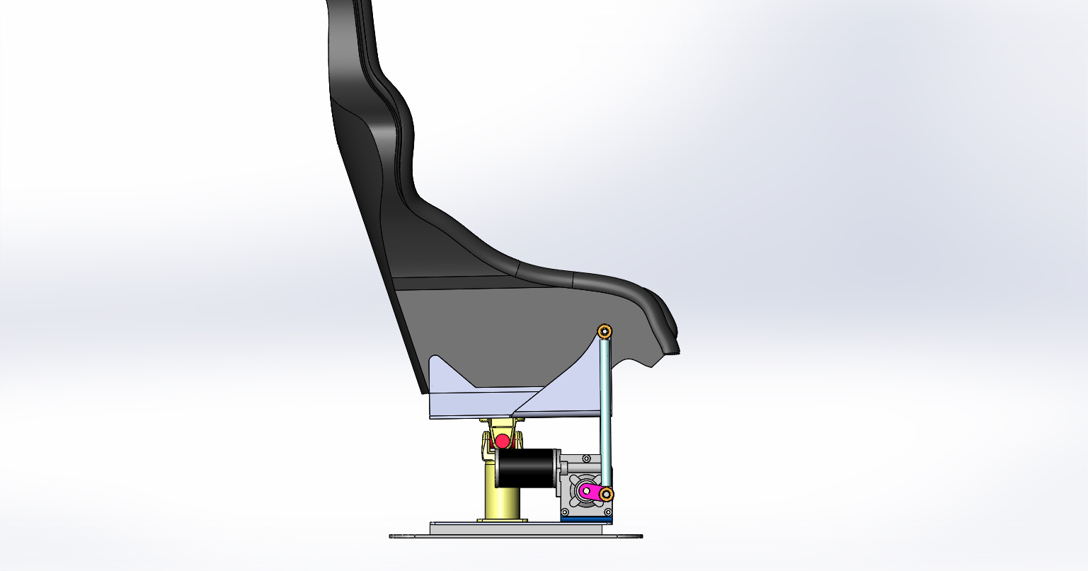

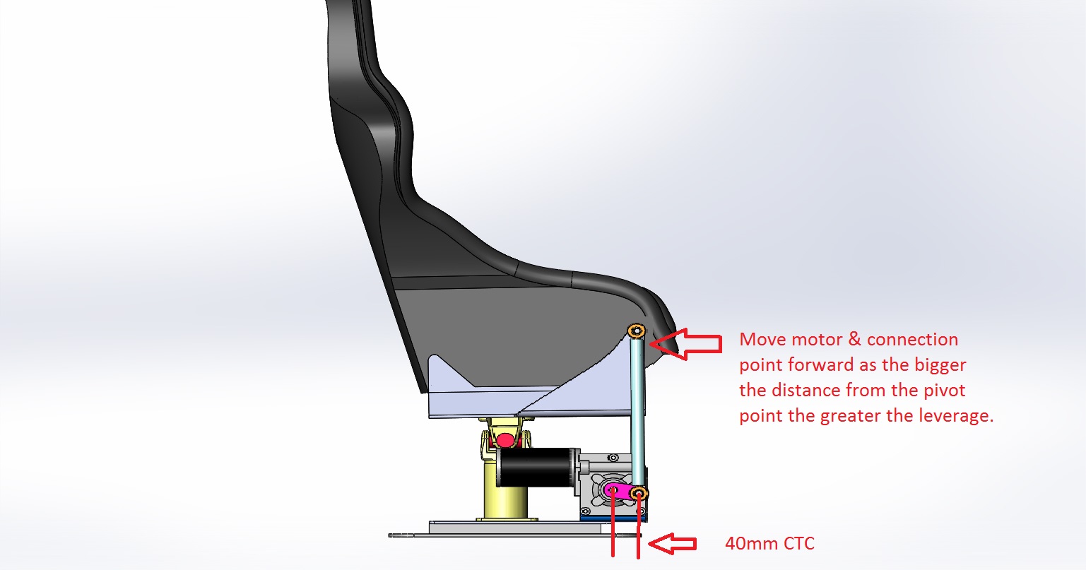

    Some suggestions for your consideration @jimmytm3

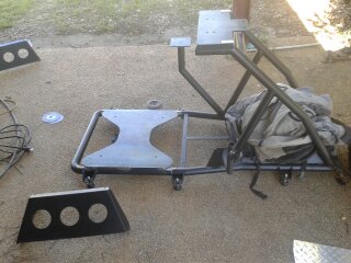

    Welding the base to the frame makes much more sense now with the complete picture :thumbs

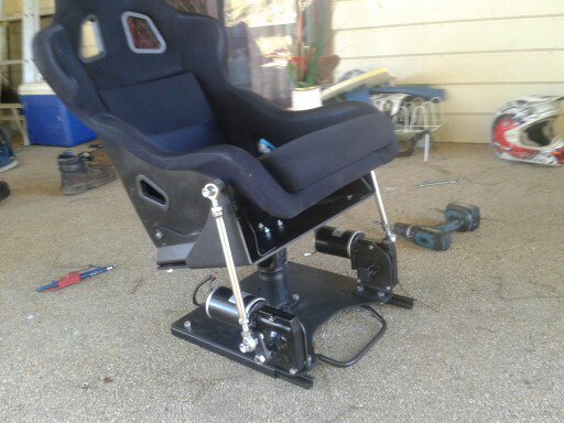

    yea the chair is a bit out of scale have the motors as far forward as they can go and the linkage is 40mm centure to centure
  7. bsft
    Move motors a bit further forward if you can to give them 5-10 angle if possible
    and out to the side a bit if you can as well

    o.k thanks

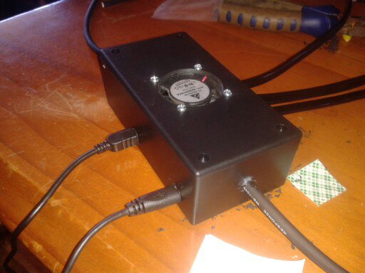

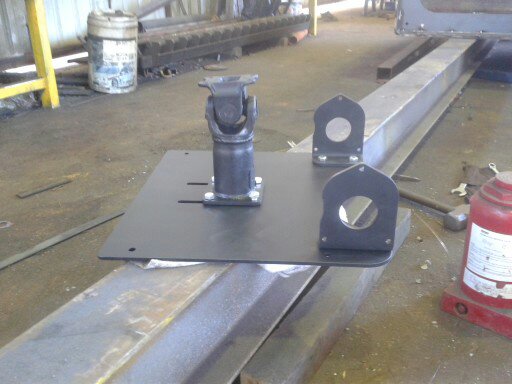

    1429919958328.jpg 1429919981686.jpg On the job :)
    21,592
    151,215Coins

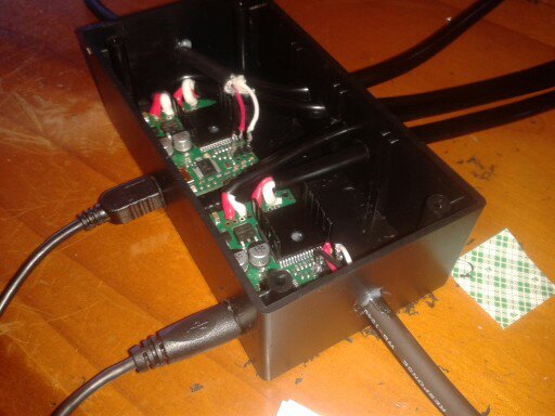

    Very neat and tidy. Have you considered having some sort of exhaust hole so there is air circulation?

    i think thats the go just a small 10mm hole or something

    can you use those usb double adaptersso there isnt as many cords for the jrks

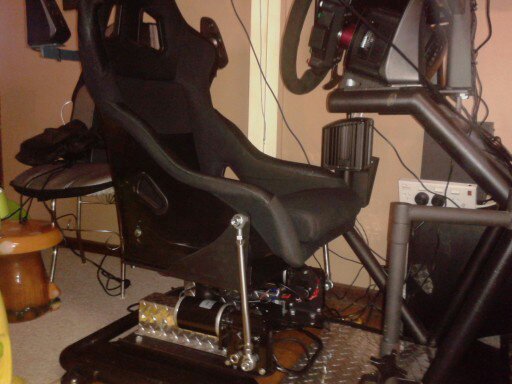

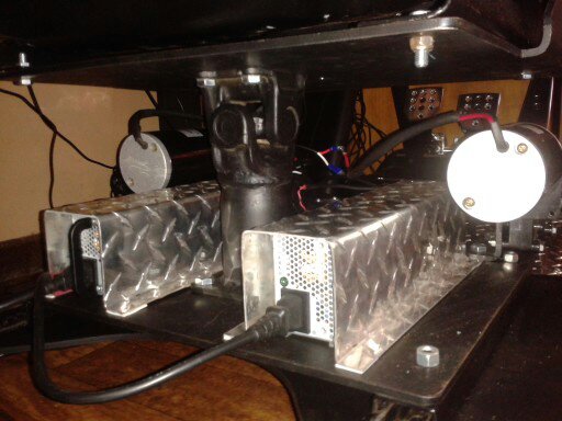

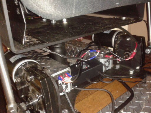

    1430096867853.jpg 1430108029331.jpg 1430108033592.jpg 1430514602899.jpg 1430514719702.jpg 1430096867853.jpg 1430514850601.jpg 1430514678131.jpg All running . Pretty cool thing few teething problems , cable management and babys but other than that works great running iracing having problems finding were to patch real rally 2015 if any one has info that would be great thanks bsft and noorbeast for all your help
    21,592
    151,215Coins
    Brilliant job @jimmytm3, I really like the checker plate PSU covers :thumbs
    We will all be looking forward to a video of your rig in action when you get time to do one.
    I think this is a really good extension/adaptation of @bsft's Desk Racer layout idea for use with an existing static rig.
