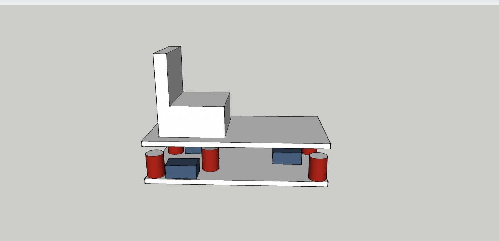

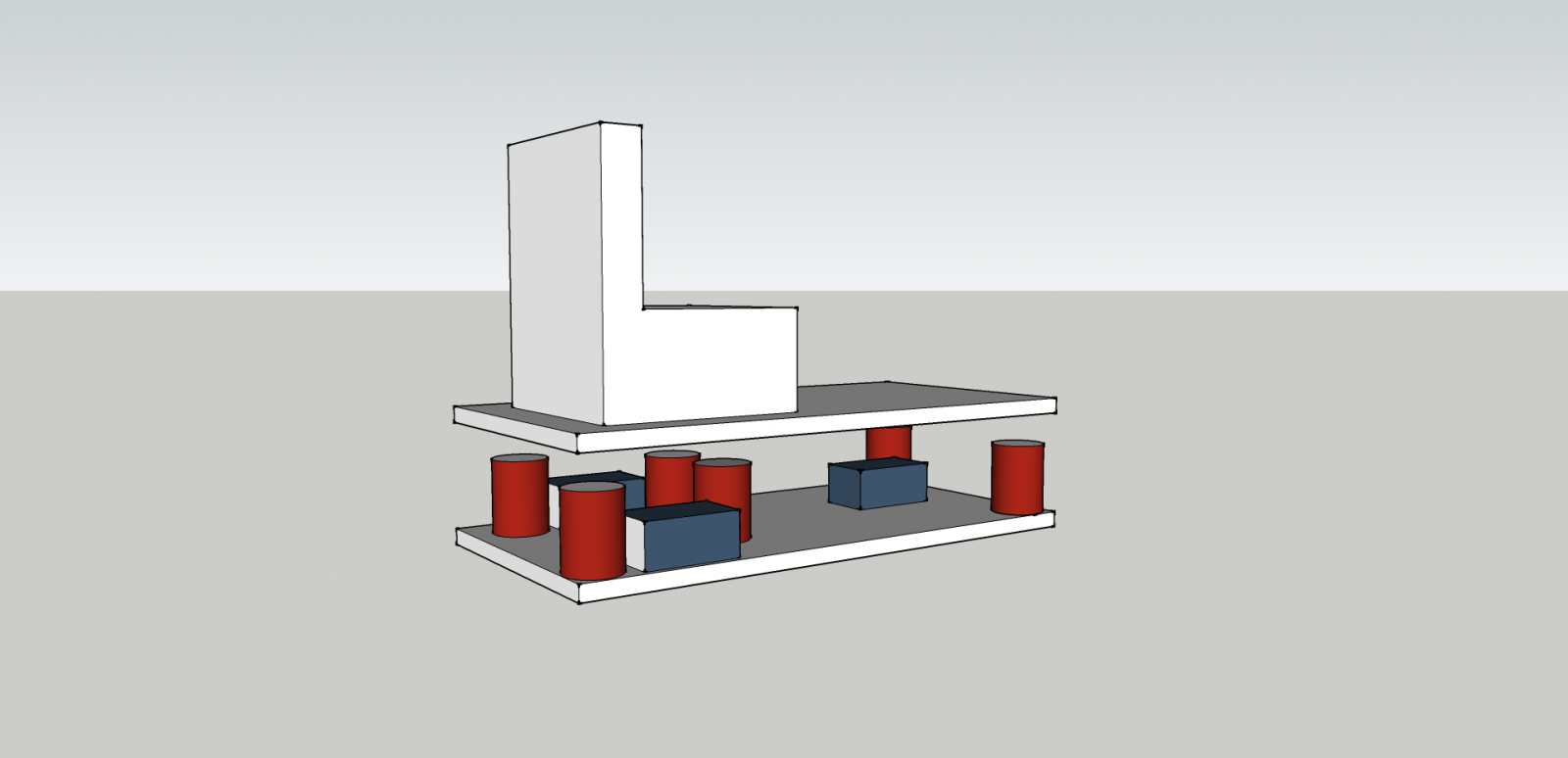

    For some reason I cant edit the OP. Anyway I draw a (really) raw sketch.
    The red pylons represent springs and blue boxes motors.

    I would suggest @willaupuis is the best person to advise about suitable springs for his own heave implementation. However if you plan to replicate @Jymä's design then being a full frame the weight and distribution would be somewhat different from @willaupuis seat shaker design.
    I know from setting up my own adjustable spring assisted heave that you really need to get the spring rate correct for the intended load, too much and you strain the motors, too little and there is not enough assist on the heave lift.

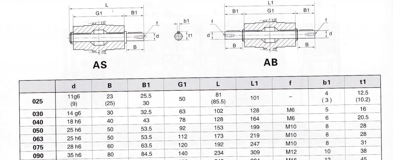

    For the lever connections:
    I read the FAQ's http://www.xsimulator.net/community/faq/how-to-attach-levers-to-wormdrive-gearboxes.182/ but I can't find reasonably priced rigid couplings for 18mm output shaft (040 in the factory datasheet (attached): key is 2,5mm high and 6mm wide).
    I did find taperlocks ( http://www.ebay.com/itm/1108-18mm-T...949533?hash=item20f2b5ba9d:g:xhgAAOSw~gRVywZX ) that do seem quite the same except that you cant use the curb screws to tighten the shaft.
    Should I try the taperlocks or just go with kind of a hollow shaft connection like the one in FAQ?
    The thread inside the end my output shafts is supposed to be M6.
    I didn't really get what @Nick Moxley meant with the codder pin, but that is probably with a truly hollow shaft.
    I got information from the factory that they forgot to produce my output shafts so the shipping of the motors is 5 days delayed. They have the motors and gearboxes ready though....

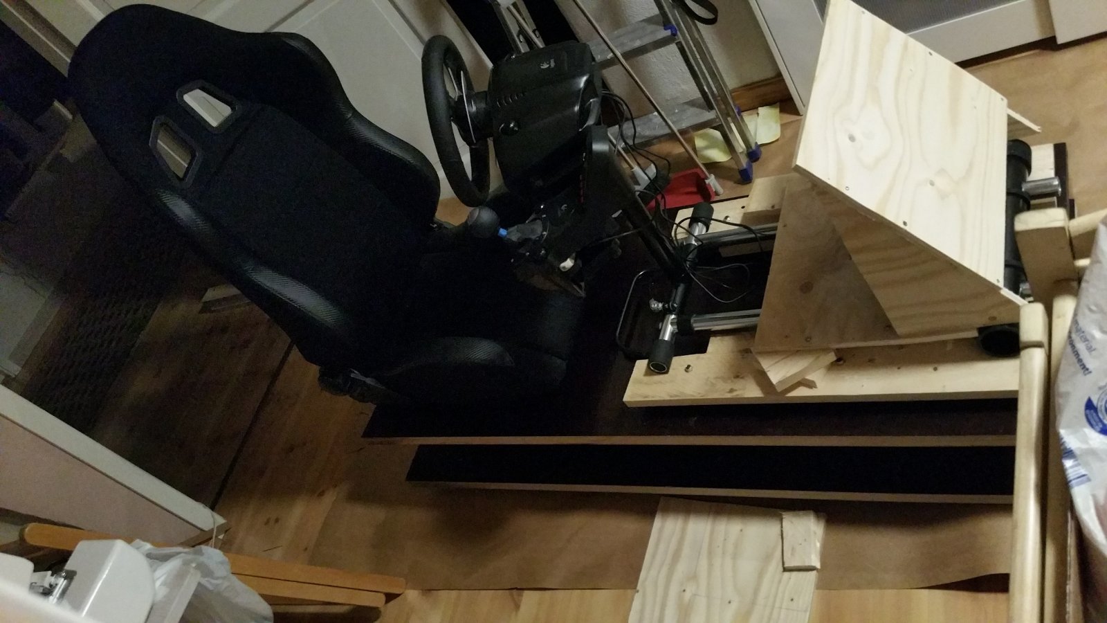

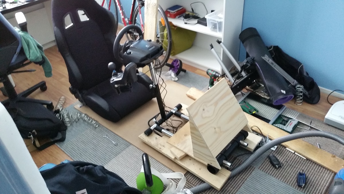

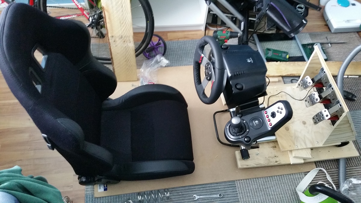

    Couple of early photos of the pedal/wheel-system.
    As said, not a fancy system, but seems to work. Would be lighter if I would loose the wheelstand pro, but it gives quite sturdy base and nice adjustability for the wheel.
    Under the plywood/wood-rack there are rails (you can see the rail handle between seat and wheel. Also G27 pedals are inverted. Seems solid, I can give it quite rough pedal pressing and it won't shake nor wobble almost at all.
    Of course I will cover it with something (textile, rubber mat, etc.) and before that probably dismantle couple of times and cut / work on some parts :p
    The base is not going to be that what is under the seat or pedal/wheel-system. That is just some MDF that I might need at some point.

    Do you guys have any suggestions about motor placement?
    If the platform would be symmetrical this would be easy, just put the motors symmetrically.
    But as it is a rectangle I don't really have any good idea how far away from the COG (sideways and front/back) I should put the motors and whether should I put 2 motors in the front or in the back of the COG.
    The platform will be heavier on the rear side but the longer front side will produce greater lever when the system is tilting.
    Or is the motor placement some what fine in the early draft in the 3th post?

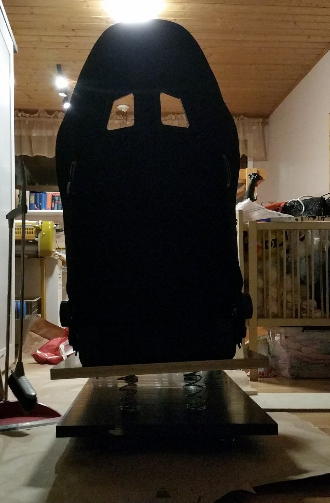

    Getting the levers in a couple of days and already got the MMs.
    I don't have much sparetime at the moment, so progress is really slow.
    The wheels (6 pcs) attached make moving the sim really easy even though the total weight is going to be massive (80-90kg).
    The spring attachment is still off in the photos (I have fixed that), but you get the idea. I also need to make some columns for the springs so that there is enough room for the motors etc. between the plywoods.
    For some reason I can't find rose / heim joints in Finland (probably I just can't find the right word for those in finnish).
    I would need them just to make the anti-twist system. If I cant find them I'll use fork joints and M10 threaded rods for stiffening the body.
    Bellow you can find some photos:
