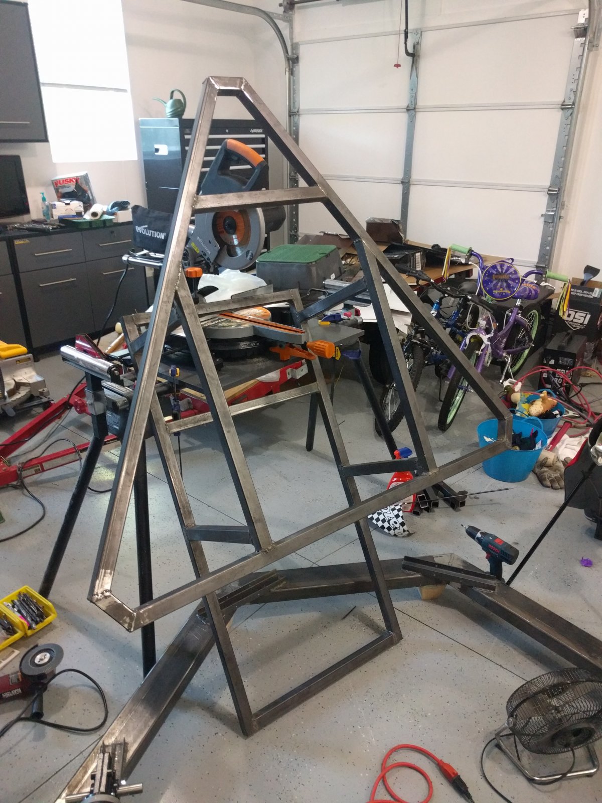

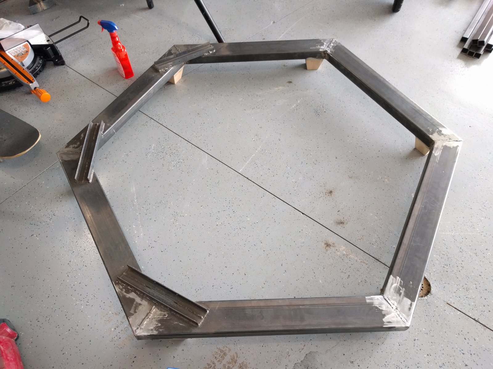

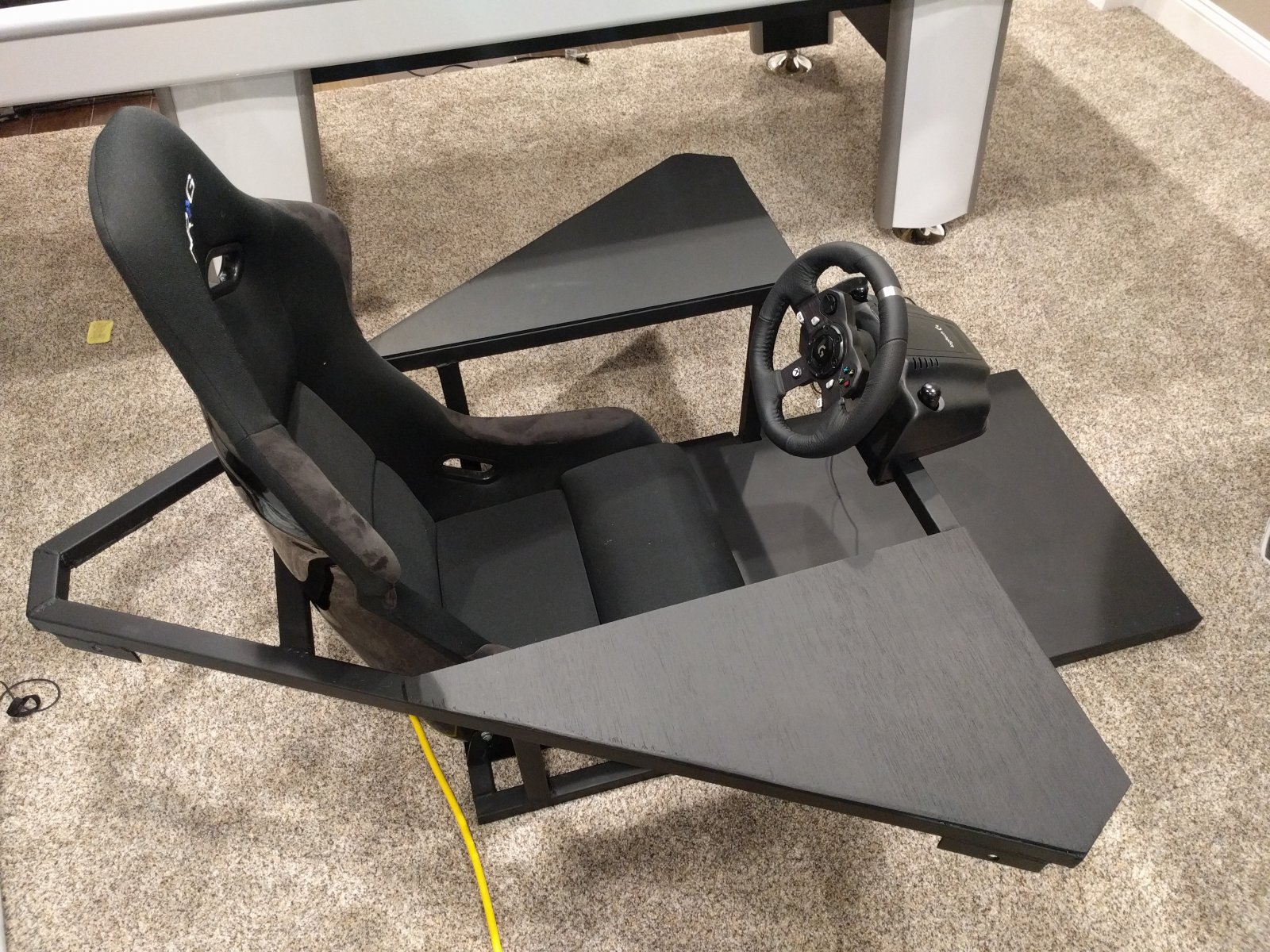

    I decided to weld the unit together first and test fit to see how it felt.
    Base: (2" x 4" x 1/4" rectangle steel with wood furniture legs I had laying around for height)
    Top: 1 1/4" square tube (Sorry for the mess)
    Dry Fit:
    IMG_20160808_225421.jpg IMG_20160808_225436.jpg IMG_20160808_225447.jpg IMG_20160809_074404.jpg IMG_20160809_074418.jpg
    I'm currently working on wiring up the electronics and will post more progress soon. I will gladly post some specific dimensions if needed.
    More to come soon.

    Very neat work indeed :thumbs

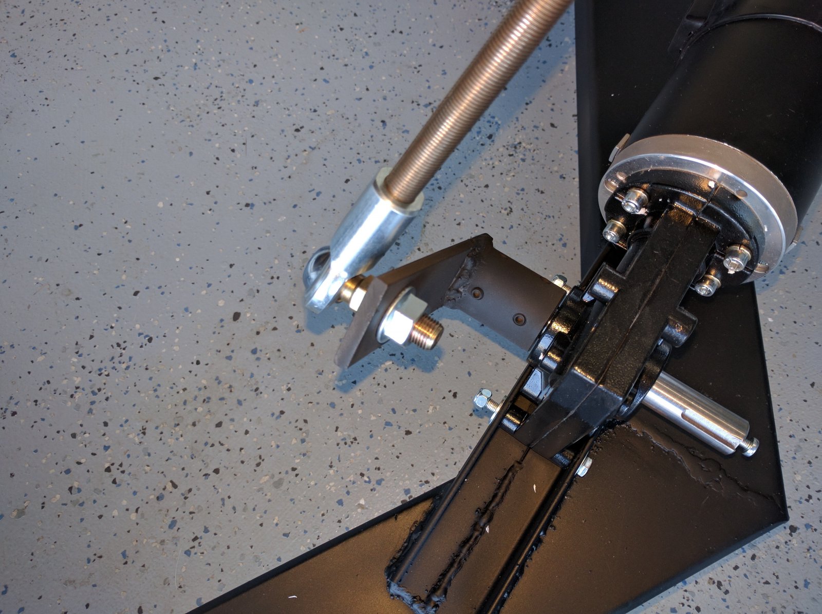

    Just a quick question, why are the levers mounted to the inside as it looks like there is a fair angle on the rod ends?
  3. CLEOPHUS
    CLEOPHUS Member
    Apr 12, 2016
    47
    229Coins
    +69 / 0 / -0
    I'm not committed to them being mounted inside, but I will say that the angle does seem more dramatic in the photos. Also, the motors have not been calibrated so some of the levers are in a position they will never experience while working.

    Nicely built:thumbs. From the photos I have some concerns, but maybe see how it pans out.
  5. SilentChill
    2,619
    20,402Coins
    +3,480 / 34 / -0
    Glad I inspired someone else :D
    Just a couple of observations, however I maybe wrong :p

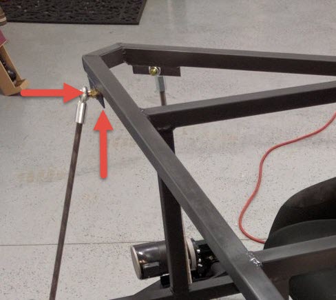

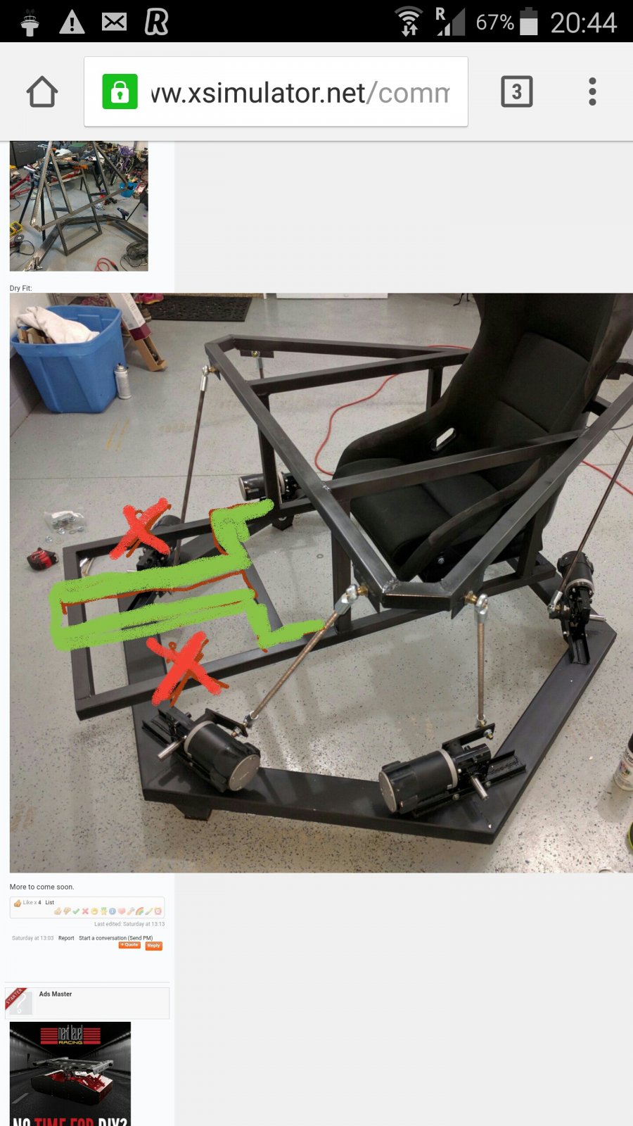

    I think you may have problems with the front 2 levers hitting the foot pedal frame. Probably need to move the frame a good 100mm inwards either side. Tried to show what I mean in pic below
    Also you may need to get the arms a bit further out from the levers else they might bind in the lower position of the axis and end up bending the arms.
    I learnt the hard way just trying to help :D
    look forward to seeing the build progress
    • Useful Useful x 3

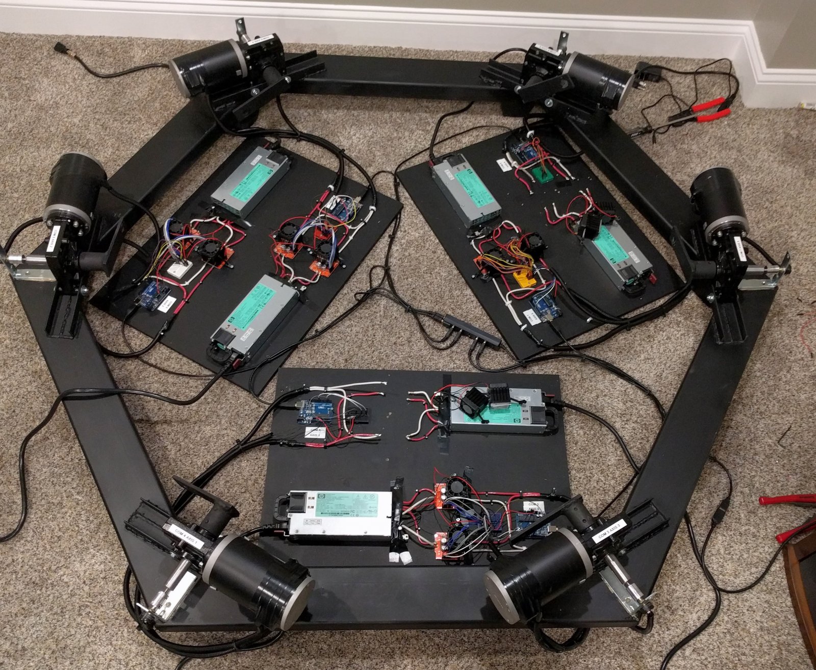

  6. CLEOPHUS
    CLEOPHUS Member
    Apr 12, 2016
    47
    229Coins
    +69 / 0 / -0
    Craig - I fear you're right, but still holding out hope. I'm just finishing what seems like miles and miles of wiring. It takes a tidy build to a complete mess quickly. I'm learning from my mistakes. Last night I couldn't figure out why 3 of my motors wouldn't operate properly with SMC Utils. I realized that all 3 were mounted in the same way/direction. Reversed polarity on them and they are operational now.
    Also, I have mounted the northbridge coolers on the Moto's and only 1 of 12 caught fire! Progress! haha

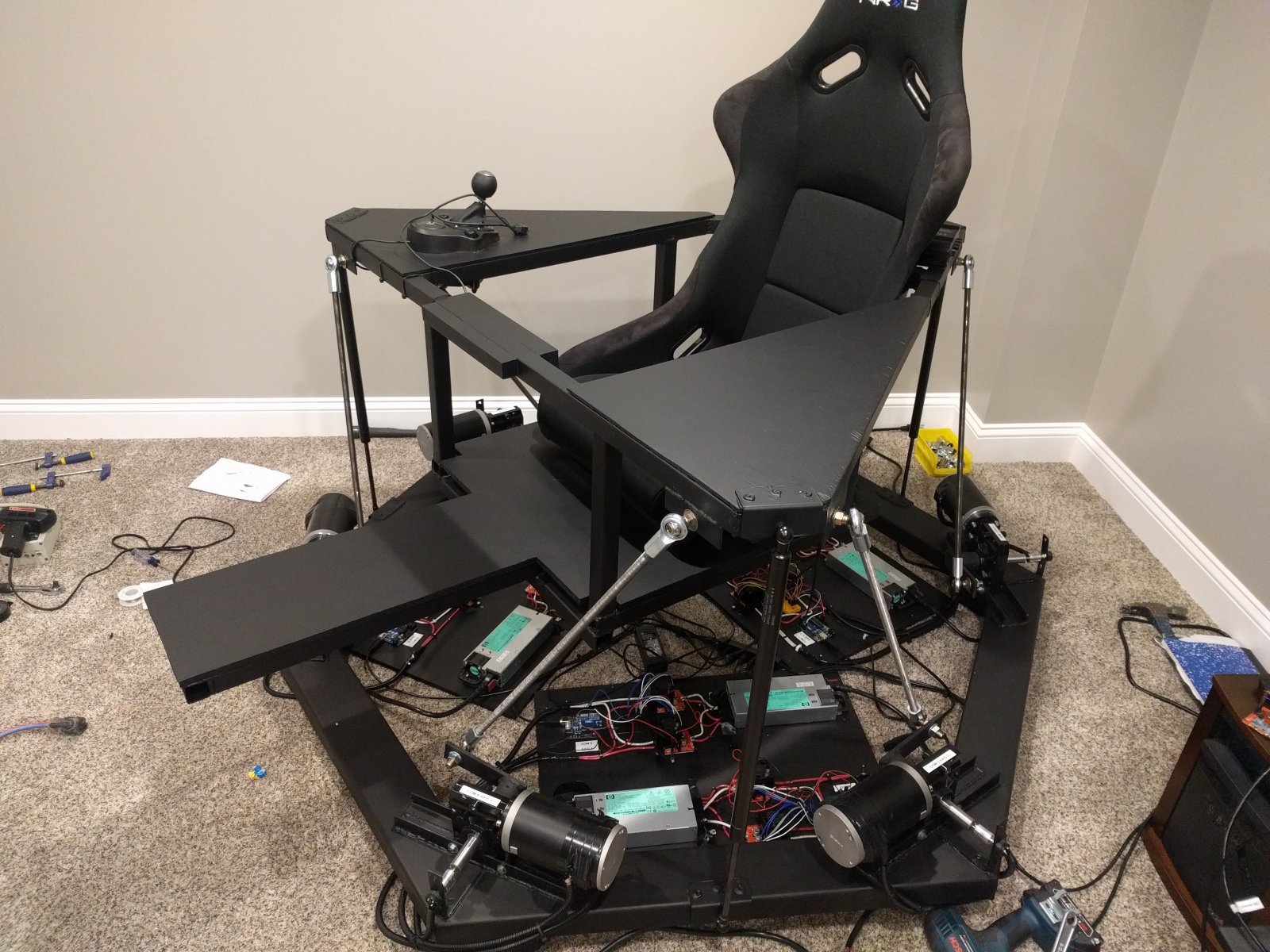

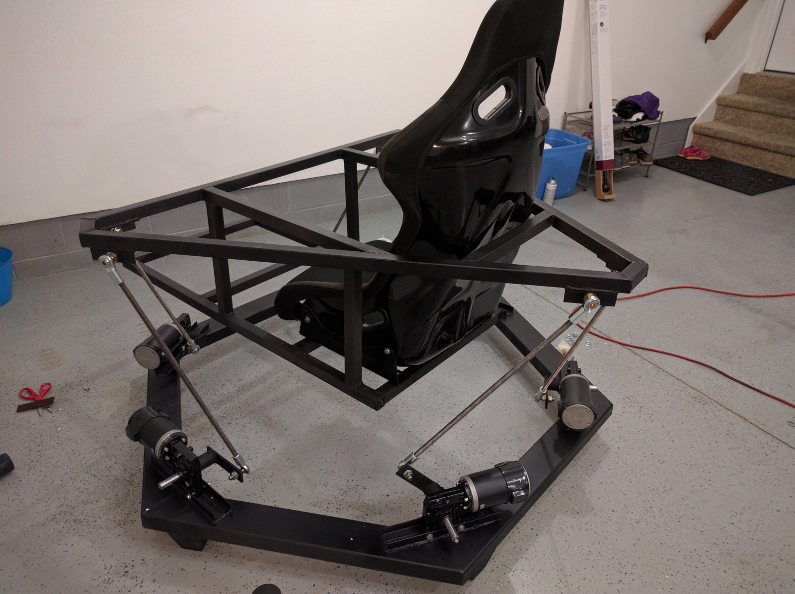

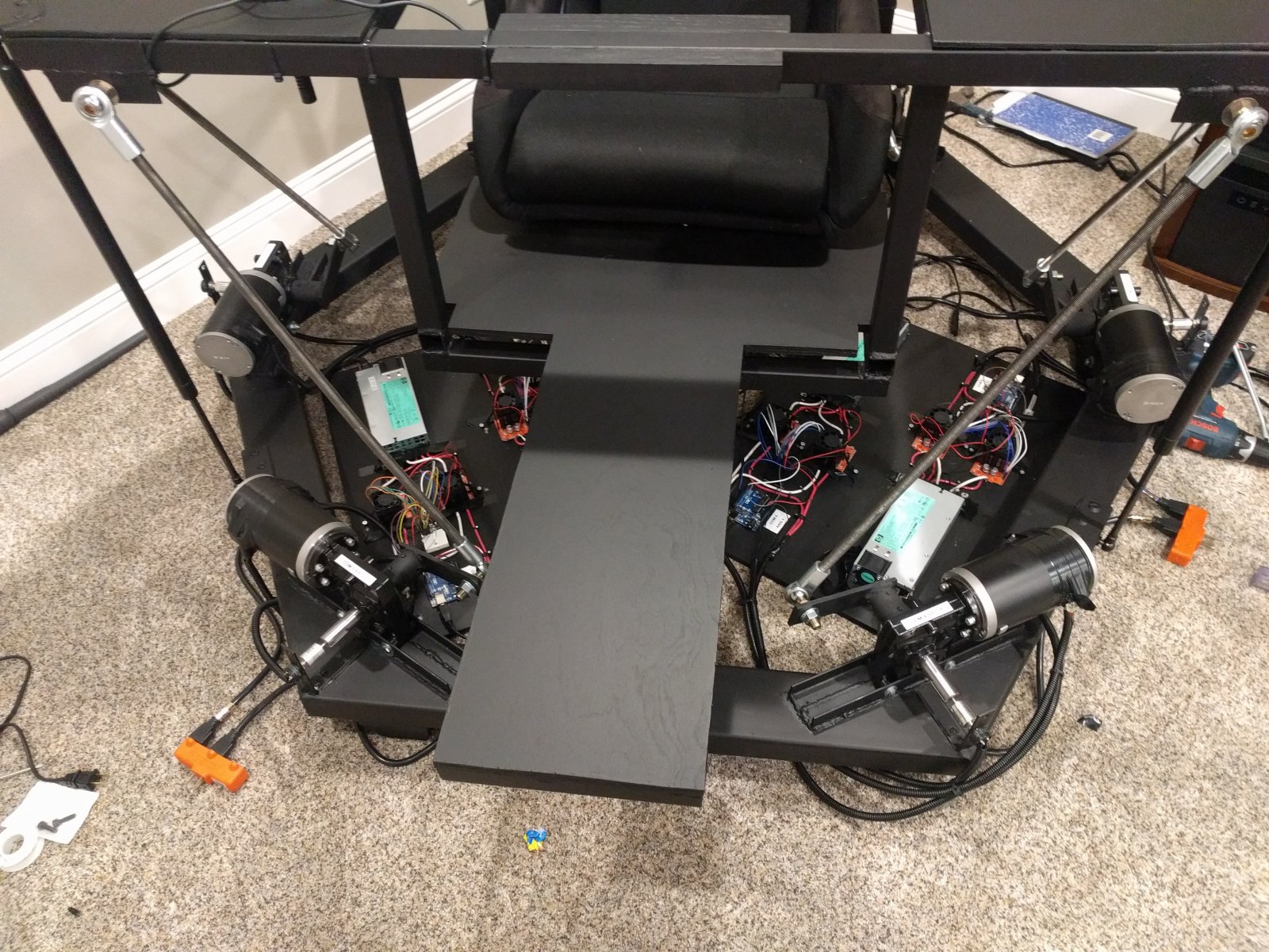

    During testing - I caught 4 more Monster Motos on fire due to PWM set too high. Unfortunately, I wont make much more progress until I have replacements.
    Bolted in the seat and added some wood.
    • Like Like x 6

  9. Pit
    3,013
    30,418Coins
    +3,088 / 31 / -0
    one more thing: with the seat in the middle you will cover the electronics, so if something is going wrong with your MMs etc., then do you have to disassemble the seat?

    i'm concerned about rigidity of these brackets:
    .jpg

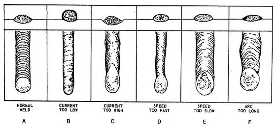

    It's great to have an "Evolution saw", the cuts are near to perfect :)
    It helps very much to weld more easily !
    Your first welding are bulky... probably too cold (not enough current) or too fast
    http://www.wcwelding.com/arc-welding-tips.html
    try to cut some welding you made and have a look on penetration :) that's a good exercice

    I can pretty much guarantee 99% nothing to do with PWM settings it's poor MM clones.

    As I said - It was my first time welding, but they did improve as I went. I did cut a bunch of my practice welds to see penetration and they seemed plenty deep. I considered eliminating the brackets all together and just running the rod ens through the frame, but I couldn't easily find rod ends that were long enough.
    If I could recommend anything to someone looking to build with steel - the 10" Evolution saw is amazing. I cut 1/4" steel 2x4's for the base just as fast as I would cut a wood 2x4 with my dewalt saw. Out performs my dewalt saw I spent 3x more $ on.
    Cliff

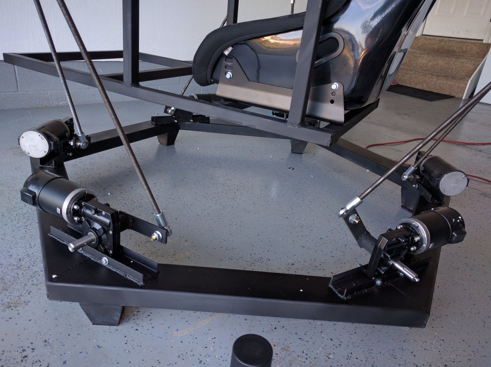

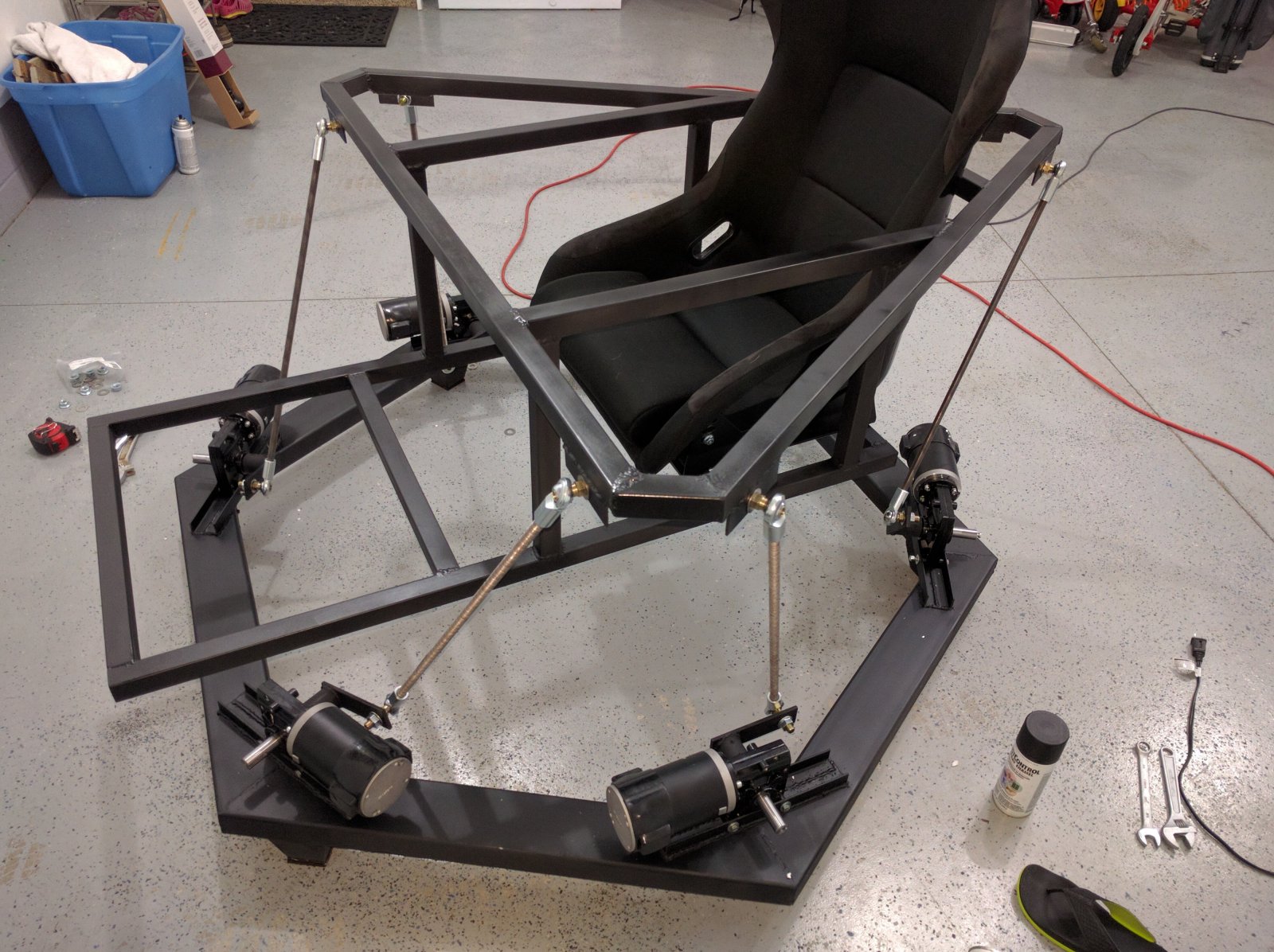

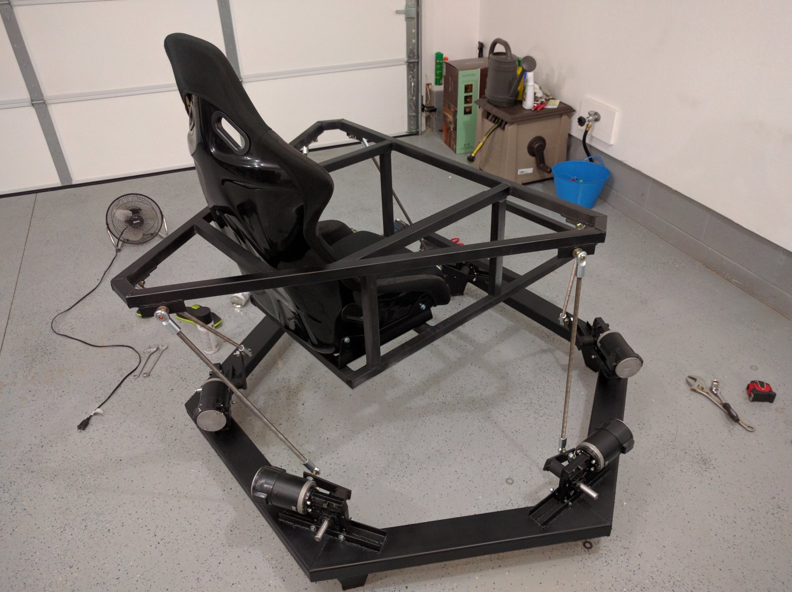

    So - some news. You were exactly right Craig. Check it out:
    After bending several threaded rods, I came to the realization that you were right and made the modifications. Much better now (still need to replace a rod or two)
    Reversed the levers for stability, added struts, etc. Should do full testing this weekend.
    Cliff
    • Like Like x 8

    looks good cant wait to see a video. your almost there. if your rods keep bending you can slip some tubing over them.

    They were bending because they were hitting the metal before I modified it. Anytime there was yaw or sway involved - bad noises resulted.
