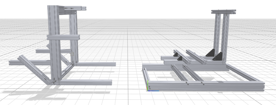

    I then used SimCalc to play around with different dimensions to see how it changed the forces etc. It took me a while but I ended with dimensions I thought were going to work well. I then found an aluminium profile company that had reasonable prices and also had an online CAD tool so I was able to draw everything up and then order it.
    The idea is that the front half with the pedals and wheel attached sits on top of the base and will slide back and forth to allow for different users height and also slide back to make it compact for storage. The pedals would also fold up to make it compact during storage and would also allow for different angles and heights.
    Once I had this all down the CAD spat out a BOM which made it really easy to order. So I ordered the framing and then was able to get onto something else.

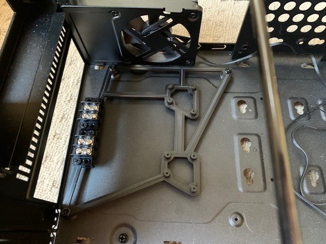

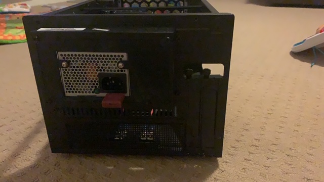

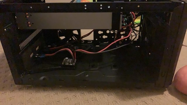

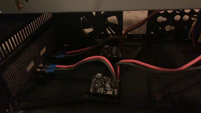

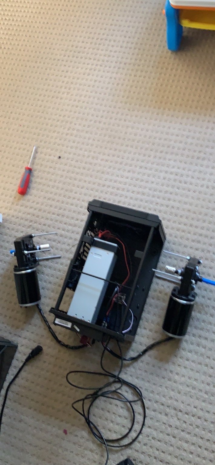

    Control box:
    I needed something to house the control equipment and decided to put the equipment into a mini ITX box (stole that idea from my friend). I used this one: https://www.coolermaster.com/catalog/cases/mini-itx/elite130/
    It was long enough to fit the power supply in which was my main concern. I had to modify the internals slightly by removing the 3.5” drive bay and the USB cables which were bulky to give plenty of room inside. I then 3D printed a plate to screw the server power supply where the ATX power supply would have normally gone and a hanger to support the rear end of the power supply from a mount that used to support the 3.5” drive bay. In order to mount the JRK controllers, I printed some mounting brackets on a frame that would attach to the motherboard mounting points in the ITX case and also space for terminal blocks in for the motor power. I also printed a blank grill to cover the motherboard I/O cover on the case and cut some holes where the terminal blocks are to allow for the motor cables to enter into the case.
    After soldering everything up (took a while using my cheap soldering iron) I was able to mount it all in place. I reconnect the cases fans and bought a switch to turn the power supply on and off (the power button on the case was the typical momentary switch which wouldn’t work with the power supply).
    A few things took me a while to get right, and even then, its not perfect. When I connected the USB to the JRK it clashed with the internal fan, so I had to move it as well.
    This is about half of the progress to date. I’ve received the framing (and modified it again), mocked up the motors with the control boards and pots and also started to have some brackets fabricated to mount the motors, along with brackets to have the universal joint welded to. I’ll share in another post soon.

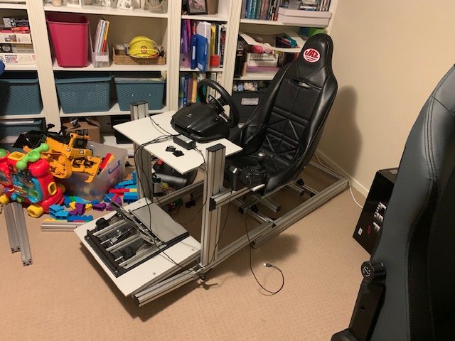

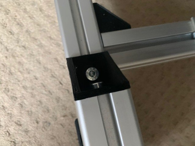

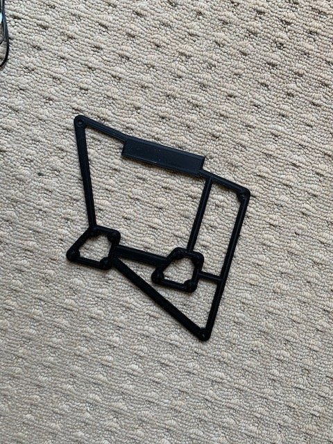

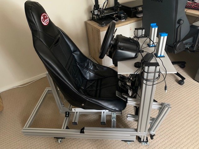

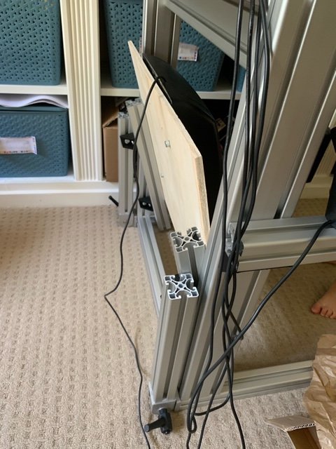

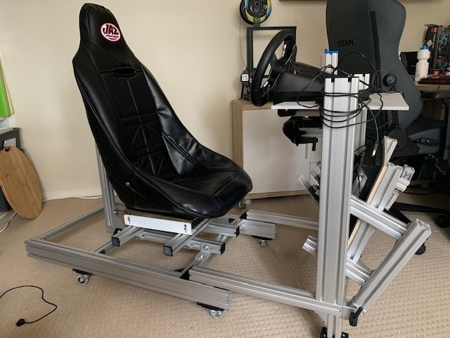

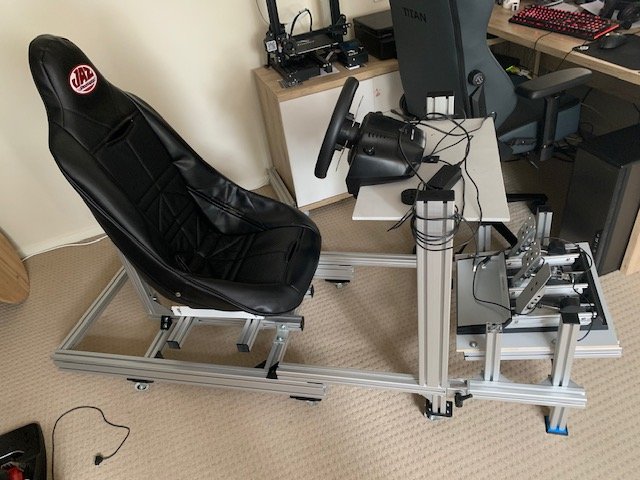

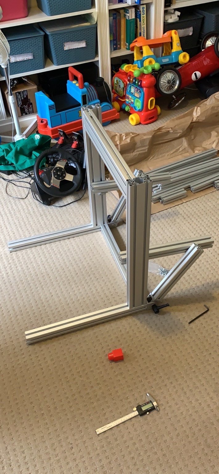

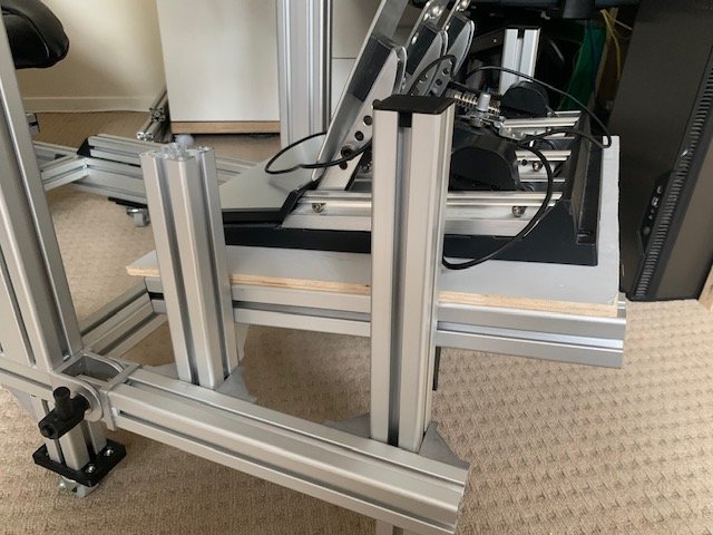

    So I put the frame together which went relatively smoothly. I couldn’t put it fully together because I want to wait until I have all the brackets before I drill the profile to lock things in permanently. I put the base frame together using temporary brackets however the full front to mount the wheel and pedals could be completely finished. The folding mechanism worked well for storage but was totally useless when it actually came to using the sim. When putting any sort of decent force on the pedals the front collapsed. Should has seen it coming, was good in theory I guess lol.

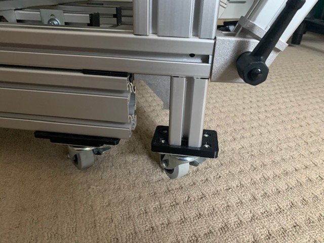

    I printed some temporary posts to support the front but that means I’ll lose a lot of the adjustability I was hoping for so I bought some more profile so I can adjust the angle on the pedals again and also made some more solid supports with short pieces of profile.

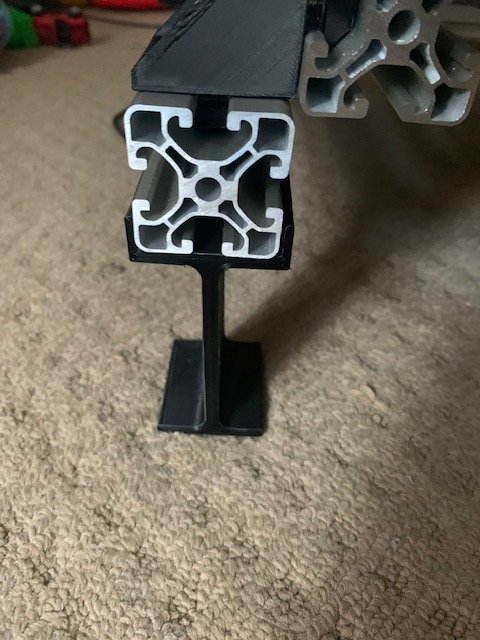

    To make the front section of the profile slide against the base I printed some sliders. One would be locked at the front of the base (to the base), the other would be locked at the end of the front frame section (to the frame) but would also have a bolt that is easily accessible to lock it to the base and stop the front frame from sliding.
    So once I had it all together I tried the sliding function. Didn’t work like I hoped, it’s a bit too grainy but it’ll do for now. I also didn’t make the front section overlap enough with the base so when its fully extended there’s a bit of flex when putting force onto the pedals which had me a bit concerned. I decided to add a brace to make more rigid. I also decided to put wheels under both the base and the front frame. It’ll make it easier to manoeuvre in and out of storage and help the front section of the frame slide out (help support some of the weight, so it doesn’t bind up so easy).

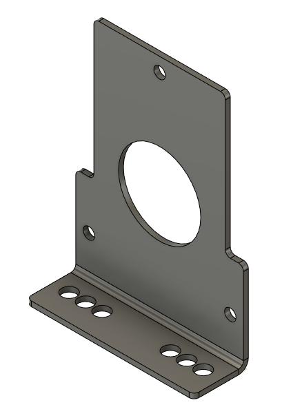

    I’m also having brackets made up to mount the motor to the frame, weld the universal joint to and mount to the seat frame. In the meantime, I’ve just solid mounted the seat to the frame so I can still have some fun with it until the brackets are all finished.

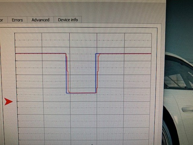

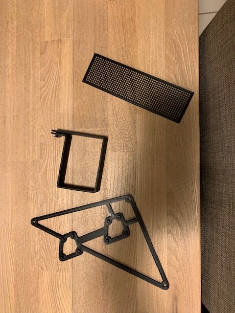

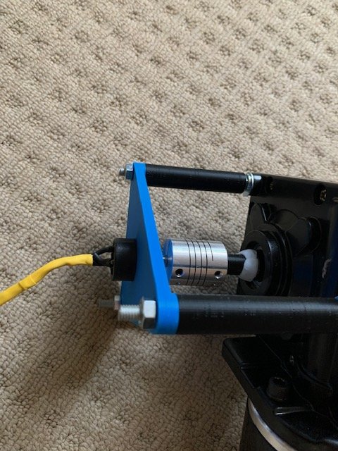

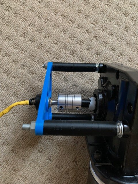

    I’ve decided to at step up as much of the control side of it as I can while the motors etc. are still off the frame. I printed up brackets for the potentiometers so it could be mounted using the all thread rod that will eventually mount the motors. I also printed some spacers to make sure it was evenly spaced all round and I wouldn’t accidently bend the pot shaft. I also printed some mock shafts just to get it all going and set up before the proper ones go in (still being made at this stage).
    I connected up the pots onto the JRKs, but I had to use a different pin configuration to what the website recommended. They said it should be connected to AUX for positive, POT- for negative and FBA for the feedback signal. I found that I had to use different pins for the positive and negative connections on the pot, I used the +5V regulated pin for positive, GND for negative (which made sense to me but I don’t know why its different to the user guide? Might just be my pots.) I found if I connected as the user manual, I did get a signal but it was static and didn’t change as the position of the pot changed.

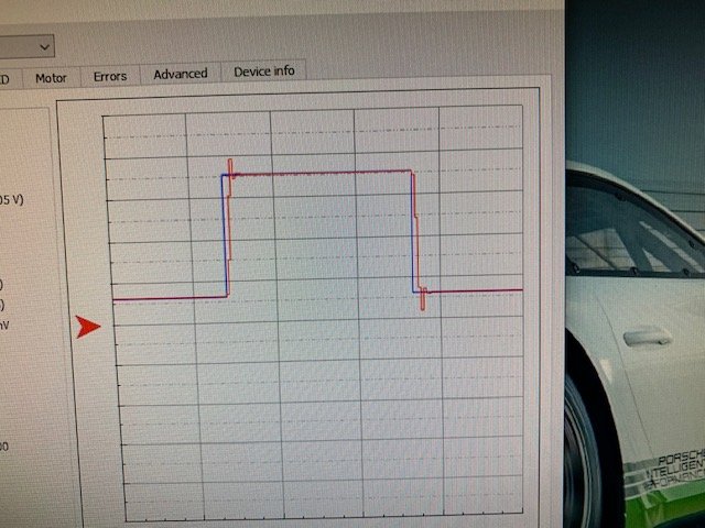

    Once I had the pots all working I then started to play with the PID of the motor. It was interesting to play around with it and see how different values cause the motor to continuously ‘hunt’ for the position. I spent about 30mins playing around with the settings (I didn’t want to spend too much time because I’m going to have to do it all again once the motors are mounted to the frame and have load applied) but I go the motors to a reasonable response. Looks like it reaches to position pretty quickly and doesn’t have too much overshoot.
    I’d be interested to know what settings other people have used on similar set and what their response is.
    I also found the JRK utility difficult to objectively measure the variables. The graph shows it, but I can’t seem to figure out how to select a point and it tell me its position and time in relation to the graph. If I can figure that out I can really see if I’m making he response faster and see how much overshoot I’m actually having. Does anyone have experience with this?

    I’ve had an issue with the sliding mechanism. I’ve used M8 bolts to hold the sliders to the frame, but if the frame goes slightly on an angle the thread is digging into the aluminium. It’s just seized up so I have it apart at the moment. I need to sand down the profile to remove the burrs and remake the sliders to use M6 bolts.

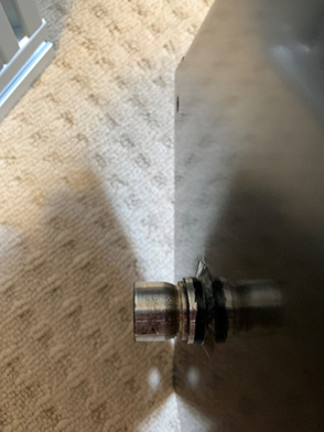

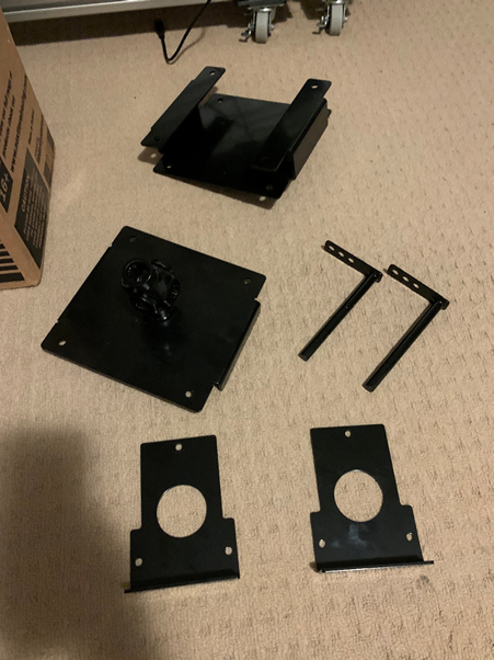

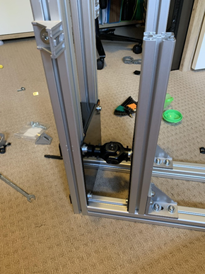

    So after some time I have some updates. I received the brackets and shafts back complete and powder coated which looks awesome.
    The universal joint has two plates with nubs on them which go into either end of the universal joint and then has grubs screws that screw in to hold it. The only problem is that is could still twist when the seat is tilted to one corner (pushed from one motor and pulled from the other). So I grabbed some JBWeld and packed it in either end. I also jigged it up with some profile so I knew the two plates would be square for when it was installed into the rig.

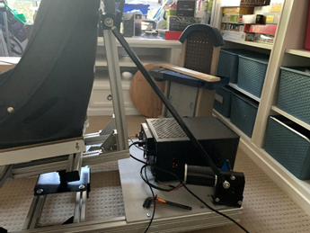

    I mounted everything to the main frame and could measure up exactly how long I need the connecting rods to be between the motors and the back of the seat frame.
    I bought some hex bar and put a right hand thread in one end, and a left hand thread in the other end. That way I can twist the hex bar for adjustment, just like a turnbuckle.
    I mounted everything and tested it all without power to the motors and had to make some adjustments to the pot positions and the rod end positions to make sure nothing bound up. I then re-did the pot calibrations and tested it again and it all works pretty good! I haven’t fully cranked up the acceleration yet and I may need to re-do the PID but it works for now.

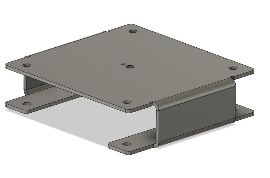

    I've had the sim up an running for a while and I've made a few tweaks . I've made some brackets to mount my Fanatec power supply, USB hub and also made some clips to help with the cable routing.

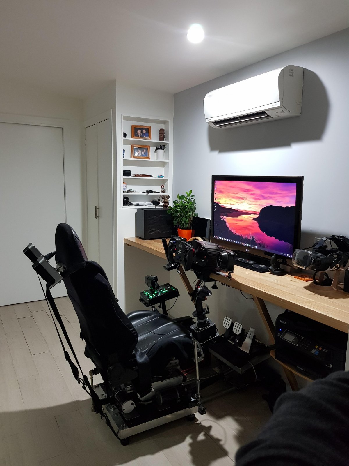

    This is my rig today, still waiting for me to build a new desk hung pedal mount, I am hosting a Bathurst V8 Supercar qualifying day on my rig for a bunch of mates on 4/12/21:
