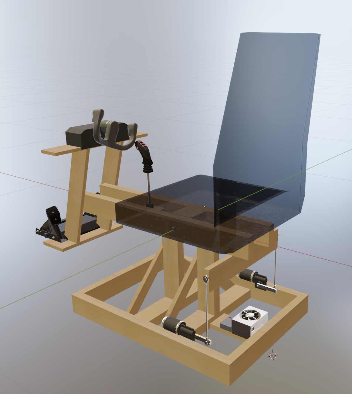

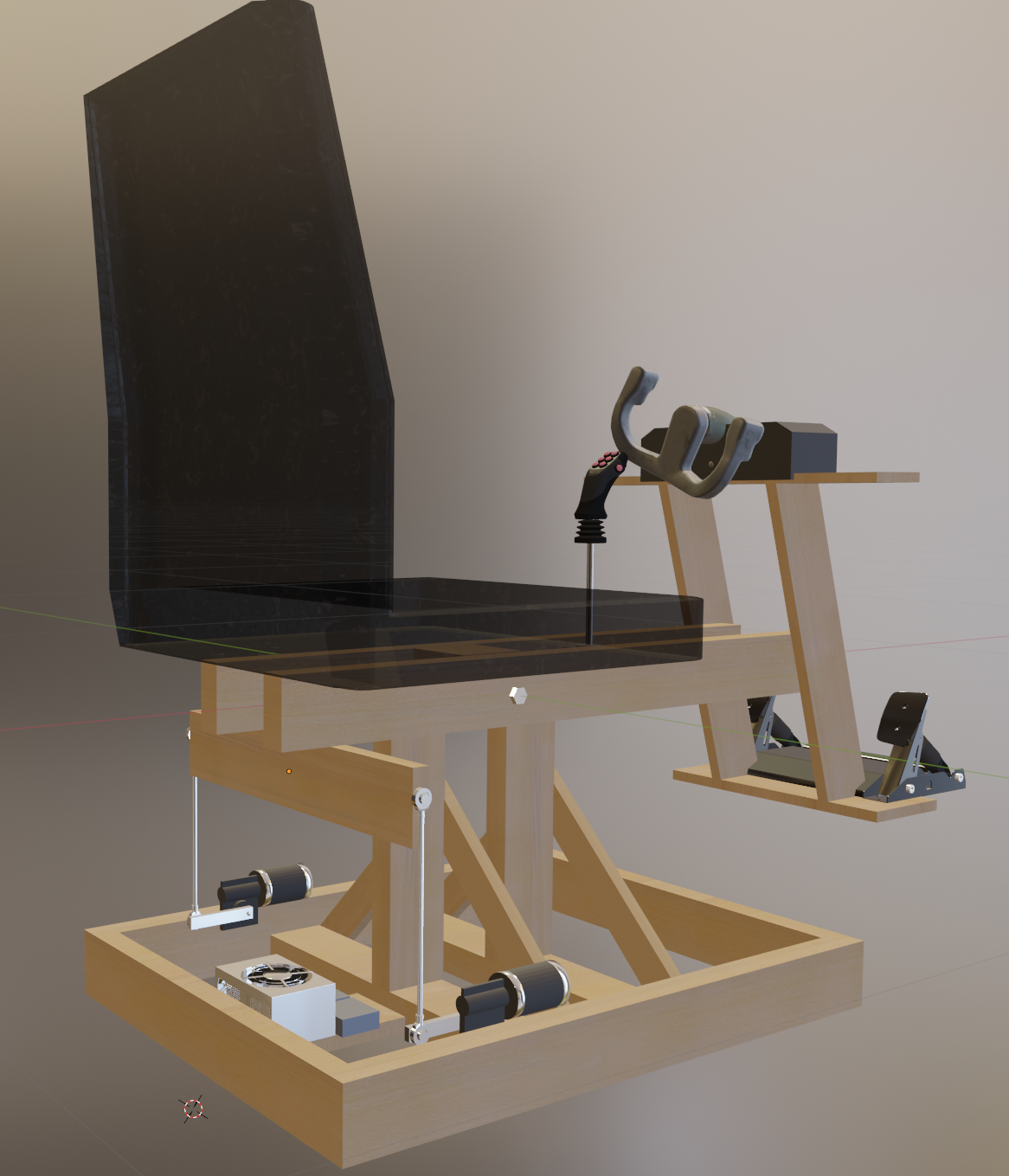

    Here is my design. Low budget is essential, and I don't have metalworking equipment, so I will be building it out of wood: 2x4" and 1x4" lumber mainly. I don't know how to get and set up a suitable Universal Joint without welding and for cheap, so I'm planning to build it into the rig.

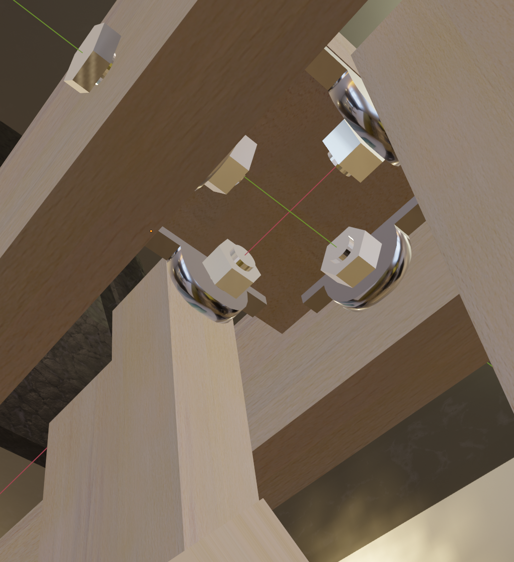

    Here is my general design. For VR without motion compensation I need fast movement but small angles. As I'm not into combat flying and more into MSFS, this is fine. If motion compensation for Reverb G2 in WMR mode (not SteamVR) will become possible I would like to keep my option for larger angles, but I may limit the angles at first of they are too much for VR. DIY Center-mounted joystick will be optional, when I need it for a specific aircraft. Yoke can be swapped for a wheel for racing games. Please tell me what you think about the design and what am I doing wrong, if anything. Advise on improving the design is appreciated!

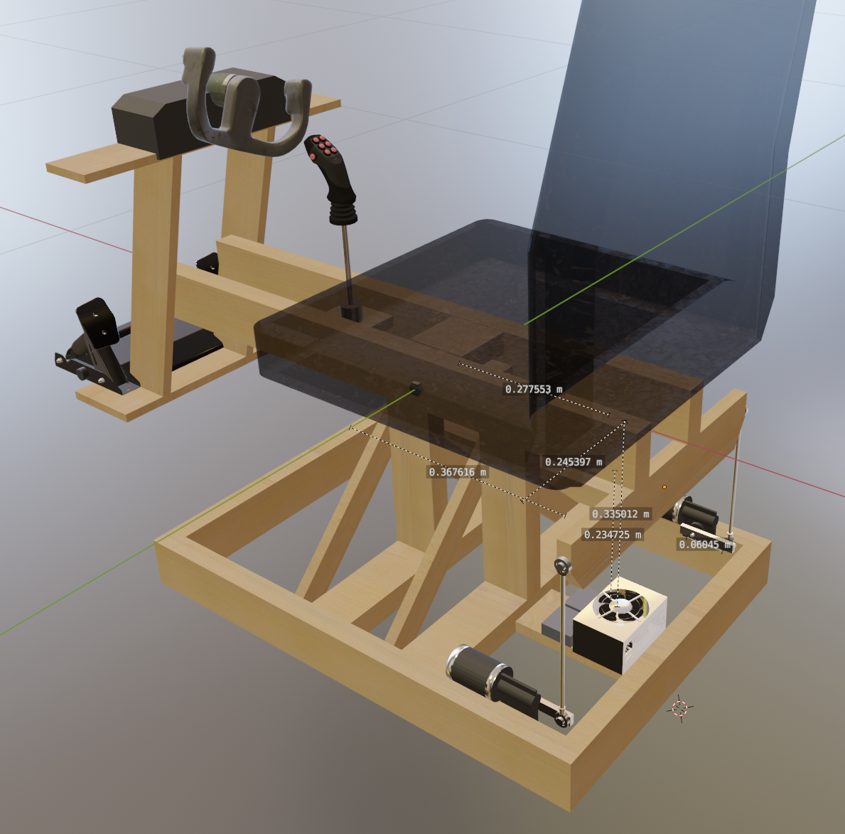

    Here's a close-up of the "universal joint" arrangement with 4 pillow-block ball bearings (see parts list below):

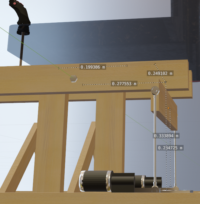

    The pitch: 2 long beams (going left to right) pivot on the 2 bearings on Green Y axis. Roll: the square "u-joint" wooden block pivots on Red X axis on its 2 pillow block bearings. All bearings are on the bottom side, so the upward pressure works for the stronger attachment.

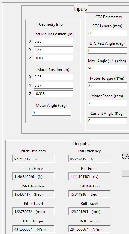

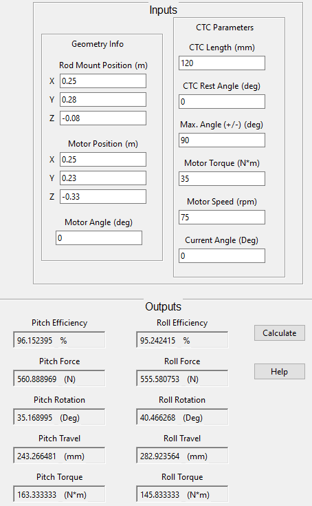

    I tried calculating with SimCalc but I'm not sure it's making sense. Am I doing it right?
    If I set "motor position" Y to 20cm as I measure it in my model, it says "invalid geometry", but 23cm works. Why is that? I'm definitely doing something wrong. Here is the working result with 23cm:
    These are my distances:

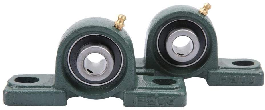

    DIY Universal Joint: UCP202 Pillow Block Bearing x 4
    $20
    - Would it work? Is my geometry feasible?

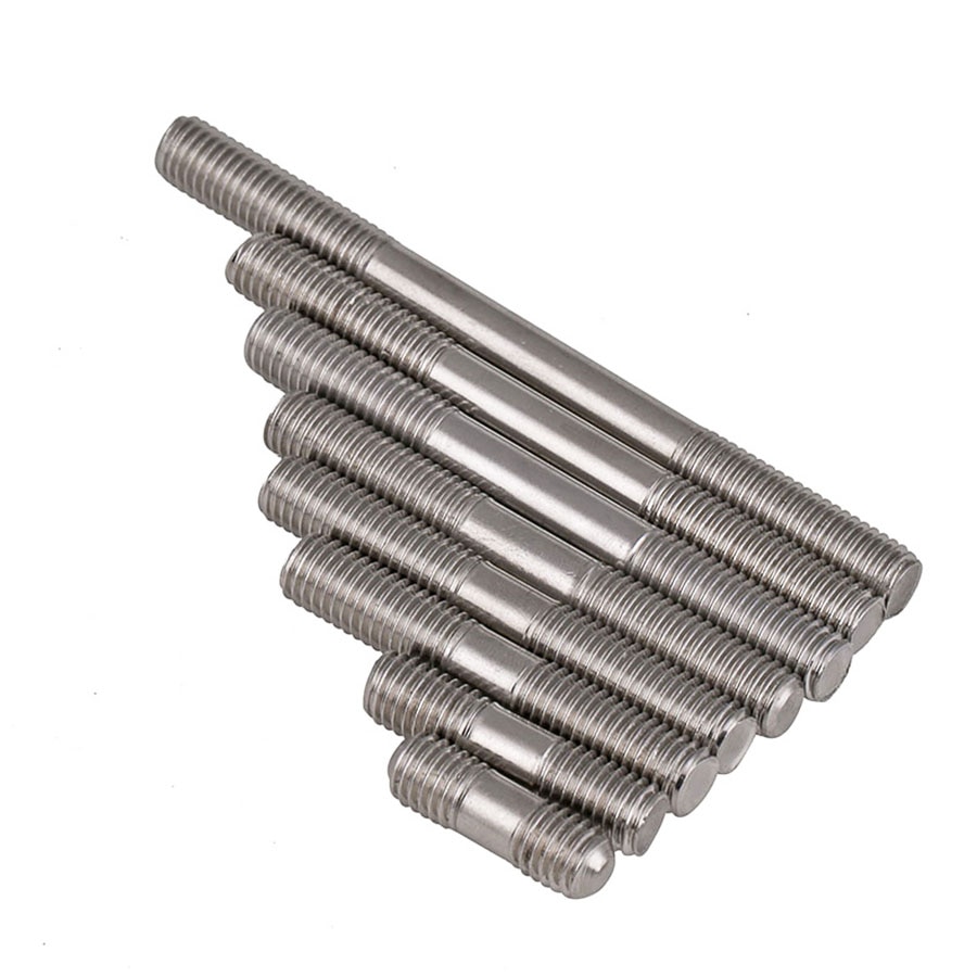

    Rods M12 x 25cm x 2
    https://www.aliexpress.com/item/1005002205826524.html
    $19.04

    Even with pgsaw 50:1s I would suggest moving the motors further back, as far as you can which is basically the back board of the base, as compact designs require as much design torque as possible.
  3. Ronan Design
    Jun 4, 2021
    262
    Toronto, Canada
    1,672Coins
    +137 / 1 / -0
    Thanks @noorbeast . What does moving them back do? I can even extend the frame if needed. Should the rod mount points be moved as high as possible, or as low as possible if I move the motors back? Is the goal to have zero position with arms looking up to have rods as close as possible to a 45 degree angle?
    If I move motors back, I guess the arms should be looking outside then, so the full rotation is possible (in emergency case when something goes wrong). I n that case, should I extend the top rod mount board sideways, or keep it as is and have the rods at an angle in a sideways direction too?

    Come to think of it, if arms are angled and motors moved backwards, but the rod mount points are lower than main seat rotation point (u-joint), then pitch up movement (tugging seat back down) would be at a disadvantage... Should the rod attachment point be moved higher than the u-joint, if motors are moved back? Kind of closer to the SimCalc illustration? I just can't picture the geometry on my rig, with motors on the back board, pulling seat down. I think it would lock...
    21,592
    151,215Coins

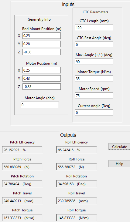

    You have SimCalc, so increasing the Y distance between the pivot and motors will demonstrate an increase in the torque.
    The angle of the lever to the rods should be 90 degrees (max torque efficiency) when the rig is level and at rest. The torque efficiency of a lever drops off rapidly over about 40 degrees up and down. Think of it like a door, if you are at 90 degrees you can push it with your little finger, but the closer you are to the door edge the less efficient the force.

    Somehow it doesn't change at all:
    If I increase Motor Position Y from 0.23 to 0.43 for example, I get exactly the same torque:
    My pitch and roll travel and rotation all decrease, and torque stays the same? I tried other values - same result. Looking at my 3D image now I see that the maybe arms should be slightly farther than 90 degrees to the rods, to counteract loss of torque at extension? But you say they should be 90 degrees...
    21,592
    151,215Coins
    You need to move the rod mount position on the Y axis back as well.
    50-60mm is likely in the ballpark for a compact design lever CTC distance.
    Keep in mind that in a compact design the actual perceived linear speed is multiplied by the seat back height, where you head is, rather than the measure at the base.

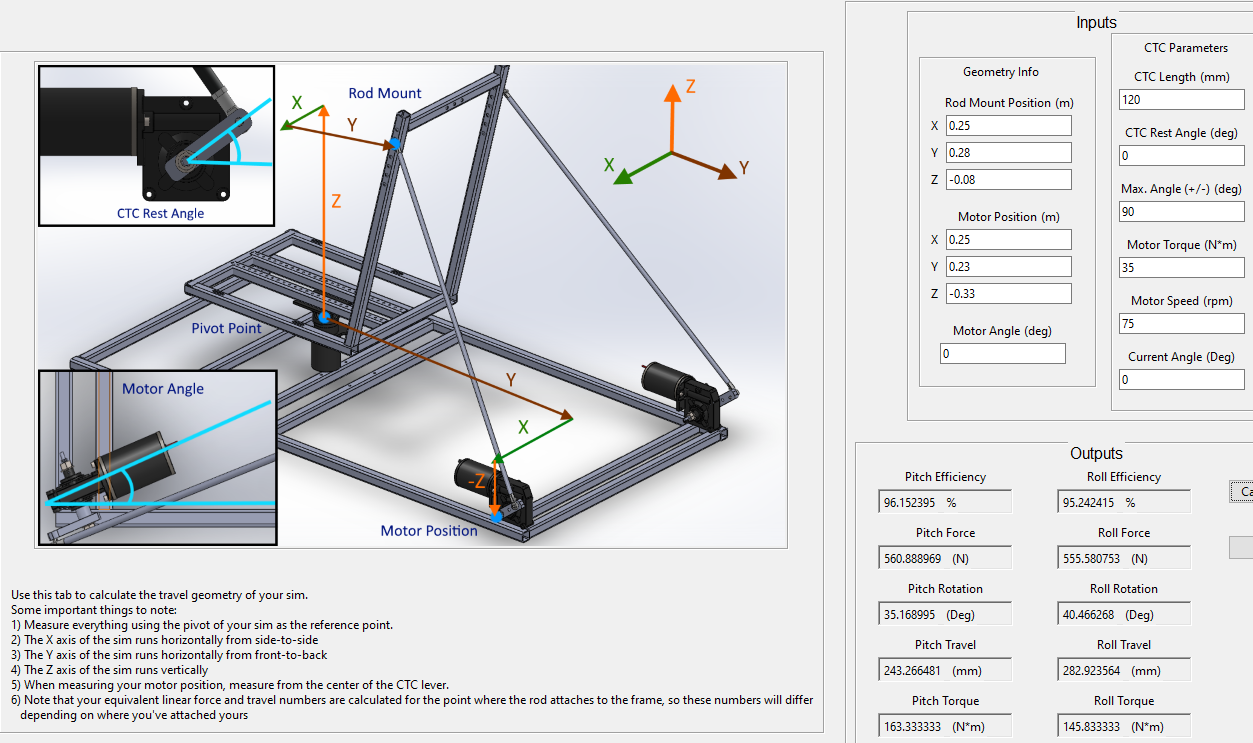

    I tried moving both motors and rod positions back, and shortening CTC to 60mm and got results that have more torque and much less travel because of shorter CTC. Also twice less rotation. @noorbeast is this configuration what you meant?
    The rig now looks like this:
    Or did you mean I needed to angle the rods? Would 60mm CTC give me enough travel? 15 degrees seems like too little...
    21,592
    151,215Coins
    In VR less is more, even for flight you want fast precise movement, rather than large wallowing axis movements, and on a compact rig you need plenty of torque to move it. You have to keep real physics in mind and what it actually takes to drive a loaded rig.
    Yes I do mean extend Y rod and motor position as much as possible within the design constraints.
