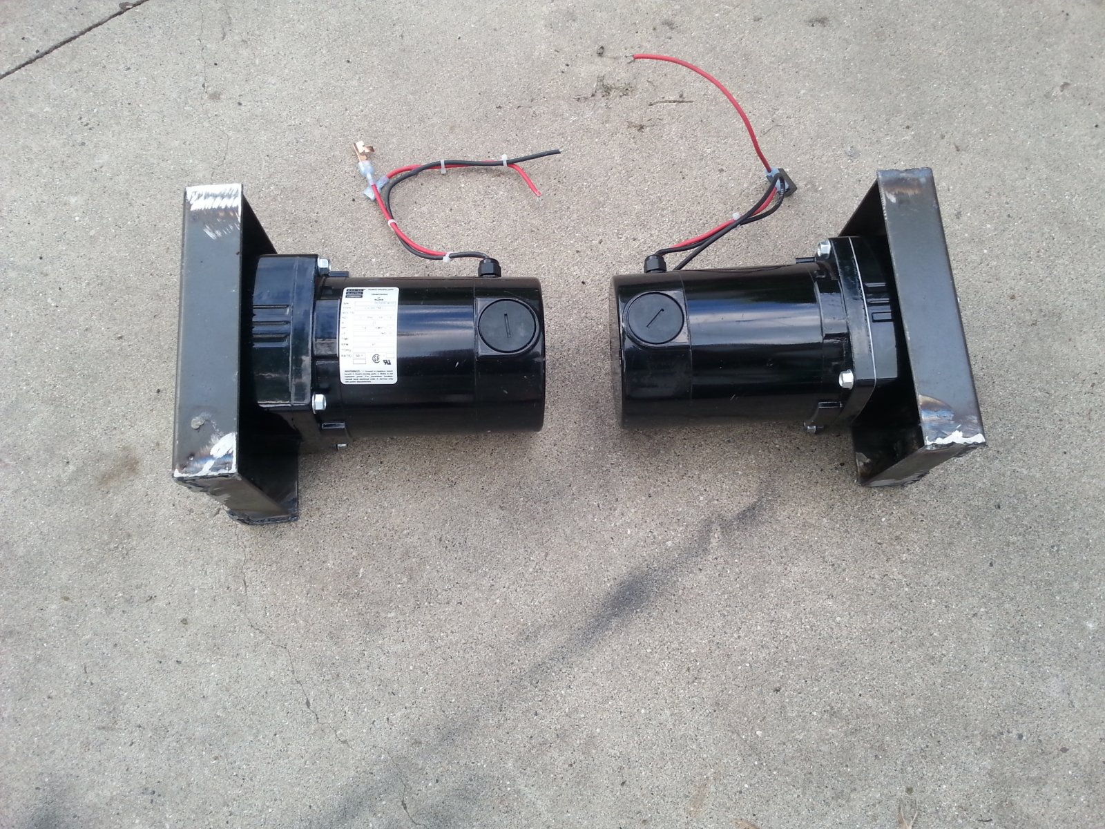

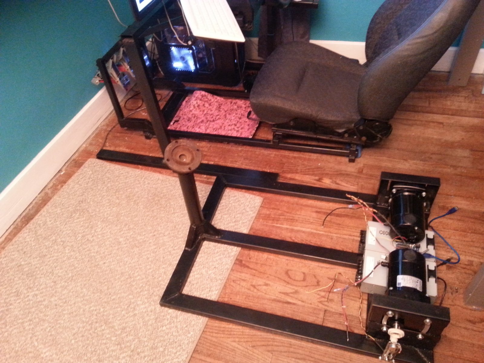

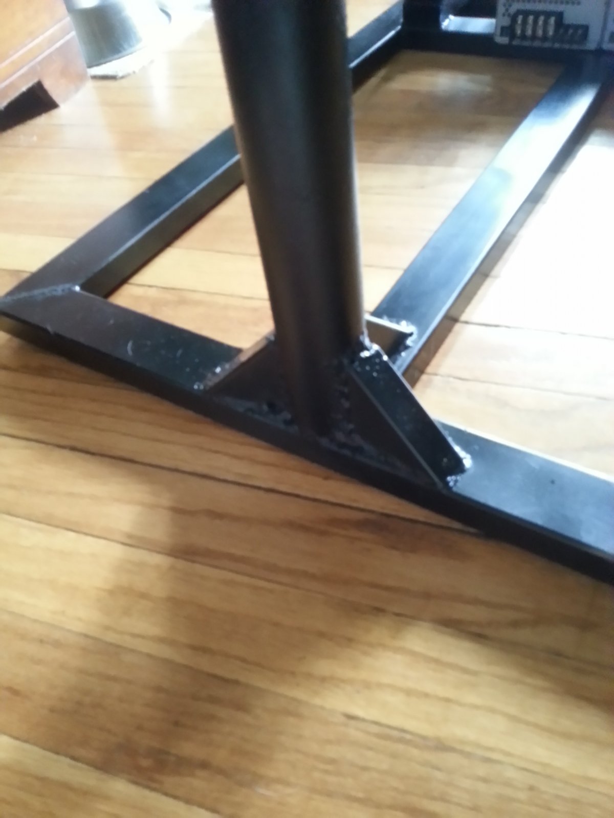

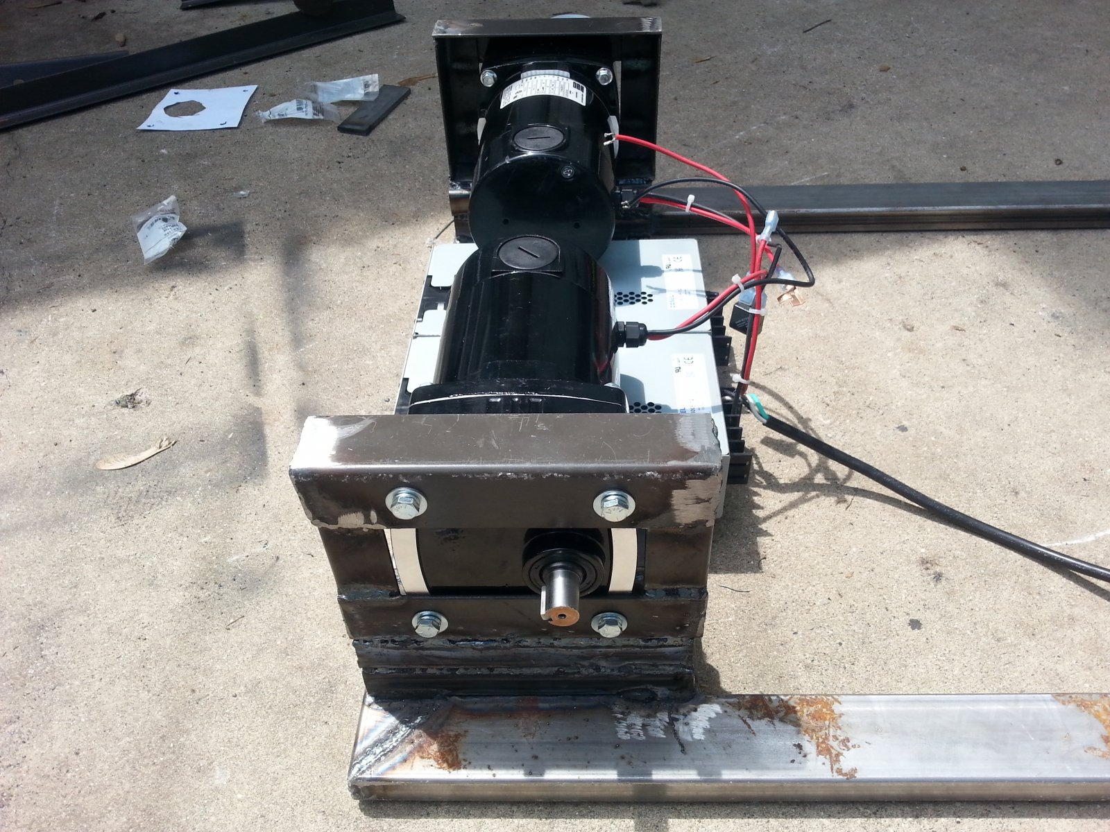

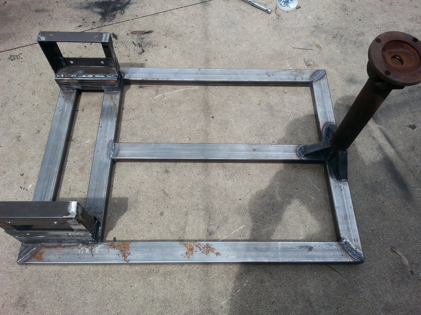

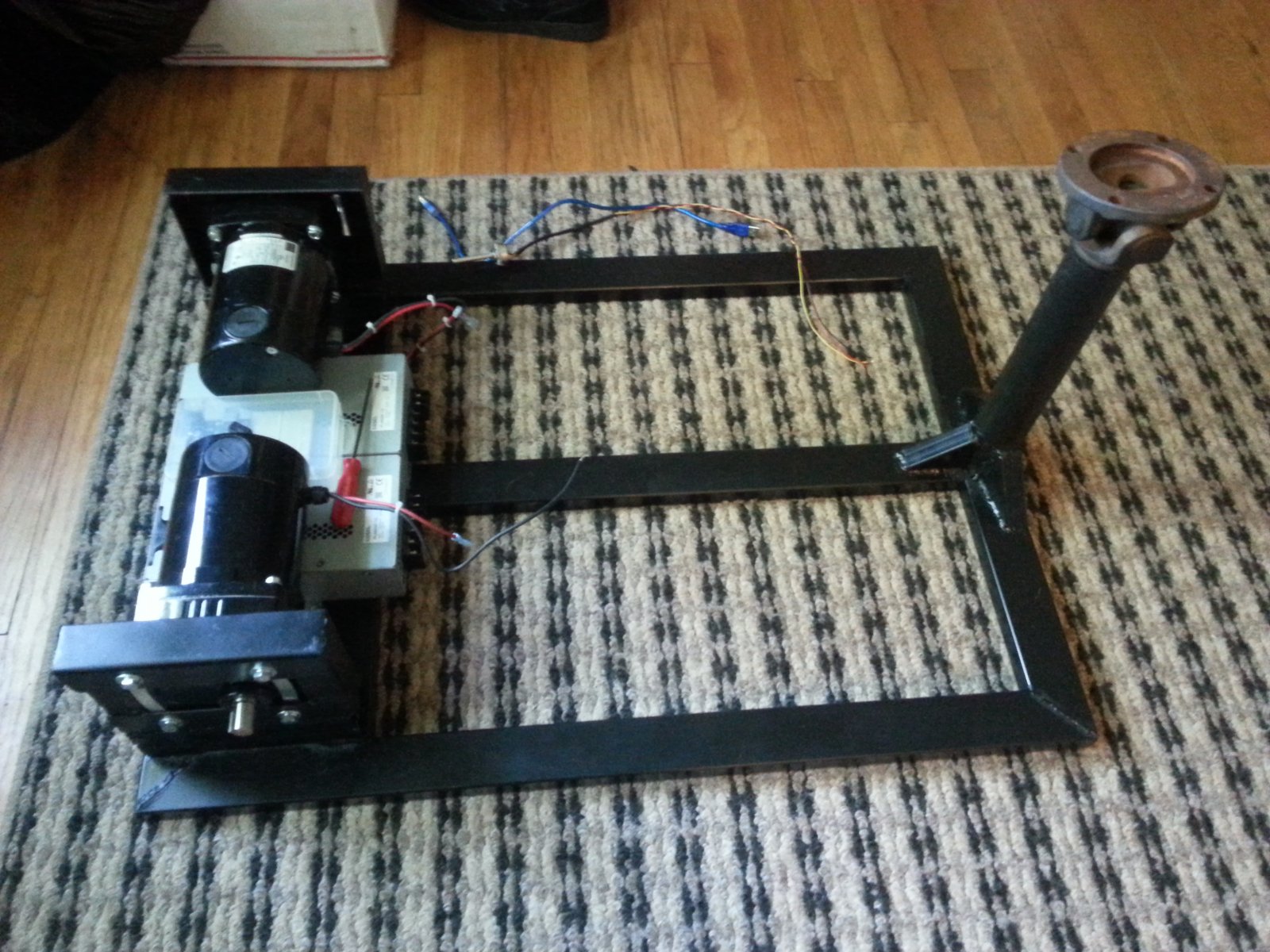

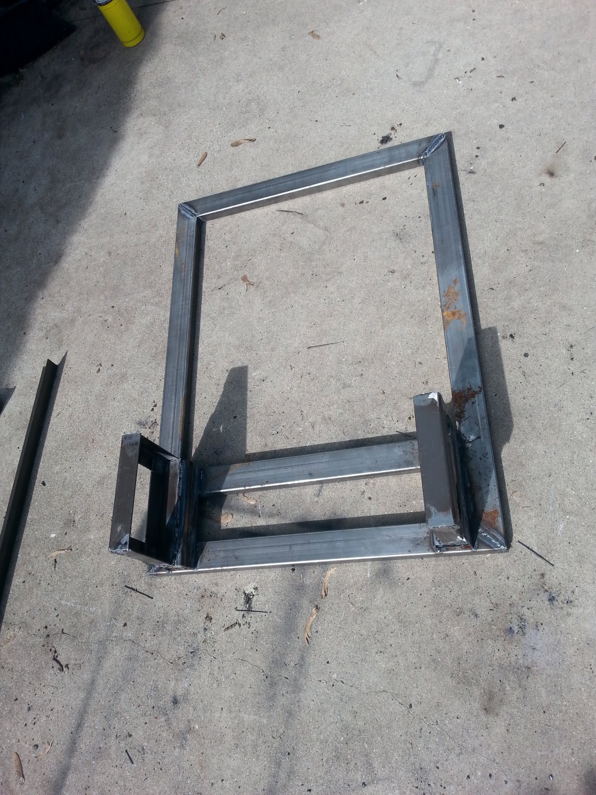

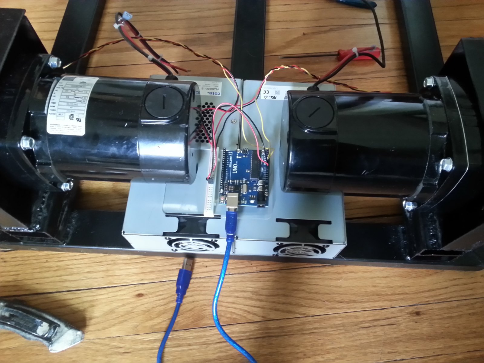

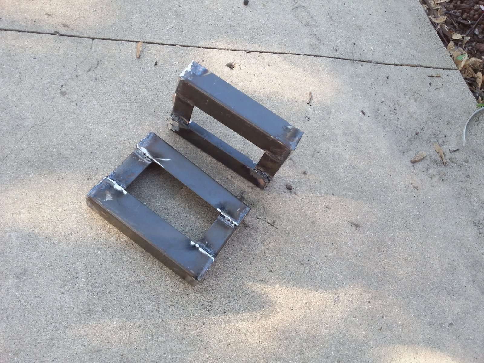

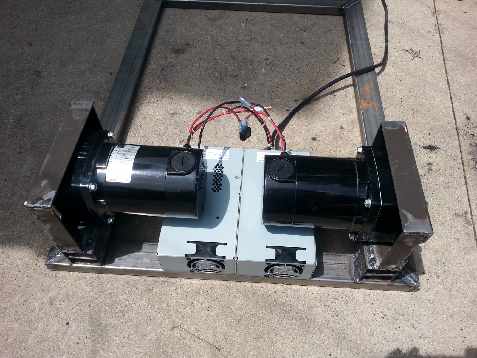

    finally started building the bottom frame. got motors and psu's situated. tommorow ill work on pots. waiting for electronics from china so I have a minute. 20150616_181718.jpg 20150616_201128.jpg 20150617_100832.jpg 20150617_124533.jpg 20150617_124608.jpg 20150617_150212.jpg
    • Like Like x 6
  13. noorbeast
    21,493
    150,578Coins
    +11,017 / 55 / -2
    You were going to post a rough sketch, I am curious what the dimensions are and how the motors connect to the seat.
  14. bruce stephen
    Jun 7, 2015
    1,286
    general contractor
    michigan
    9,114Coins
    +1,243 / 9 / -0
    those are top secret i would show them to you but u know...........
    the base mearures 24in 61cm x 33in 84cm
    post top is 15in or 38cm up from base
    22in 56cm from motor shaft to motor shaft
    27in 68.5cm from motor shaft to post
    motors are 276 watts each
    psu are 50 amps each
    hopes this helps i'd give more info but don't rteally have some of the design decisions made yet.

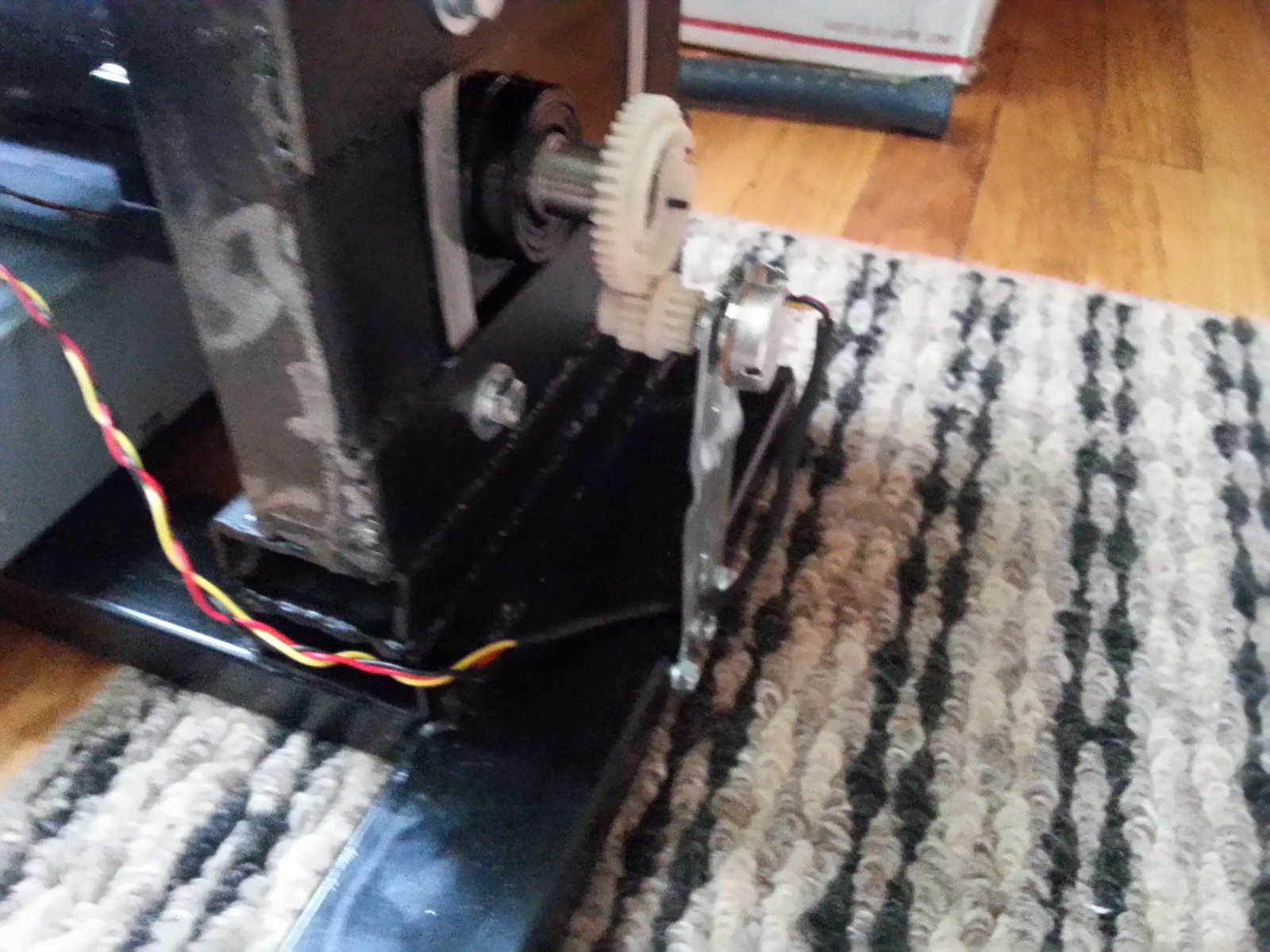

    ok painted and did a few small things got a pot hooked up. got pots and ard to show in smc3. Waiting for motos 6/9. and my 5/8" keyway collars for the levers 6/14.
    20150619_095336.jpg 20150619_114914_LLS.jpg 20150620_173727_LLS.jpg 20150619_120000_LLS.jpg

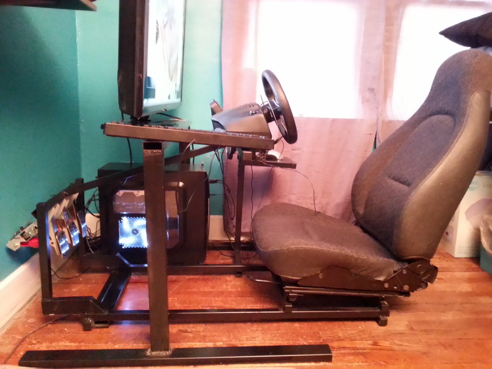

    and just for clarification I do not have drawings. If i did I would share. I may use the static rig i referenced (will post properly below) in my first post but it is really heavy and twists. its the first thing I ever welded, only 2 months ago. plus the seat is from a saturn (kinda heavy with useless slider) and i think if i save i can get something cooler. I don't know how to make keyway 5/8" so i ordered. the lever arms will be steel bar welded on. not sure on angle and will try to match suggested. I think the arms will come from the back of the motor. I'm not much on the math side so sorry for the lack of pre planning. I'm just building and trying to read as much as possible.
