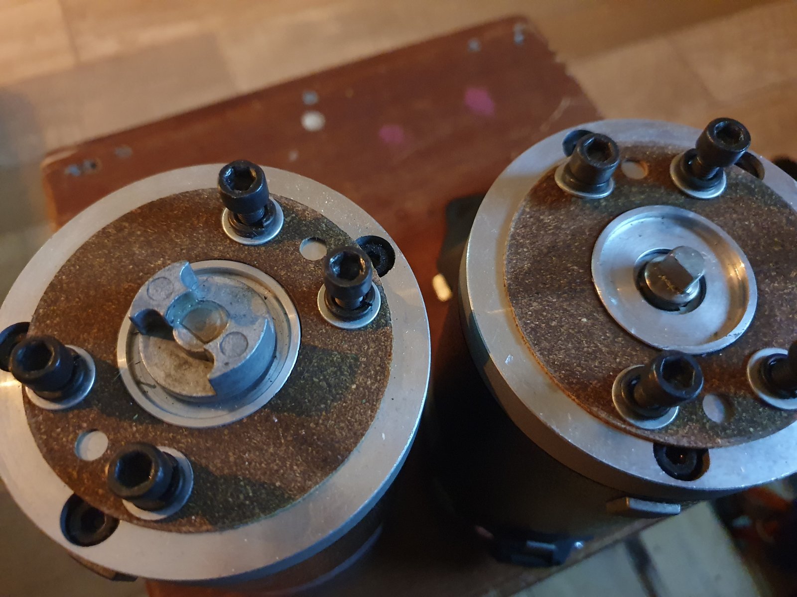

    He guys,
    Just fired up my 2 Dof and something was rattling inside my right-motor.
    Opened it up and there was a most terrible thing I ever saw. :mad:
    It is a ZYT90-155-24-3000 with an matching worm-wheel 1:50 from https://www.motioncontrolproducts.co.uk/products/8/24/12vdc-traction-motor-zyt90-155-04-nm/
    I already wrote them an E-mail.
    But how is the piece called in English?
    And also the rubber part between the motor and the worm-wheel side?
    Or is this a common problem, and you guys have multiple part numbers, which also can be found in " The Netherlands"
    TIA

    If I would to guess I would say motor coupler and bush.
    But that’s a guess.
    20,535
    145,034Coins
    +10,776 / 52 / -2
    The ones Motion Dynamics sell in Australia are called Motor/Gearbox Spider Coupling Set: https://www.motiondynamics.com.au/motor-gearbox-spider-coupling-set-metal.html

    Thanks for the info. I sorted it out with the guys in England.
    Got 4 sets of these couplings for just the freight charge.
    Thanks anyhow

    What caused its damage? Is the load too heavy?

    Because it is cast alu. I think it is just a matter of time it will happen. Had it ones time more. But I have some spares....so ok.

    This may be the reason. The strength problems of aluminum parts cause damage over time.
